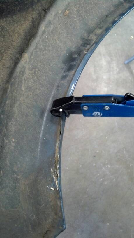

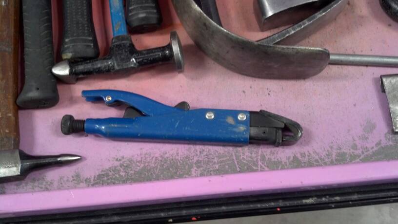

    Modified my clamp to peel rolled lips on wheelhouse and door skins.

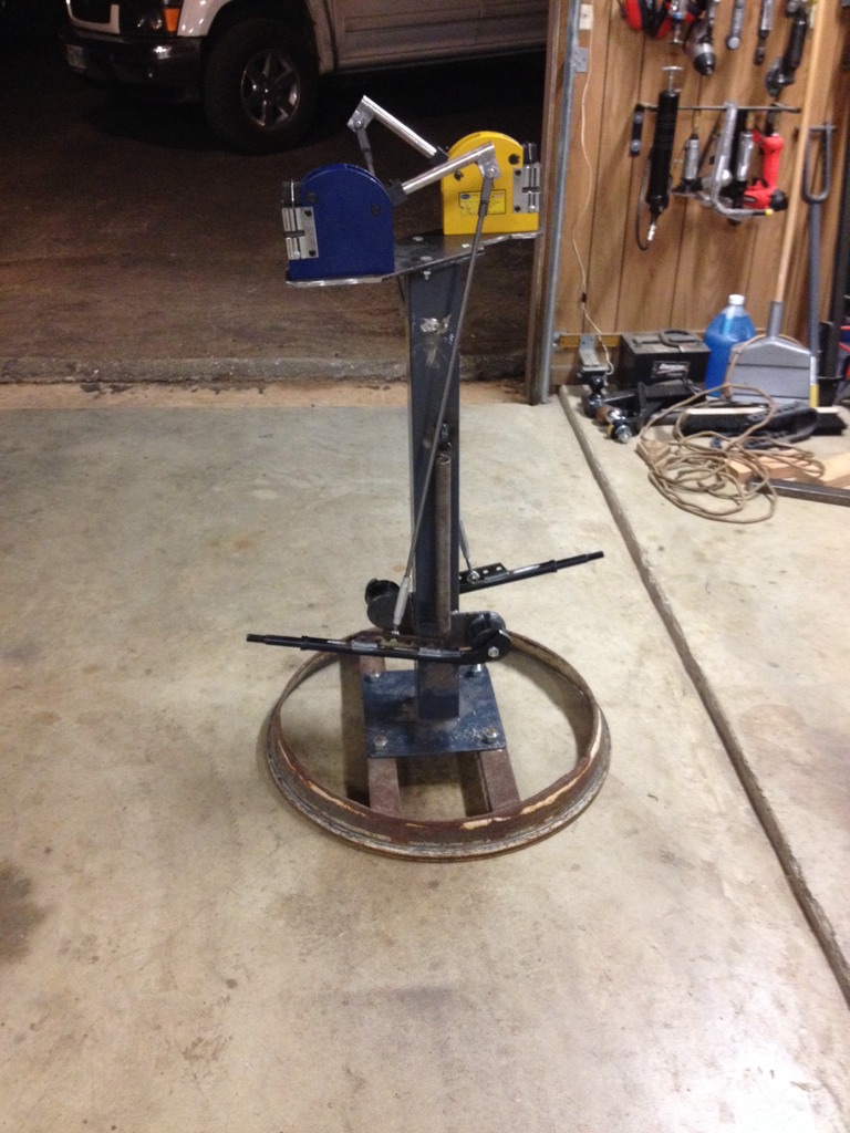

    Got my shrinker/stretcher stand all squared away lastnight. Will still tear it back down for paint.
    I took the other half of my semi wheel, and mounted the "bender" setup on it. Unbolted the bender portion and made a new flat top for it. Pedals are MII strut rods that were the wrong angle for my MII setup. Has big return springs from an attic stair and turnbuckles for adjustment. I will still add pedal pads to it.

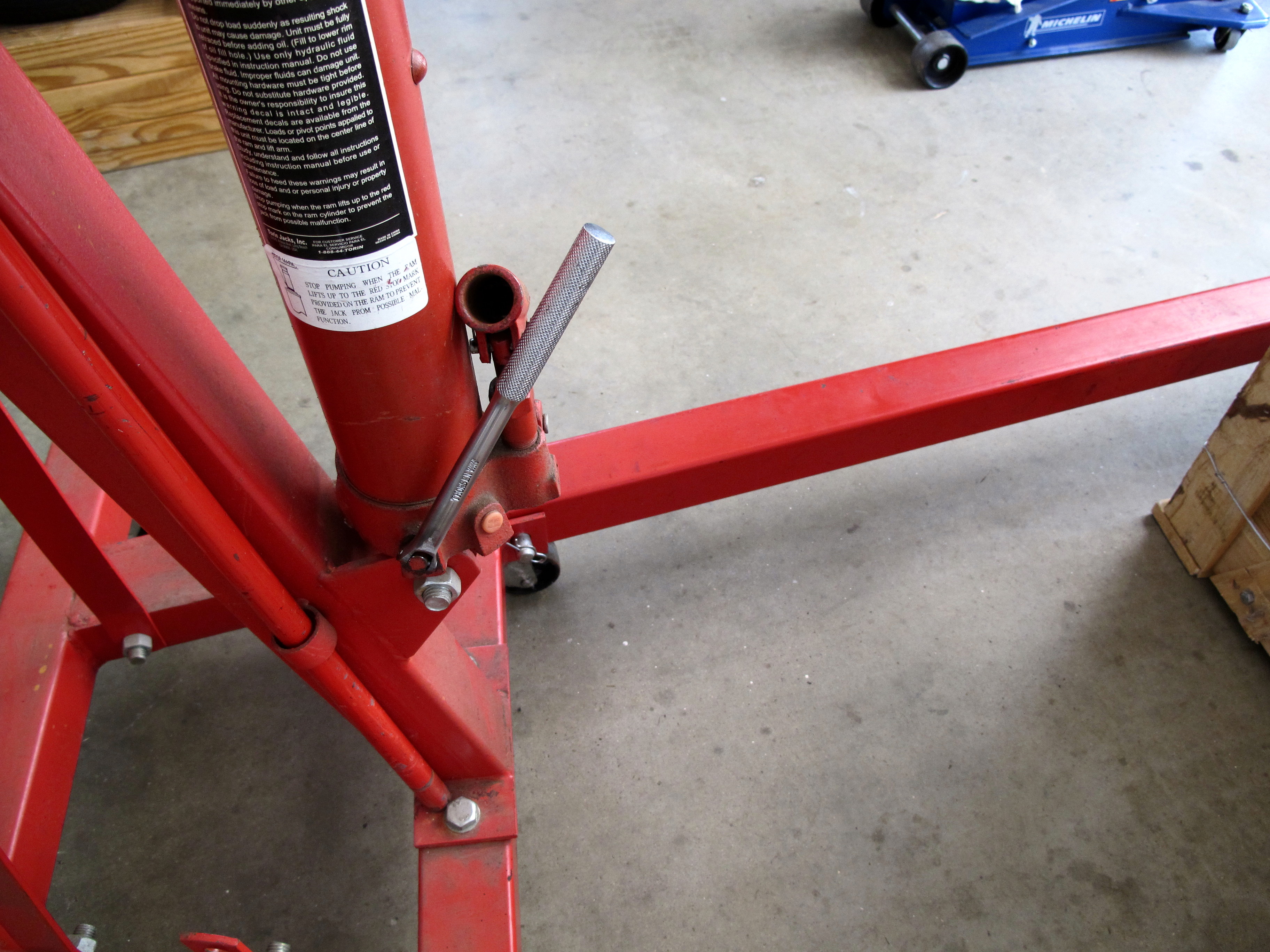

    Upgraded my engine hoist release using an old wore out swivel head ratchet handle.
    jakespeed63 and Zapato like this.

    that hoist release is nice,a finer adaptation of mine,gives me an idea for the non pin style jacks..
    Merlin likes this.

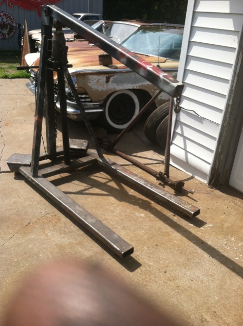

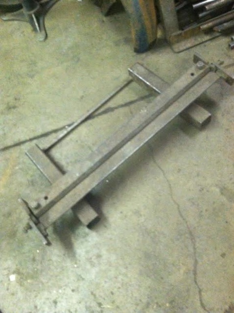

    Here are some tools I made more than 40 years ago, a little crude; but they sure have done a lot of work over the years. They are out at my kid's place now days and are in pretty much daily use there. Made the hoist cause the one at the rental place didn't fit under dropped axles.

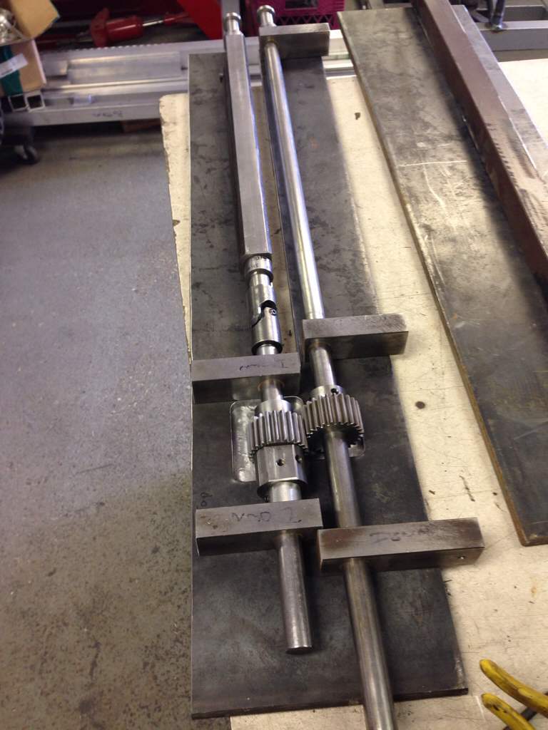

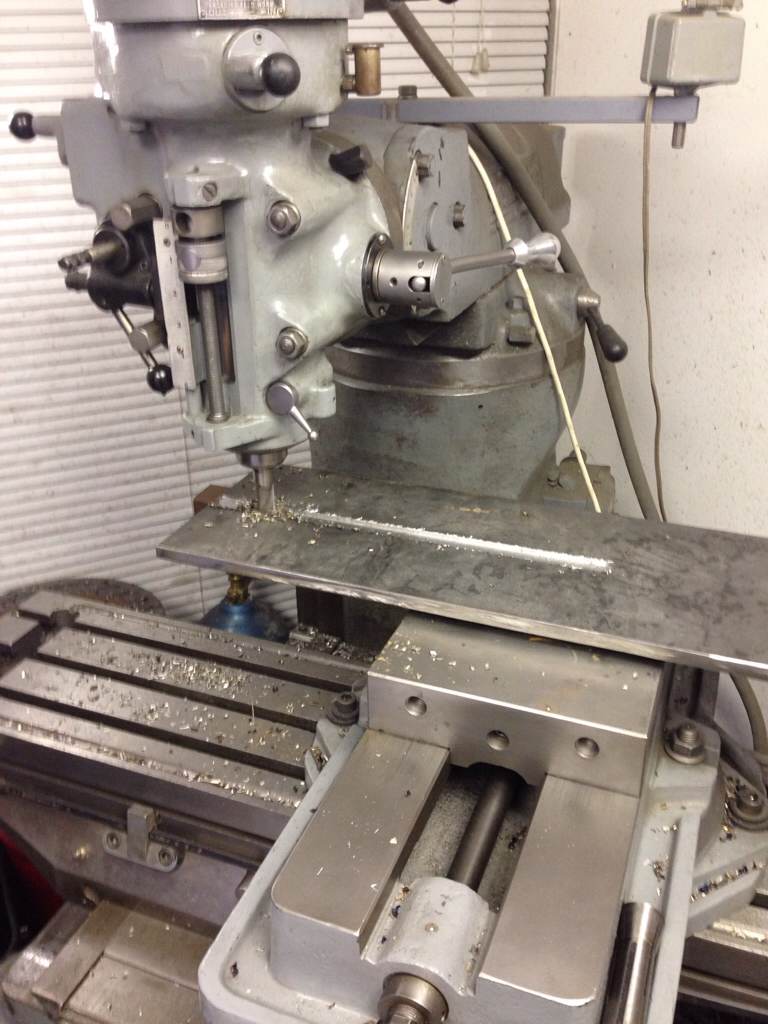

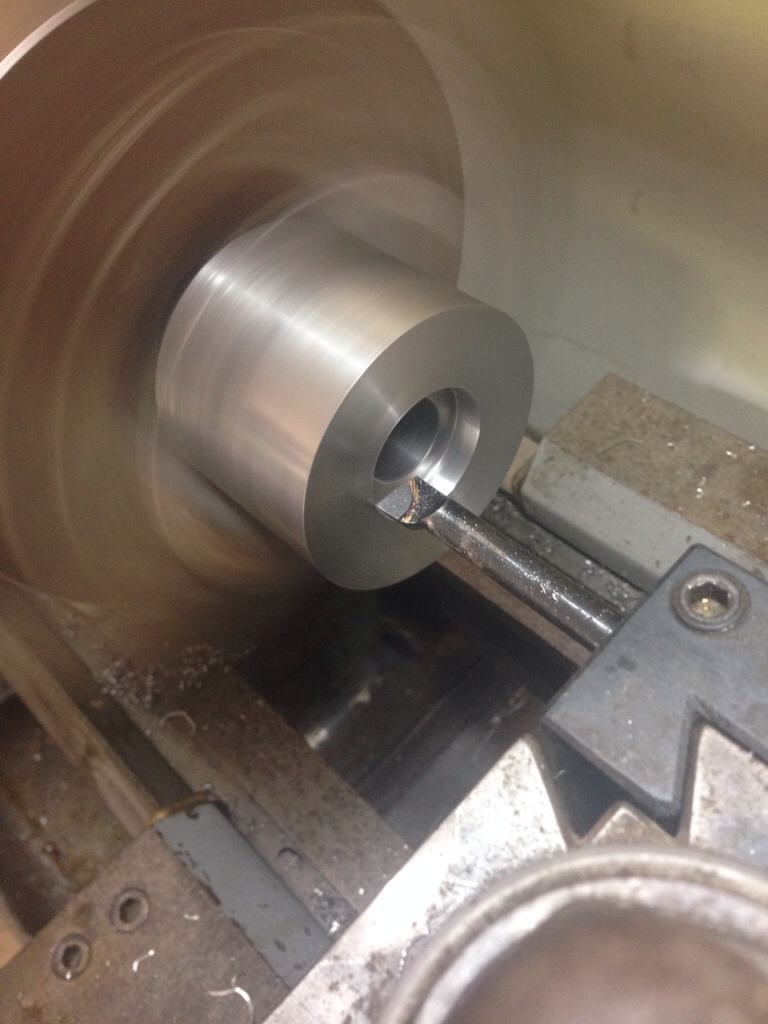

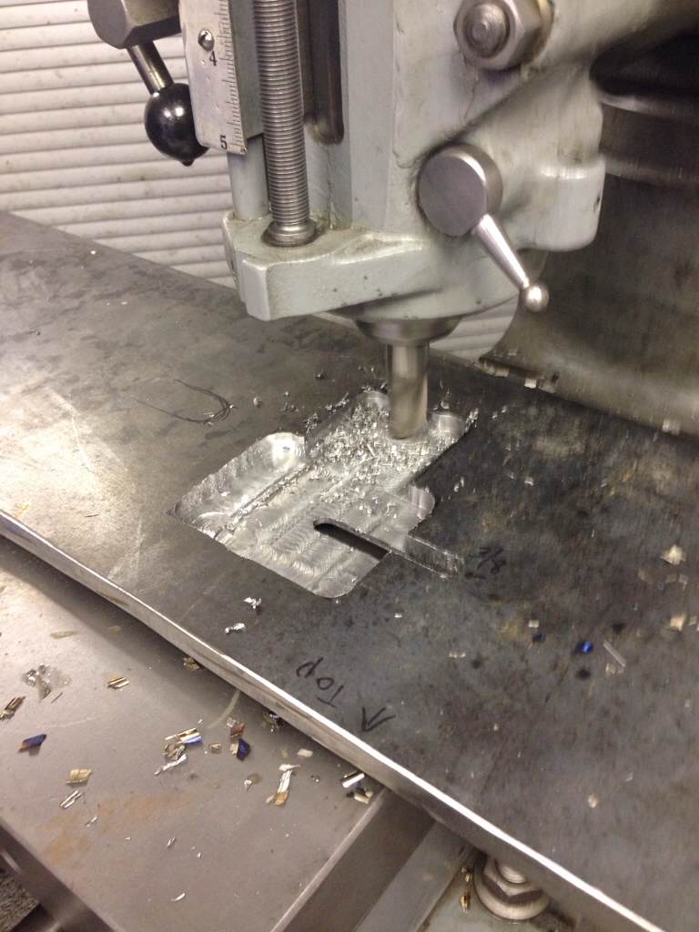

    Built this a few months back.. The internals were done by a guy on metal meet named Rick. I made everything else .. Basically just a copy of his design. I added a 3/4hp 3 phase gear motor which is run by a vfd. I added a foot pedal and a forward and reverse switch. I also started making my own dies on the lathe out of s7 tool steel. The bead roller has an adjustable top shaft which moves in 1 1/2. The side plate are half inch which are really beefy ImageUploadedByH.A.M.B.1402856813.961685.jpg ImageUploadedByH.A.M.B.1402856829.326780.jpg ImageUploadedByH.A.M.B.1402856845.576475.jpg ImageUploadedByH.A.M.B.1402856867.959737.jpg ImageUploadedByH.A.M.B.1402856878.512565.jpg ImageUploadedByH.A.M.B.1402856898.343240.jpg ImageUploadedByH.A.M.B.1402856923.859797.jpg ImageUploadedByH.A.M.B.1402856939.159776.jpg ImageUploadedByH.A.M.B.1402856953.943315.jpg and do not flex at all.

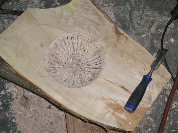

    Thanks but its not perfect. But it turned out o.k. I used my skill saw and cut kerf's till I could chisel what was left. Then waited a really long time and sanded with 36 grit then 80 on my air sander.
    I practiced with a piece of fir and the skill saw and I still messed up.

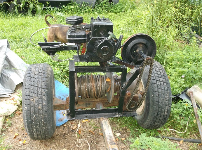

    NEW toy, I have been working to perfect it's operation, NOW stacked into a more compact footprint, I cut the gearbox off, put a pulley off a tiller, a adjustor off a lawnmower, a motor off the pocket bike project here, a 50 chain down to the "army truck" winch there on the frame. RIGHT now it is on a small trailer I kept around to make a motorcycle trailer with, but it will end up on a section of 2x2 to slide into a cl*** 3 trailer hitch. To use it, drop it on a trailer ball, it pulls the lighter "one" to the heavier tie off point..
    Pull in the belt tensioner and it pulls like a big wrecker.

    That is really nice but suggest you add a fairlead.

    Yes, planning on it. I had a ramsey winch in a box behind a 41 chev bumper, it has a guide there on the front. Also mounted to a 2x2 to go onto a trailer quickly, or stored out of the weather in a building.. the motor went out on the Ramsey winch, Summit has them for $91 thou.. Not had a real use for it in a bit. It was kinda bothersome, would **** the bottom out of a battery in a 100' pull.
    Also, A " 8 foot aframe" with outriggers... to bolt on with two bottom swivel bolts, tilt upward after threading the cable to it.. and a instant "crane" to lift truck cabs and other light bulky things.. I didn't invent this idea, but watched in amazement as a old farmer in Illinois load a small tractor with one on the back of his truck. THE tractor was three to four thousand pounds. (I ain't building nothing that heavy) Last truck cab I swapped I used my outdoor cherry picker with a 14 foot piece of 2x2 stuck into it and a chainfall.. (up near vertical) I was sweating bullets. and dodged one that day. I've turned over them cherry pickers a few times, and my current one has 13" tires on the front outriggers, splayed real wide to go outside a vehicle's footprint.
    I have a 24" Ibeam & trolley I put into the ceiling of my shop.. when I can get to it for projects in the way.

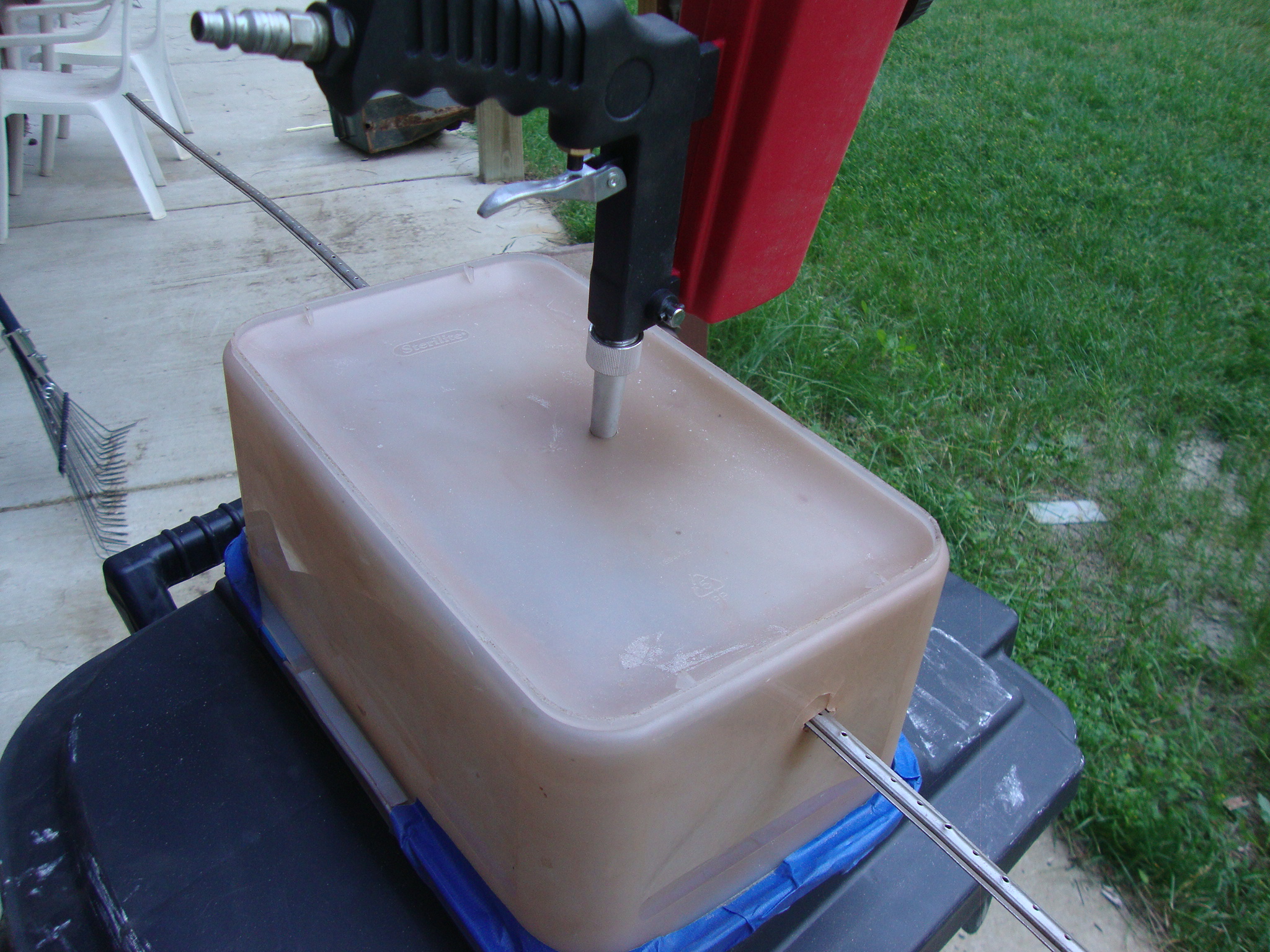

    This is super gay but it is serving its purpose. I need to blast my stock exterior insert trim on my deuce sedan. Its to long to fit in a blast cabinet and there rare enough that I dont trust a heavy handed sand blaster to **** them up so I cut two slots in the end of a tote to slide the trim thru then I drilled a hole big enough to slide my spot blaster in and there ya have it min DSC02747.JPG DSC02748.JPG i blast cabinet. Takes a bit of time but what the hell I have time.

    Super gay? I like your ingenuity. Nice use of a tote.
