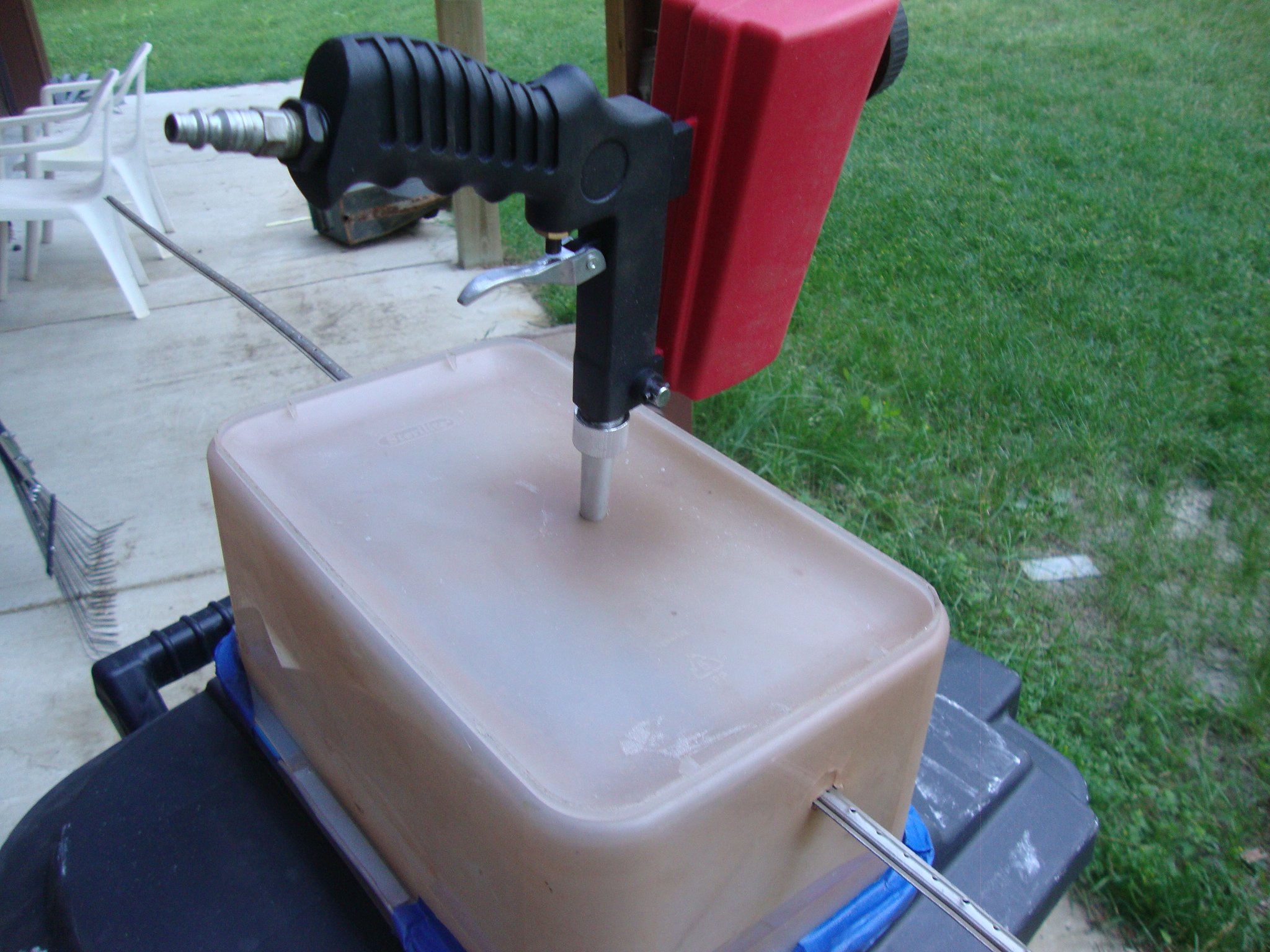

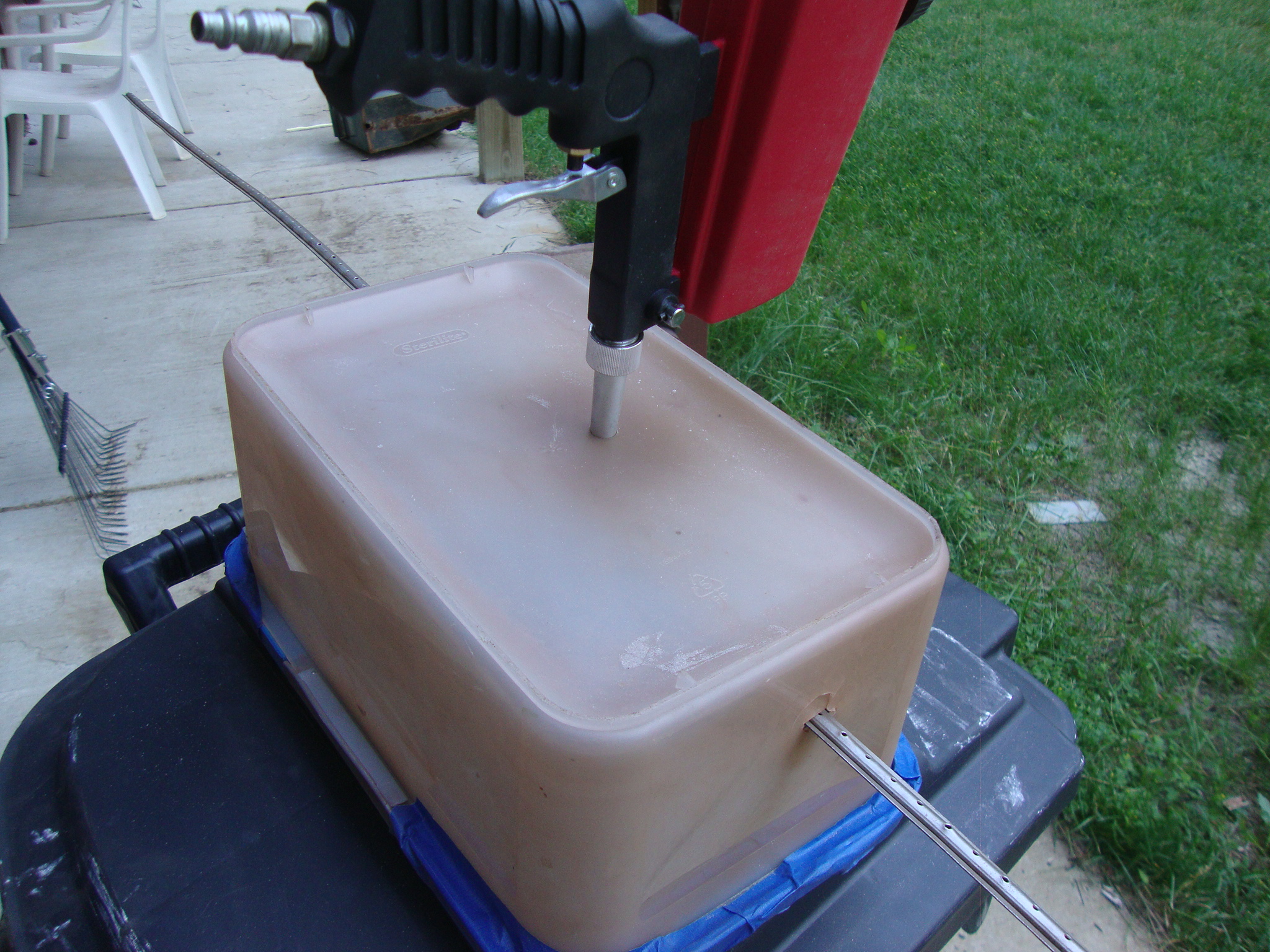

    NEAT idea Rusty... A guy here in town heard I had a new V4 air compressor.. and showed up with a neat rig a vacuum and "media blaster" here. He wanted a crazy amount of cash for it. It was just a rubber floppy nose tied to a vacuum canister with the media nozzle in the middle of the suction tip. Ever now and then, he'd turn it off, and the media would fall back into the bottom and recycle.. the unscreenable trash out the side.
    Moisture kicks any media blaster's ****. I hung a old "air brake" reserve tank in the ceiling as the final collection point at the end of the air line, where the air had cooled, and in the tank, slowed down to settled the water out. Made a heater on a rod to "stab into the sand".. stick it in, let it cook, the sand is hot and dry. I slung the last small blaster I had into the woods. There is a blast cabinet in the shop, I think the neighborhood cats use it, crawling through the rotted chinese rubber glove holes.
    A "real" sandblaster is very dangerous to be around, as I learned years ago.. it will penetrate the skin like rock salt from a shotgun.. A "dead man" blast pot "pneumatic pop off" hit me on the arm, the discharge line turned the wrong way, it blasted my arm with grit.. Looking down, all the tattoos were gone in red blood. thousands of pin holes. My working buddy cut the toe off a sock, helped me thread it onto my red arm.. and for a year black "coal slag" came out of my arm in pimples.. When they'd pop, there'd be a grain of black grit. I've been "scared" ever since of being blasted.

    Let's try this fellas, sorry...

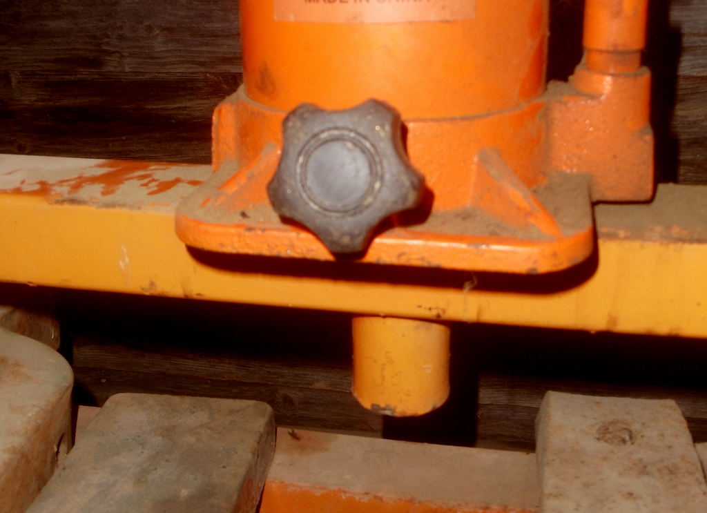

    This may seem pathetically simple, but your post reminded me of it. The hydraulic jack release on my 20 ton press had a habit of sticking just enough that I always had to find the jack handle to loosen it. The solution was to drill out an old knob (yes, it's plastic, but it has a br*** threaded sleeve in the center that makes it more durable) to fit the jack release and slot it with a cutoff wheel to fit tight. Filled it with hot glue and slapped it on... tightening or loosening the valve is a one hand operation without looking for the right shaft to do it.

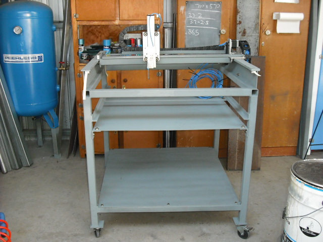

  13. Here is a cnc plasma cutter I am making. Still a bit of work to do but hopefully will be cutting at the end of next week. The table is only 600 x 600mm in total cut size as I have only a small shop to fit it in. I can manipulate the size if I have to when I need to if the need arises.
    Here is a short video of me testing the x, y, and z axis.
    Mtw fdu.

    You sir have exceeded the home made part of this thread! Very nice indeed!

    I hope you are also buying or building a fume extraction system to get rid of the fumes that it is going to produce. Especially in a small shop.
    Otherwise all that nasty stuff will wind up in your lungs. :eek:

  17. Thanks guys for your responses!!
    I am thinking about doing an extraction fan for it.
    I also have a oxy profile cutter which runs with an electric motor and a magnetic tracer...That is ok but you still need a pattern and also allow for the cut size compared to the pattern...hence the plasma table. It will save a lot of time even when I do only 1 part. It doesn't take long to draw it and cut it.
    Cheers again guys!!!

    I think the fume extraction fan is a must. And a strong one at that. The metal vapor fumes off of the high intensity plasma stream as well as any oil residue or anything else on the steel is one of the worst possible things in steel fabrication that you can breathe in.

  23. Here guys is some more progress I have had on my cnc plasma table.
    Still have a bit more to do. Will post more pics soon.

    Here I am a CNC programmer, and I was gonna post a pic of the dent knocker I welded up.
    I'm seriously humbled...:confused:
  25. Thank you very much Ulu...I am actually speechless from your comments. Again, thank you.

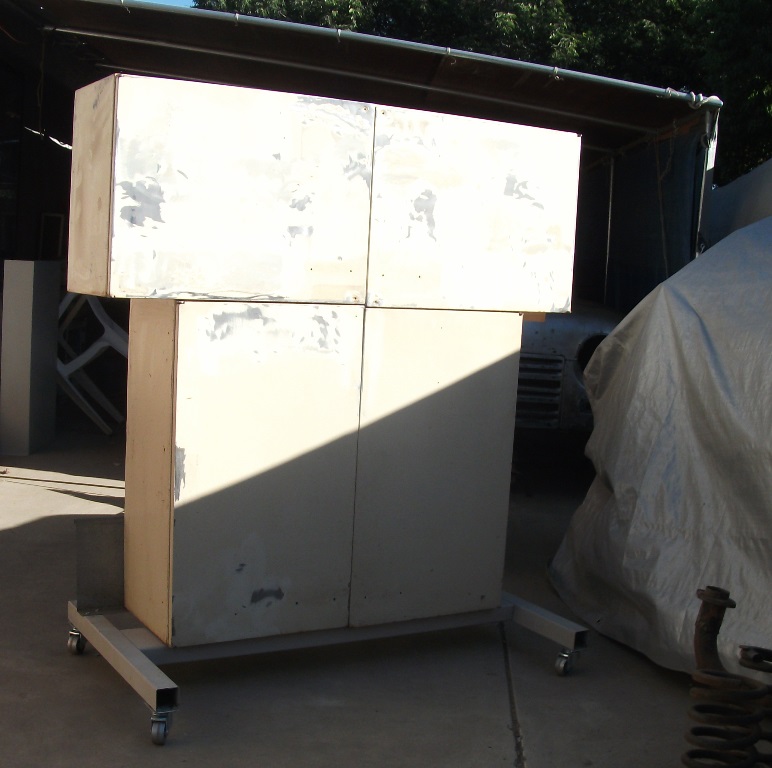

    But you guys are so nice I'll post you some photos of my rolling tool & supply cabinet, made from recycled steel kitchen cabinets & a big plotter base, reinforced with steel angle, lots of screws, several strategic welds, and stamped corner gussets at the main attachments. I lined it with some high dollar rubber mat, & paint is Rustoleum, which was on sale so cheap I bought a case.
    Same paint I used on the torch cart. ;) )
