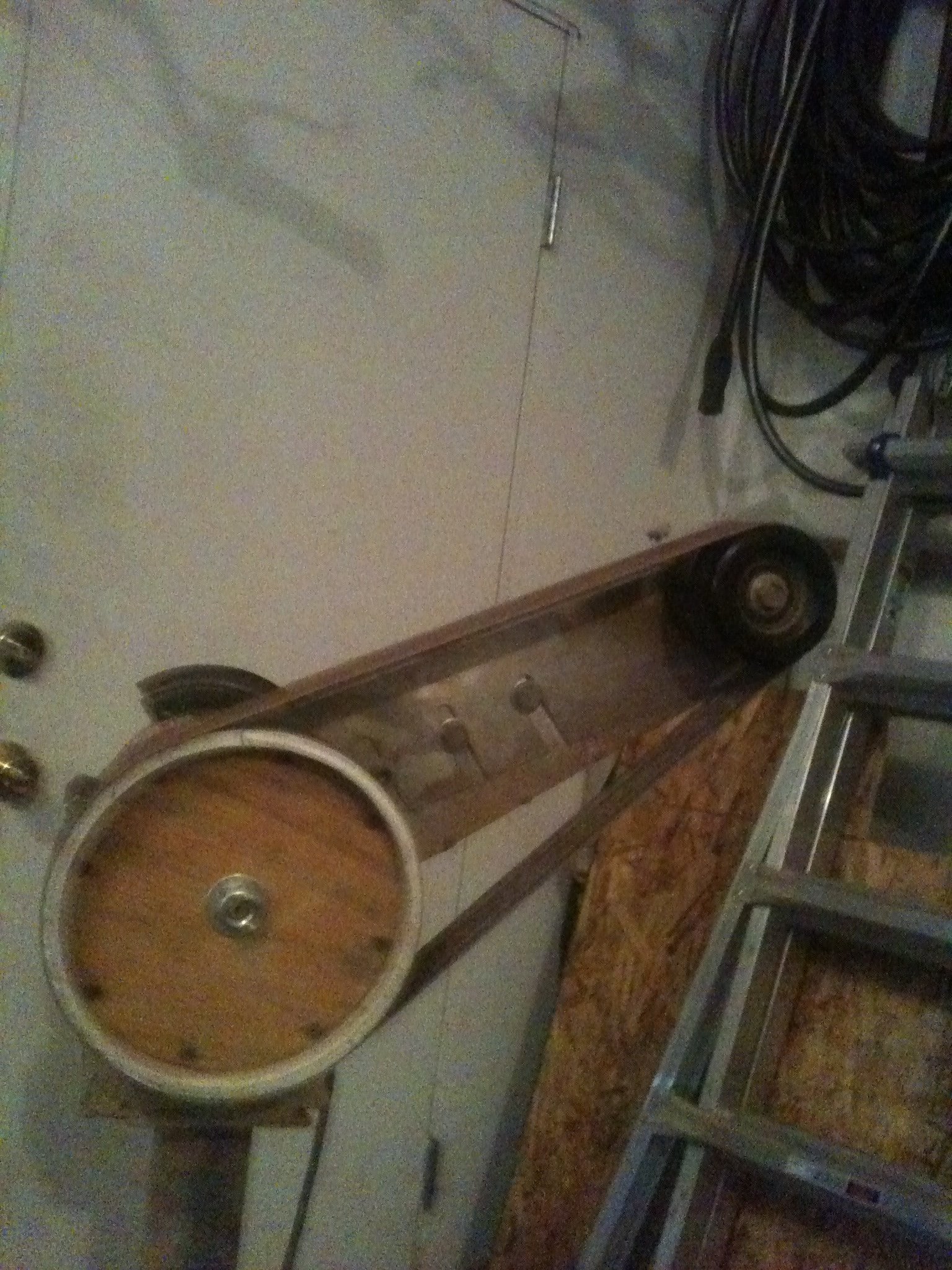

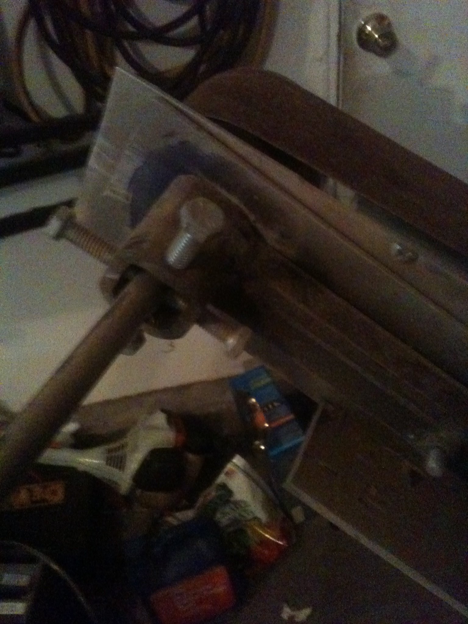

    Here is a belt sander I made out of an extra bench grinder a few years ago image.jpg image.jpg image.jpg image.jpg The main pulley is a pvc pipe connector with a plywood center epoxyed and screwed in.
    The idler pulley is two idler pulleys stacked from a Buick 3800 engine.
    The idler shaft is adjustable in all 4 directions for belt tracking.
    The platen is on top and adjustable for belt tension.

    I'm kinda surprised it doesn't melt.
    I had a belt sander with plastic drums on steel axles & the plastic got so hot the axle just spun in the drive drum.

    It works pretty good the way it is , but if I build another one I will probably use the steel pulleys coated in high temp "rubber" like the factory built units.
    I say rubber because I'm not sure what material it realy is.

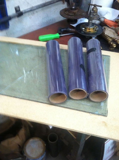

    I do a lot of cabinet blasting and found an alternative and less expensive way to protect the gl*** window as compared to purchasing the cover sheets from Eastwood or TIP. I get a roll of .003 clear plastic film from the art store (40"x12' roll about $12 at **** Blick) and cut the roll into 12" lengths with a saw. I then tape the end of the roll to the gl***, unroll it, cut it to length, then tape the perimeter with
    regular masking tape. Found besides being cheaper, that the masking tape holds better and does not leave an adhesive residue like the double sided tape on the purchased sheets.

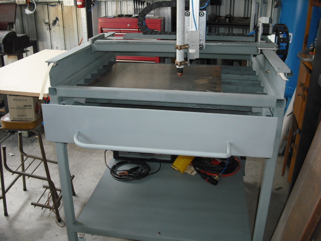

  24. I have finished "building" my cnc plasma table and now am working through some technical issues. I purchased the machine from the US and everything has been set to recognise inches. Here down under we use the metric system and I am now getting my cnc supplier to manipulate the programme he sent me. Here is a short video of it now.
    Hopefully can post a video soon of it doing some cutting.

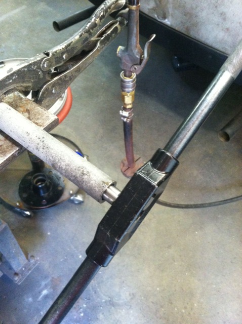

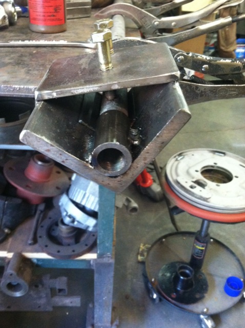

    Here is a little giz I made to help thread tie rods, etc. Don't have a lathe at home and was having a little trouble getting the tap started straight enough especially since the 11/16" taps that Speedway sells (at reasonable prices) are plug taps instead of taper taps. Anyway, drilled an 11/16" hole in a piece of DOM, honed it until the tap fit smoothly thru, welded it onto a piece of angle, added a bar with a clamping bolt. Fits 1"OD tube as is for hairpin bungs and with shims 7/8" OD for tie rods and drag links along with shortened original Ford tie rods. It worked out so well I made another one to fit a 5/8"-18 tap for clevises and 4 bar bushing ends. Just gotta use a good drill and strong grip to open the tubes to tap drill size.

    Here is the plasma table at work. I can't imagine building one. Kudos and I hope you get your bugs worked out. We have our share with this commercial machine.
