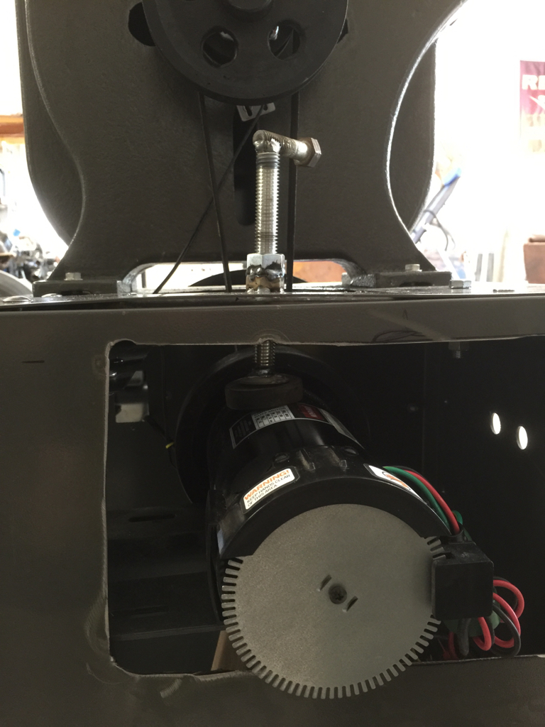

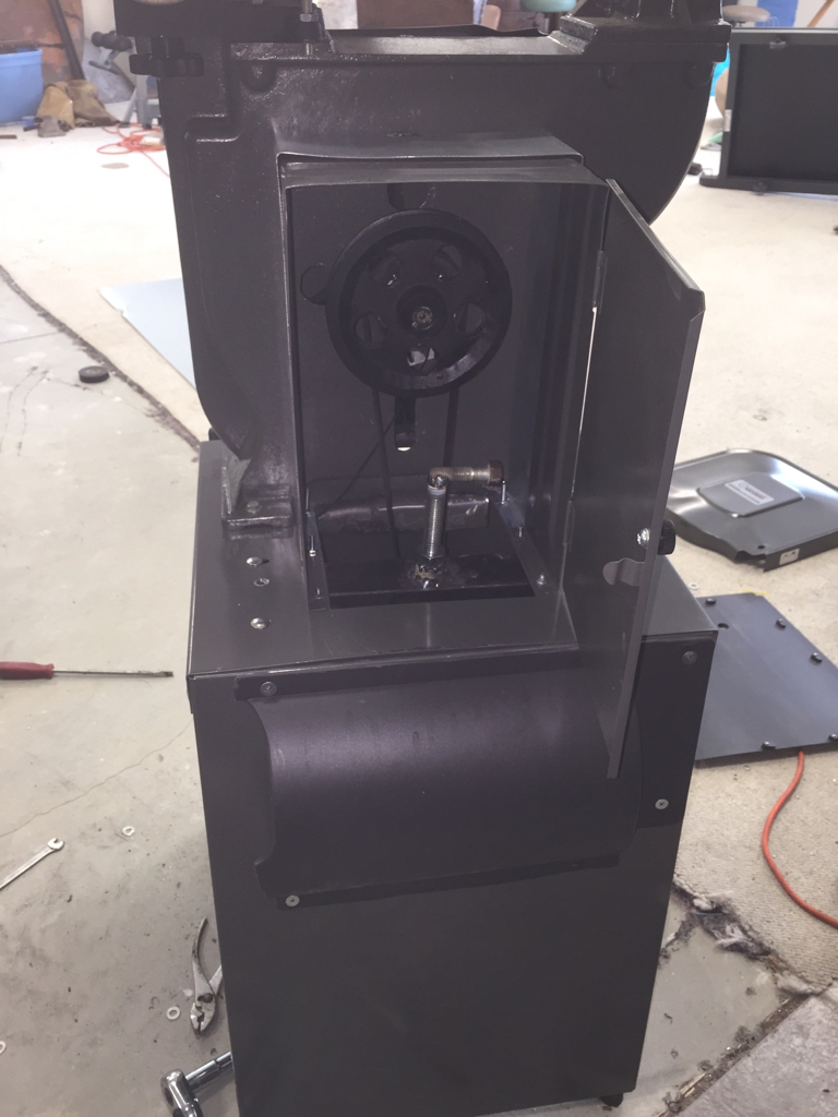

    Got the belt yesterday and installed. Need to add a tensioning bolt to make the belt tighter as the blade stalls under load... Headin to the mancave now to work out the kinks.
  2. I cut some 1/2" plate yesterday. Like ****er.
  3. lowcoe
    Joined: Jan 30, 2008
    Posts: 846
    lowcoe
    That did the trick. Are you using the treadmill type ribbed belts? Mine is a j8 meaning 8 ribs on the belt.

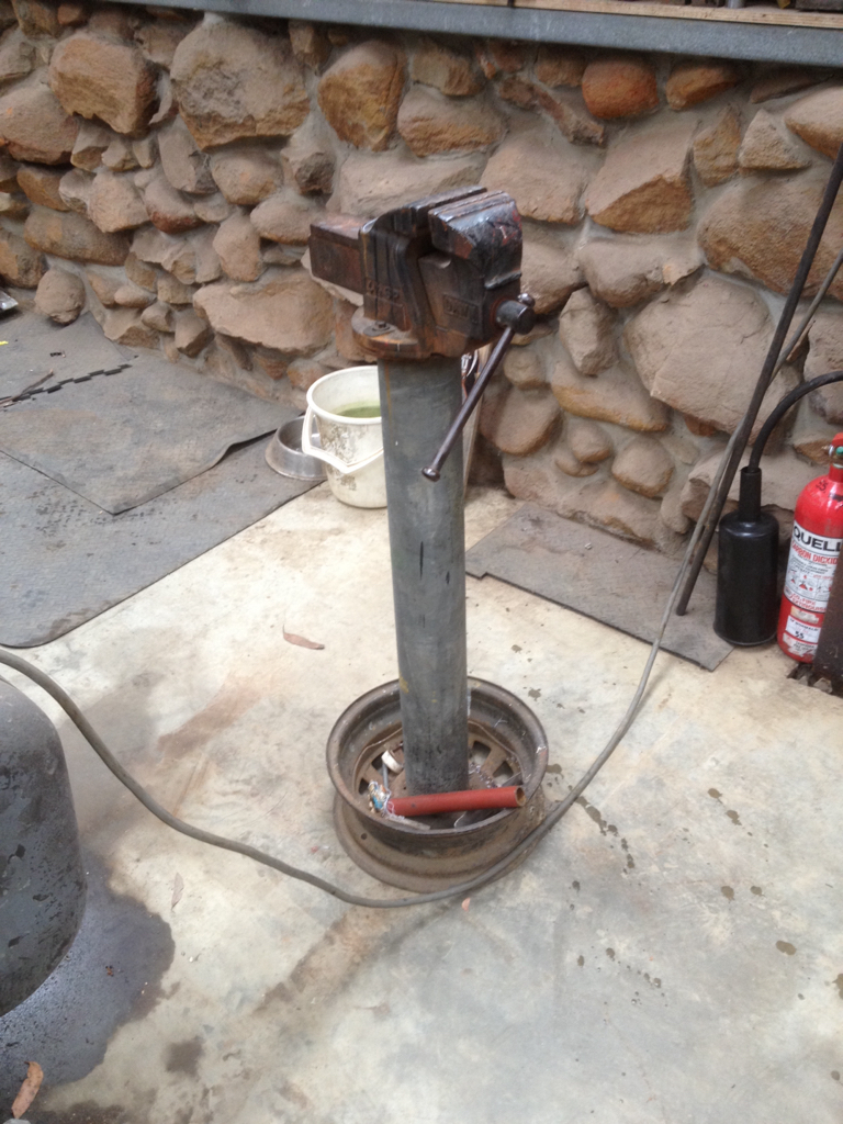

  11. jdownunder
    Joined: Aug 21, 2007
    Posts: 334
    jdownunder
    ImageUploadedByH.A.M.B.1422765138.877878.jpg ImageUploadedByH.A.M.B.1422765164.346559.jpg
    Rims and pipe make movable stands

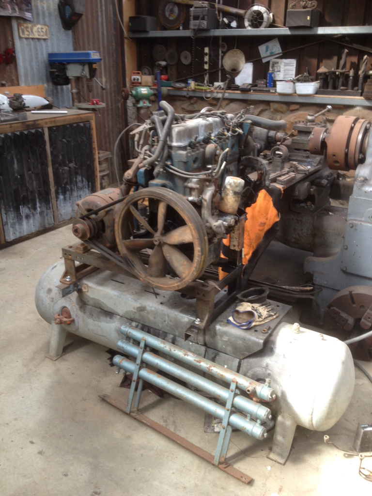

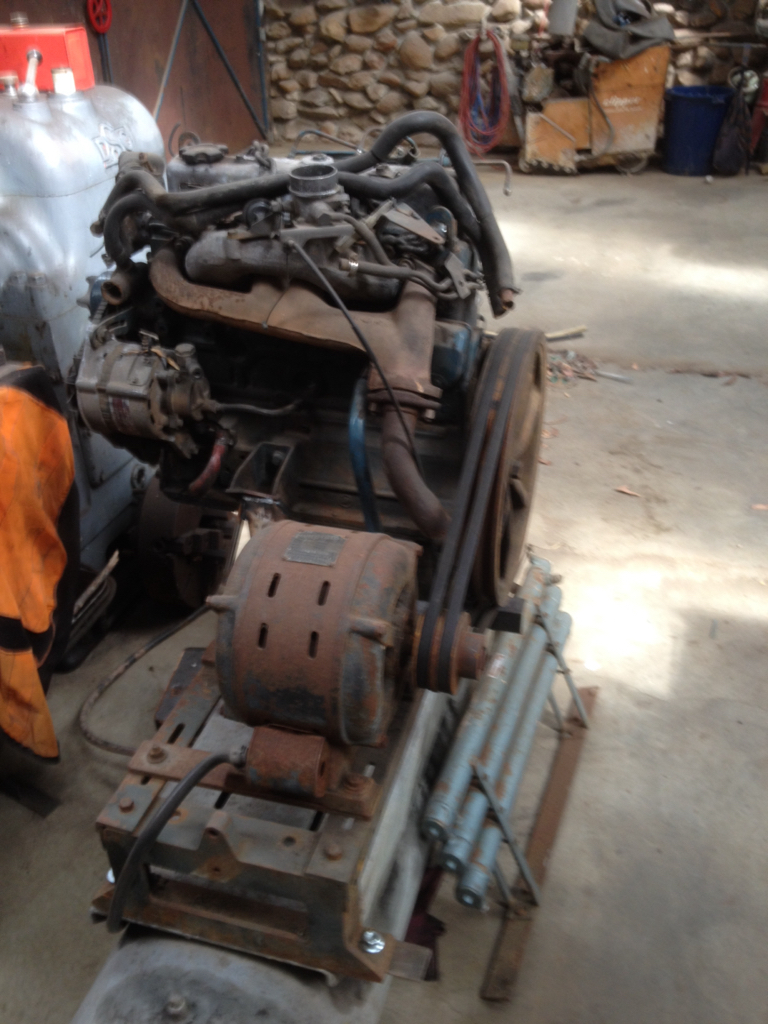

  13. jdownunder
    Posts: 334
    jdownunder
    Check my build thread lowcoe
    I'm two pages into yours dunno who's out of control lol

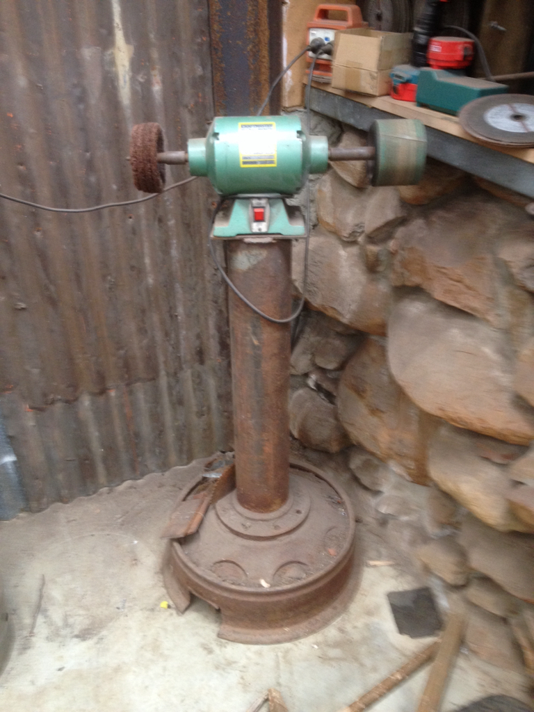

  18. saltflats
    Joined: Aug 14, 2007
    Posts: 13,637
    saltflats
    from Missouri
    The ones we used were AC and we put an arbor on the shaft for a buffing pad and that baby has enough power to throw your part for some distance.
    64 DODGE 440 likes this.

  24. That driven pulley looks small and your blade speed will be high because of that. Also your torque to the blade teeth will be low facilitating stalling at Low blade speed.
    Just a guess. So you up the speed to stop the stalling and fry the blade quickly because the FPM is beyond normal for steel.
    For comparison, I can cut 100 of feet of 18 gauge on one blade if straight cuts. Cutting radii cuts blade life by 50% or more.

    31 digesting your build thread. Delicious. So driven pulley is the one not attached to the motor? The pulley attached to the motor is very small maybe 1 inch in diameter. The one attached to the saw is maybe 3.5 in diameter when it Boggs down the small one spins. I'm guessing larger pulley equals more surface area , more grip and less slipping, equaling more torque.....
  28. ago
    Joined: Oct 12, 2005
    Posts: 2,198
    ago
    from pgh. pa.
    Yes, the driven pulley is the one on the saw. To cut steel you need a much bigger saw pulley. A better solution is to use a counter shaft or jack shaft, with a small pulley on the motor and a big (12")pulley on the one belt end of the jack shaft. Then a small pulley on the other end of shaft then a large Aprox. 12" pulley on saw shaft. Tread mill motor would be a very good solution. You have to get the saw RPM much slower to cut steel.
