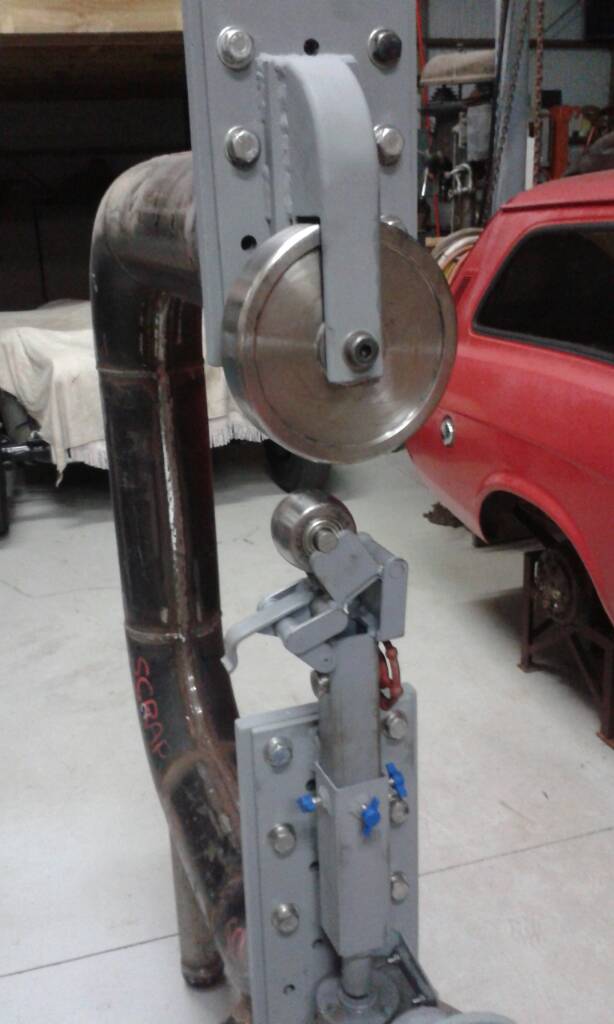

    I have just finished my wheel. It has been a few years in the making. I needed it for some upcoming work on my 39 Coupe project, so had to get it done. I am pretty darn happy with the results. I have a quick release set up on it. This enables me to release the job from the wheel and reinstate it to continue working with out changing the tension. It also means I can take out a piece with flanges on the edge or swages, without having to wind the wheel all the way out of the way. The reduction box also makes adjustment very easy and fine. The frame is left over s**** pieces of pipe from the s**** bin at work. The bends were being thrown out due to a lack of paperwork! I wasn't needing paperwork for my job! I split the pipe and bends to put a flat spine right through the frame, then welded the pipe over the top. The plates top and bottom are 1" thick, drilled and tapped for fastenings. The plan is to use the frame for may tools, just by bolting on the appropriate heads. Plans for a plannishing head, louver press etc are forming in my grey matter already.

    ^^^^^^^ Way cool!

    I just found the flat lower wheel in a box with the other ones. I used it to align the two wheels a bit better. Just a little shim material in behind the top wheel mount and it is pretty damn close to spot on now! I took the opportunity to wax all the wheels to protect them from our humidity. Everything tends to rust if left uncoated.

    Nice wheel, Woodbox. Those ****** estates are fetching a fortune now in the UK.

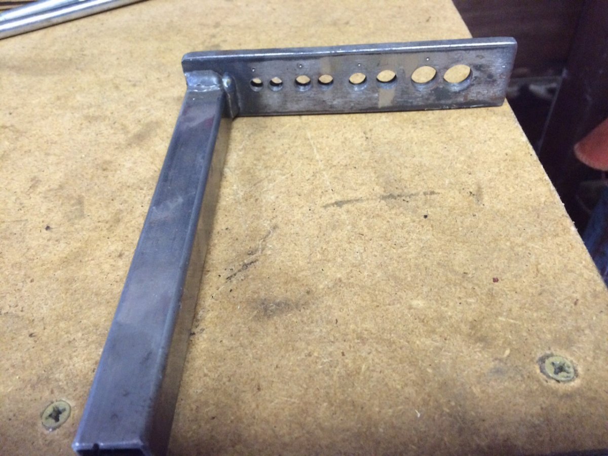

    Combined a U-bolt, a piece of bar stock, and an old drill index and mounted it on my drill press column.
    Not so much a tool; but it sure is convenient and helps keep track of at least that set of bits.
