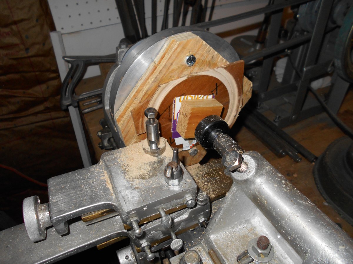

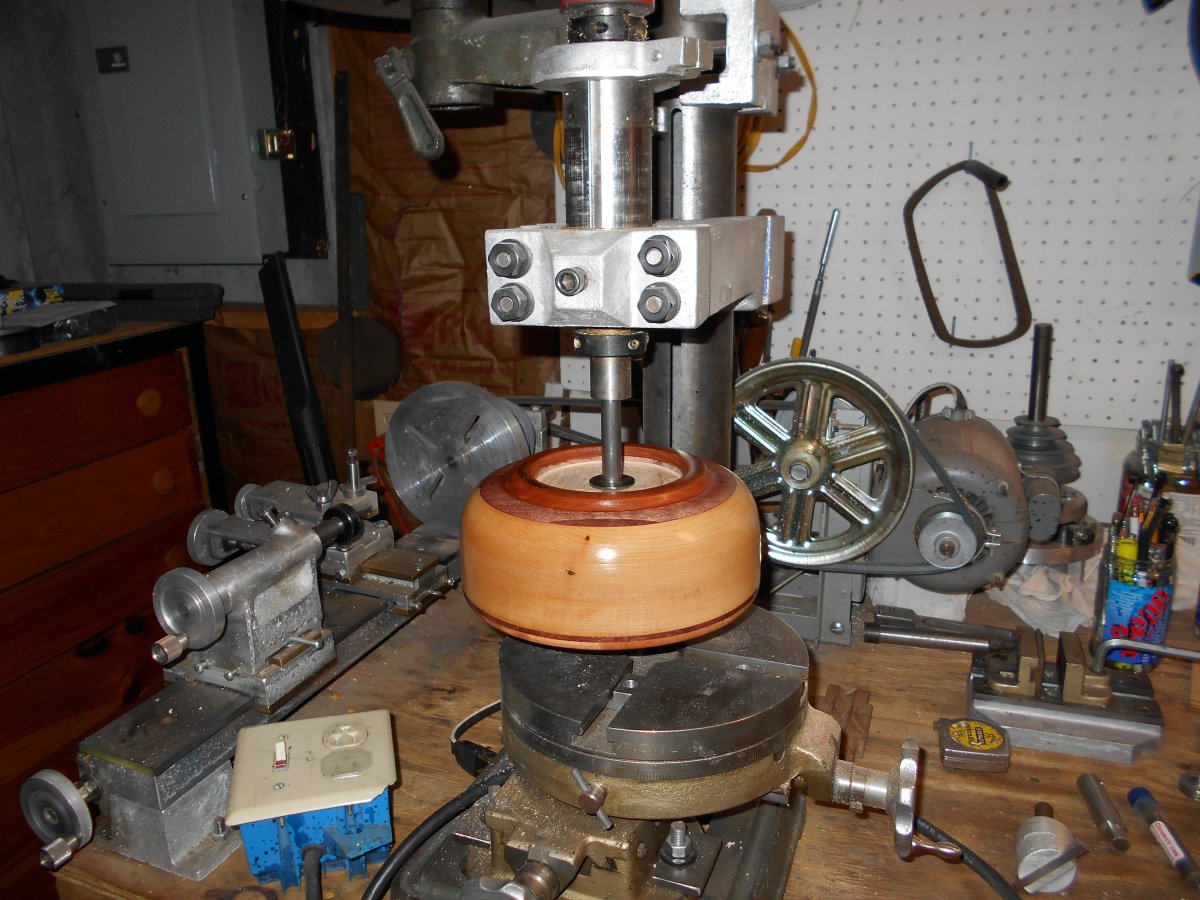

    I built my own lathe based on Dave Gingery's Shop From S**** series, using his charcoal-powered foundry to produce aluminum castings. I later took a cheap throwaway drill press (5/8" chuck but a low speed of 700 rpm????) and cast the parts I needed to convert it to 12 speeds with a low 40 rpm spindle speed and cast/machined a milling attachment and a variety of cutters. I've cast and machined all kinds of parts and materials with them; the pictures show a beautiful block of maple my neighbor gave me when he moved...I added some cherry and purple heart to it, machined it into a bowl and sent it to him.

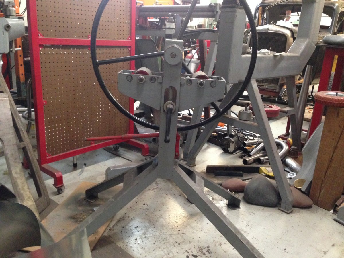

    Here is a pic of an old strap roller I picked up..Has three rollers all connected by gears..Not a slip roll so whatever you roll has to be able to spring apart..

    Or you cut it and weld the halves.
    We had a mondo horizontal slip roller at my old job, but if rolling I-beams & flanged sections, they trap, so to roll a full circle, you must cut it loose.

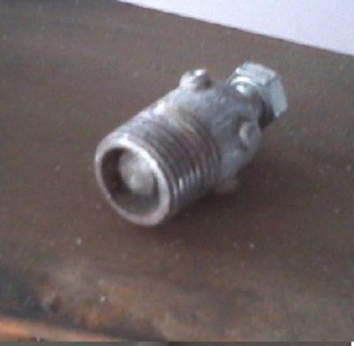

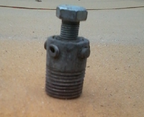

    Here's a real quick & dirty job.
    I needed an A/C clutch puller at 11:00 PM one night.
    The clutch has straight pipe threads, or close enough to screw this hacked-off ****** into,
    There's a 3/8" bolt, and the nut is ground a tad then jammed inside with a big hammer.
    Four impromptu set screws secure it.
