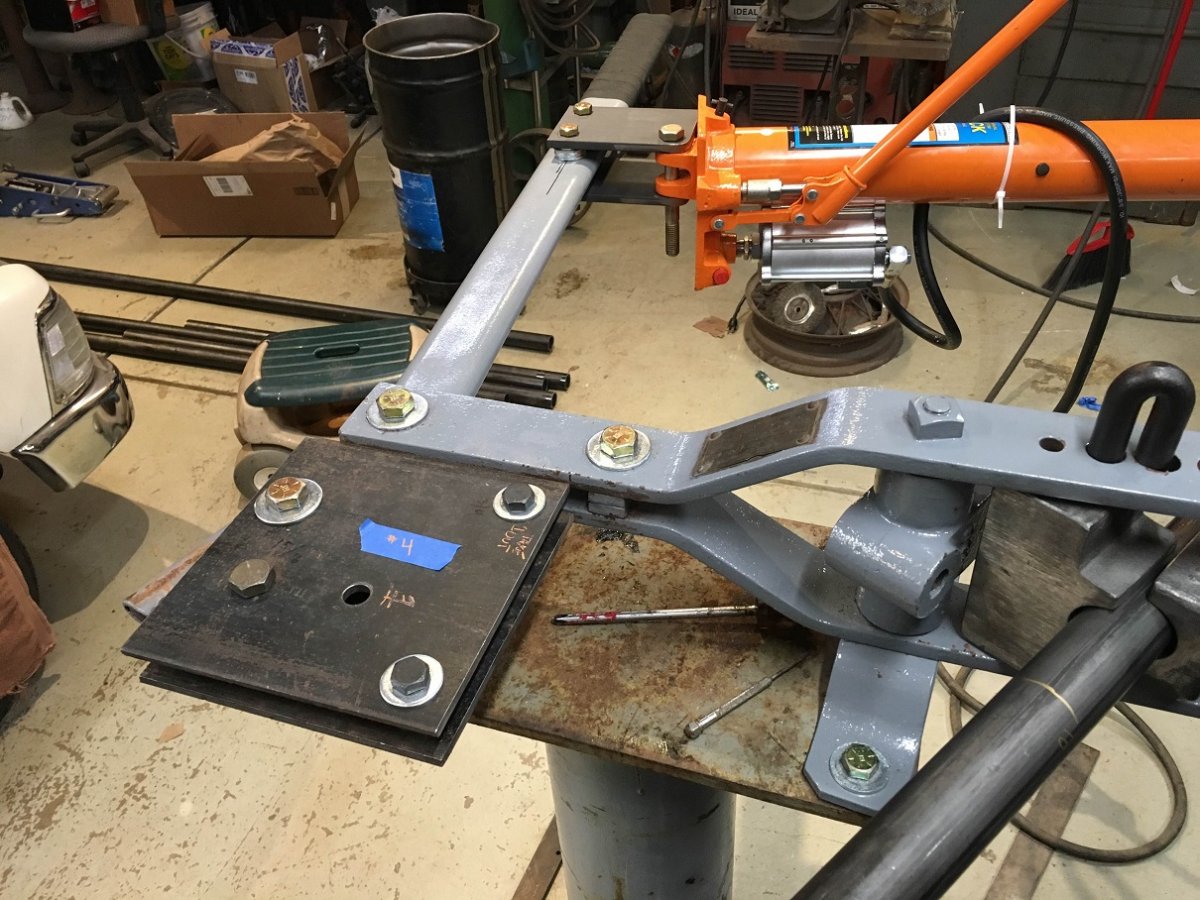

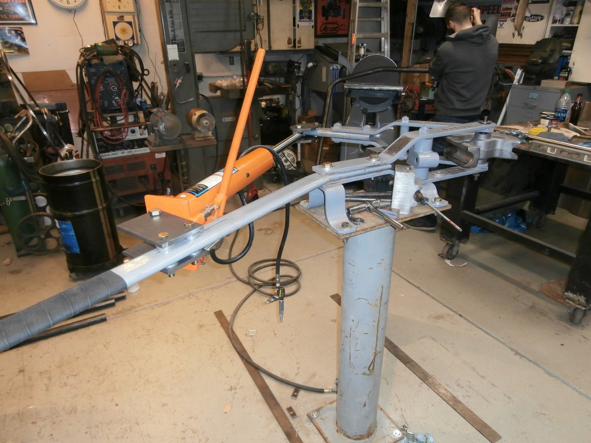

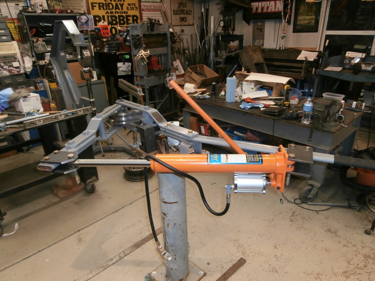

    My son needed to bend up a rollcage for his OT truck. I have a Hossfeld #2 with some dies but not the one he needed. He sprung for the correct size 1 3/4.Tube is 1 3/4 .125 wall.After anchoring it to the floor real good we gave er a try,no dice.Not enough mustard to get it done. So we decided to put some power to the thing and hopefully that wouldnt cost more than the bender.Priced out ready made units,no way. We dont do enough tube to spring for the gold.
    After watching videos,blogs,etc and trying different setups,we decided on the following and it works good.
    Took the handle off swing arm and bolted to mainframe. Made up 3/8 brackets and used a air ***isted engine jack from HF(will pump sideways...the hand pump model will not!)On first stroke we got just under 45.Rebolted handle and made up another mounting bracket.Takes four resetups to do over 90 and is a bit time consuming,but one picture shows first bar.I can post better pictures if someone wants them.We have a little over $200 in jack,bolts and plate.No welding or torch work. Just drill press,coldsaw and bandsaw

    I did something like that on a bender that I made. The only difference is that I used a high lift bumper jack like the off roaders use. The air jack may have more power as the bumper jack was limited to how hard I could pull the handle.

    I will get more pics of the other brackets posted so it all makes more sense

    More pictures.We used the handle figuring it would save time and wouldnt bend.Worked fine.The pictures show position 2,3,4 of the other plate needed. To get it bolted up we removed the inside bolt on the handle and rotated it.The plates have a spacer inbetween to keep them from collapsing or spreading.It rides about a inch in step two till the pivot force catches up with it and pushes more squarely,if that makes sense.

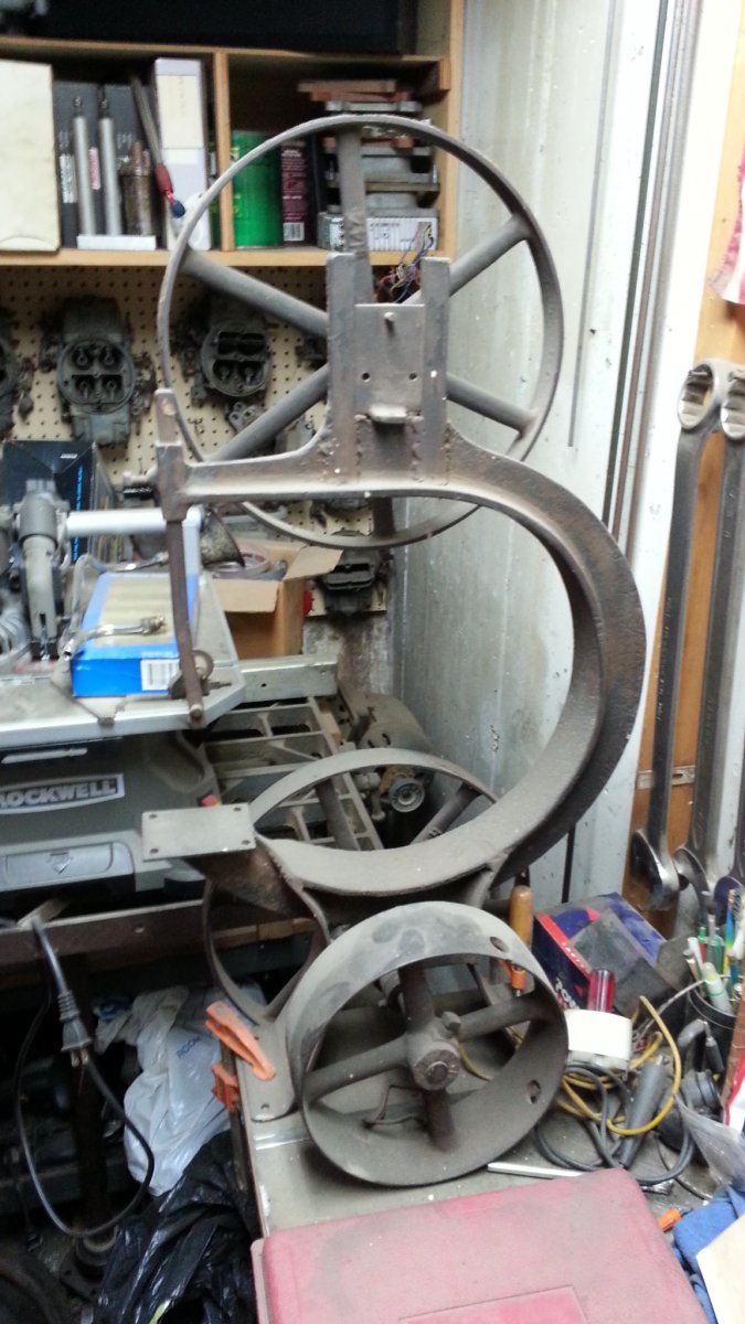

    Here's my Grandads ban saw that he made way before I was ever a thought.

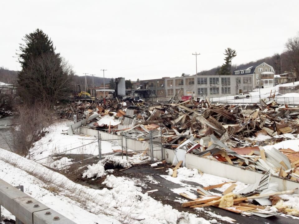

    The saw is too small for the wood beams I have. I bought the framing from a demolished lumbermill and the beams start @ 12" X 12" and go to 12" X 18" most are 20 feet long. I end up using a chainsaw mill to cut the beams. Besides the band saw has to tall a table to be useful. Blade length is 137" so blades are all custom.

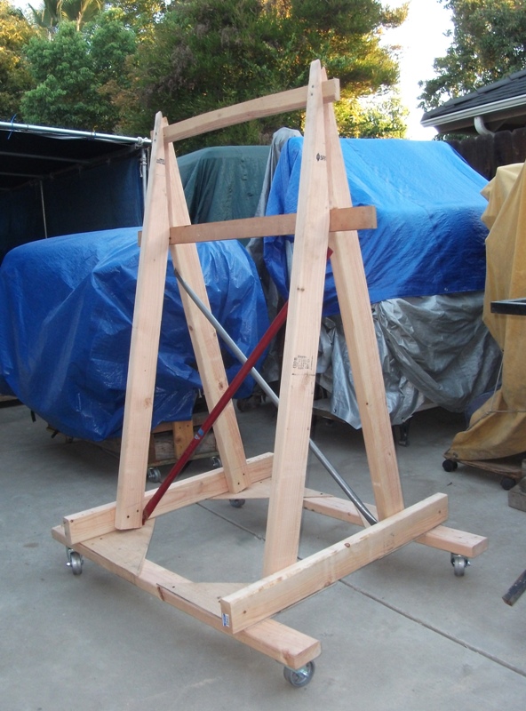

    I used to work in a vending machine factory. We had dozens of carts just about like that to move & store vending machine doors in-process.

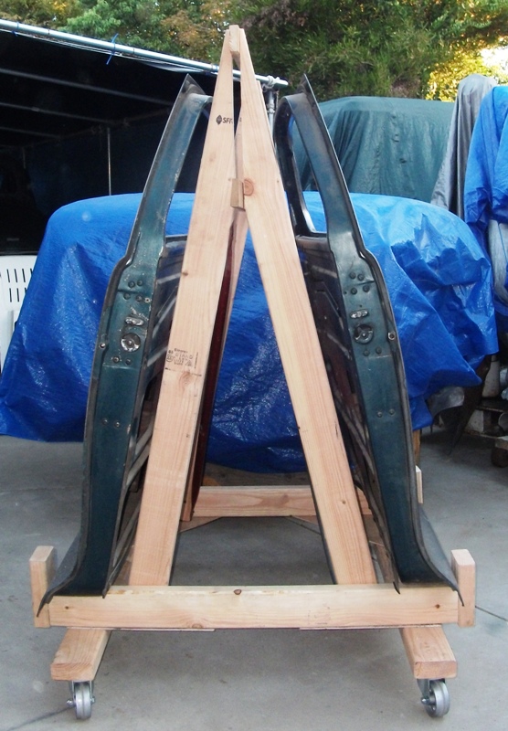

    This is what I built to store, move, & work on the doors for my Plymouth.

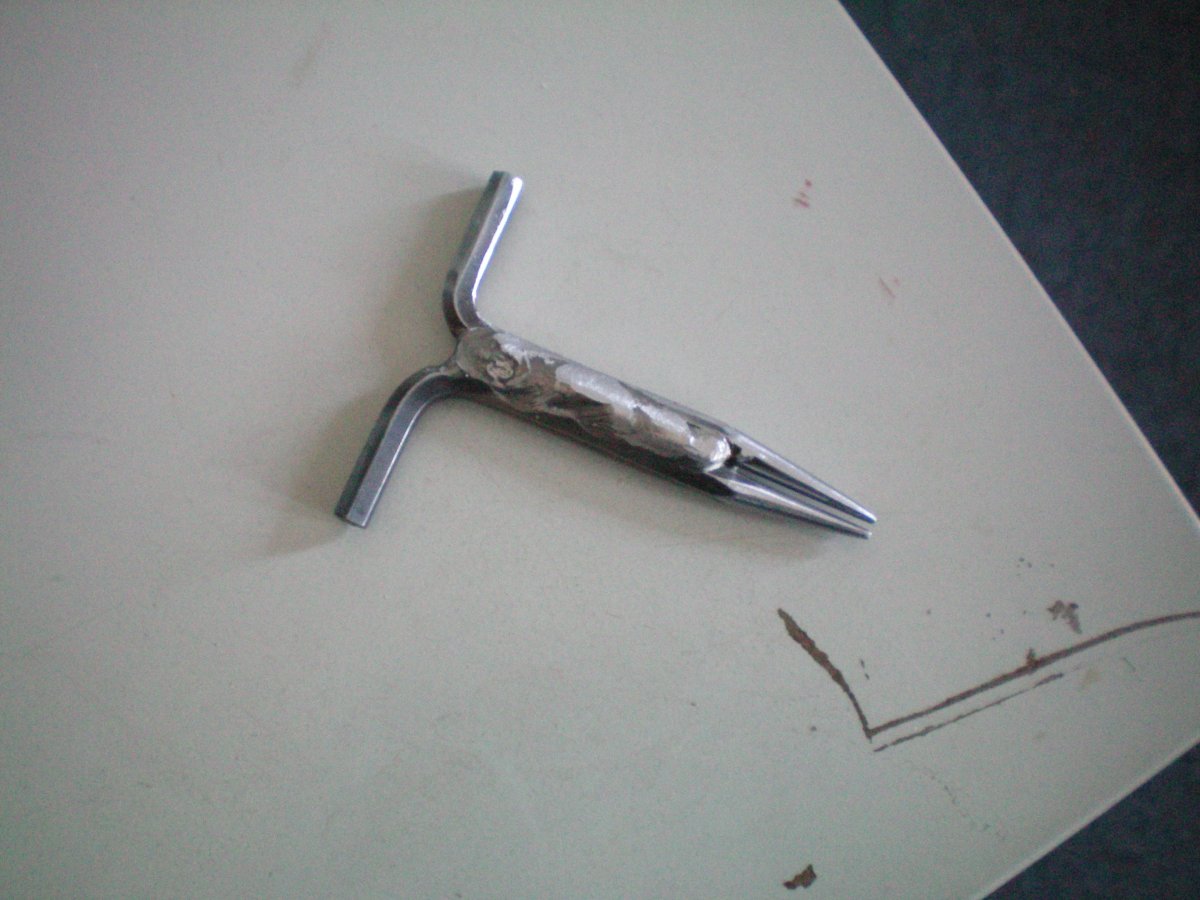

    006.JPG A sheet metal tucking tool I made from 2 allen wrenches,the toughest material I could think of that I had on hand, welded back to back.

  22. Hey Blue 49 I am at a loss as to how you use this tool, do you have a couple of Pic's showing what it does.

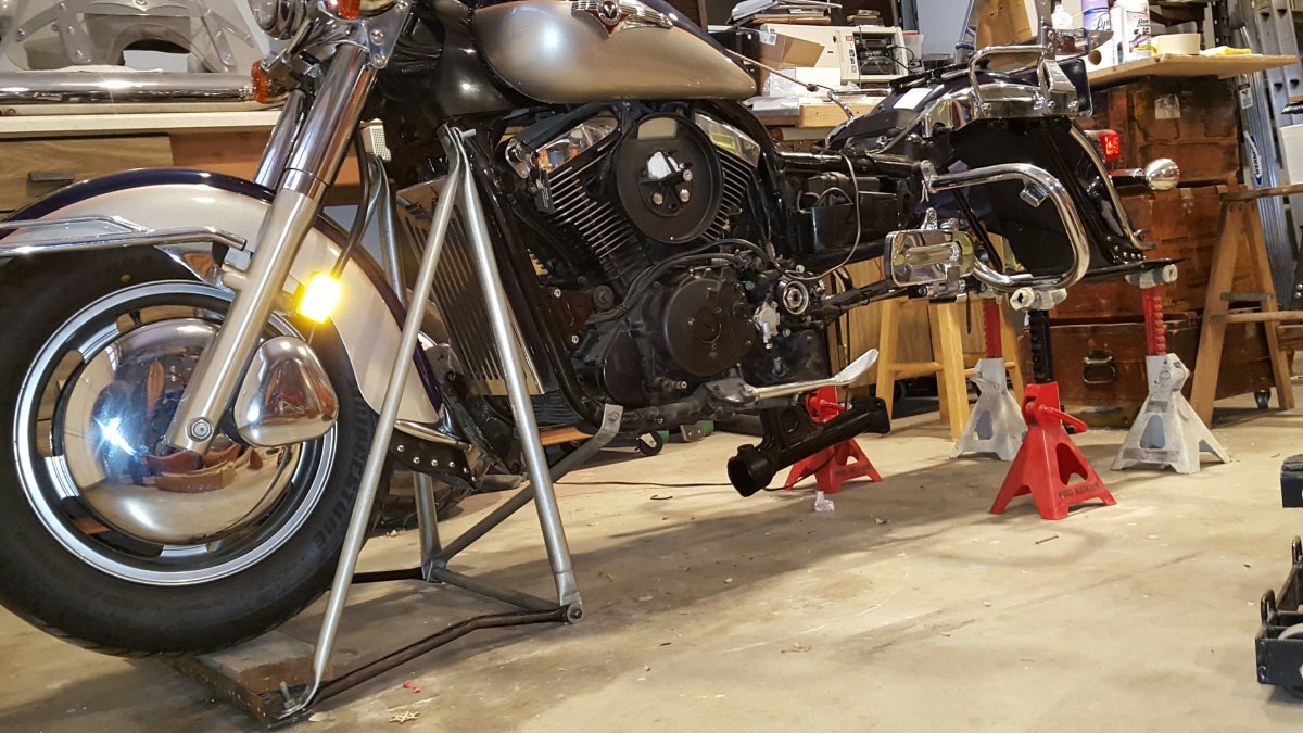

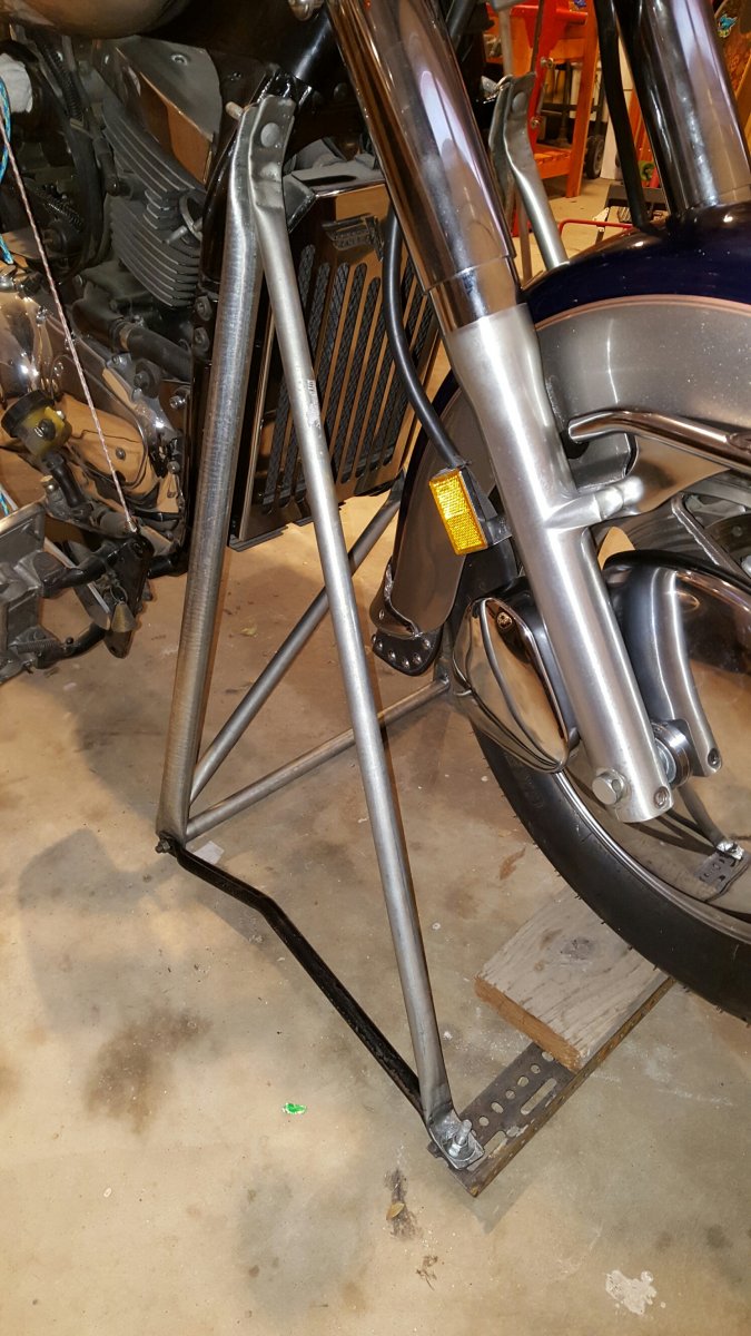

    I had to take the gearbox apart on my bike, so I built this quickie stand out of old junk and some galvanized conduit. You can see I just mashed the ends in a vice & drilled a few holes.

    Here's a guy using a tuck shrinker. A bit different, but the same idea.

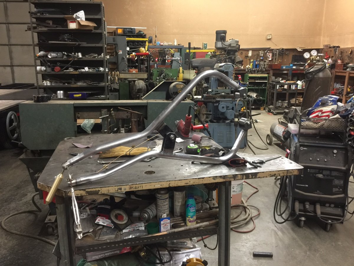

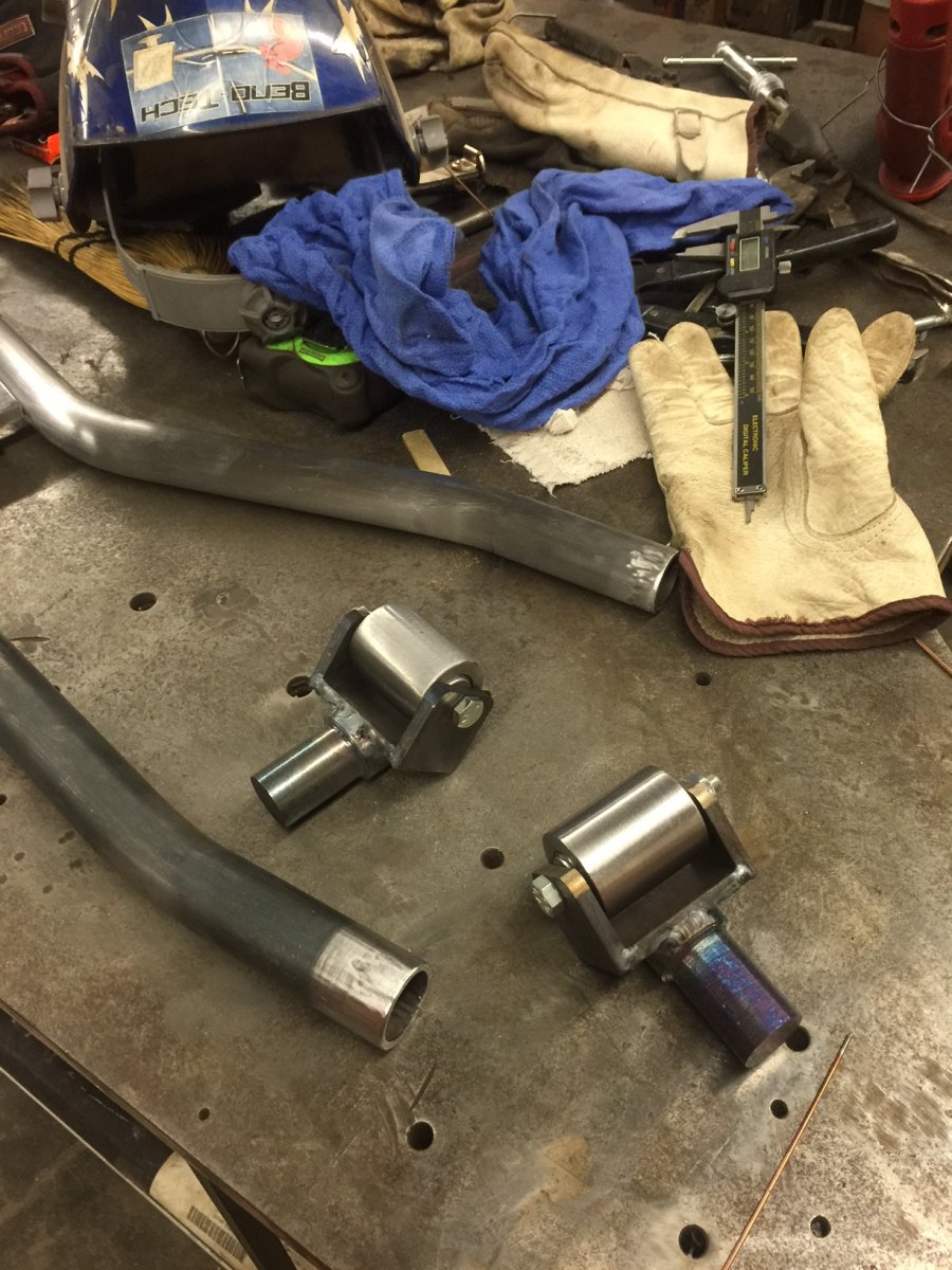

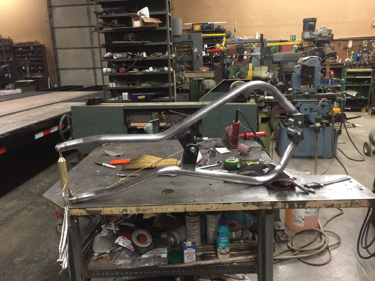

    I spent a little time at the shop over the weekend and made a hand held english wheel sorta thing. It will allow me to take the wheel to the panel without removing it. I machined all the end "bungs" as well as the turnbuckle. Made it out of a hunk of br*** and then knurled it so that you can easily hand tighten/loosen the wheel. In the pick the one end is not yet tapped as I was waiting on a 5/16"x24 Left hand tap for the heim.

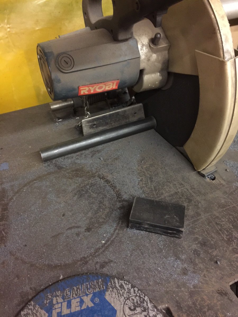

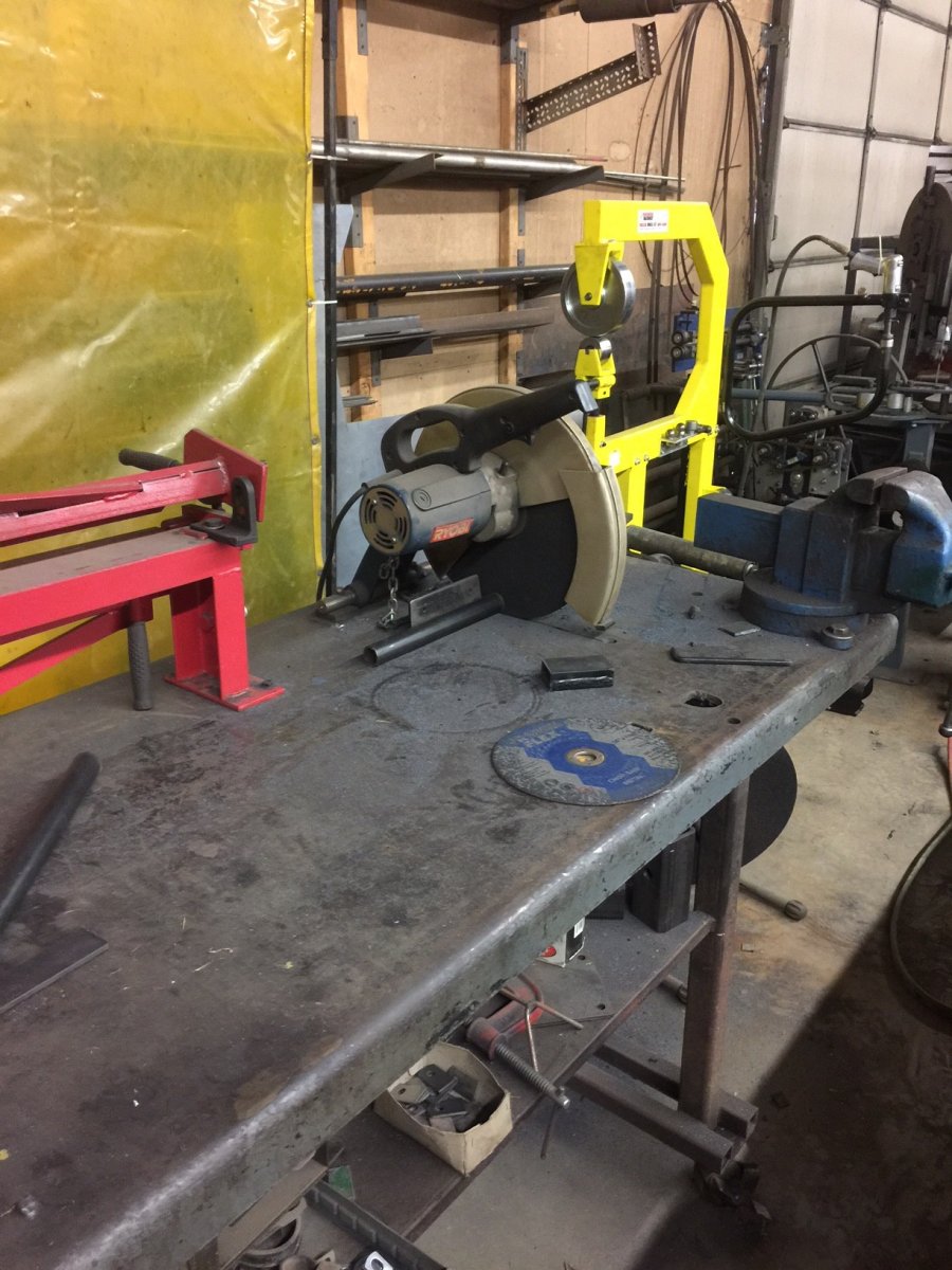

    Here are a few other modifications I made to some of my machines and tools. First is one I posted a long time ago but now have a better pic. It is basically a pic of my chop saw mounted into my 13ft table. Stock can just lay flat on the table and be fed into the saw and cut without having to prop it up.

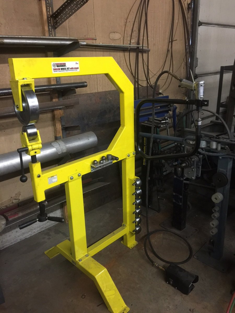

    A pic of my HF E wheel that actually works VERY well but the reason it is in the pic is my planishing hammer I built is mounted 90* to the wheel. It can come off and be hand held as well.

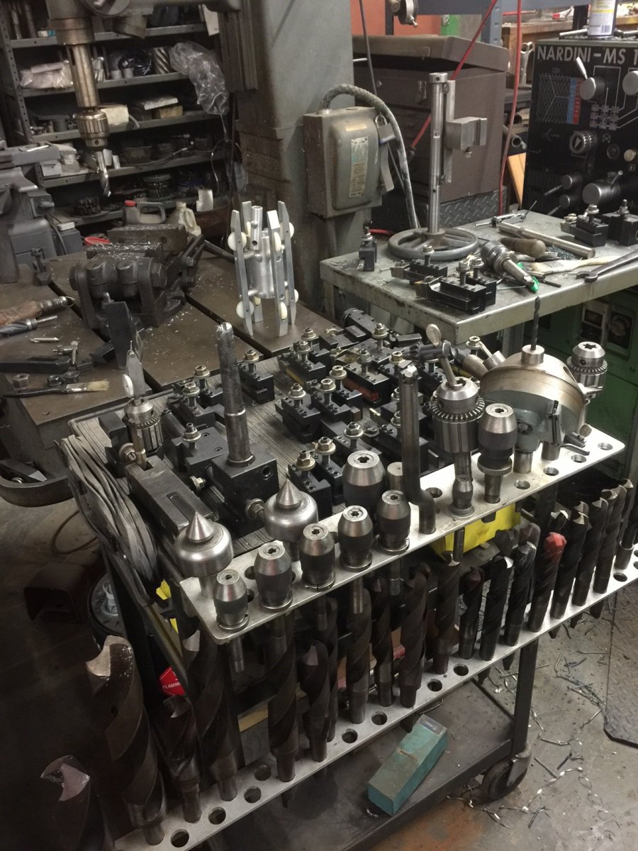

    A pic of my lathe tooling. I used an AV cart and machined a big piece of aluminum angle. Holds all the MT3 taper tooling and then the QCTP holders simply lay up on top.---Extra credit for whoever can figure out what that "thing" is in the background that has little white wheels around all 4 "sides."

    Jack,
    The white thing looks like it might be a stock puller for light tubing ?
    I notice that you added an "r" on the end of lathe.
    I do that more often than not....for some odd reason, the finger jumps up to the letter "r" as if to finish the word. IDK
    Incidentally, did you win big at an auction? There's quite a cluster of Albrecht chucks in that tooling rack.

    Thing with the white wheels looks like a truck for running a camera down a pipe

    Rich B wins the prize! That was one left over. I used to make those for a plumbing company that sold specialized cameras and other weird stuff.
    Gatz, I do that all the time by adding the "r"to the word lathe....
    As for the Albrecht chucks, I actually paid dearly for them on Ebay. They are worth every penny though. I have used virtually every brand chuck and Albrecht is the cat's ***. The one thing I DID win big time at an auction is the Leland Gifford drill press that the "pipe skate" is sitting on. Believe it or not that machine was $10K and it is in EXCELLENT condition. Paid $150 :)
