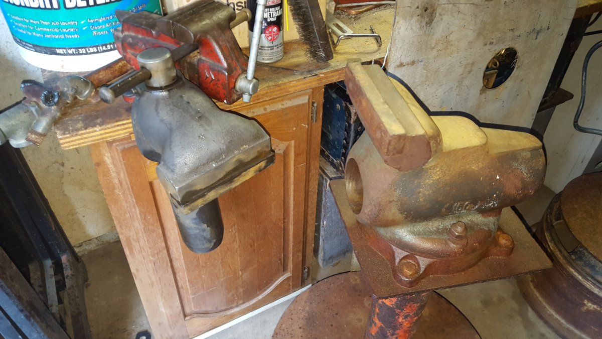

  4. Ulu
    Joined: Feb 26, 2014
    Posts: 1,775
    Ulu
    from CenCal
    I think the vise is a foreign copy made from melted down SBCs and Fords. Still no marks found but the screw was not rusty inside, and the castings are m***ive. I stuck the jaw in the derusting tank this AM, for a preliminary dip. I'd say this vise sat in a pole barn for 30 years, but didn't see a lot of use. It's not beat-on, and there are only a few welding scars. It's sun-baked more than anything.
    The Baldor is as well, but it is so smooth! It takes forever to spin down.

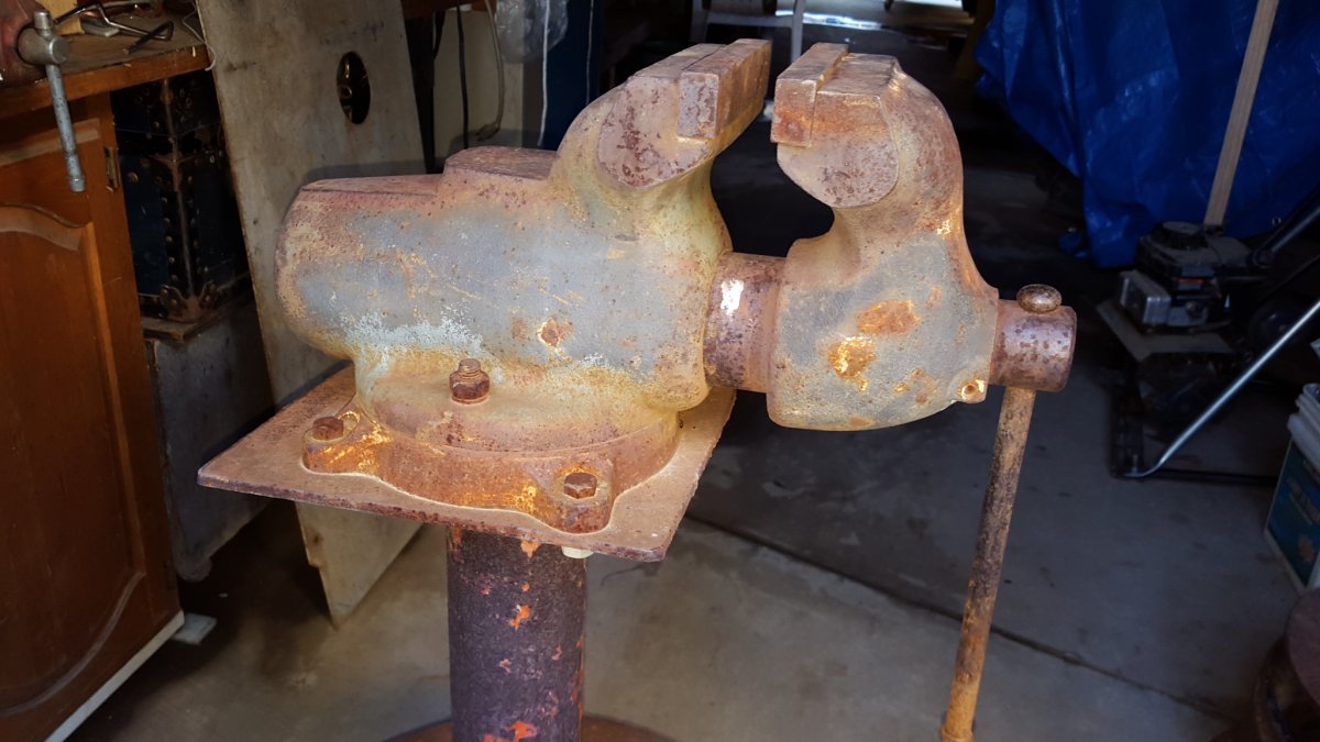

  8. Ulu
    Posts: 1,775
    Ulu
    from CenCal

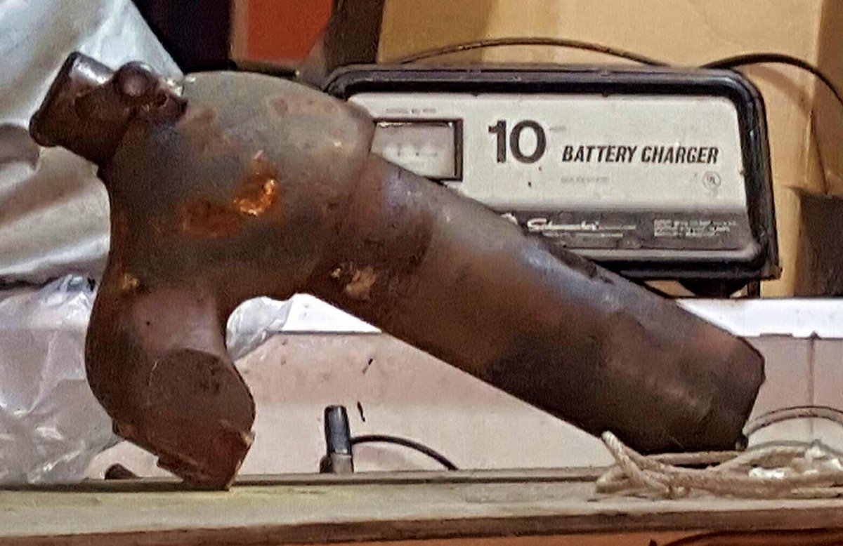

    Well this thing was pretty Rusty and the stands are even worse. They're not going to fit in my de-rusting barrel.
    I ran the jaw of the vice in the De-rusting tank for two days, then took it out and scrubbed down with white vinegar and a brush.
    Finally I wiped it down with a fresh g****fruit, rinsed off in water, hung it up, dried with an air hose and squirted it down good with WD-40 rust preventative.
    Before.
    After.
    The body of the vise is in the de-rusting tank, and now bubbling away merrily.

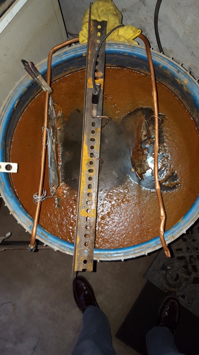

  9. cowboyinachair
    Joined: Nov 17, 2010
    Posts: 352
    cowboyinachair
    from colorado
    what is in the de-rusting tank
  10. Ulu
    Posts: 1,775
    Ulu
    from CenCal
    Find the thread on "electrolytic derusting" for the whole scoop, but basically its water and some washing soda; and you hook a battery charger up with the negative side on the rusty part and the positive side on some **** that's going to turn to rust in the bottom of the tank and disappear (your sacrificial anodes) let it run for a couple of days and take it out and scrub it down that's about all there is to it.
    I'm using some galvanized sheet metal as my sacrificial anodes because they make rust transfer very quickly (particularly in cold weather when you need a little help because the tanks chemistry tends to move slow in cold weather.)
  11. Ulu
    Posts: 1,775
    Ulu
    from CenCal
    Thank you, J.A..
    I did go join, and they have some very unusual stuff to show off.
    BTW, no identifying markings whatsoever have been found on the vice so far.
    Pretty certain that this one came up from Mexico as the guy that owned it was a local Mexican farmer, or Vintner as he actually raised g****s.
    Which reminds me I got a case of g****fruit for free and I've been experimenting with g****fruit derusting. Right now all the nuts bolts and washers are stuck inside a particularly sour g****fruit. I'll let you know how it goes.

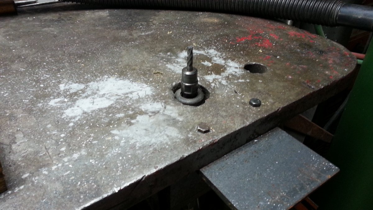

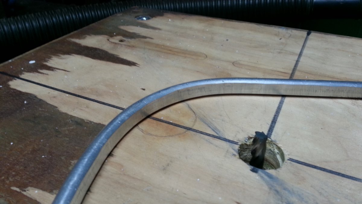

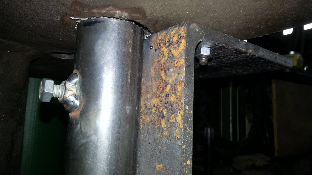

    Okay you may not want to try this at home but I am always trying to make stuff with a stick and a rock because I don't have a mill so most of my work comes at the hands of a die grinder.
    So needing something to help shape parts by hand got me thinking that something to hold the die grinder would be of help so here is what I came up with.
    There was already a hole in my work bench so I found a peace of pipe that my small die grinder would fit in and welded to a peace of angle then bolted to my table and hooked out the grinder with a foot control and did some playing and would say it work pretty good.
    I used a board over the top so I can change the bit without removing the tool from the holder. 20160313_145723.jpg 20160313_145701.jpg 20160313_145846.jpg

    Very cool; a router table for metal working...
  22. slack
    Joined: Aug 18, 2014
    Posts: 544
    slack
    Do it work pretty goood?
  23. saltflats
    Joined: Aug 14, 2007
    Posts: 13,597
    saltflats
    from Missouri
    Yes it does
    Its just like by hand it just cuts one direction

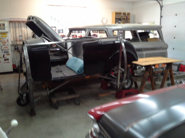

    Rollover contraption.
    For finishing underside of my roadster.
