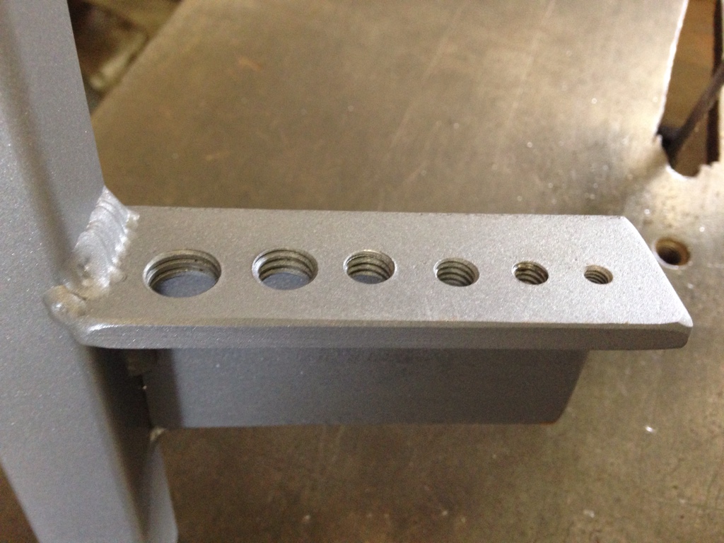

    Nothing earth shattering here, but made this cam bearing tool for the flathead I'm working on.

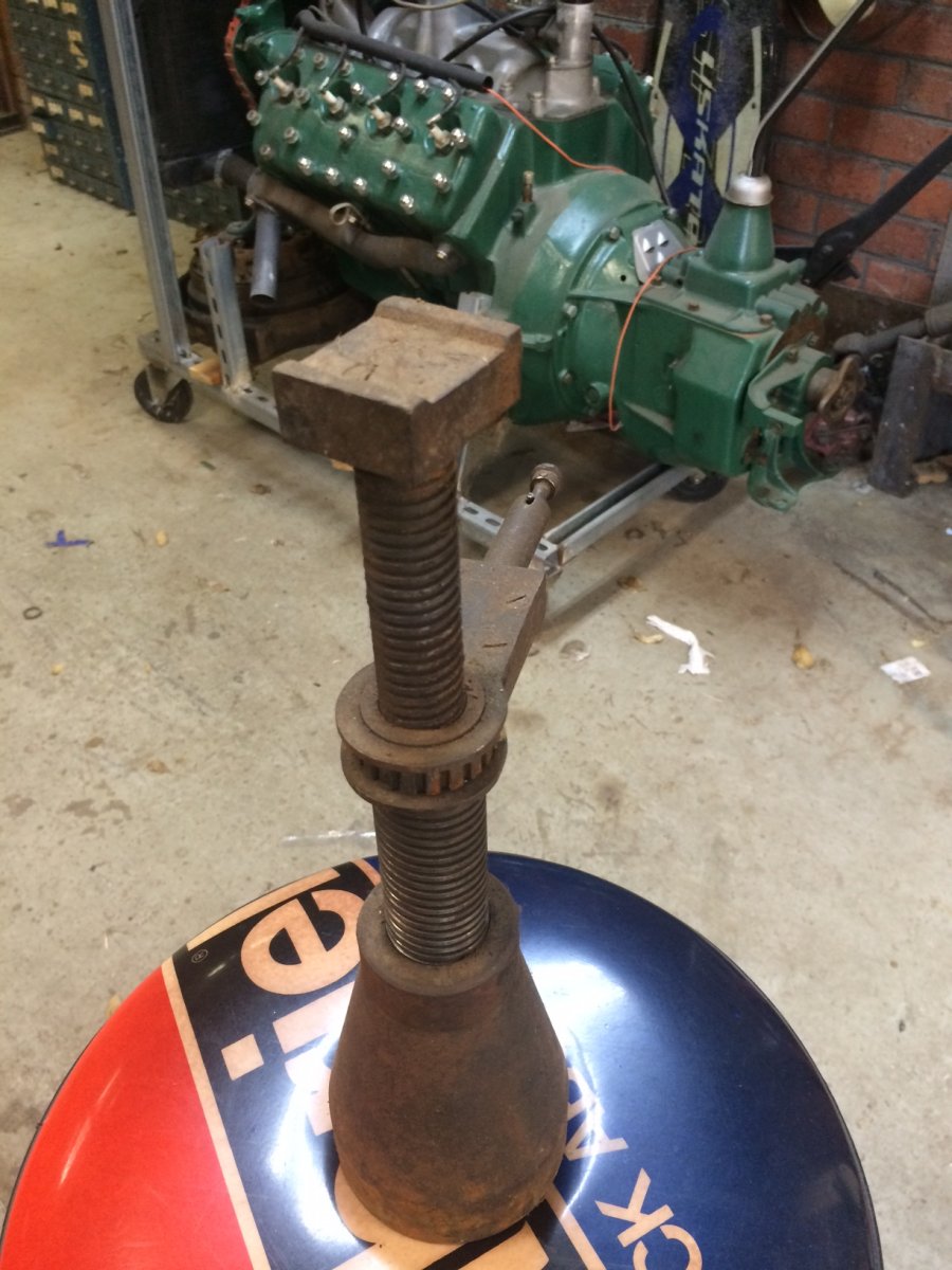

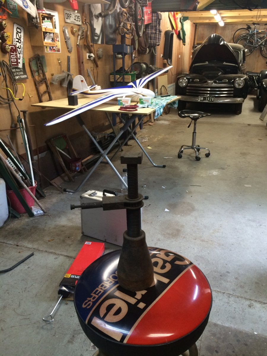

    Found it

  14. 64 DODGE 440
    Joined: Sep 2, 2006
    Posts: 4,433
    64 DODGE 440
    from so cal
    Found it
    View attachment 3170883 View attachment 3170884 [/QUOTE]
    That's a nice looking unit. It deserves to be cleaned up and put on display.

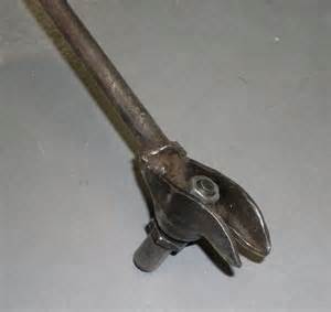

    I was shown this valve spring compressor today. made from a junk rocker arm
  22. Sporty45
    Joined: Jun 1, 2015
    Posts: 1,387
    Sporty45
    Love it! The simpler the tool, the better. Especially when giving new life to junk parts. :cool:

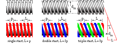

    I wonder if that was multi start thread.
    http://3.bp.blogspot.com/-AnwEQPl8NKg/VBeoCFZIG3I/AAAAAAAAA1E/2EJwr3EHSiY/s1600/multiStart.gif

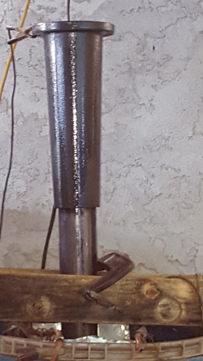

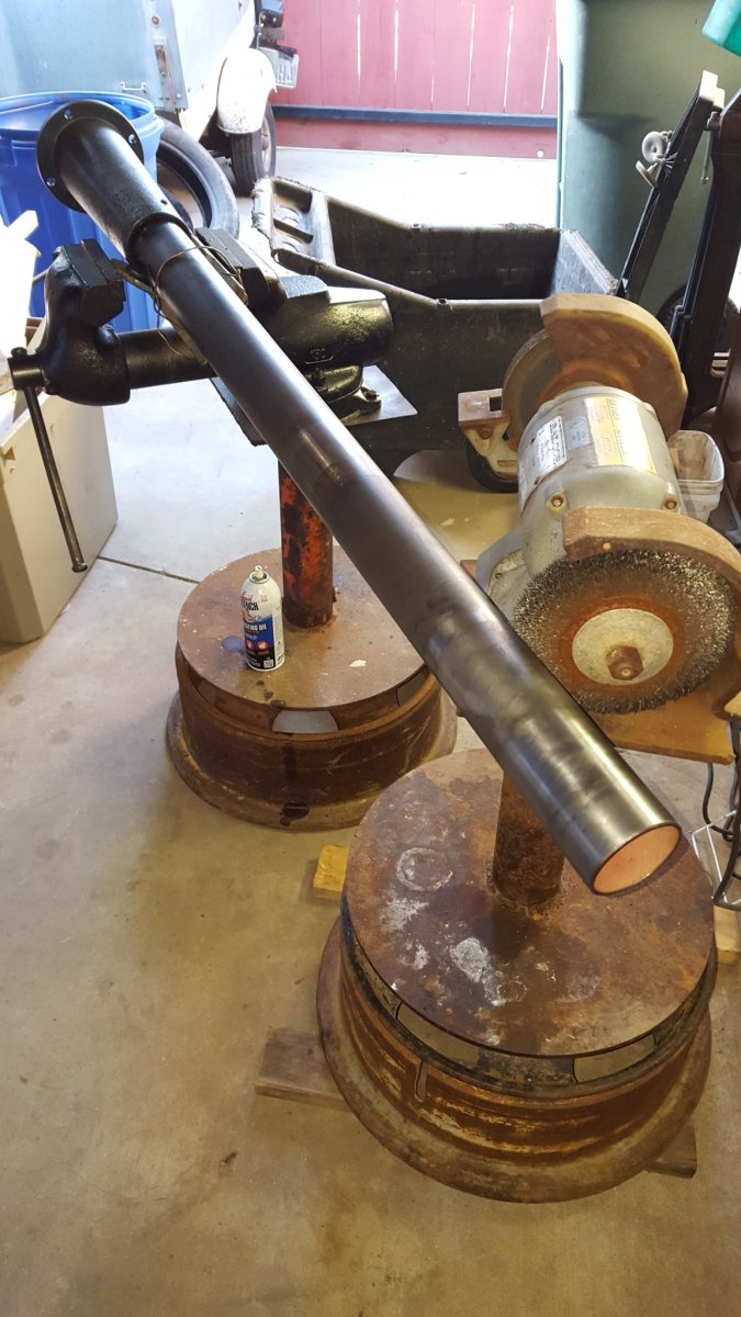

    The guy that gave me the big vise got a hold of this cast iron Baldor bandsaw and a 1960s Craftsman drill press, all of which we are in the process of restoring with my homemade, lo-cost, junkyard de-rusting equipement: an old orange juice drum and some old copper tubing and bits of galvanized tin and bailing wire, plus my ancient battery charger.
    This is after a dip + the Jasco acid wash, scrubbed with a stainless steel brush. The base was a rusty mess but it still had a nice paint on the bottom once that dirt and rust was removed in my tank. If you like machinery, you just gotta love real old-fashioned cast-iron . . .
    The platten was as rusty as the other parts you see.
    Dipping the pole, or should I say, "the gratuitous pole dipping shot."
    Freshly greased, in plastic wrap. The arm and gearbox for the platten, plus fence and small bolts.
    Final burnishing on the Mighty Baldor.
    The head unit is next and then we start painting.

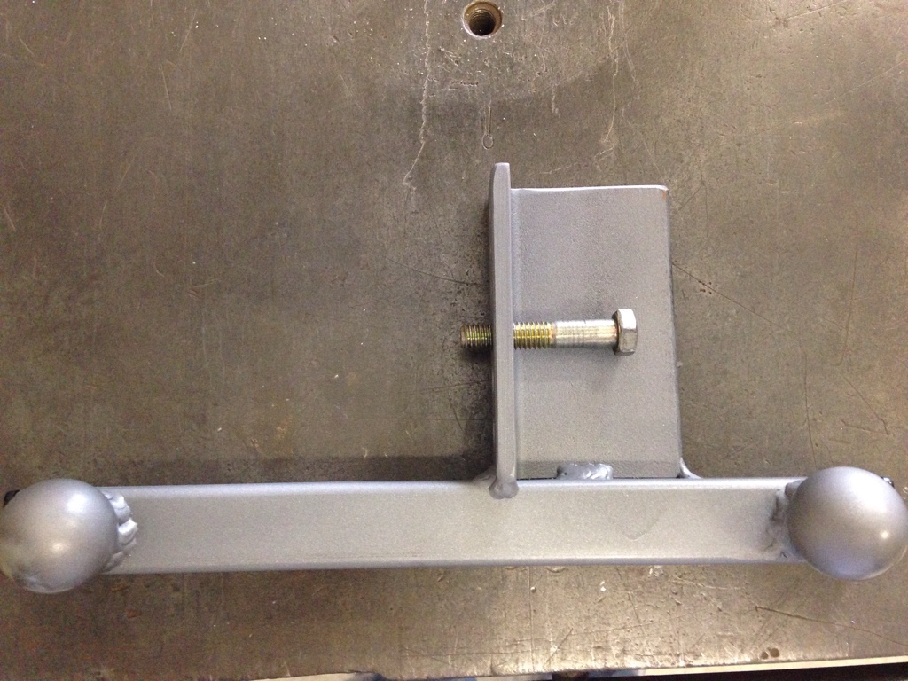

    I'm sure this has been done before. Works well for cutting bolts to length on my band saw ImageUploadedByH.A.M.B.1460149751.779733.jpg ImageUploadedByH.A.M.B.1460149762.862808.jpg ImageUploadedByH.A.M.B.1460149772.378731.jpg
