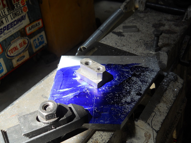

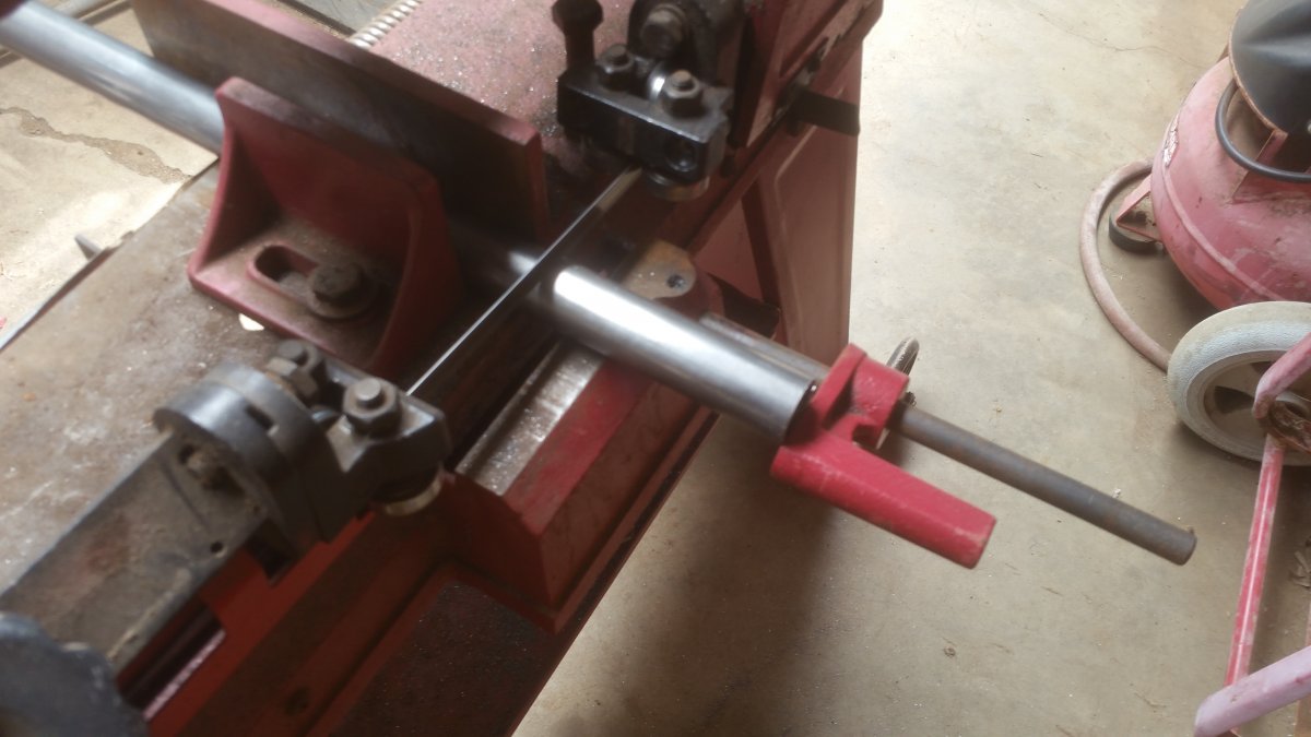

    i already posted these pictures on the"Re purposing parts" thread. because I couldn't find this one. But as long as we are talking about band saws. I wanted to cut up that aluminum head to stretch it. But the vise jaws wouldn't open enough even though the blade opening was long enough to cut the head. And sometimes i want to cut something on an angle. Or it's to short for the vise to grip it. So I made two T nuts to fit the moveable vise jaw guide slot. Tapped them both 1/2 and 3/8 so i could use either. now I can just use finger clamps to hold stuff or put the vise back on if I want.

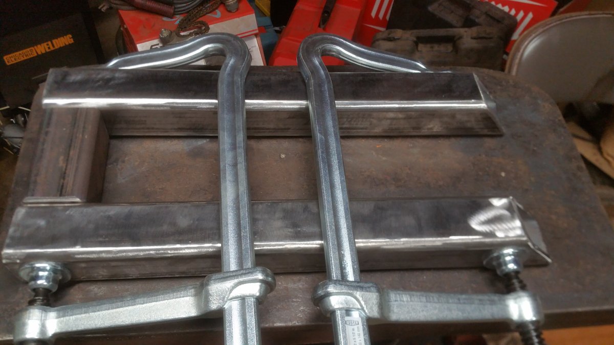

    I needed to machine my F-1 steering box so I could put a new flange on it. The 4 jaw chuck we have was a bit too small to hold the box, so I made this little fixture to use the 3 jaw. It worked well.

    Using your head!

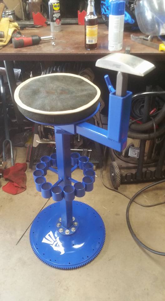

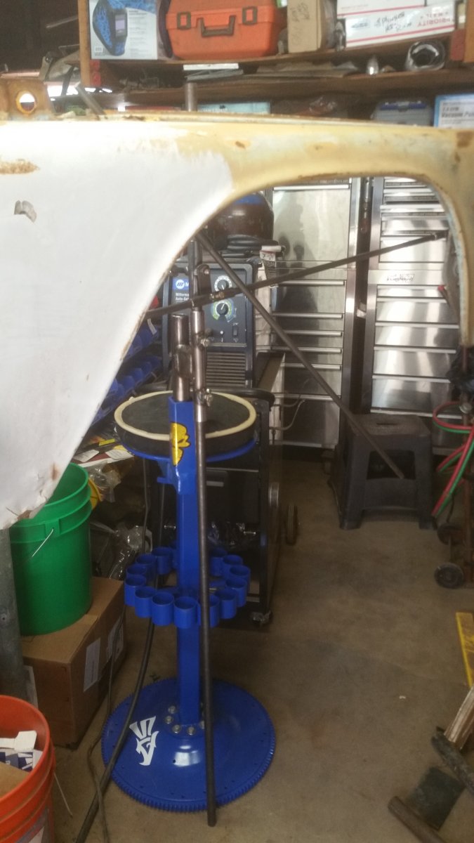

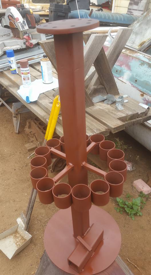

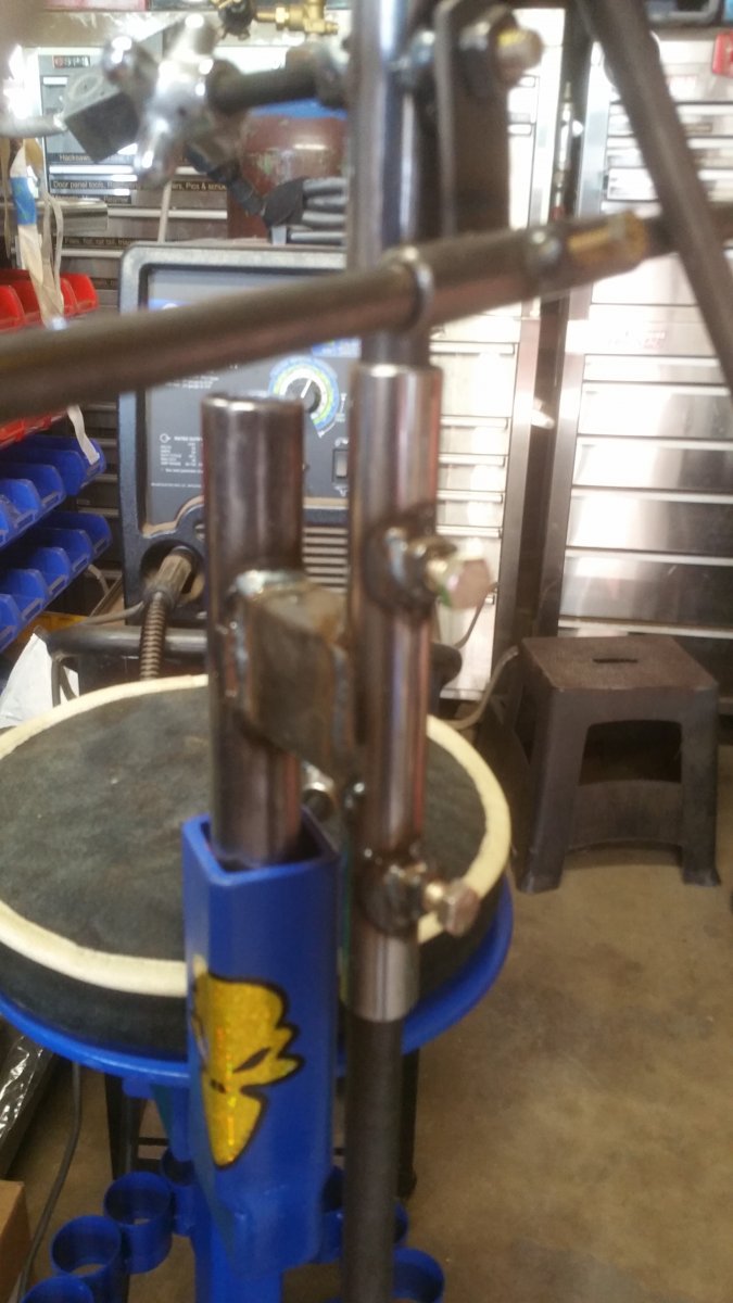

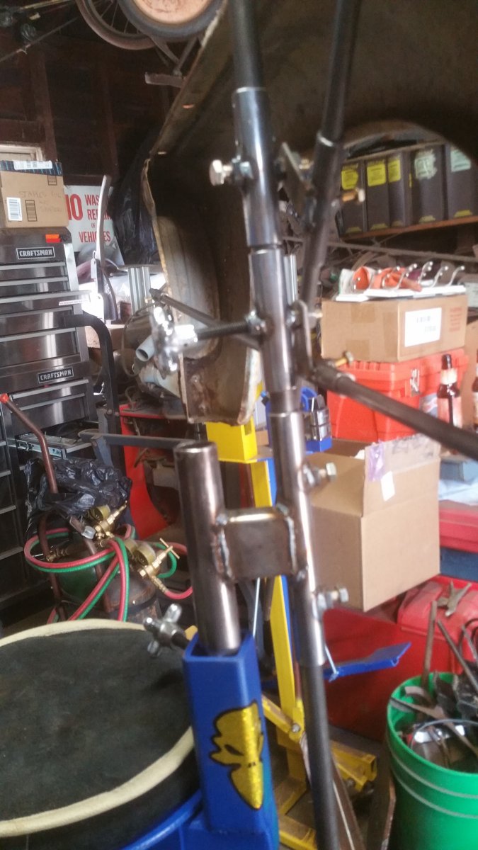

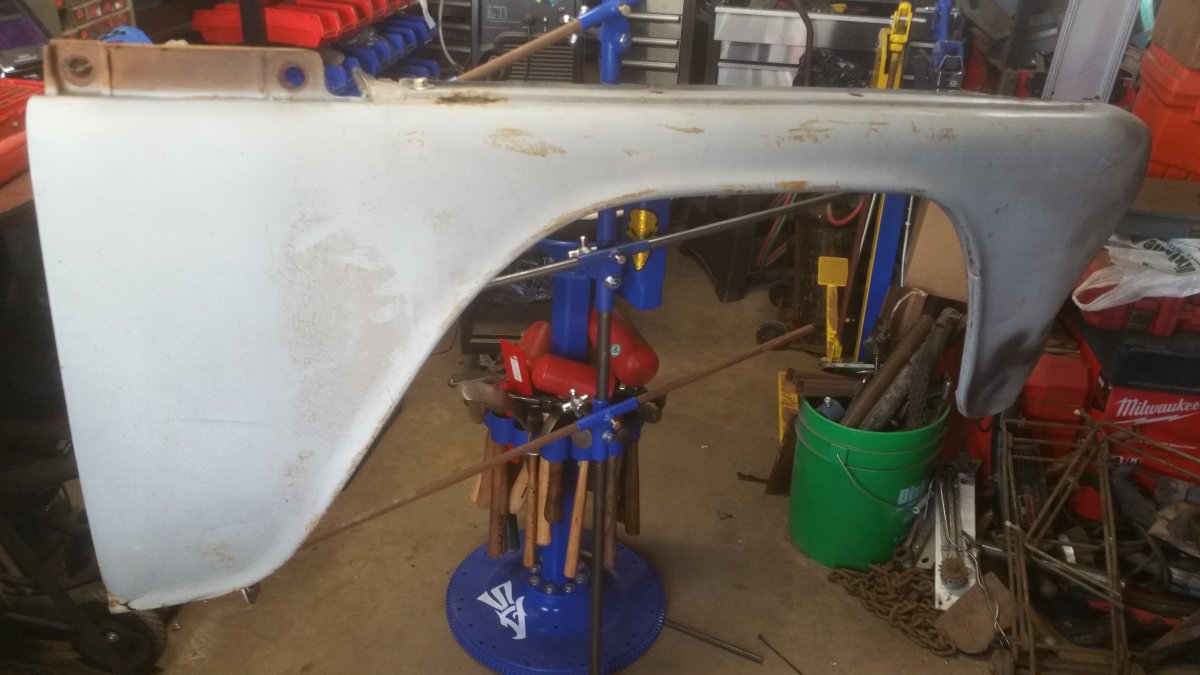

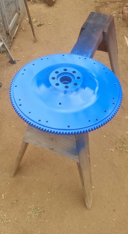

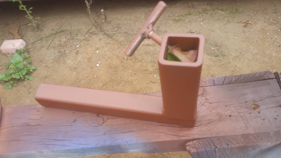

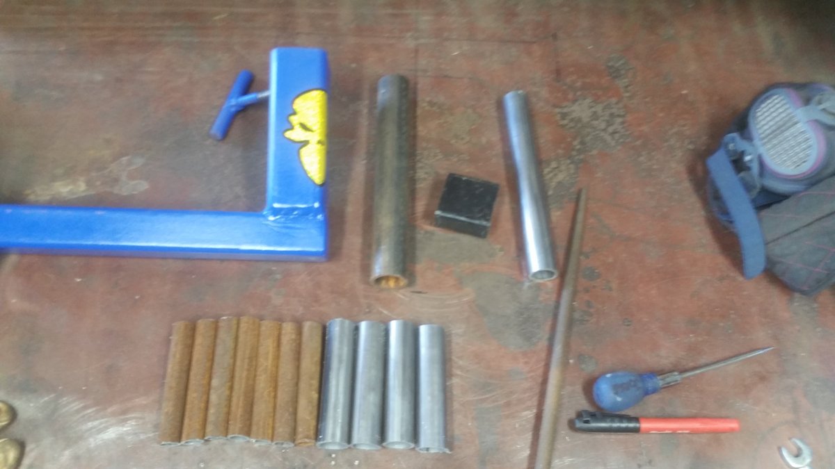

    New metal shaping stand for sandbag/anvil/dolly...may add other attachments later stand 1.jpg stand 2.jpg stand 3.jpg stand 4.jpg stand 5.jpg stand 6.jpg

    Excellent work .. Good thinking outside the box on the panel holder ....
