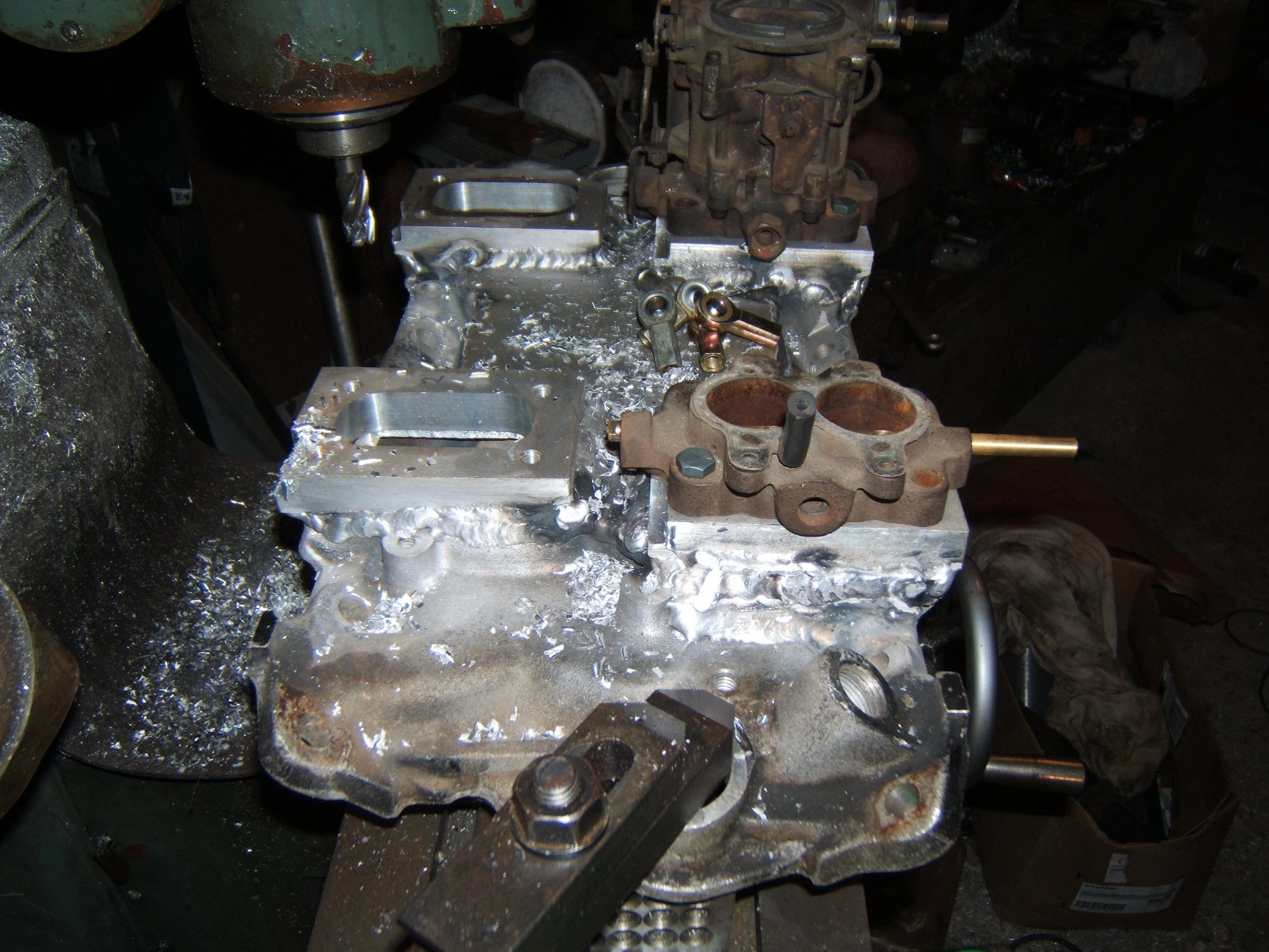

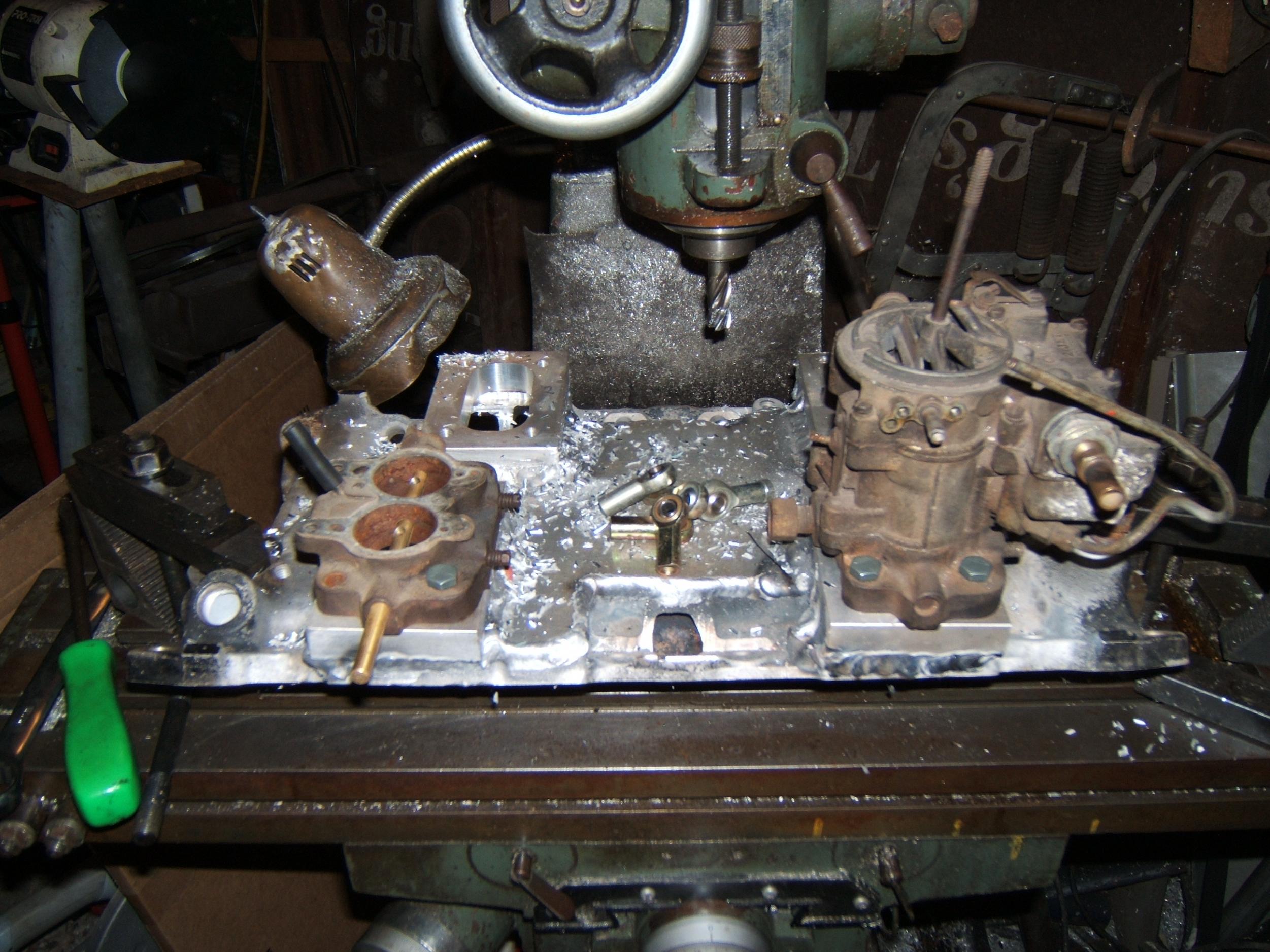

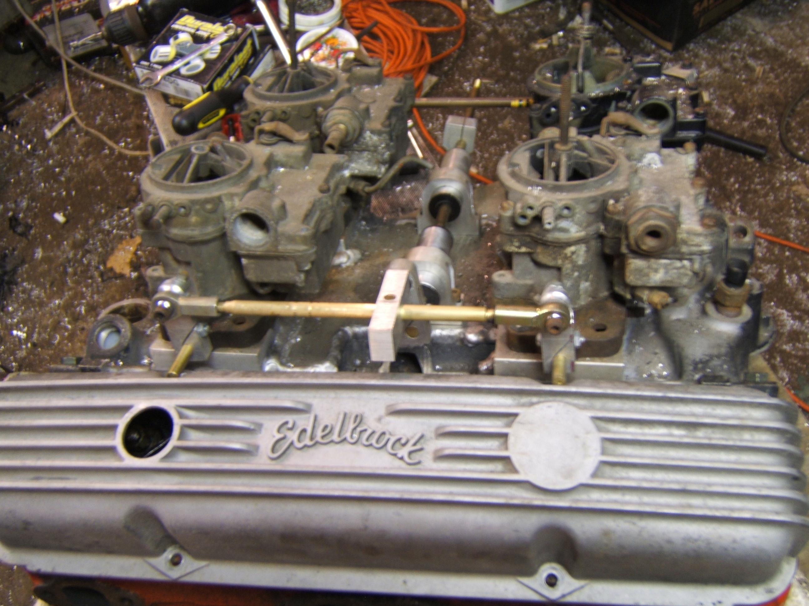

    Man, I just checked in to see whats up, Wow! Great stuff everyone love seein' what turns others cranks. Langy I was hoping you'd chime in. Always love seeing your work. Not to diminish everyones elses submissions, all great stuff. I'll add one more I've been working on for about eight years(not every day HAHA).

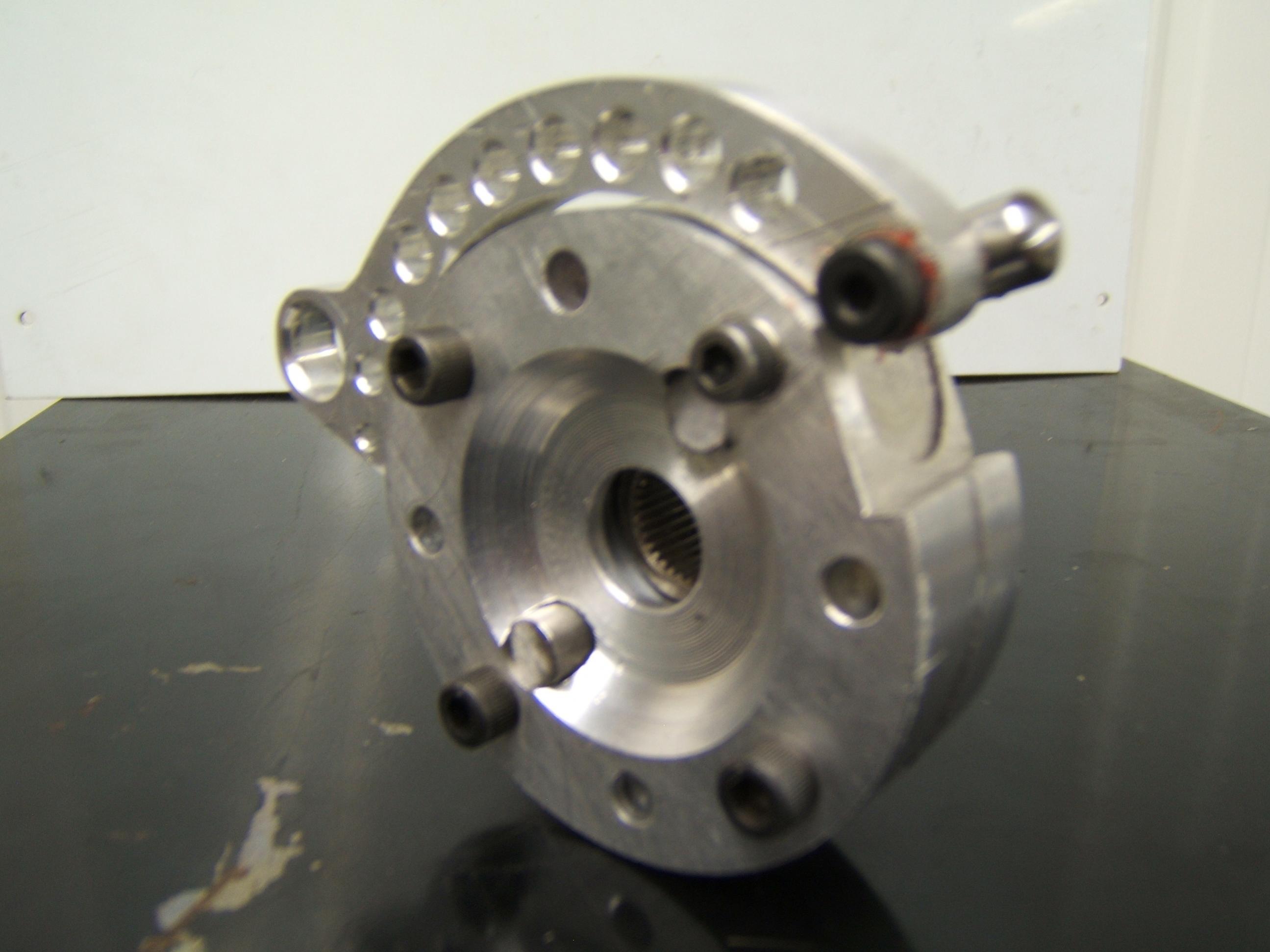

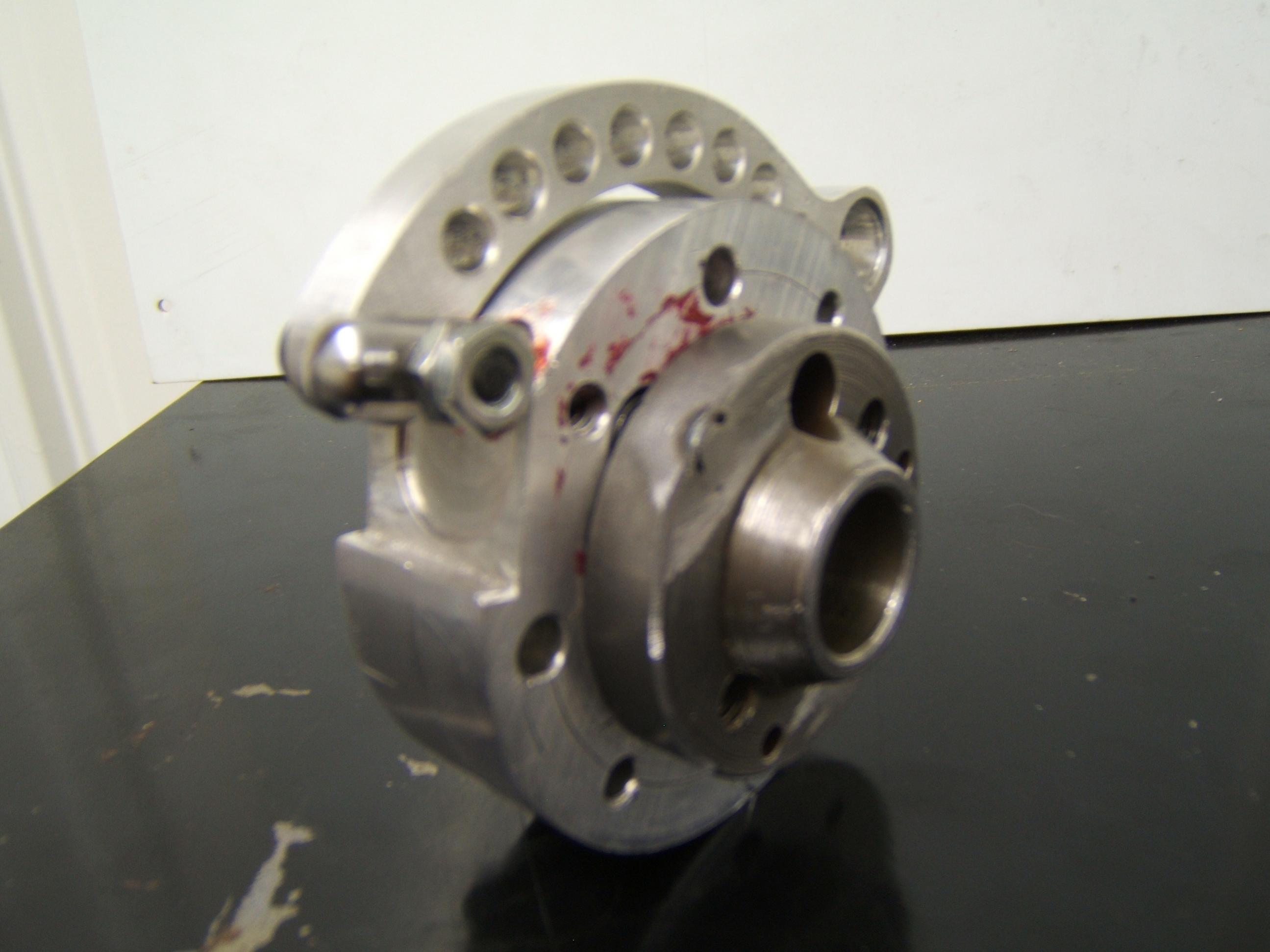

    I'll put up some more. I built a quick release steering wheel taker-offer. I know I could've bought on but where is the fun in that? The only problem I have with it is you don'y want to rob a bank then try to put the whell back on, I have to figure out how to index this thing better. The sad part is everything is off set so it only goes on one way, however you can get it to star on the wrong way. A little fine tuning and it will be great. And it was free(not including my labor.)

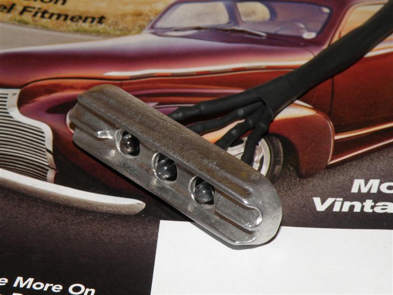

    I recently cast up this little piece to hide my dash warning lights. It measures about 2 1/2" x 3/4". And has three led's, blue, red and green.;)
    I'll prob get flamed for taking the photos on a "street rodder" magazine:eek::eek:

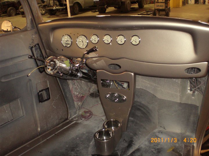

    Blister and console.

    You might be a poor speller but you sure do Bad *** building that console!!
    Man that is sweet. Wish I had that talent!:D

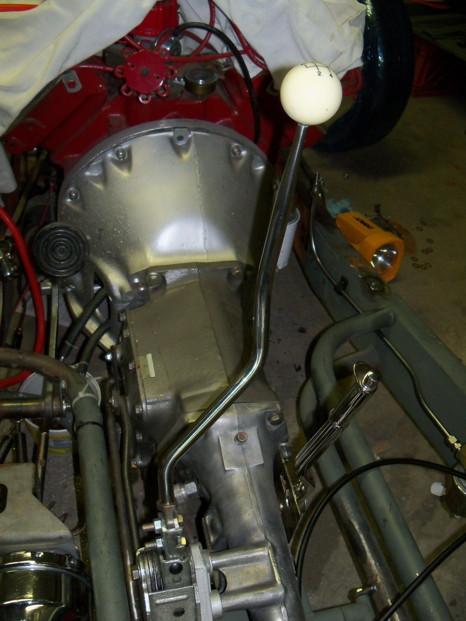

    This is the most recent piece I made. I couldn't buy a shift lever for my 833 that was the correct position so a friend let me use his shop and we turned this out of a piece of 1 inch hex stainless, tapered and threaded the end and curved it using his induction heating machine which does not discolor the stainless. Then I polished it and it looks store bought.

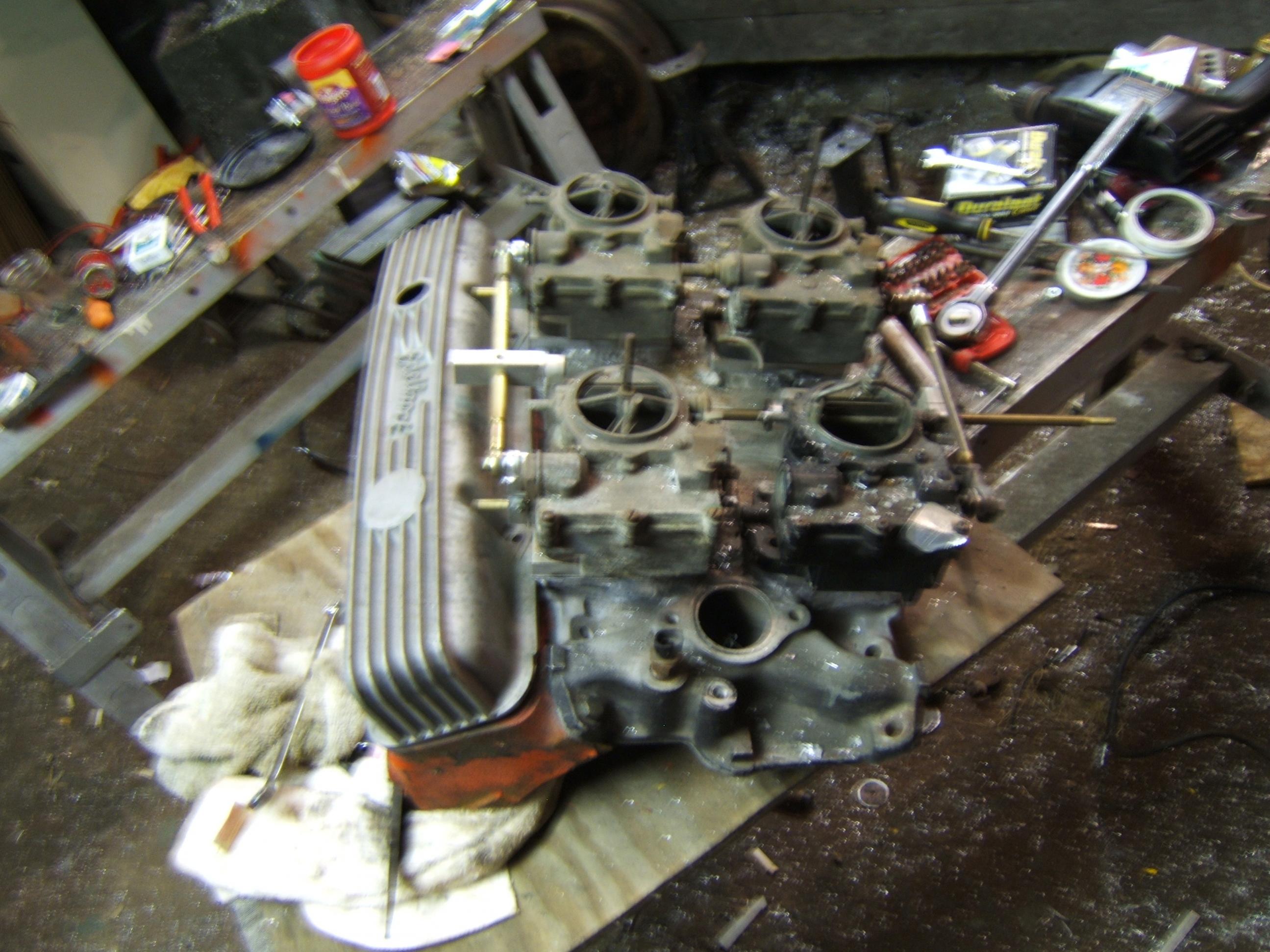

    From s**** laying under my workbench..

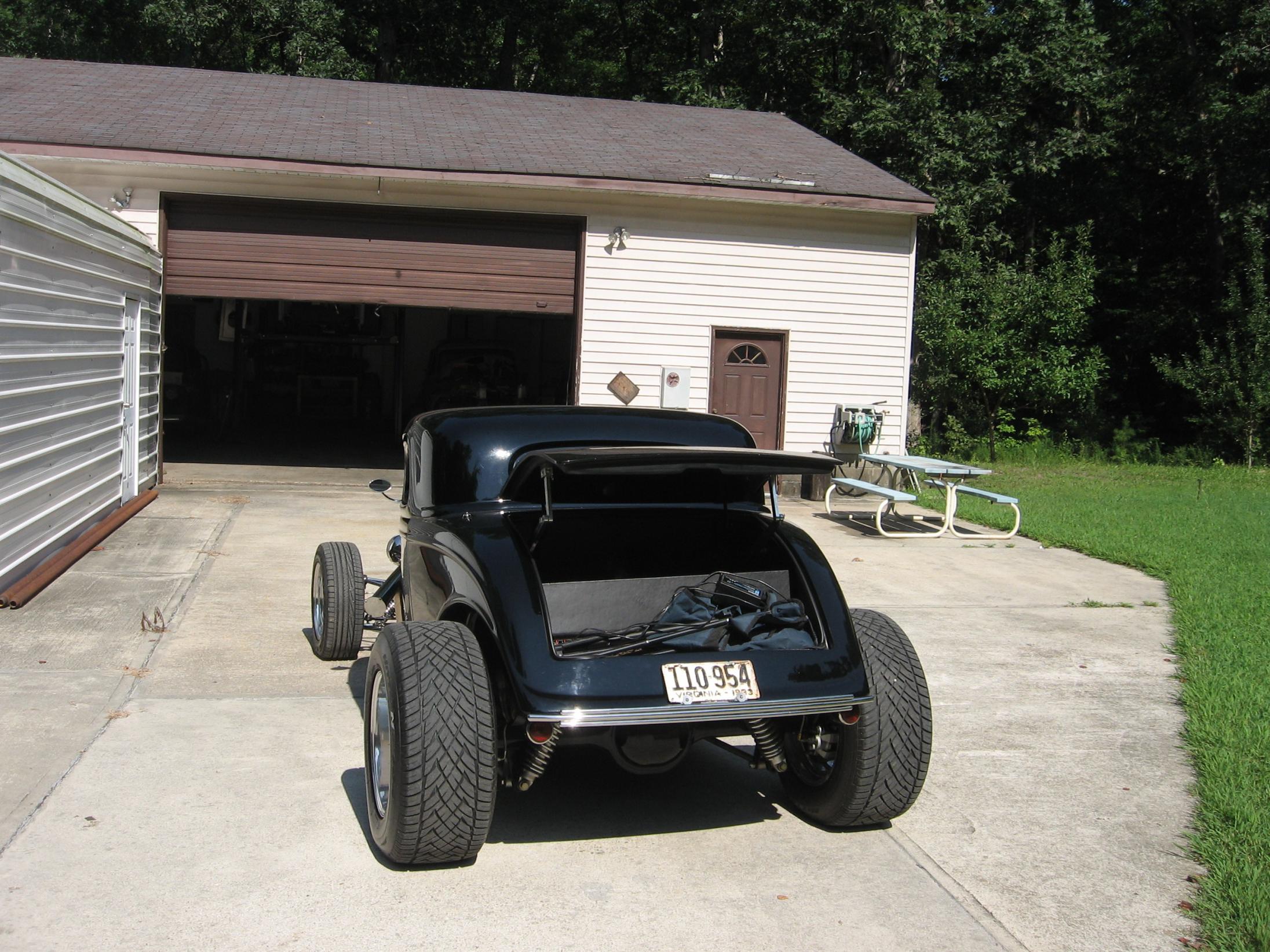

    I made my rear bumpers and exaust from ss

    Is that console all metal? Any details on the build?
