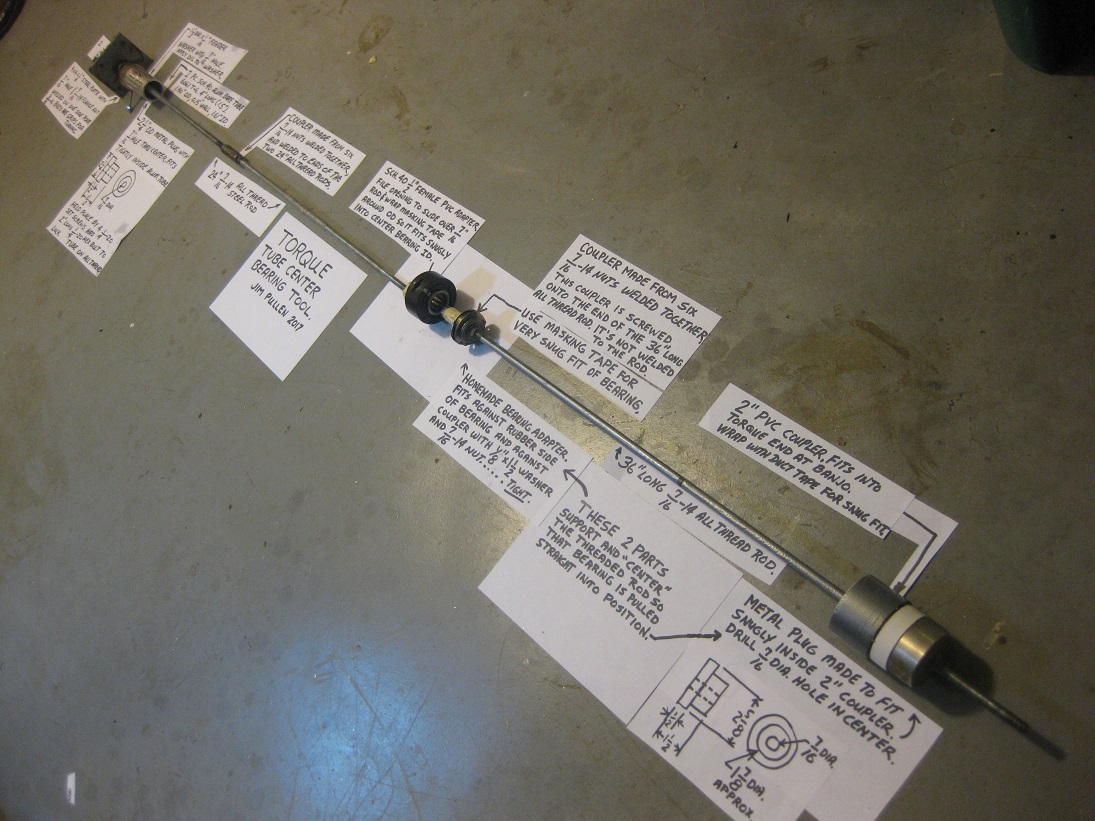

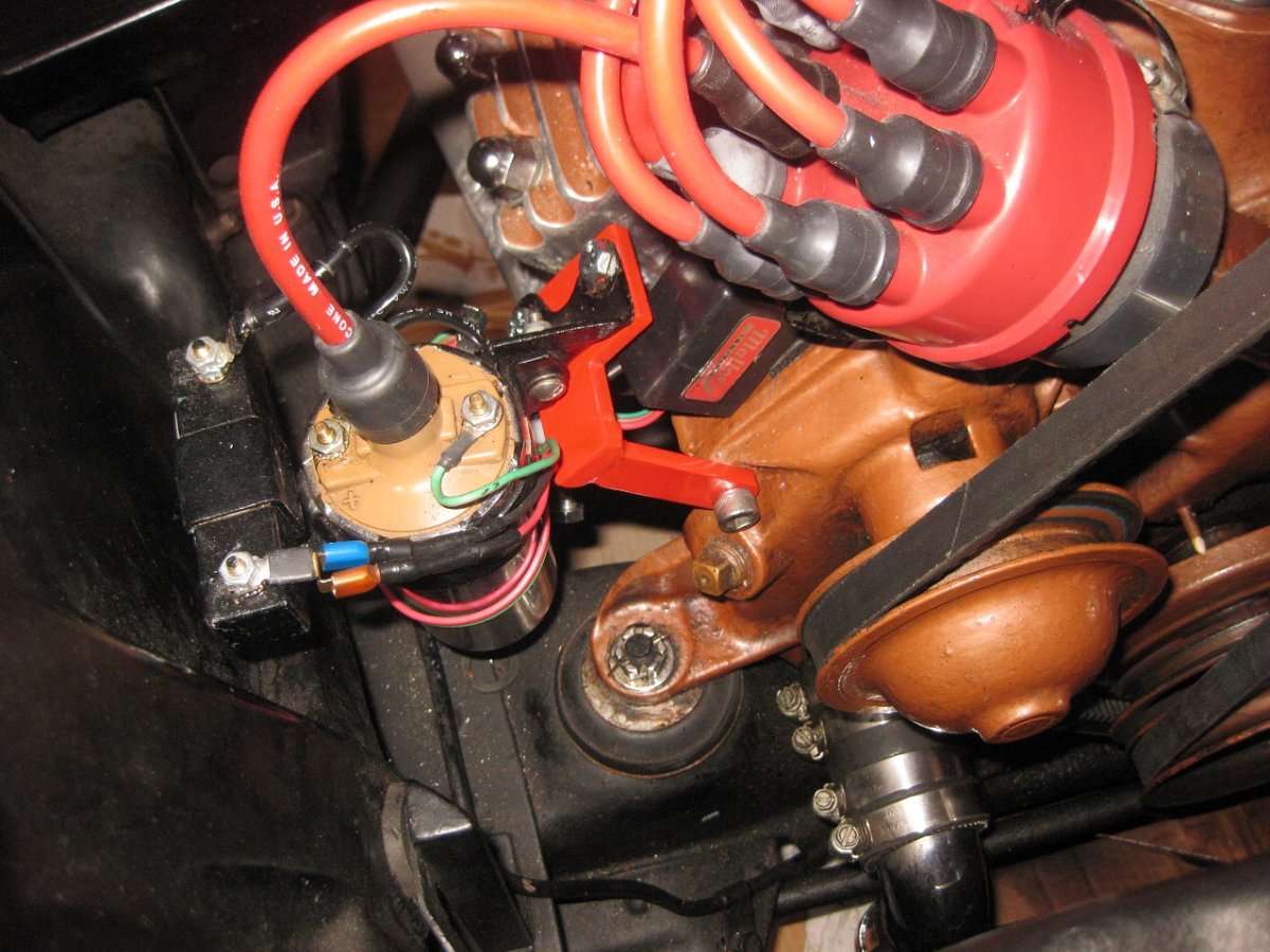

    Coil bracket for flathead engine that remounts the coil. Bolts to the water pump so as to "clean up" the head. Also tool to remove and install Ford torque tube center bearing, oil fill tube with screw on cap and fuel filter alum fittings, upper and lower aluminum radiator hose pipes, adjustable alum. fan hub pulley.

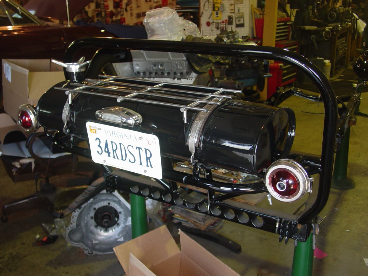

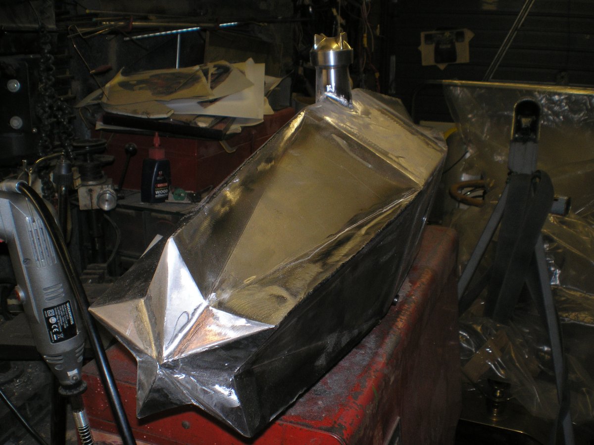

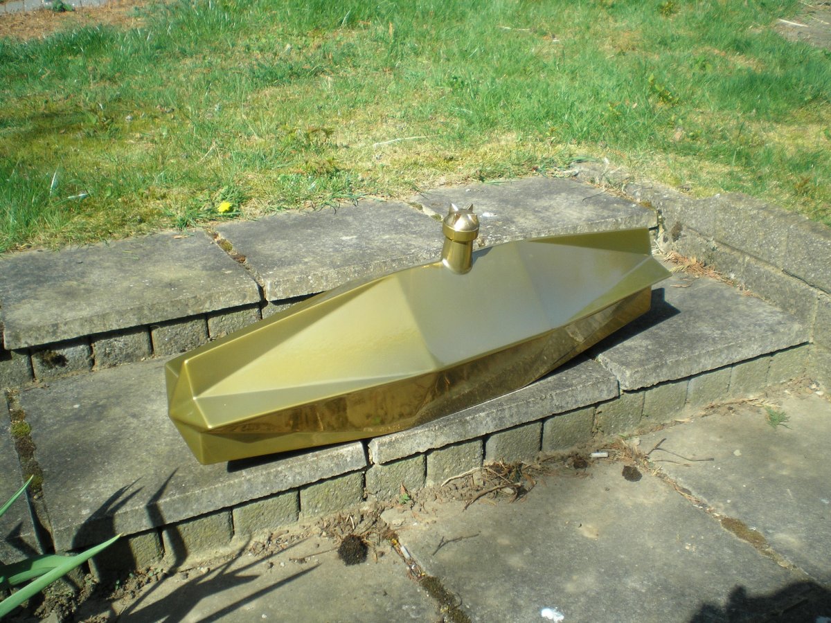

    My gas tank, a little further along, the tag is one layin around, its' not a '34 DSC00177.JPG DSC00178.JPG

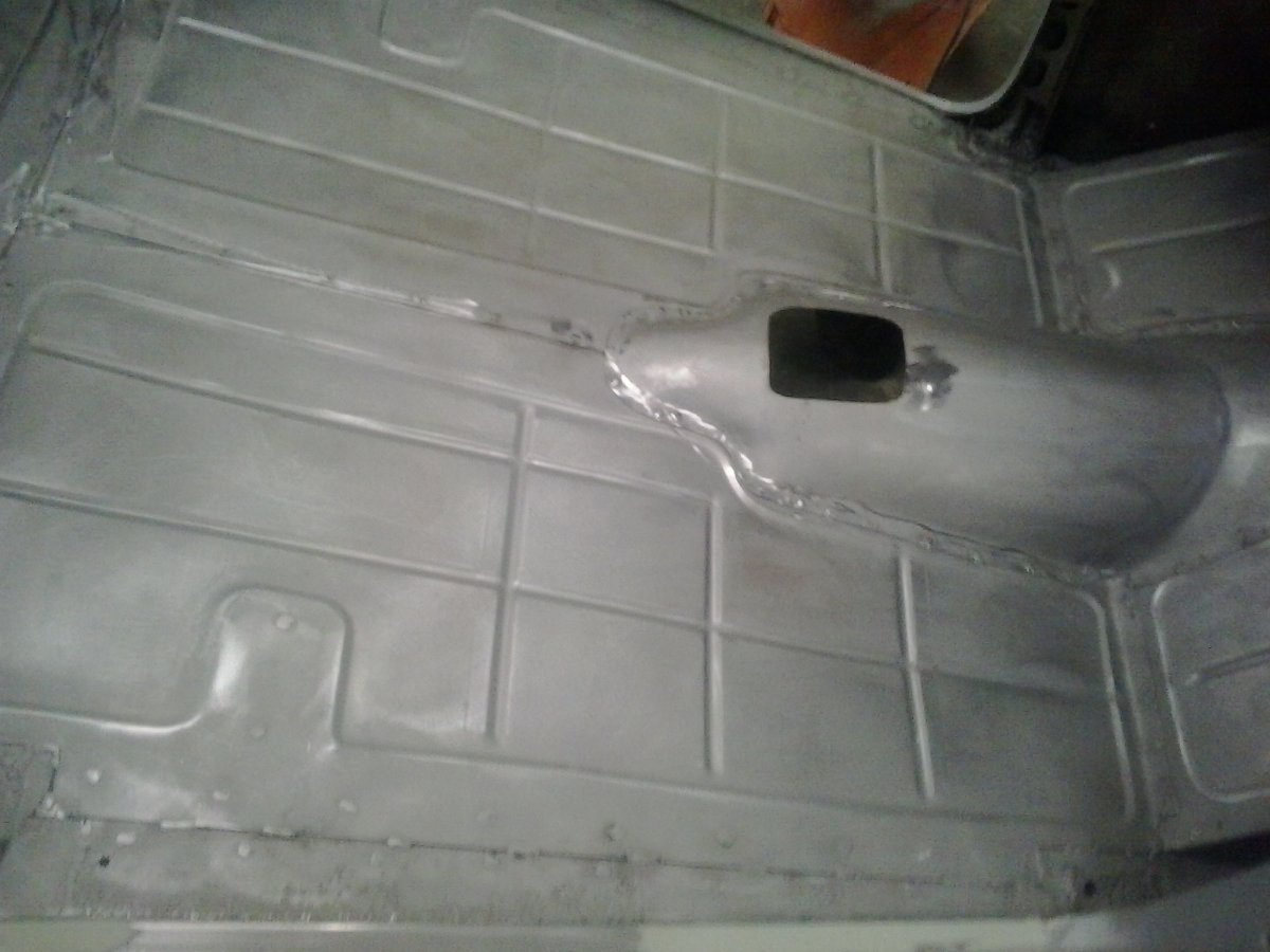

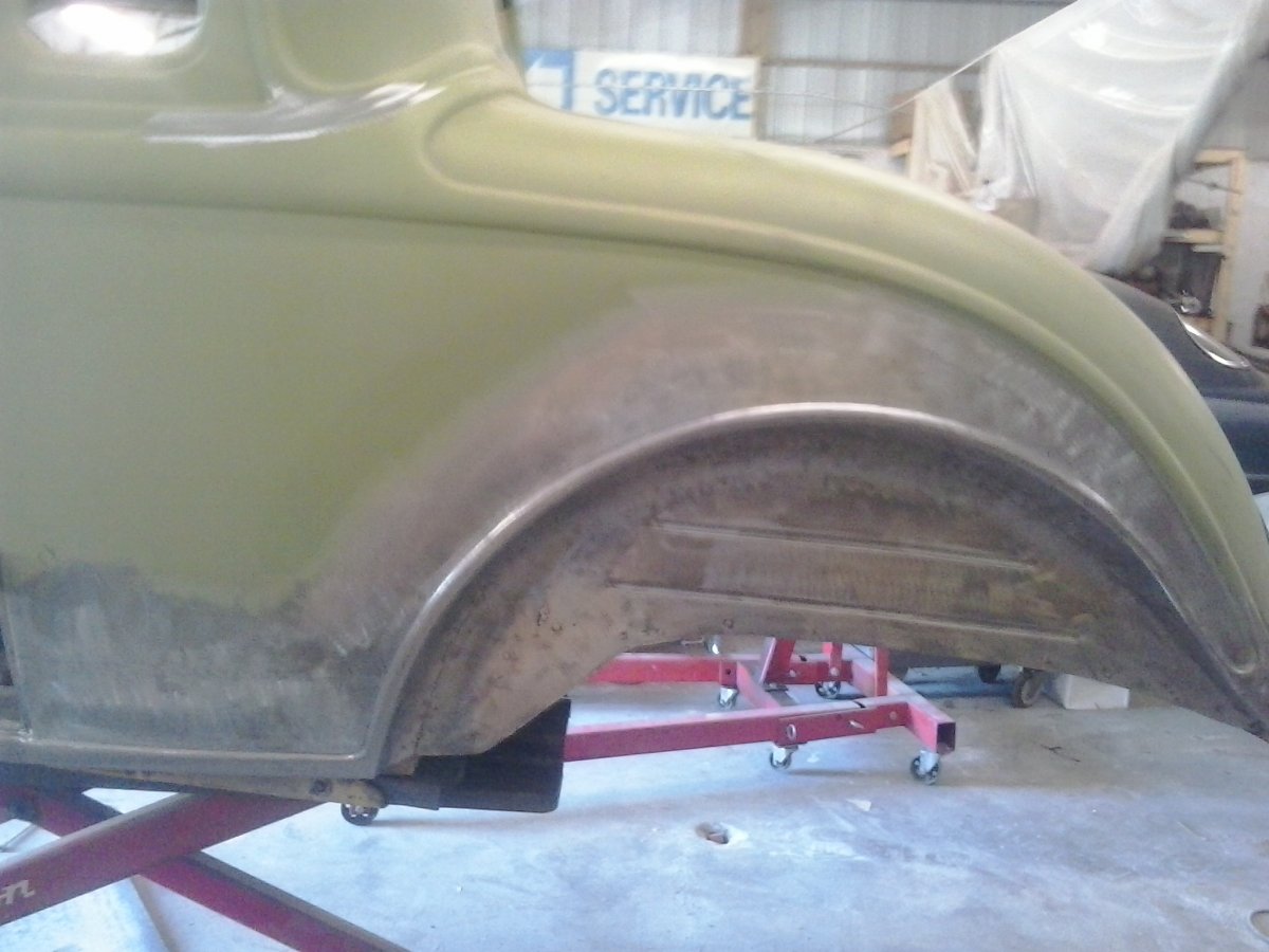

  8. made the floors lower qtrs. wheelhouses and qtr extension for a friends 33 Ply

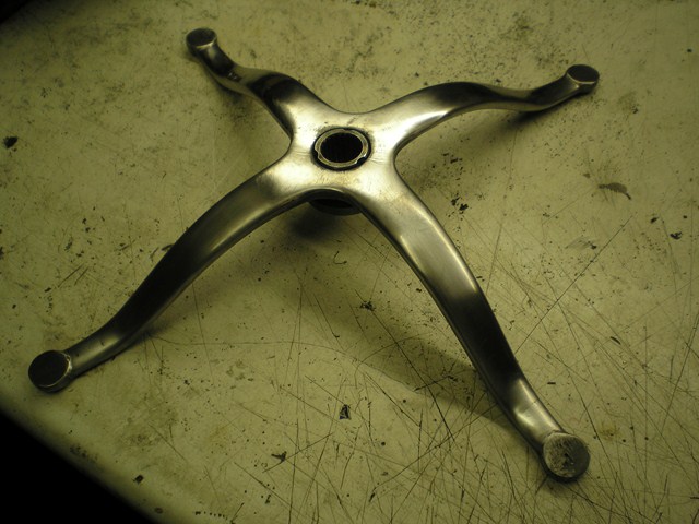

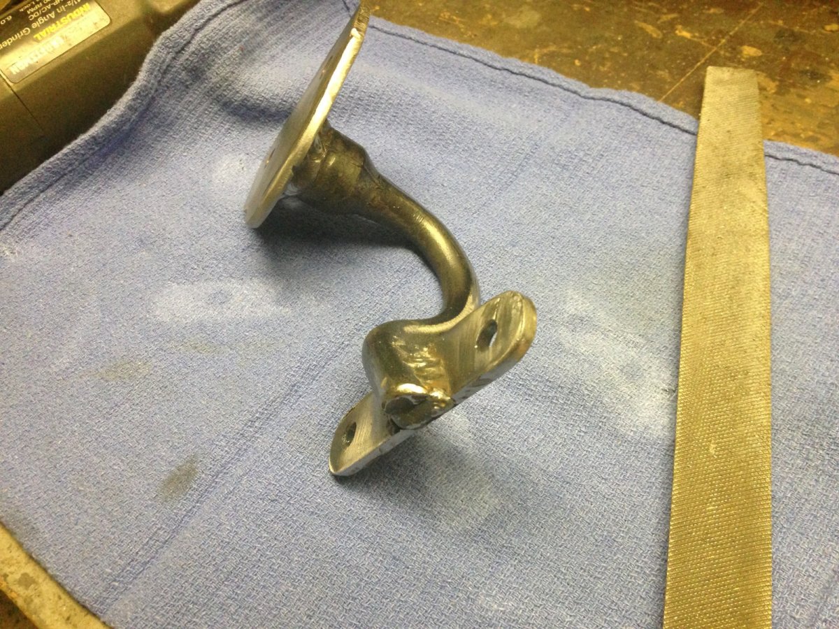

    Old lug wrench for an offset column drop....column didnt' line up under holes in bottom of dash.

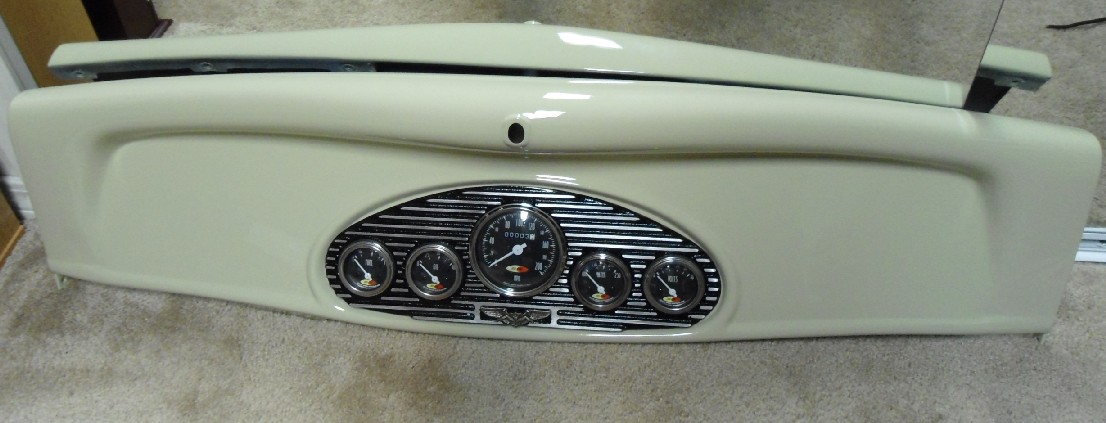

    Made dash from a 34 ford upper rail and a 34 chevy bottom half. cluster is an aftermarket "champion" piece turned upside down to fit the chevy inset.. 34dash.JPG 34dashpainted.jpg

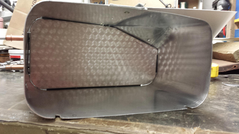

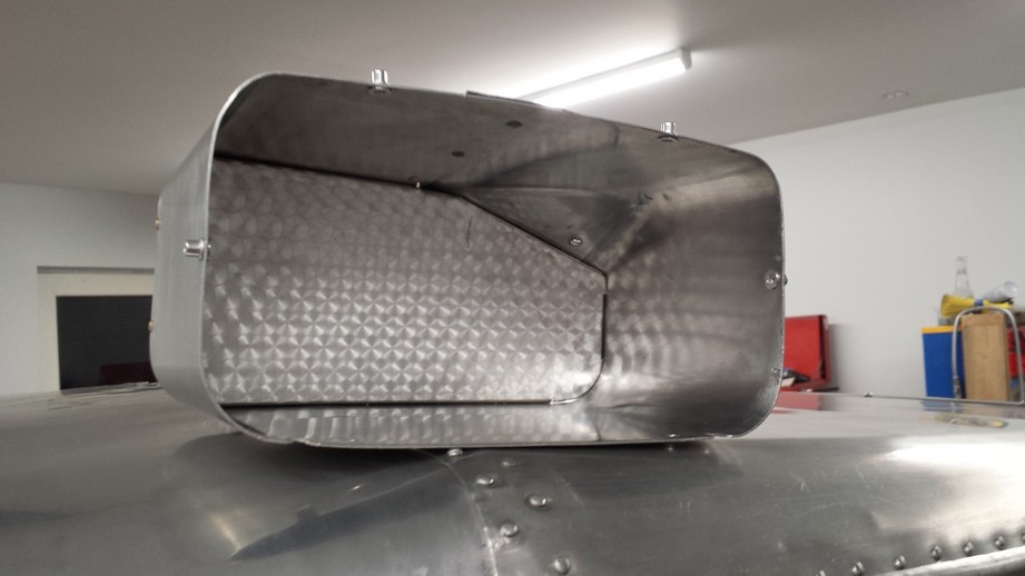

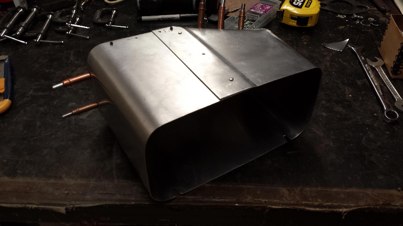

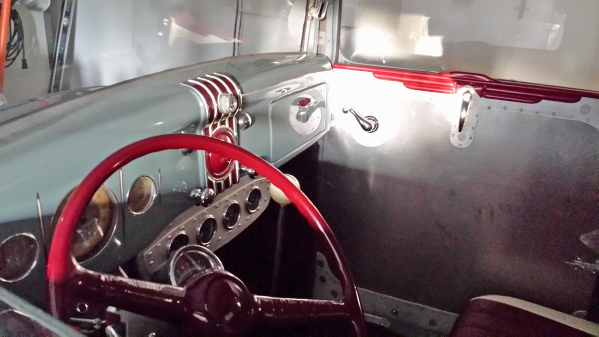

    29 Model A Coupe/36 Ford dash/No Glovebox
    Fabbed from Aluminum
    This item is very low in cost so why go through an extensive aluminum
    exercise to make one...because it goes with the wartime aviation theme of the Hotrod
    The notched section in the corner of the box is to clear the curved upper tank panel
    common to 28/29 Fords...Next challenge Get it in!!!Stogy :eek:
    Honestly it was a challenge and fun at the same time.
    1) Visual from internet image
    Interior theme below...

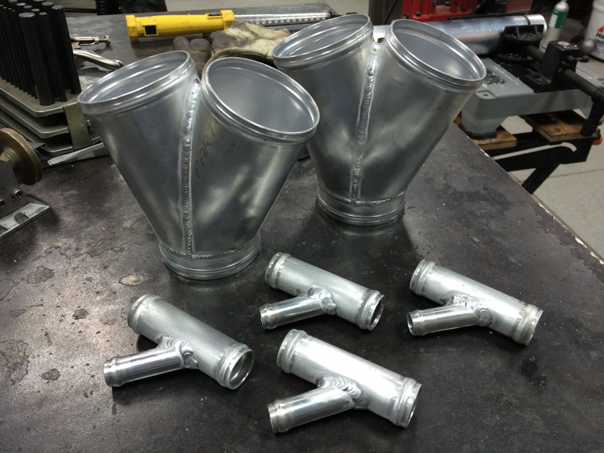

    A tube beading machine.
    Heater parts using my tube beader.

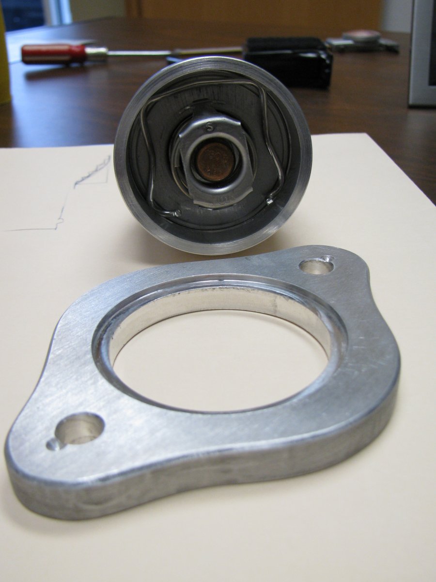

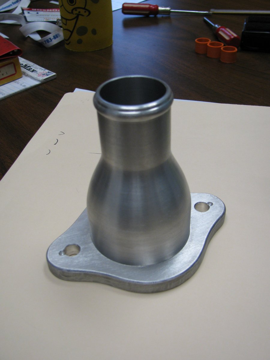

    Thermostat housing for a Packard straight eight.

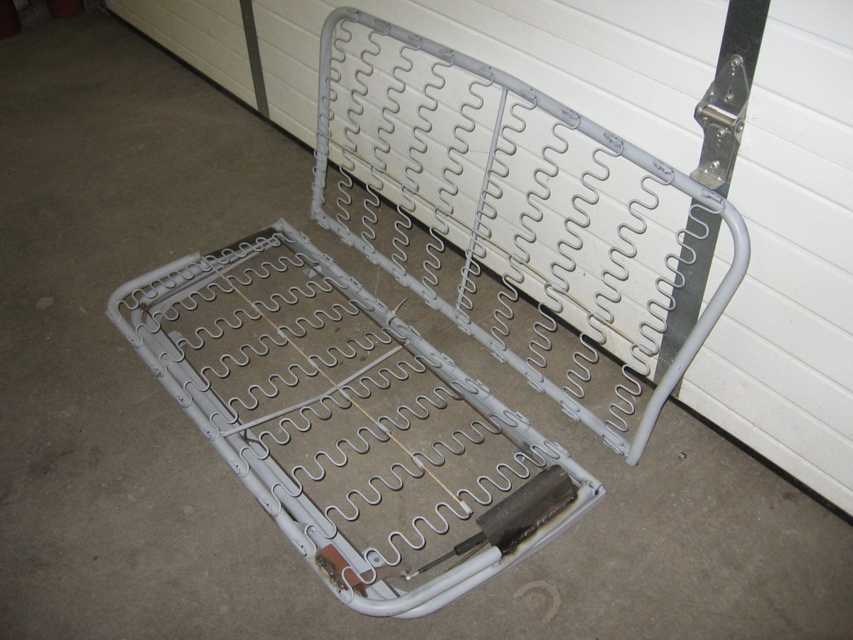

    made some seats

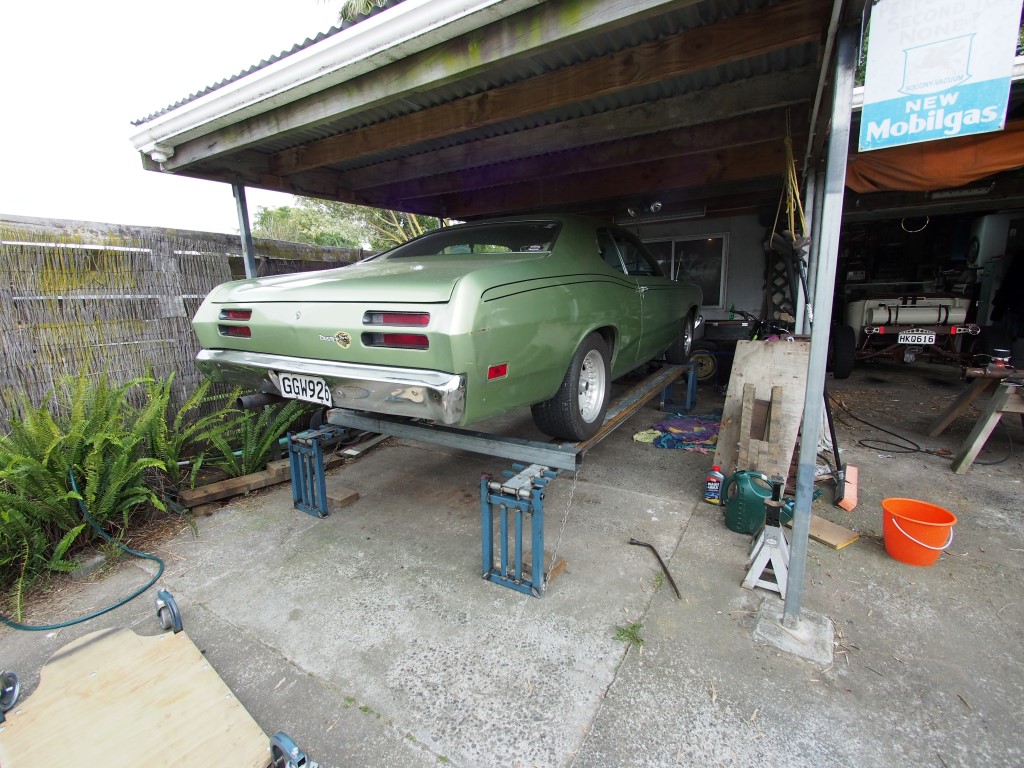

    built an easy lift. Pardon my ot Duster:oops:

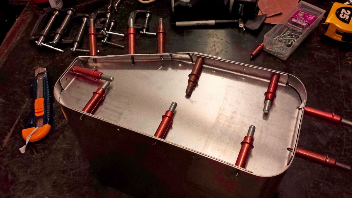

    Update...

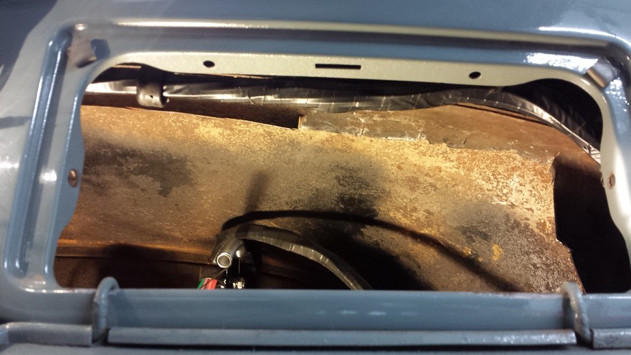

    Procrastinator Stogy finally got the Glovebox prepped and installed into the ole Hotrod...All that remains is a latching system. 36 Fords had a spring system and that is long gone...it is available repro but I am going to add a latch of some kind...for now its just a temporary spring...
    The literally quick n' dirty modified former tank complete with sharp edges everywhere...
    note 4 mounting holes with two hidden in hinge area...
    I pre installed the box where I wanted it and marked all the holes and opened 4 for riv nuts...and two clearanced holes for hinge area. Riv-nuts are super cool and come in many sizes...I chose 8/32UNF riv-nuts with pan head slotted screws which p*** for the look...
    Minus the latch (TBI) I'm pretty happy with it...I may fab a covered pad to sit and cushion the goodies

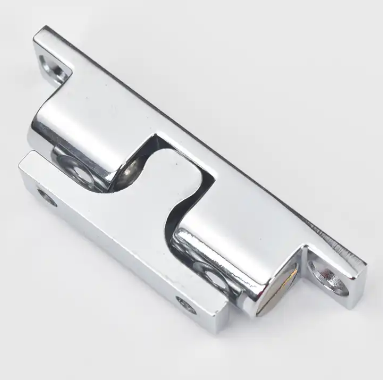

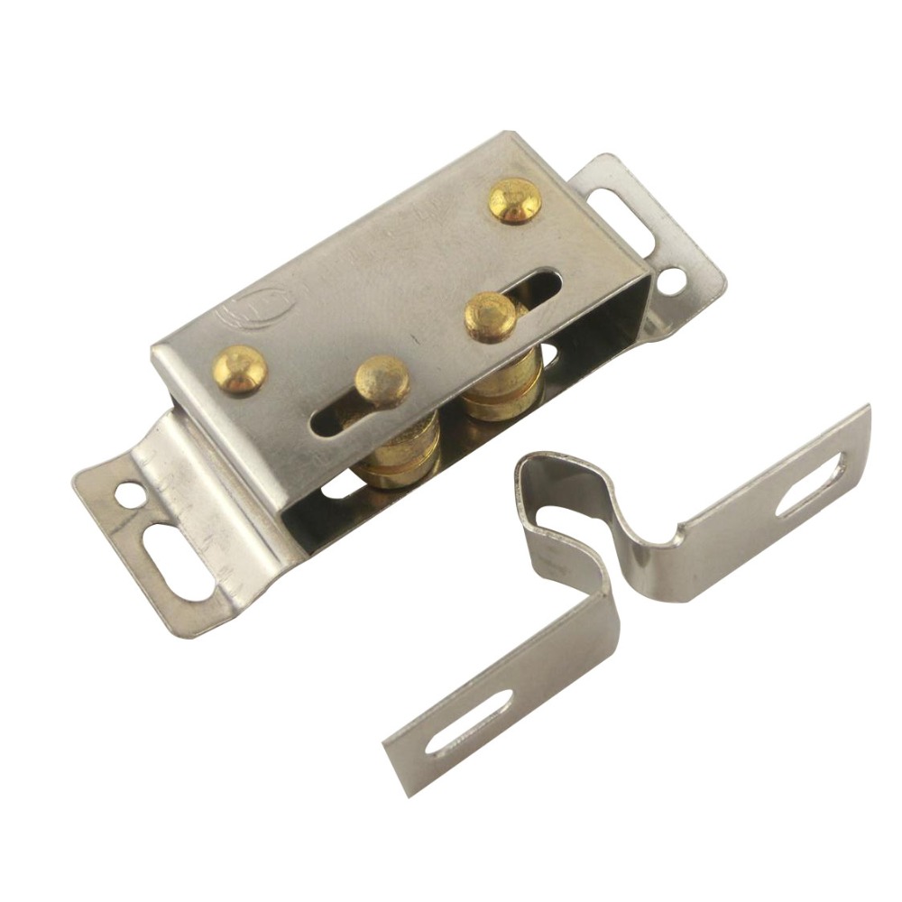

    :rolleyes: Latch option 1
    (I have but it is sorta to modern...ish)
    pcs-cabi-closers-xmm-magic-closet-door-catches-cabinet-doors-with-glass-cabinet-doors-unfinished.jpg
    :rolleyes: Latch option 2
    (I think this looks old...er)
    I will post a follow up when latch is installed...;)
