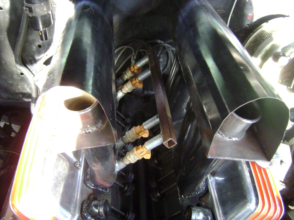

    finals are done! I built some thicker flanges and finished the intake fingers for one side. next week I'm going to pick up some throttle bodies and a throttle position sensor from the pull your part.[​IMG]
  2. 52pickup
    Joined: Aug 11, 2004
    Posts: 833
    52pickup
    from Tucson, Az
    Looking good. If you need access to a mig let me know, you can come use mine.

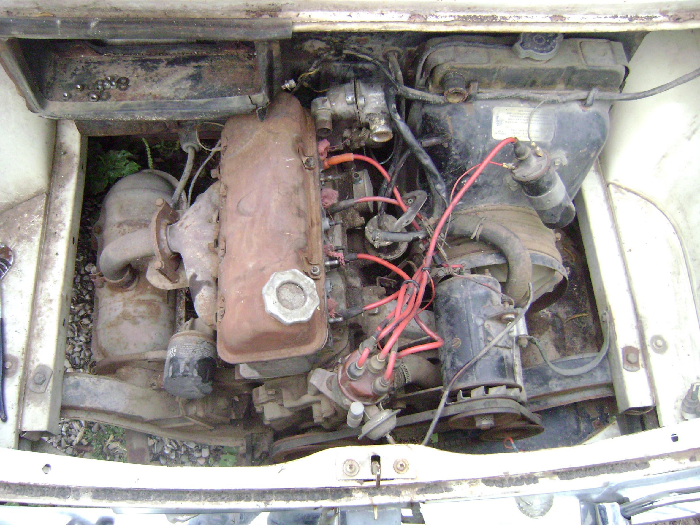

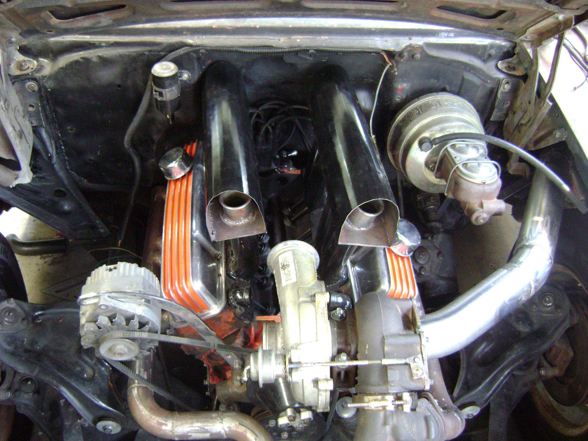

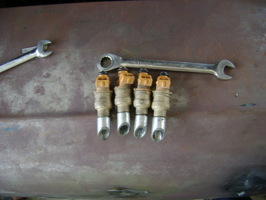

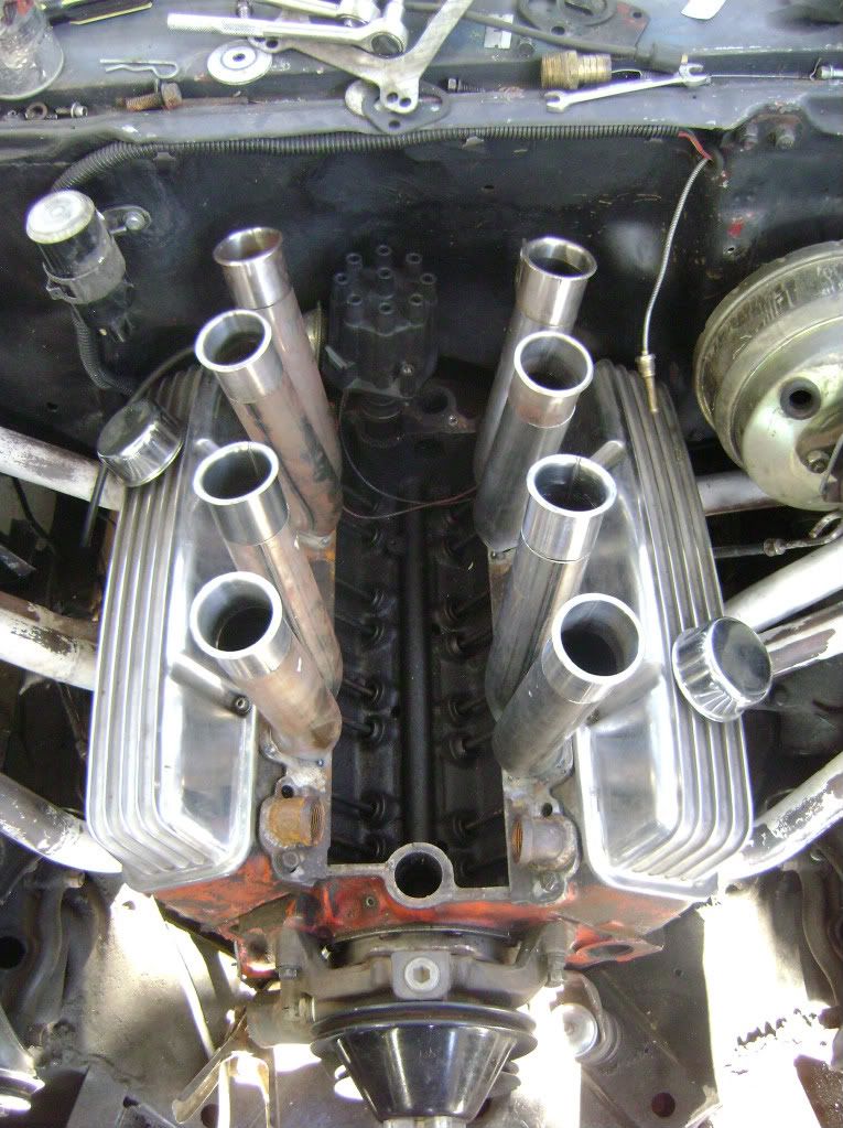

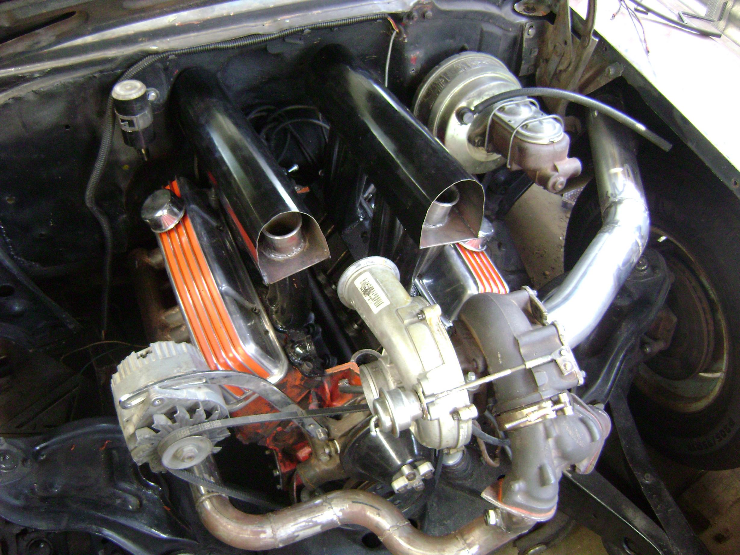

    I have made some progress! I gave up on the ITB's(the tuning part intimidated me). so i'm building a dual plenum manifold. and I also got my un-assembled MS computer. here are some pics for those interested:[​IMG][​IMG][​IMG]

    Joined: Apr 1, 2007
    Posts: 106
    ramaro
  5. 52pickup
    Posts: 833
    52pickup
    from Tucson, Az
    Are you going to box in where you put the plates at the top of the tubes? Have you decided what you're going to do for throttle bodies?

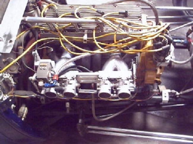

    Pretty neat. Altuough SBC injection is pretty easy to come by.I know, you wanted to do it your self. I did a banger with GSXR throttle bodies and alswo with Ford 4.6 throttle bodies. Did one with a F150 two barrel TB also but didn't take any pictures. Lost the wires while I was at it.
  7. rc.grimes
    Joined: Aug 14, 2007
    Posts: 694
    rc.grimes
    from Edmond, OK
    The big CBR and GSXR throttle bodies are real common and cheap at most salvage yards. I personally think they would look out of place. The idea of the 4 F150 tb's looks like overgrown scott/sp carb tops and a little more at home.

    yes. I'm thinking the throttle bodies are going to either exit the plenum up front or poking out the sides. i was thinking of using 2 late model 3.8L GM TB's or ford 4.6's. thanks guys!

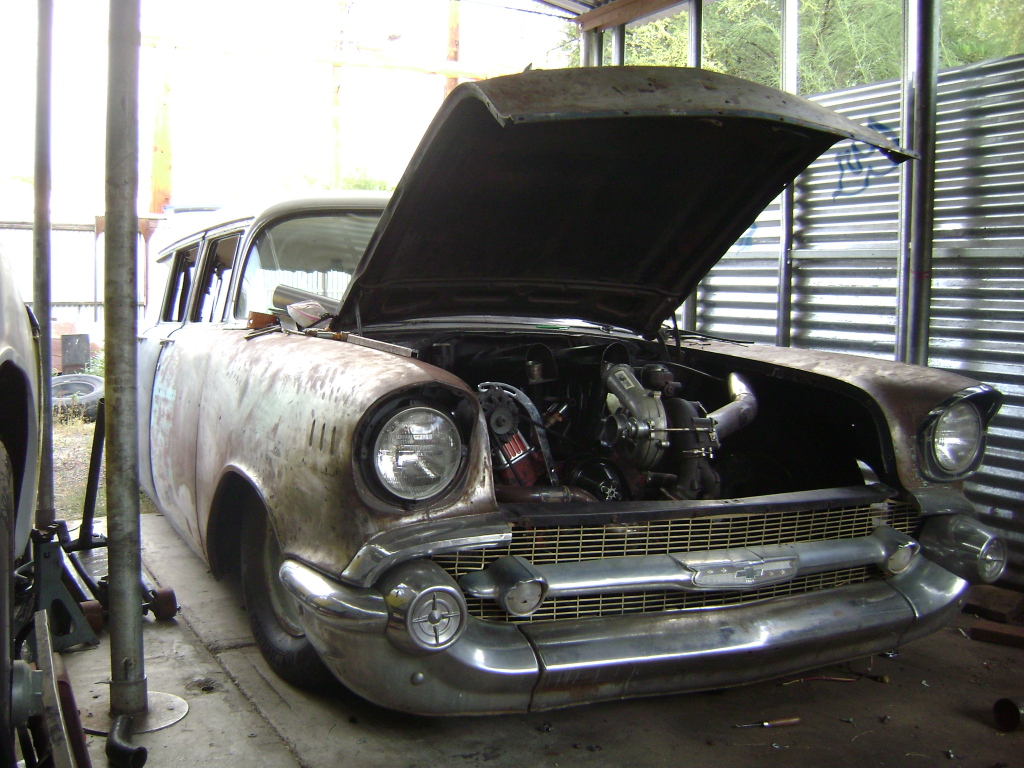

    yeah, turbo will stick around. I found some twins that I want to rebuild a little later on, and build a setup kind of like the old malicoat bros. willys, but with my dual plenum manifold.

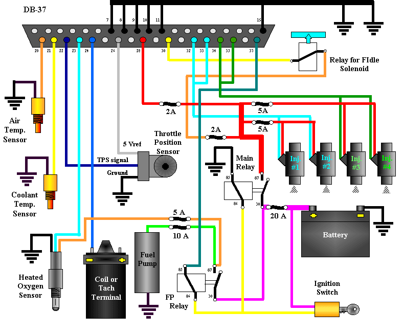

    This weekend i built my computer pigtail. this is the wiring harness that goes from the back of the computer to the fuse panel(i bought the unassembled panel from DIYautotune for around $40.00, actually all my computer stuff is from there). The whole computer assembly and wiring is not that bad, actually the wiring is quite simple, and the computer assembly is just solder by numbers. here is a diagram of the sensor wiring. the 37-pin connector in this pic, represents the back of the computer, but if you build a fuse panel, you can just run the wires from it directly to the component.
    If anyone has questions, I'd love to hear them!

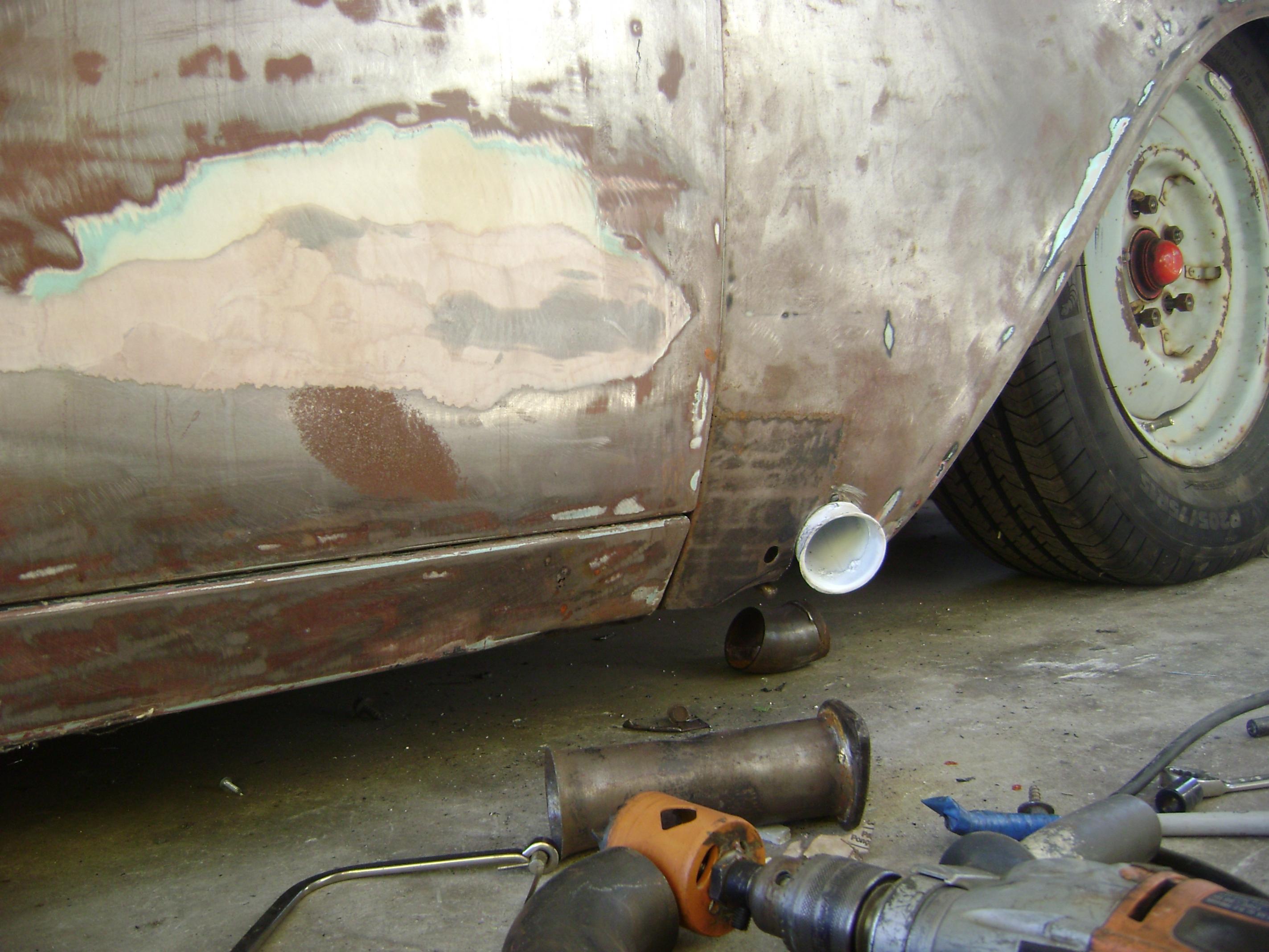

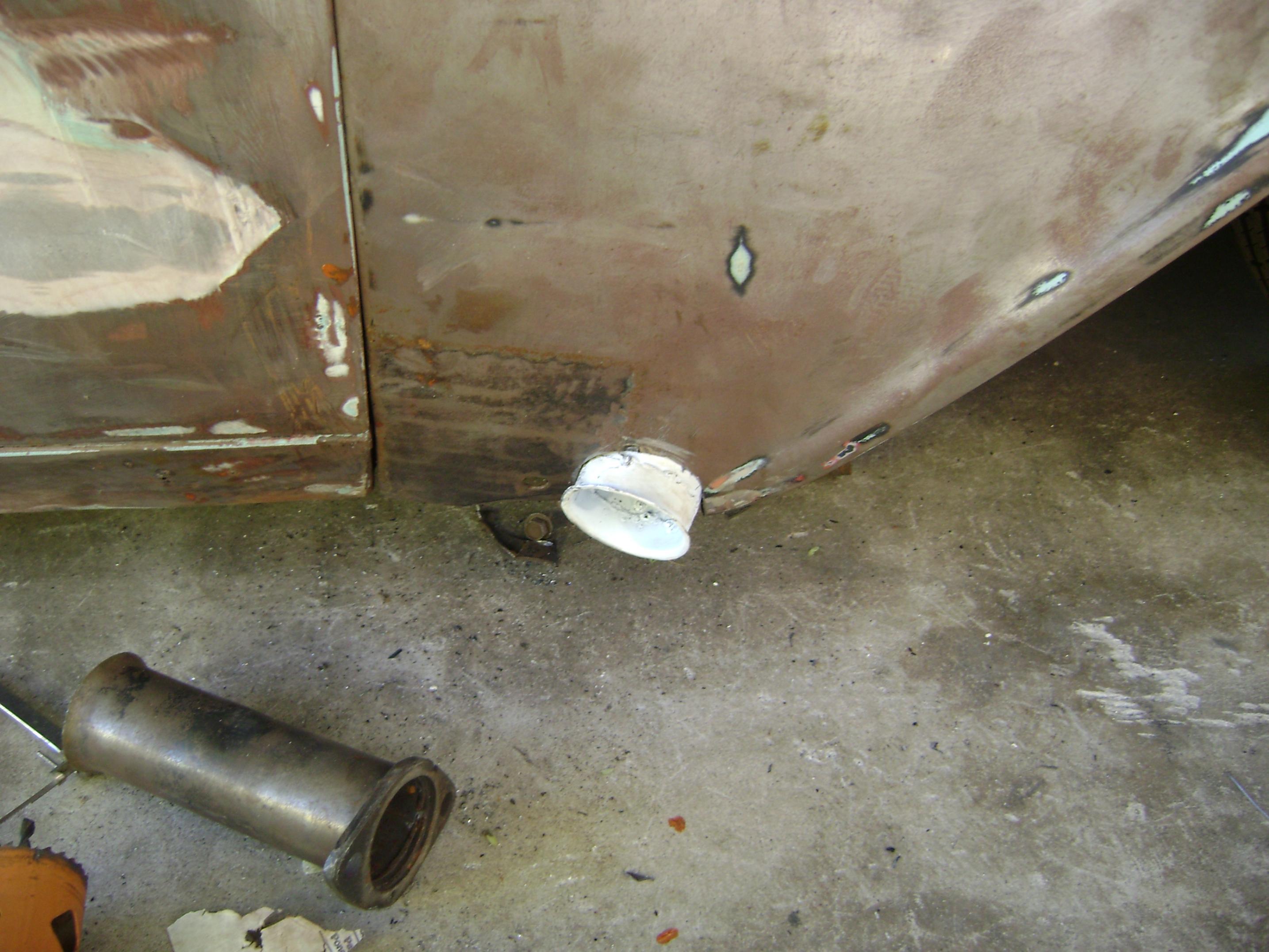

    here is the exhaust. the O2 sensor is back in the fender.
