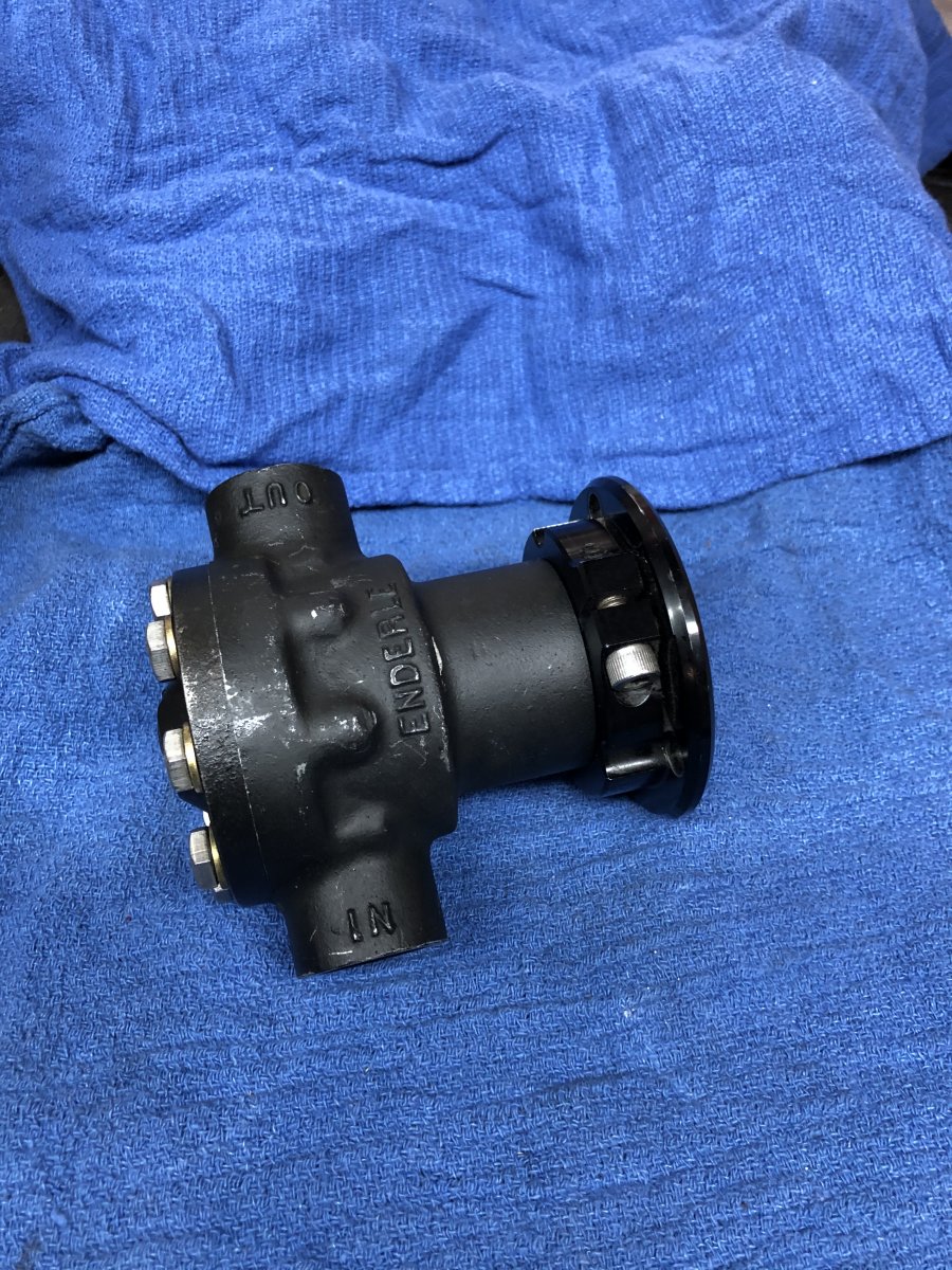

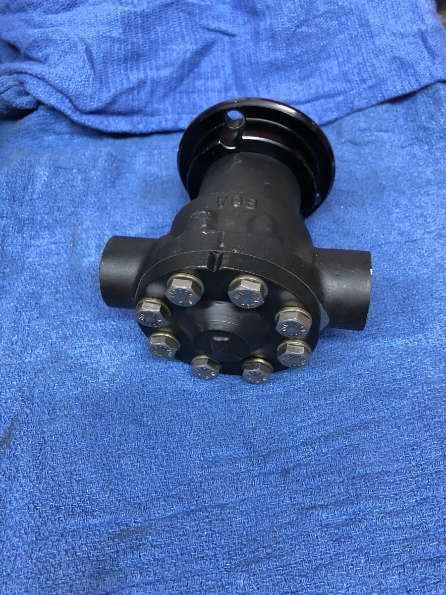

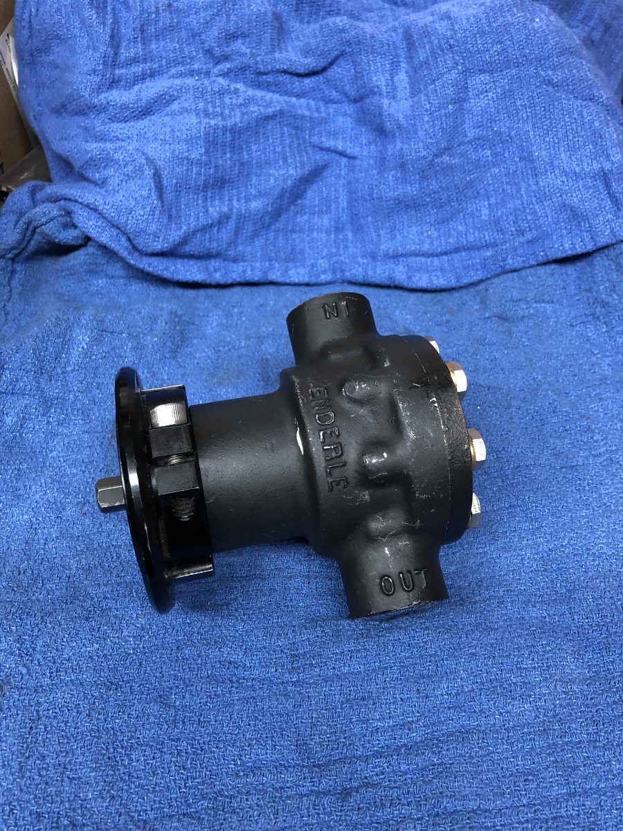

  10. Hi Mopar,
    Just keep reading and I’m sure you will figure things out.
    I am glad you are not giving up,,,,,good ideas come around all the time from people that don’t quit.
    I was wondering though,,,why don’t you just use a normal mechanical pump,,,,price?
    I have picked up several at swap meets for reasonable money.
    Here is the last one I purchased at Nashville,,I can’t remember if it was the auto fest or Stones river swap meet.
    I understand that California is much more expensive price wise,,,maybe I got lucky and the guy just liked the way I spoke to him.
    It is an Enderle 80A. -0
