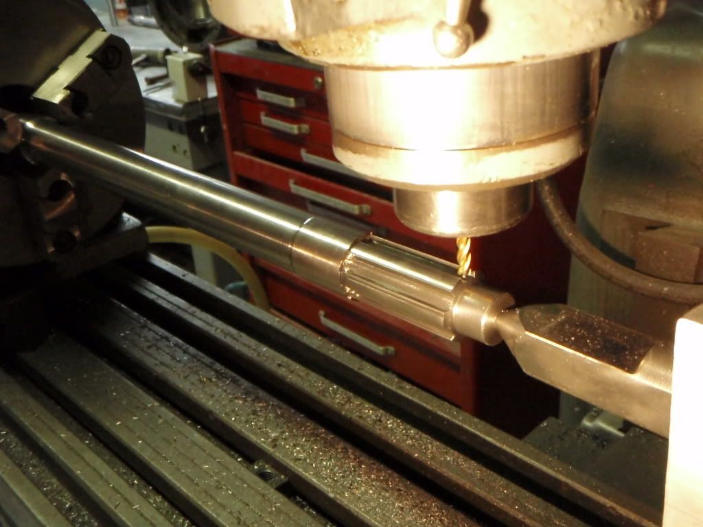

    You mention something about cutting the splines, you got that worked out yet? I messed with that part once and could only come up with 3 seperate cuts to make each spline.
    Thanks, oj
  24. Jethro
    Joined: Mar 5, 2001
    Posts: 1,967
    Jethro
    OJ, you will end up with the drain on the top. I drilled one of the bells and put a drain bung and plug there. The biggest thing is having the ring gear on the drivers side of the rear end.Like i said before if you put it the other way the car will go backwards. Or you could use it for a front wheel drive.
    Cutting the splines
    I have played with this one a bit and I think I got it sorted. In a dividing head I found center and went over half of the width of each spline. I cut each spline with a indexable carbide 90 degree cutter. Cutting one side first then finding center again and going the other direction half the width to cut the other side of the spline. If you look at the splines from the end the sides of the splines are parallel. The ned of the cut ends up a bit into the bearing surface but that's how the factory splines look. Look at a stock pinion or a Halibrand shaft and you'll see what I mean.
    Outback likes this.

    That was about how i tried it, a seperate cut on each side and a 3rd cut thru the middle. That was the only way i could get the edges of the splines true the the center, if you ran a milling bit down thru there you'd wind up with a keystone shaped spline.
    I figured it out from a lower end shaft for an outboard motor. The cuts were very clean.

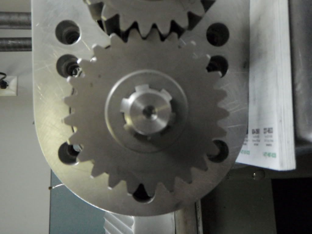

    A bit more to add today. I machined the shaft and test fit everything again....it's going in the right direction I think.
