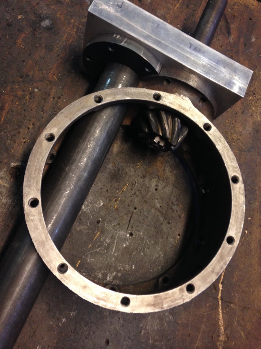

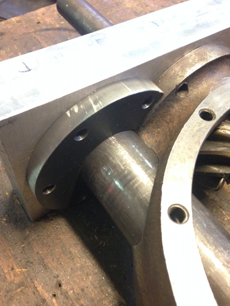

    qc.JPG qc1.JPG Thanks fellas. I will try the local welding supply. Here is why I am asking.....
    I will start a thread on it when I finish. Its an old model a Banjo I had laying around. Thanks again for the inspiration

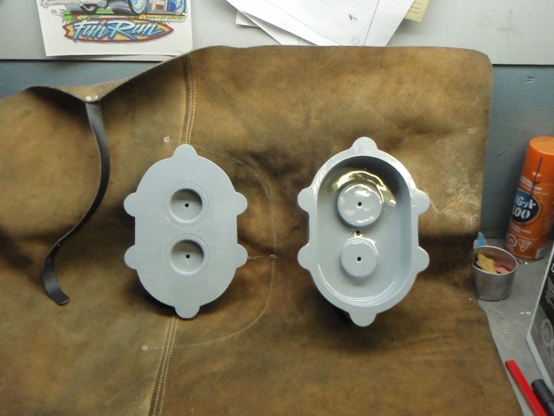

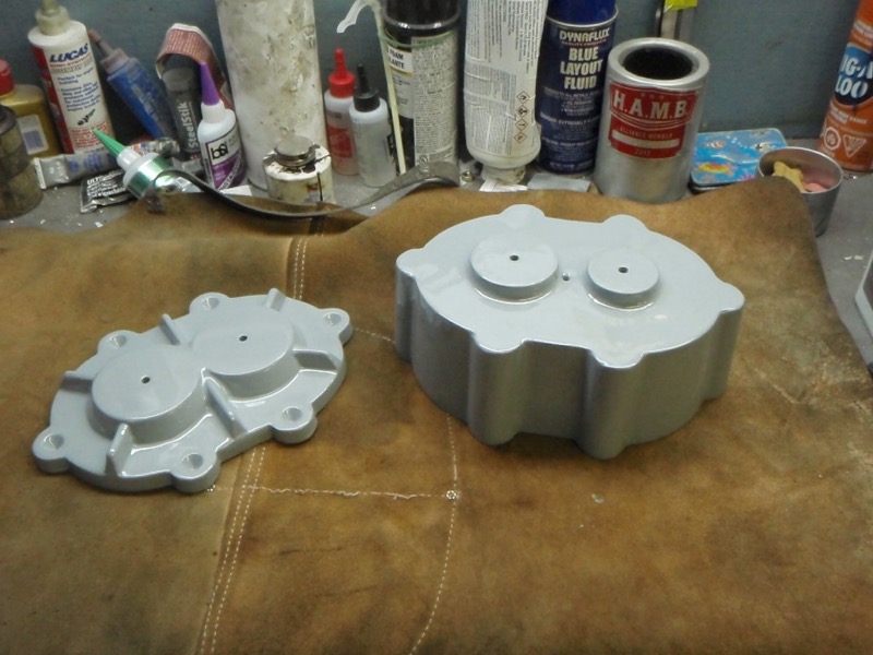

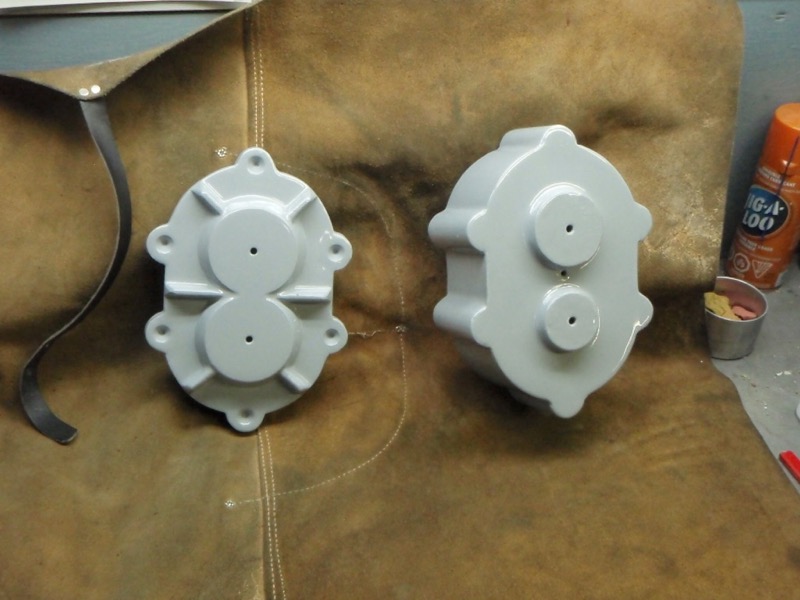

    OK, I'm back at this thing that has been hanging over my head. It's a project that has stumped me and the anxiety of not knowing how to proceed has given me well , anxiety. So I started to do a little sand casting and I have had some failures as well as some good results. The failures are education, I've learned a few things from my mistakes. I was going to make a rear cover and housing as one piece but instead I am making a more traditional style with the housing and cover separate from each other. I have only just got the patterns made and still have to make flasks to cast them in.

    Nice work, and I know less than .02 about casting but I'm a retired machinist and I'll just say don't cast more than one set before the outcome of the prototype machining says to move forward. If you have machining capability and/or know a good machinist that can check finished dimensions and walk you through it I'm thinking you're on your way.

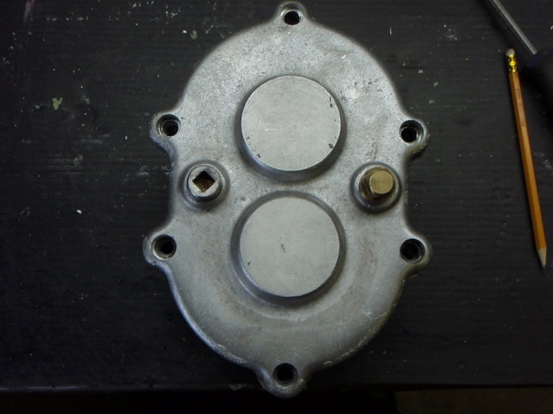

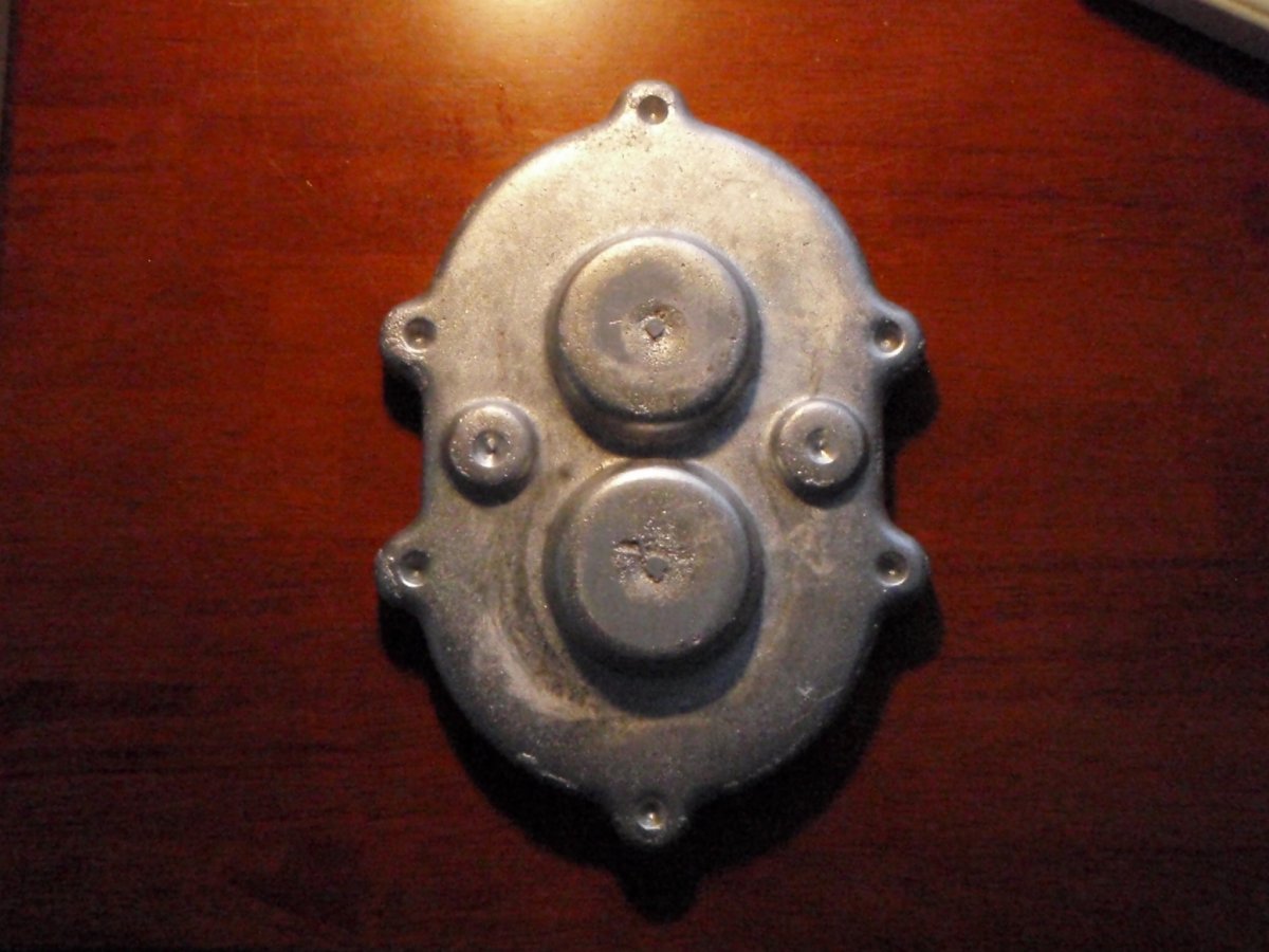

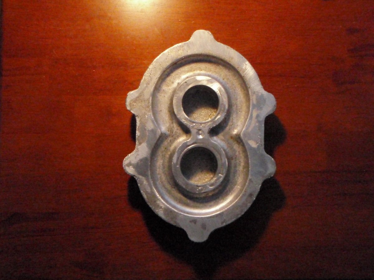

    Just dug this out of the sand. Trimmed and cleaned off , I still have to machine and measure. Don't ask me how my morning went. Anyone who has poured concrete knows what a "blowout" is and how much of a pain in the *** it is. When it happens with aluminum , 1300 degree liquid metal goes everywhere and starts little fires and makes your shop floor have tiny explosions:eek: P1010016.jpg P1010018.jpg

    Are you going to heat treat the aluminum? When I made a new rear cover for a quickchange I had it heat treated to T6 before machining. I don't know if it was needed, I just did it because all the other highstrength parts are treated like that. I haven't run the part yet so I don't have any on-the-road reports.
  16. Jethro
    Joined: Mar 5, 2001
    Posts: 1,967
    Jethro
    Probably not going to heat treat partly because I don't know how and the castings are extra beefy so there shouldn't be any strength issues. The pieces that I've made so far seem plenty strong. When breaking up the old castings to go back in the pot they take some pretty good hits before breaking apart. Not scientific but if they can take direct hits, some thrust or radial stress should be ok.....we'll see!

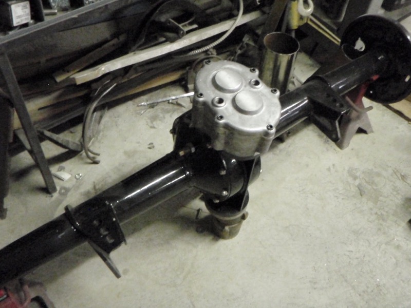

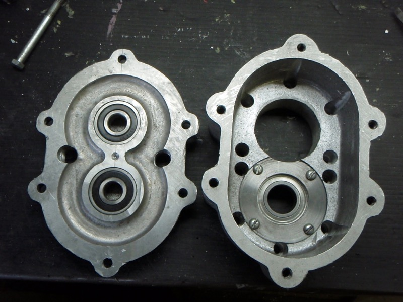

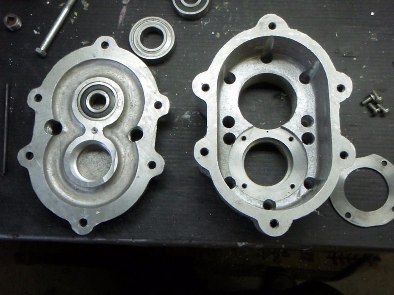

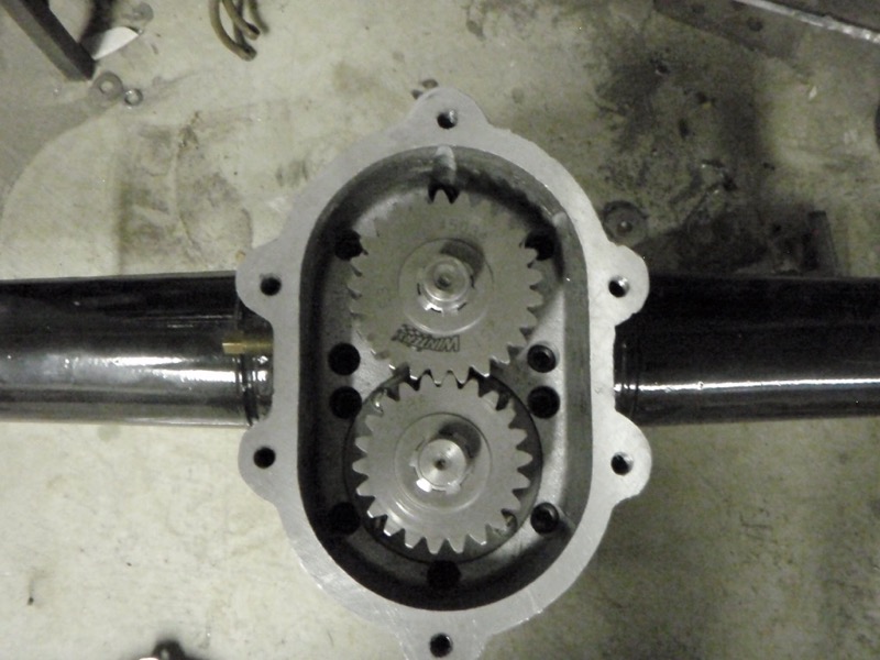

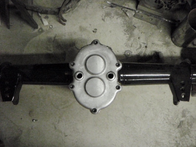

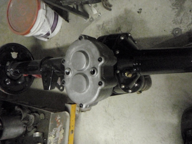

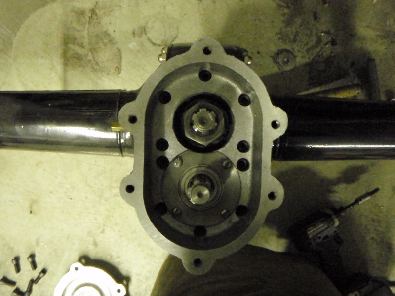

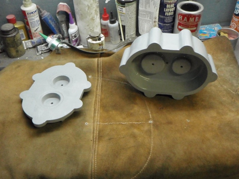

    Things are starting to come together.... QC2 - 1 (3).jpg QC2 - 1 (4).jpg QC2 - 1 (5).jpg QC2 - 1 (6).jpg QC2 - 1 (8).jpg QC2 - 1.jpg QC2 - 1 (1).jpg QC2 - 1 (2).jpg

    I've looked at a lot of rear ends in my lifetime, and that's one of the prettiest ones I've ever seen.

    Looks great, were you able to do the machining yourself or did you farm it out?
