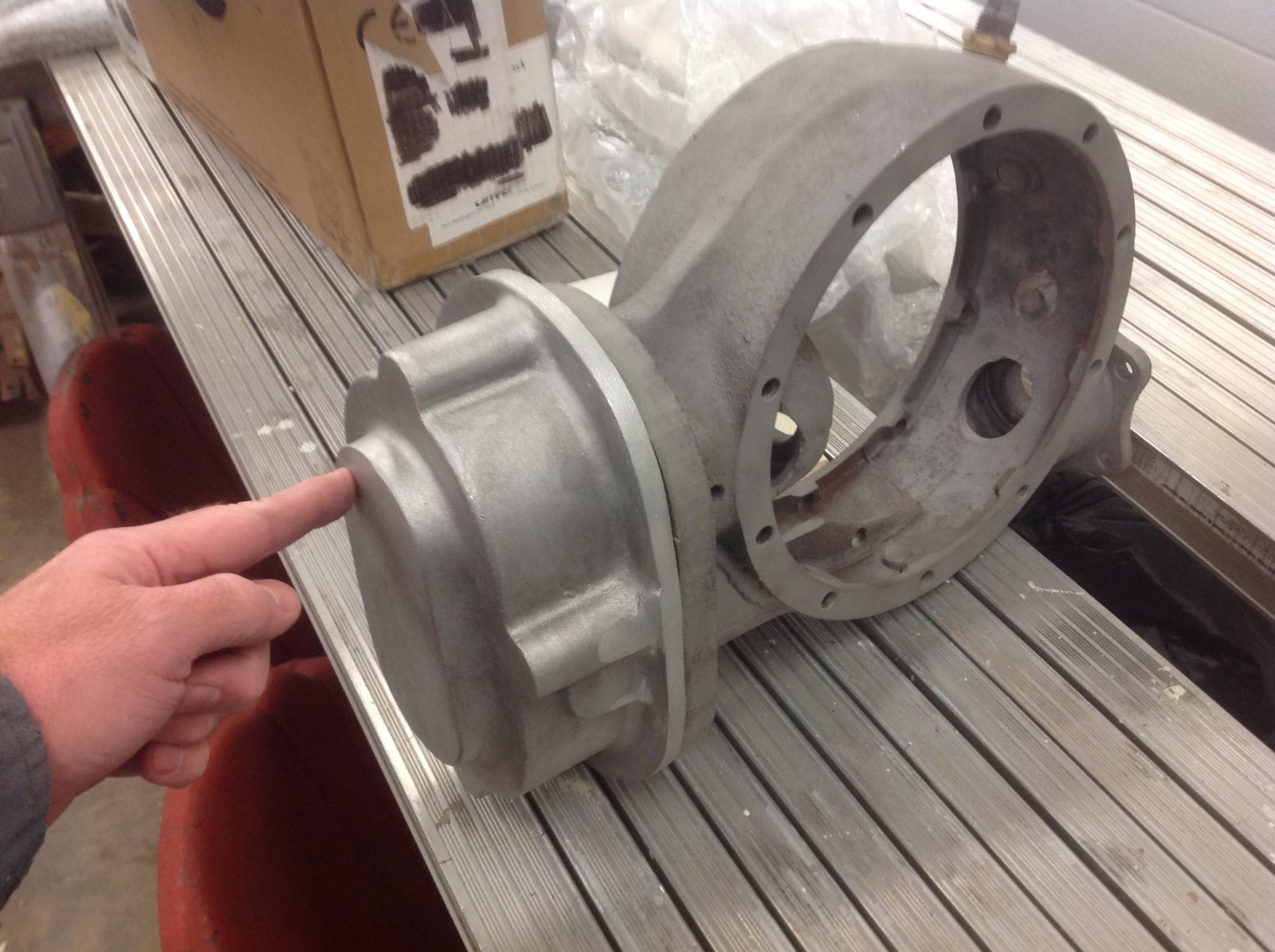

    Just a little update... I finally got the General on the road and have about 500 miles on it so far . The rear works good albeit a little noisy . I had my ring gear back brace a bit tight and when I loosened it a touch my gear noise went away by half. Still noticeable but now sounds like a truck transmission with straight cut gears. I also have a little porosity in the rear cover that I cast. I get a bit of gear oil weeping after a run . Not too bad just have to wipe it with a rag , not enough to drip.
    All in all it was a satisfying project !

    Very cool! I thought there were ribs on the cover pattern - obviously changed out?

    I had some trouble with that first pattern so I changed it ti the current one.

    So , I have been driving the coupe with this quickchange for a couple thousand miles. No major issues or problems just some oil weeping from the cover which I ***ume is pososity because the gasket area is dry and it only weeps when it's warm after a good drive of an hour or so.
    But there are a few things that I wanted to change , mostly appearance and refinement.
    I spent the last week or so changing the patterns and casting the new pieces. It's supposed to rain the next few days so I'll machine the castings and see what they look like. So far I like the way they look and I'm proud enough to put my name and country on them too. 20231103_170058.jpg 20231103_170107.jpg 20231103_170125.jpg 20231103_170156.jpg 20231103_170205.jpg 20231103_170222.jpg
