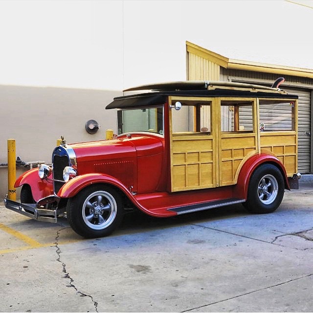

    If we're on to wood PU beds, I've seen this one that I appreciate the workmanship on at a few shows up my way. Not sure who it belongs to though.
    Here's a shot from the gathering of the Faithful '18
    and another from the Ty-Rods '18 show:

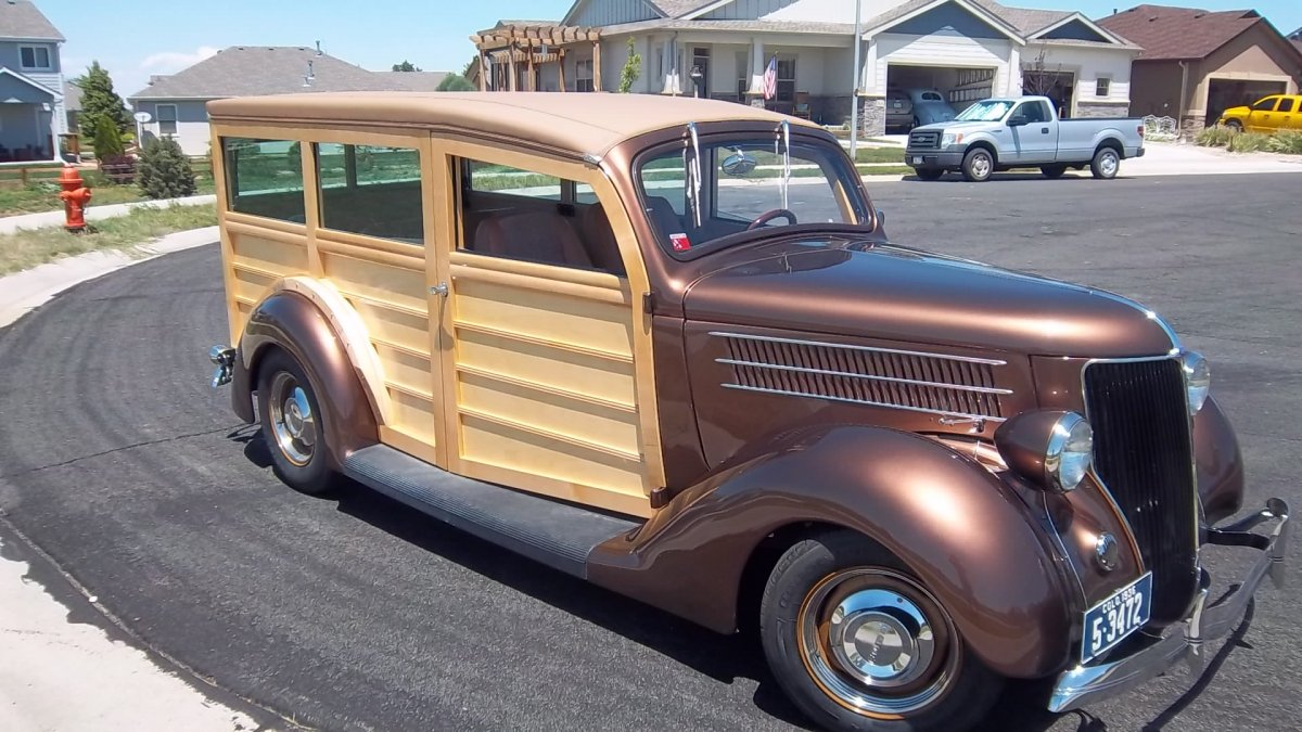

    my 37 before paint and after paint. built by myself dan dubs and carl kunkle thumbnail_GetAttachment4 (1).jpg thumbnail_Resized_20200914_183155.jpg thumbnail_Resized_20200914_183206.jpg thumbnail_Resized_20200914_183248.jpg thumbnail_Resized_20200914_183309.jpg unkle. painted by Melvin naramore

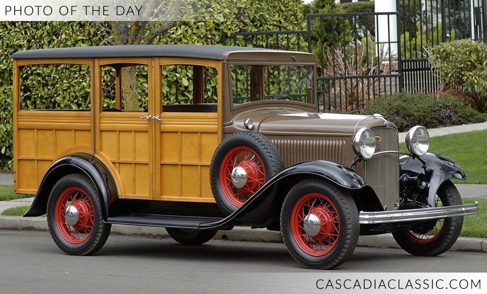

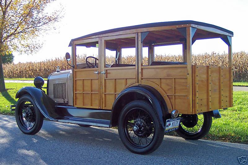

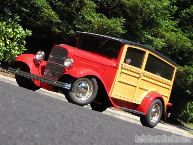

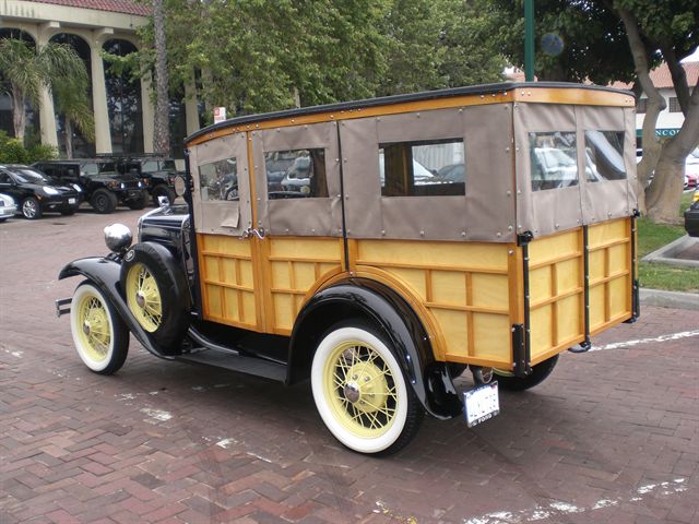

    Don’t know about homemade or not but fun to look at.
    I guess second one more of a huckster than a woodie?

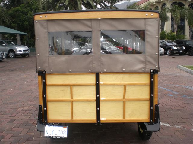

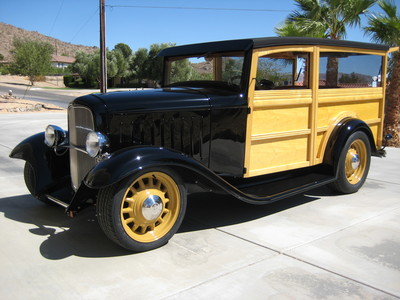

    I really like this one and would have loved to have been able to pull the trigger on it when Tony was selling...
    The bamboo and gr*** is just plain fun...

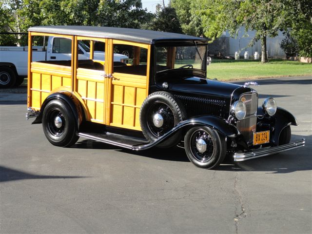

    My friend Mike from Sacramento has this 29 he re-built. HPIM1262.JPG DSC03730.JPG DSC03813.JPG DSC03725.JPG

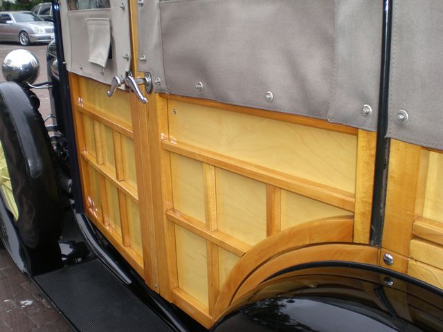

    This is a bit premature, but I'm starting on a '29 woodie, using my coupster door jambs for a template to add a bit of curve and shortening the body, more victoria like. Hence my wooden vickie or as my grandson called it, a"Wooki". I got 8/4 maple from the lumberyard-planes out to 1 3/4" thick. My nephew went and googled "woodie" to see what they were and sent me a picture, which was pretty much in my mind's eye when I started. Now I've got a vision to followI've got most of the wood cut and shaped, same with the doors. The rear spring has been on back order for a year and when that arrives, I start setting up the ch***is. All the joints are hand cut mortise and tenon with some dowels thrown in the doors as a bit easier, countersunk screws and glue, epoxy, blah, blah. Build thread when I get moving on it again.

    I used a set of old sub frames and traced them onto the 8/4 x ? maple. Used the original frame holes to bolt them down, then did mortise and tenon for the uprights and the roof frame. Tried to hide all the screws and everything is getting a coat of West epoxy, then will be clear coated for UV protection. I realized all of the 'build so far" pics are on my phone, just need to load them on the desk top, then I can start a thread. Moving very slow since my build space is used by management...

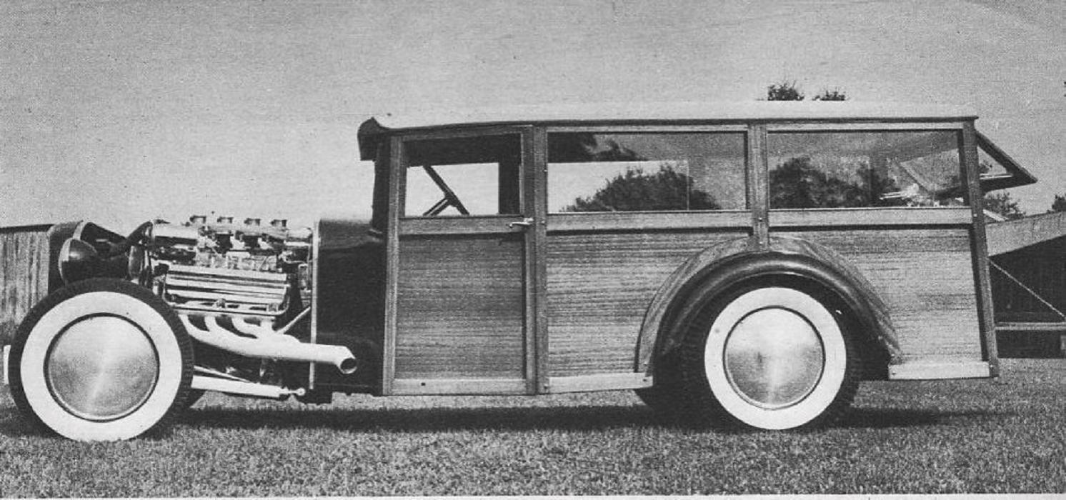

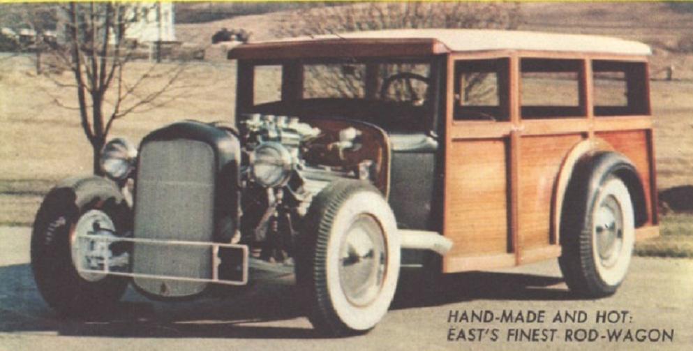

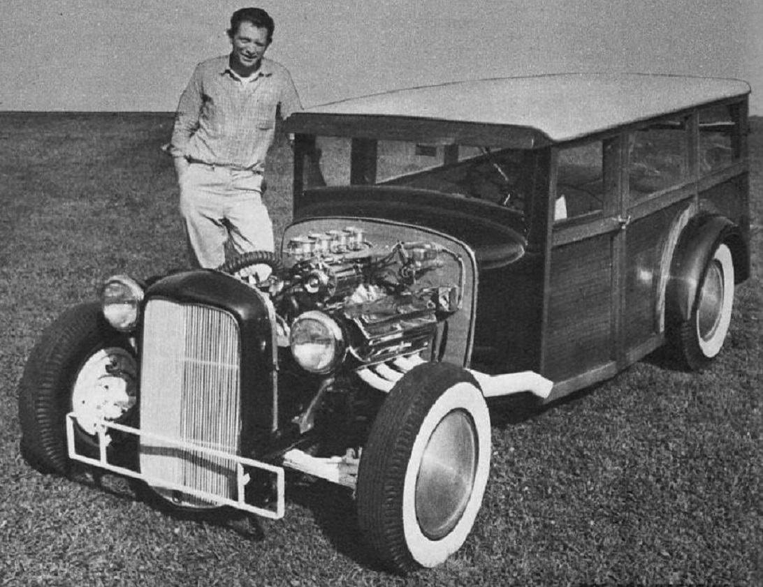

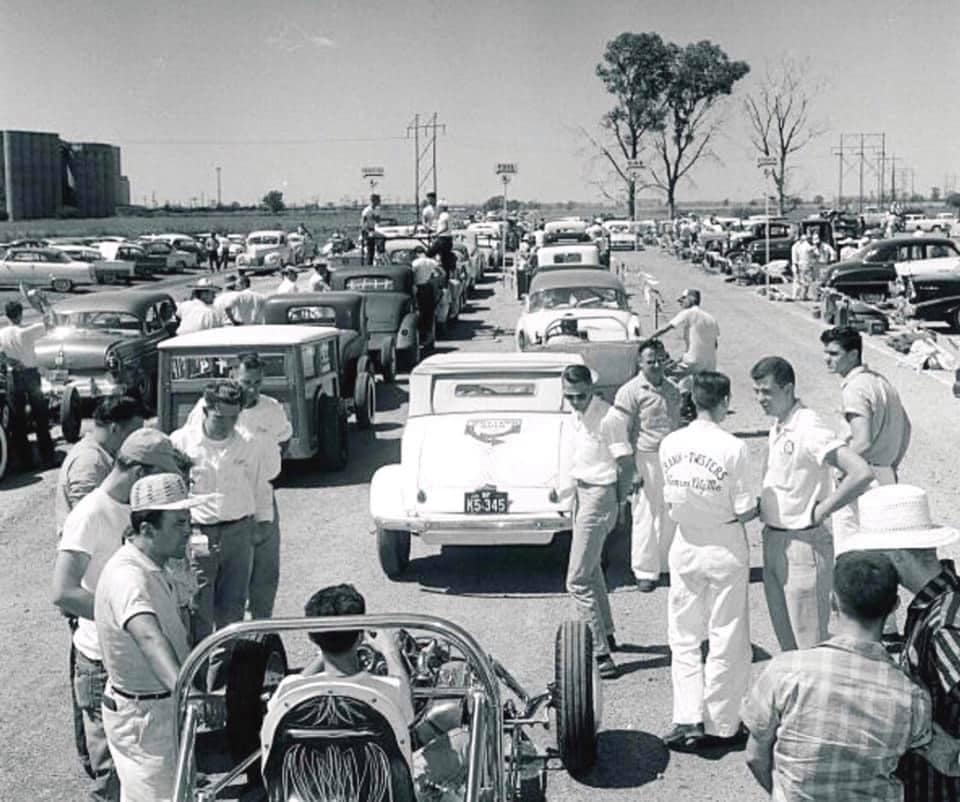

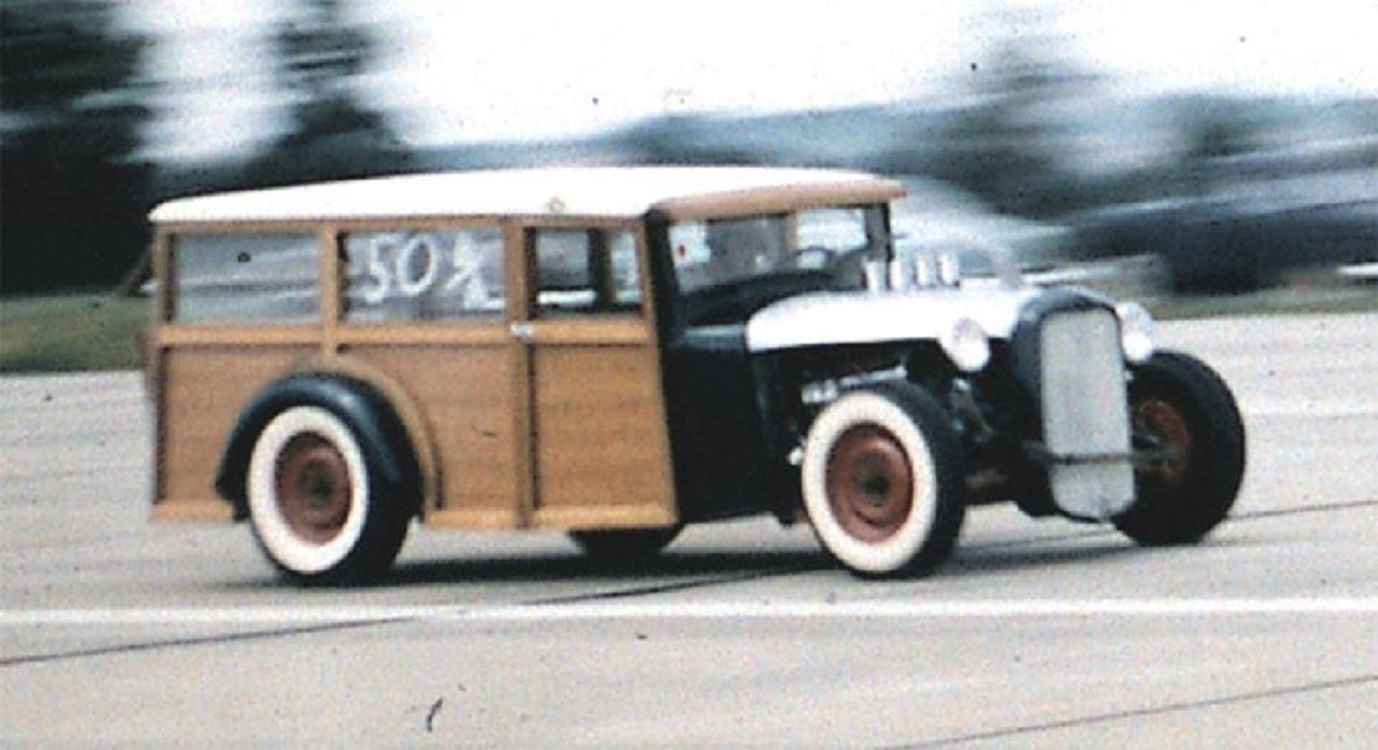

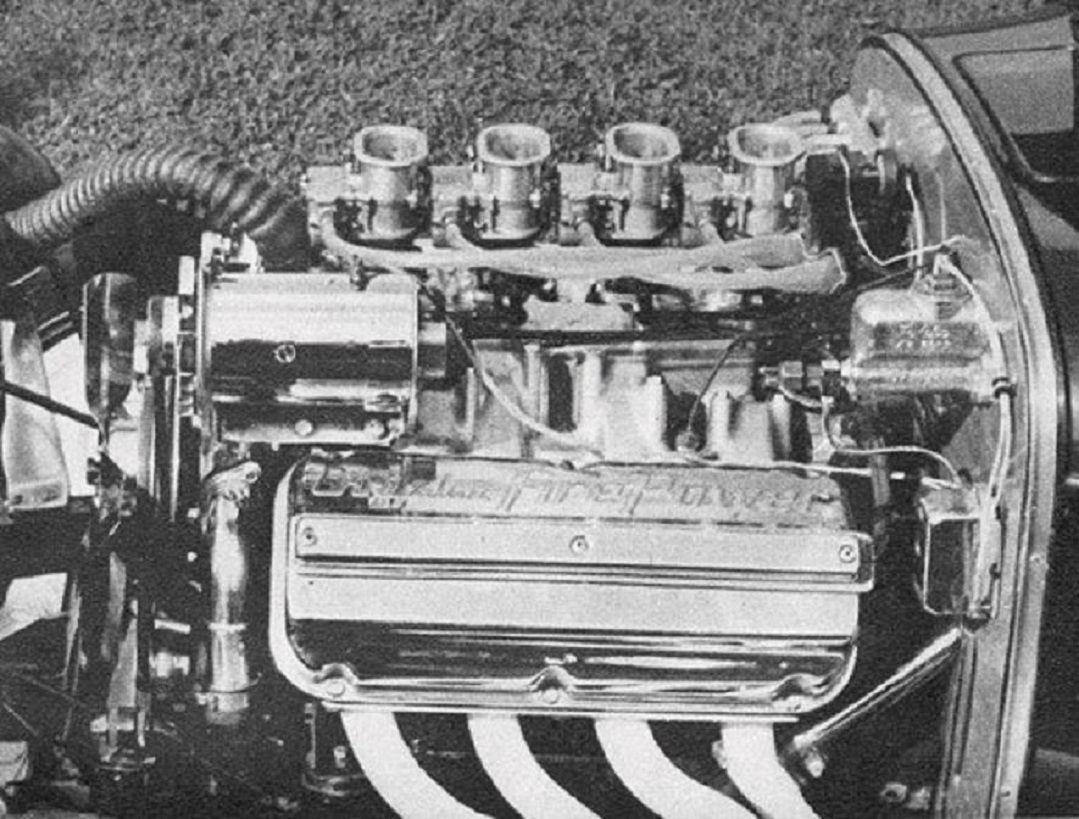

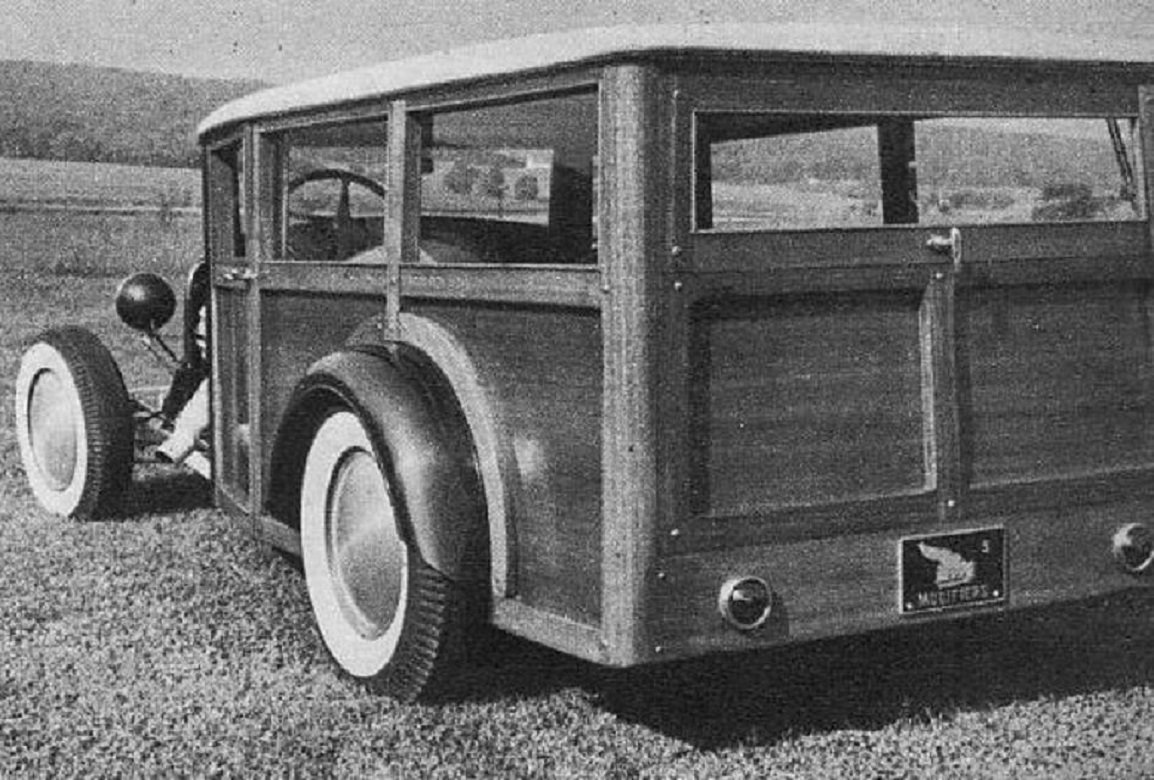

    My favorite woody. Discovered on the HAMB in some 1956 ish Allentown PA airport drag photos. John Good bought the wagon for $50. Invested $1450 on the body and drivetrain. Chopped and channeled, new Mahogany. '40 Lincoln front axle & brakes. 354 Hemi, 4 carb intake, Ford floor shift with torque tube rear. Last photo is the latest one I could find from maybe 20 years ago.
  19. Somebody should have left that car alone.^^^^^^^^^^^^^^^^^^^^^^^^^^^^^^^^

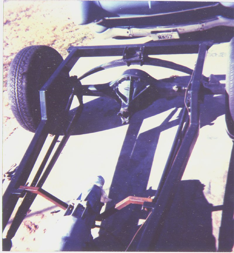

    475759176_10228316123553803_2257650393457825263_n.jpg 475914422_10228316123273796_6037436583503451186_n.jpg woody1.jpg We are just getting started on mine. I bought a frame from Brookville and we are using a 32 roadster pick=up cowl. Rootlieb hood, posies springs all around. I built a 1x1 steel frame for the body and we are using that to anchor the wood to the frame. All custom built.
