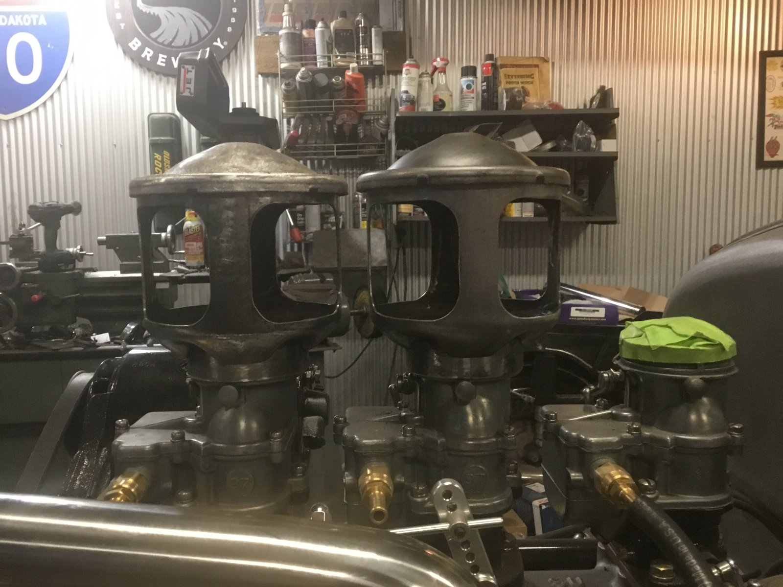

    I post this on my build thread but thought I’d share it here. My pops and I are knee deep in a father/son 26 T roadster build. We both like traditional hot rods and I especially like to use parts the look traditional but are sort of off the wall. So on this build we have a 296cu 59-L with three carbs. My pops took care of the motor but his engine builder took the liberty of ordering frog mouth scoops. My pops and I both have cars that run scoops so I want to do something different. The other day I was looking at a flathead oil canister and thought damn that’s about the right diameter to fit on top of a carb. So after some cutting this is what I came up with. I ordered some stainless mesh and will powder coat the steel black. Now I have to find ant air filter element that is ruffly 4” across and 3” tall. Other than k&n what other company have a washable filter? A08CCE6A-9842-42BA-9CF3-5D1BC9F2C21A.jpeg A4BB16BD-F626-4AF1-80A5-29E154ECF5A1.jpeg 207373E2-62E3-4ED0-8220-D6D97E0B4B95.jpeg 09A13CBF-3517-4D19-BCA0-F9788F71C9DD.jpeg 12010B9E-9833-454E-A4E3-3699B19BCDB4.jpeg

    Nice, what did you use to cut them out?

    Laid them out and used a unibit in the corners to get the round then used a small cutoff wheel to cut the rest out. Lots of die grinding and sanding after that.

    It appears to me the screen is a dbl layer. Correct? What mesh did you use?
