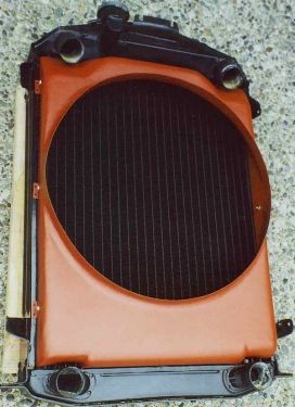

  9. Here is one that was made to fit my 32 Radiator shell also at the bottom flaps were installed to let some of the air escape. Works well here in Arizona.
