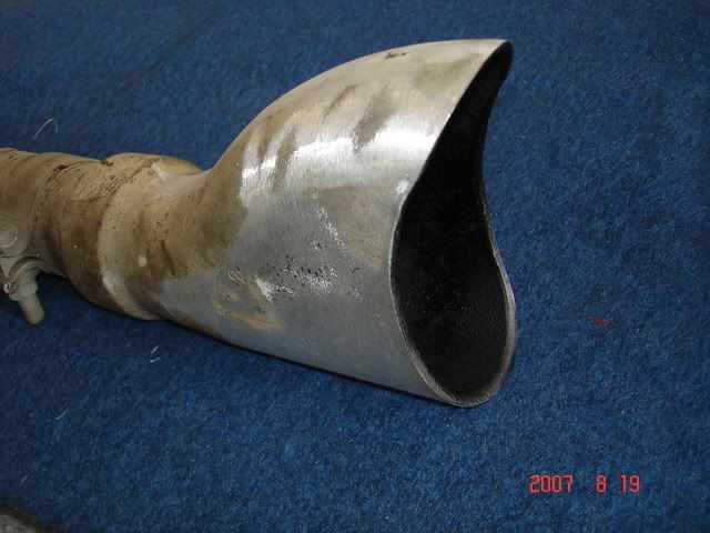

    Ive been looking for some fishtails and all I can find are the ones made for motorcycles that are like 1-3/4" diameter. While Im at the swaps I'm always looking for stuff to make something cool out of. I ran across these cast aluminum exhaust tips that I think were off of a trans am. Looked like they would work so I finally got some time to play with them.
    After cutting with the band saw ( hope this makes some trans am restorer ill :) )
    After adding some elbow grease with a file to remove casting lines and cast in numbers, and a little belt sanding (lots more to go)
    Im just hoping I can keep them from having that 'Billet' look.. but then I could probably make a few bucks on them on Egay.

    They fit over 2-1/4" OD pipes. Heres a pic after some grinding with a 80 grit disc

    Big end is 3" by 5-1/2"

  25. Brilliant Lobucrod! Simple and effective. Great job!
  26. Lobucrod
    Joined: Mar 22, 2006
    Posts: 4,121
    Lobucrod
    Alliance Vendor
    from Texas
    Can you say Big Mouth B***! PIcs a little dark but you get the idea. They're sticking out a little too far right now but im putting the bumper back on later, Tucking it up close. I think they'll be just right then.
