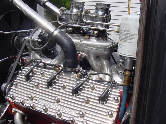

    How the men do it.No not me flat 32 sometimes on hamb did this, also did own heads.
  27. budd
    Joined: Oct 31, 2006
    Posts: 3,478
    budd
    boy thats nice, alot of work, have any pics of the head tooling? anymore info around on this job?

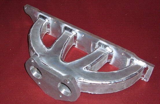

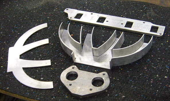

    Yup... When no one makes a manifold for your engine, because it isn't a HONDA...
    Here is Mine...
    Started with some 0.75" 6061 T-6 plate and a Intake gasket.
    Ended up with this... After a few math calculations for length of the runners and such...
