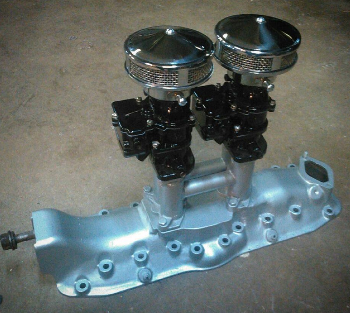

    I wish I had taken time to take pictures. When you mill the top of the intake it opens all the chambers. I had to isolate the heat riser portions from the fuel charge runners. It was a fun learning project but most likely more work than worth. Once I start something I have to see it to the finish.

    Thank you. The manifold turned out to be so much work not sure I would suggest tackling one. The air cleaners I make myself.

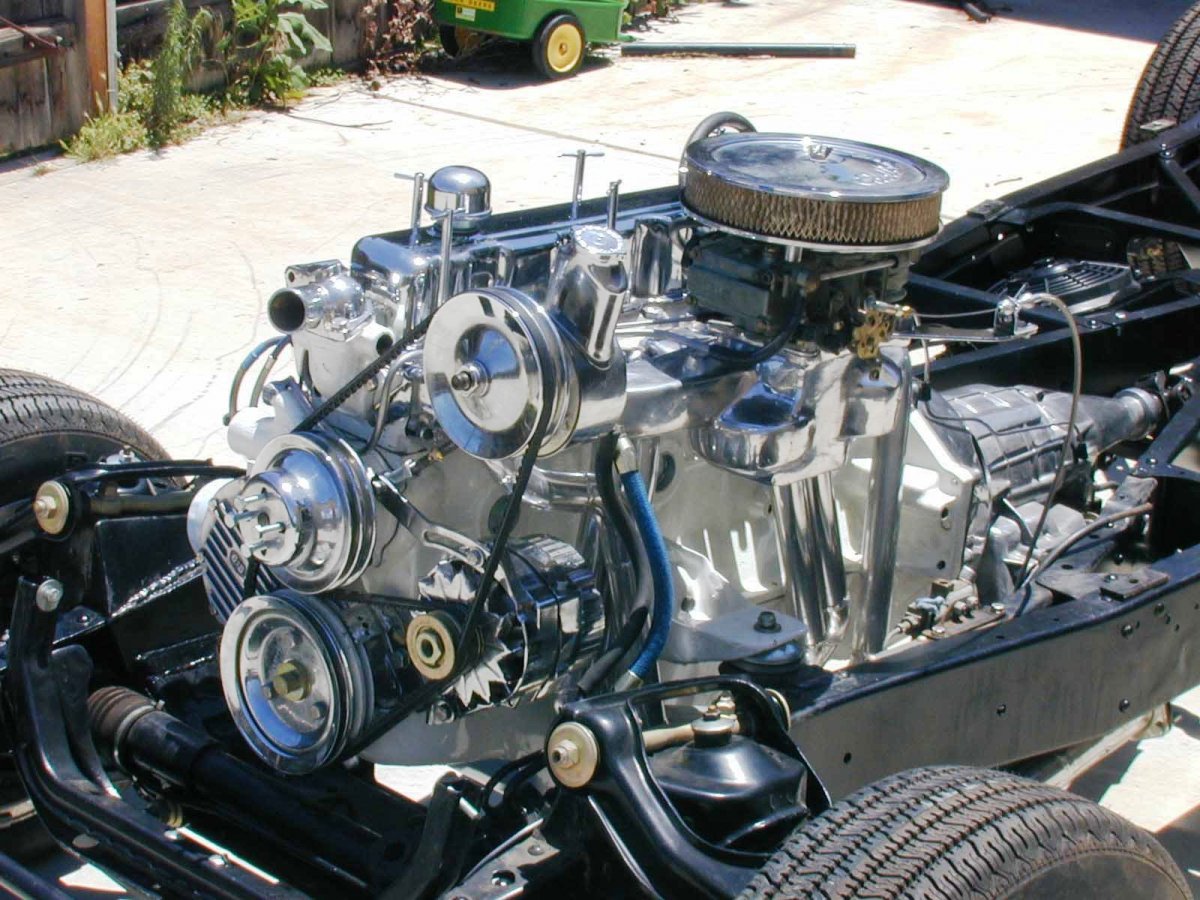

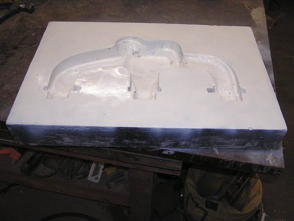

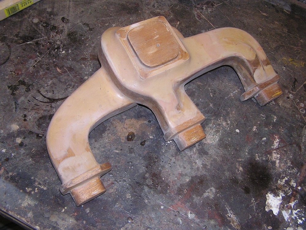

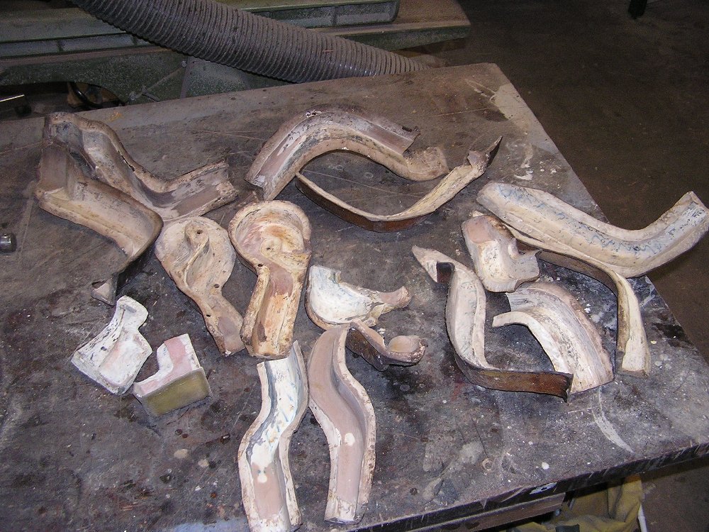

    When there is no part on the market for what you want you have to DIY. I wanted to convert my 230ci Chevy straight 6 to divided port, 180 degree, 4bbl carb induction. Closest thing out there is the Clifford manifold but it is basically a plenum manifold, not what I was after. I decided to try to make a manifold myself. Here is a series of photos showing the result. It works great! I was lucky to have a local outfit that did sand casting using my patterns, they have since gone out of business.
    I first drew up the manifold so I had something to go by.
    Then I carved the manifold exterior in mahogany.

    I cast half the manifold in fibergl*** to help make the core mods for the runners and to help in making the casting mold.

    Then I made plaster models of the runners by layering modeling clay into a plaster casting of the manifold wooden model then casting them in plaster of Paris. The runners are tortuous to get equal length for each.
    From those plaster runner models I made a series of fibergl*** mold into which the core sand can be formed.

    I took all this to the little local foundry and they cast my manifold.
    That's the best photos I have of it. I since sold the car so don't have it available to take better pictures. Here is the manifold on the car.
    Of course I had to modify the head by brazing in flange dividers and casting in deeper dividers in the Siamese ports using liquid steel.
