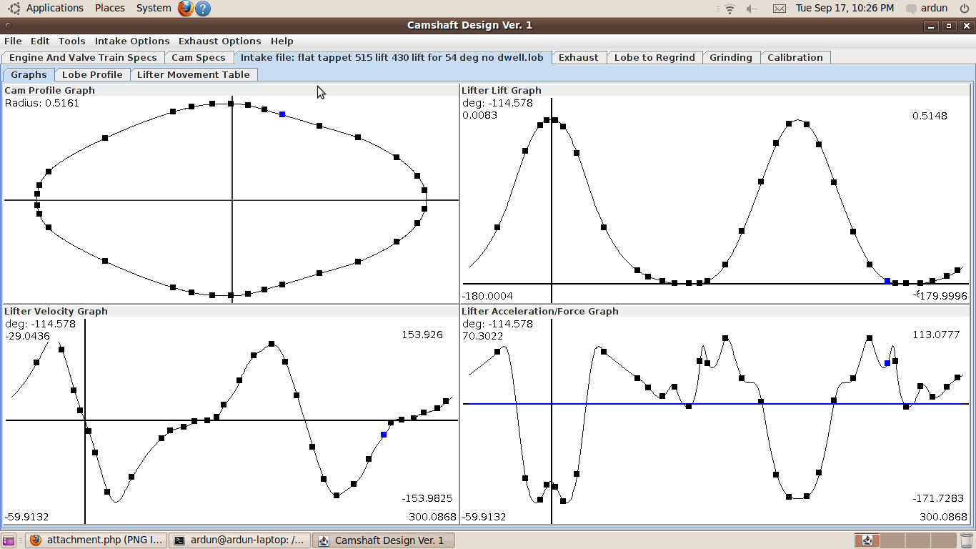

    Yes, attached is a quick (5 minute) roughed out 1/4 spd cam. The program outputs the crankshaft duration for the left lobe only and it's for a 1/2 spd cam, so just multiply it by two.
    There is no option to have the right side of the lobe match the left side and vice versa, so it would be more time consuming but completely doable. It wouldn't be too hard to add the extra code to add this feature and the feature for calculating 1/4 cam crankshaft duration.
    Thanks for the input.
    Kipp

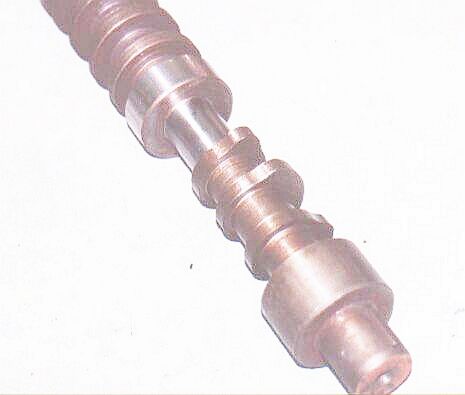

    Here's a pic of a prototype 1/3rd speed cam for a Pontiac V8.
    The middle lobe is the injector for Bosch type injection.

    What does one gain by slowing down the cam rotation? My first intuition suggests that it would make the ramp/acceleration issue worse, or am I not thinking straight this morning?

    Did you really mean to say 1/3rd speed cam? Try as I might I can"t wrap my head around that.

    Yes, cam turns 1/3 of crank.
    The engine has a normal carburetor plus injector ports in the block just below the deck.
    Special long skirt pop up pistons.
    Normal intake stroke.
    Normal compression stroke.
    Normal power stroke.
    Normal exhaust stroke EXCEPT,
    at the approach to top center of the normal exhaust stroke, the exhaust valve is still closed and at this time a shot of fuel is injected causing the fuel to ignite from compression and the hot exhaust gas still in the cylinder.
    The result is a second power stroke.
    Then a normal exhaust stroke.
    Hence the name, 6 cycle engine.
    We built several V8 Pontiacs and a couple Pontiac 4 bangers like that.
    The V8's were used for small mining operations put on a large skid with air compressor, generator and shaft PTO. They were dropped into remote locations by helicopter.
    The 4 bangers were used for racing but never did well because they were way to heavy.
    Bruce Crower was working on a small 1 cylinder engine with the same setup several years after we developed ours.(mid 60's) He was amazed to find out he wasn't the first to try it. He wouldn't tell me much about his when I talked to him about it.

    What I don't understand is. When the crank turns one revolution the cam turns 1/3rd of a revolution. When the crank turns two turns the cam has turned 2/3rds of a turn. I guess now all of the "Normal" events have taken place. Noe the crank turns another turn on the injector, without introducing more air? And that's another power stroke? Then it all goes back to the start? OK I read it again and that is what you said. Is this a really lean burn engine?
