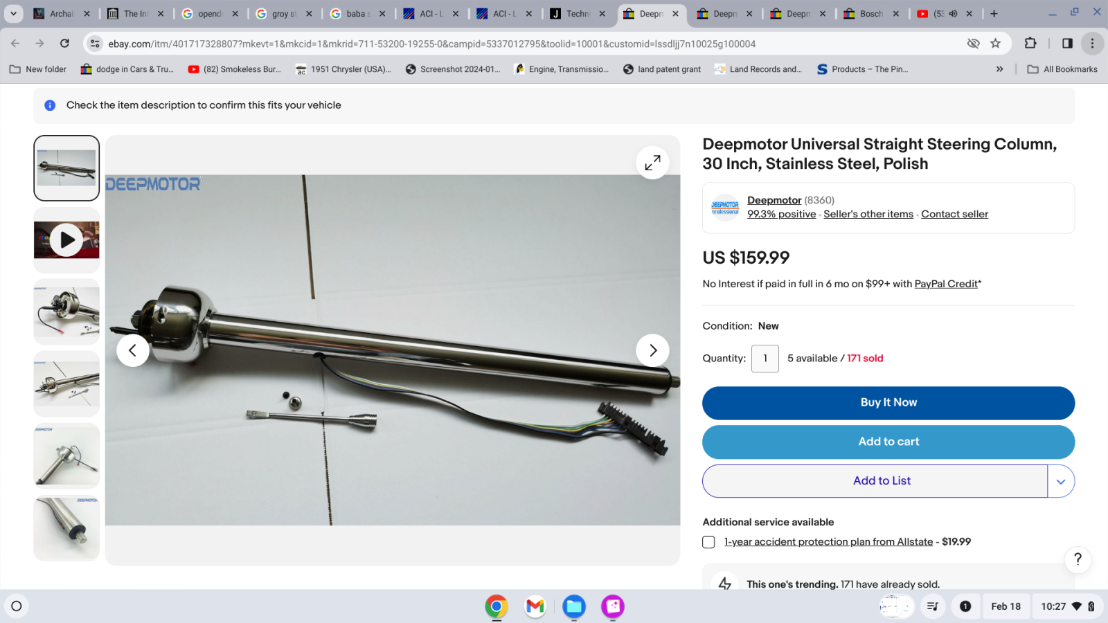

    This might work out for your build...you get the directional to boot.......................they come in different lengths... Screenshot 2024-02-18 10.27.34 PM.png
    Chadcamo likes this.

    I’ll have to check that out. For $160 bucks that might be the way to go.

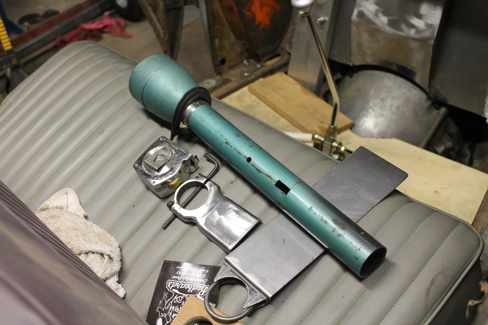

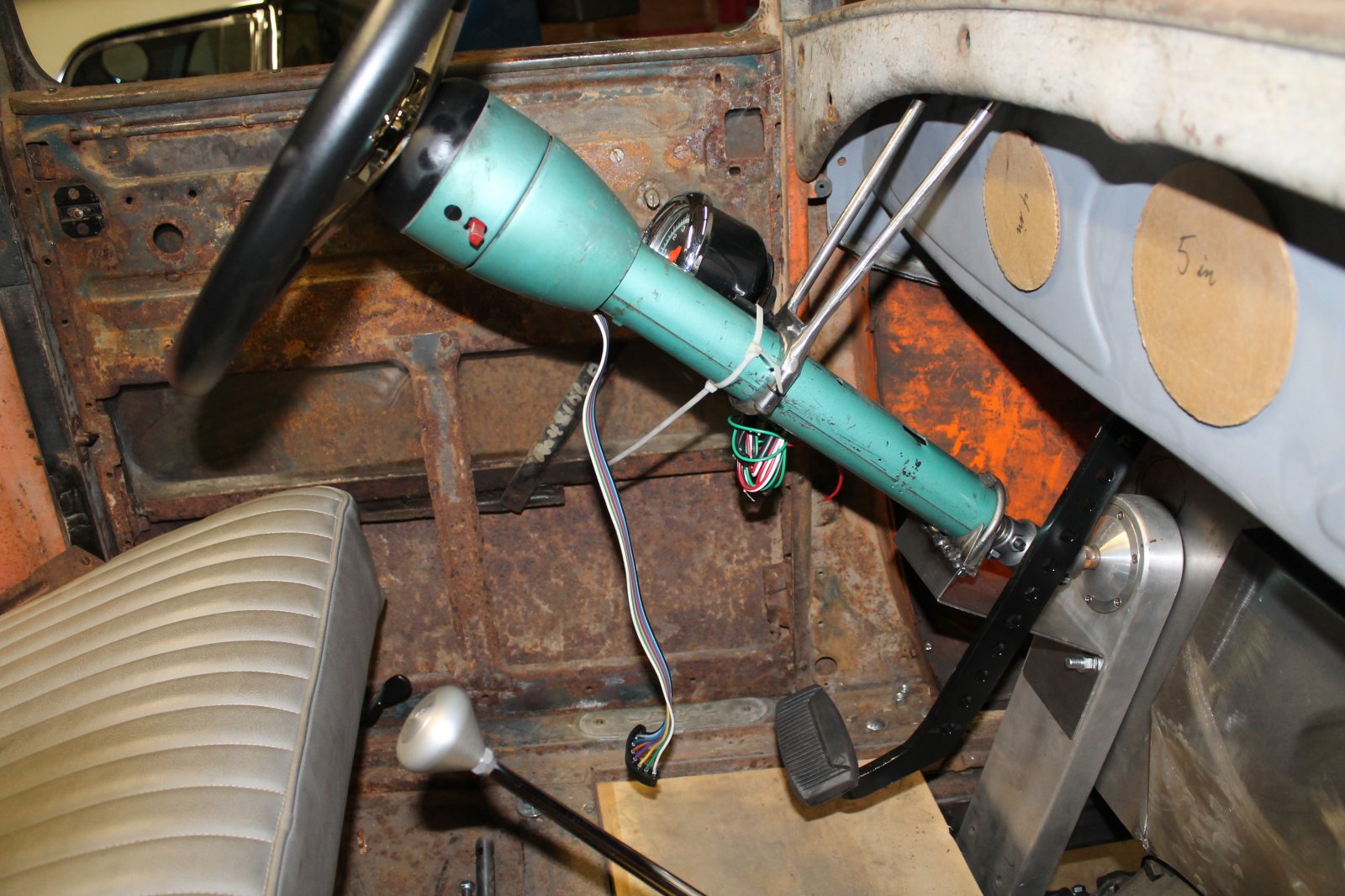

  17. Since eveyone is offering an alternative column.....look at Jeep DJ (postal jeeps). They look old, have nothing except a minimalist horn contact, are slim and have a GM 36 spline output (plus there's repo parts).
    KevKo and Chadcamo like this.
