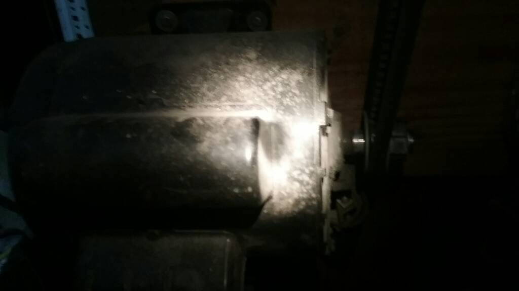

    Speaking of inexpensive things this is a Dayton mandrel set, mounted on s**** 2x12s about 4ft high bolted to a garage post, slot for v belt goes down to a 1hp motor that I put a large adjustable tension spring on it. Stuff I had except for the LED light above, mandrel ordered eBay has grease fittings. It won't stall no matter what! Grinding & wire wheel. Sorry for poor pictures, lightning knocked out our power just now for a little while. 20180527_213613.jpeg 20180527_213623.jpeg 20180527_213700.jpeg

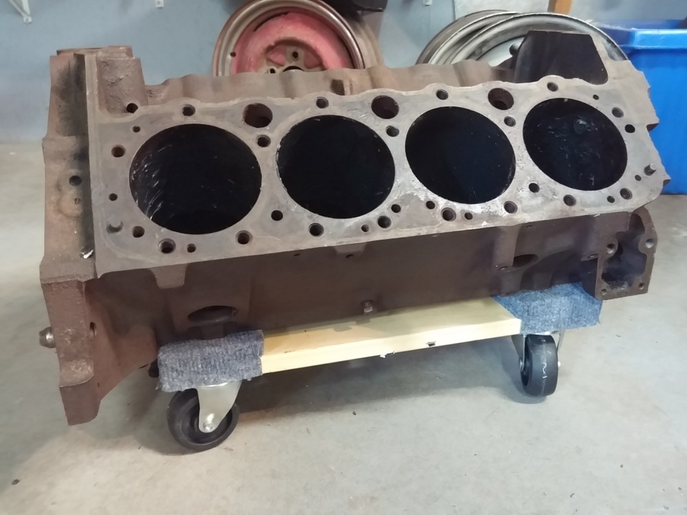

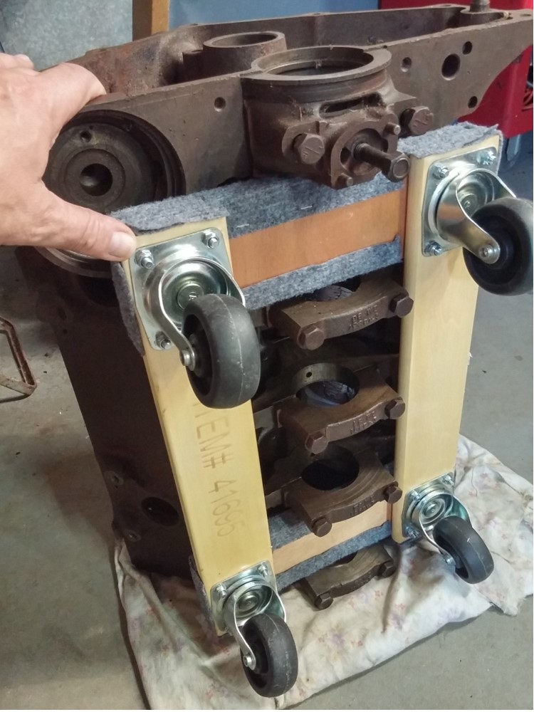

    Great idea, those moving dollies are handy. They also work great without any of your carpentry skills, if you happen to have a bare SB Chevy block you want to store and/or roll around.
    This one came from Northern Tool - cross pieces fit between the main bearing caps perfectly.
    cart_1.jpg \

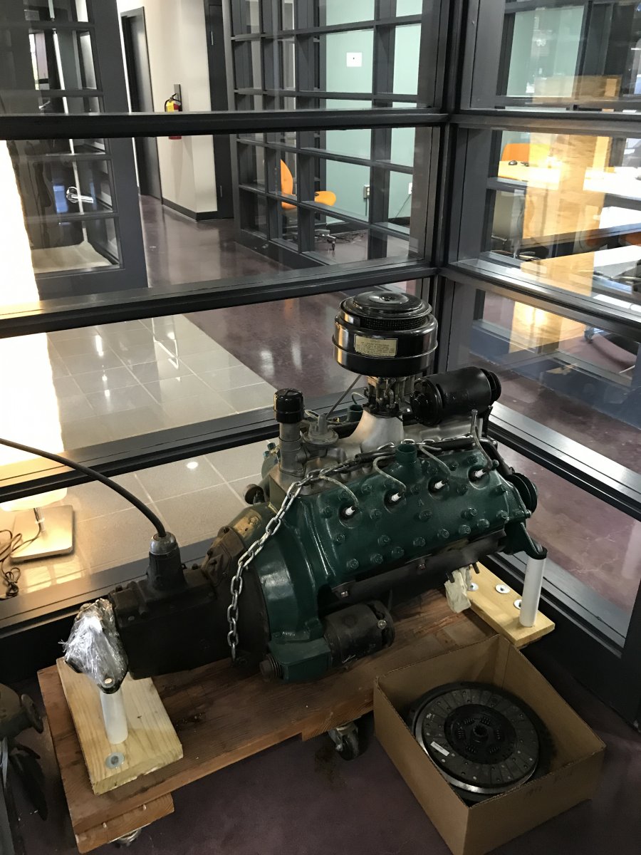

    For my flathead, I built a platform with six wheels (only 'cause I had them) then used schedule 80 pvc pipe to support the engine off the platform. The rear of the engine is bolted through the bell housing flanges and the middle of the pvc pipe. The from of the engine uses l-brackets used to secure the bottom sill of a house on the concrete foundation. I flipped those upside down with the short "L" though the water pump engine mount holes.
    That's my rebuilt pressure plate and clutch disc for the 320 8 cyl in the box on the floor.

    Kbgreen, I bet you own that place, the Flathead seems so out of place.( looks good in my opinion). Know why the cellophane is wrapped around the transmission.... that stuff stinks, especially the older stuff. Had a Columbia rear end, open, in my mini-van for two days, stunk pretty bad. Bones
  26. kbgreen
    Joined: Jan 12, 2014
    Posts: 359
    kbgreen
    It's my office and it belongs cause we all get art work in our office, right boss? The whole set up has been rebuilt and has new grease so it doesn't smell that bad. In moderation, some of car smells put me back in the garage. I mostly wrapped the rear open end to keep dust out.

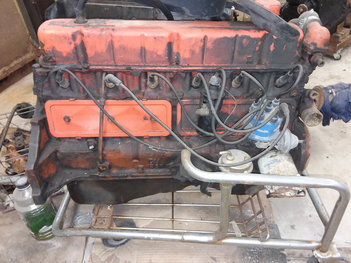

    We made a 1” wide, angle iron rectangle welded together and attached to steel roller skates for our 1960’s version of a motor cart. We had extra angle iron and of course steel roller skates that were not being used. If we needed more height and motor stability, we used a strong, steel reinforced, milk crate on the frame.
    This set up held a 283 short block, a SBC long block and a complete 292 C.I. 671 SBC motor strapped down (at different times) with 1” nylon straps from an army surplus store. The metal end hooks allowed quick attachment and release to anywhere on the angle iron frame.
    That set up worked because there was nothing else on the market that would work for us. Plus, if there was a rolling engine cart, it cost money. That we did not have, but time and skill we had lots of it.
    Your current idea is much better as the wood frame roller is an all direction cart. I have one in my garage and it has seen many uses all over the house and garage. My hooks are on the bottom, but will be moved elsewhere. You have plenty of clearance for flip out hooks.
    Our early, steel cart only could go in one direction (not the boy band) and we had to lift the strapped motor to move it in another direction. The steel roller skates were forward or reverse only…
