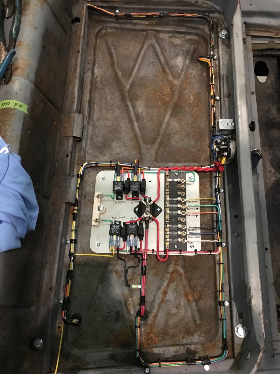

    Beautiful! How did you make it??

    Very simple, nice crimps( it looks like) excellent heat shrinks. Very neat.

    [​IMG]I'll never understand this stuff, but want to know why the red wires on top are twisted and others are not. Bob

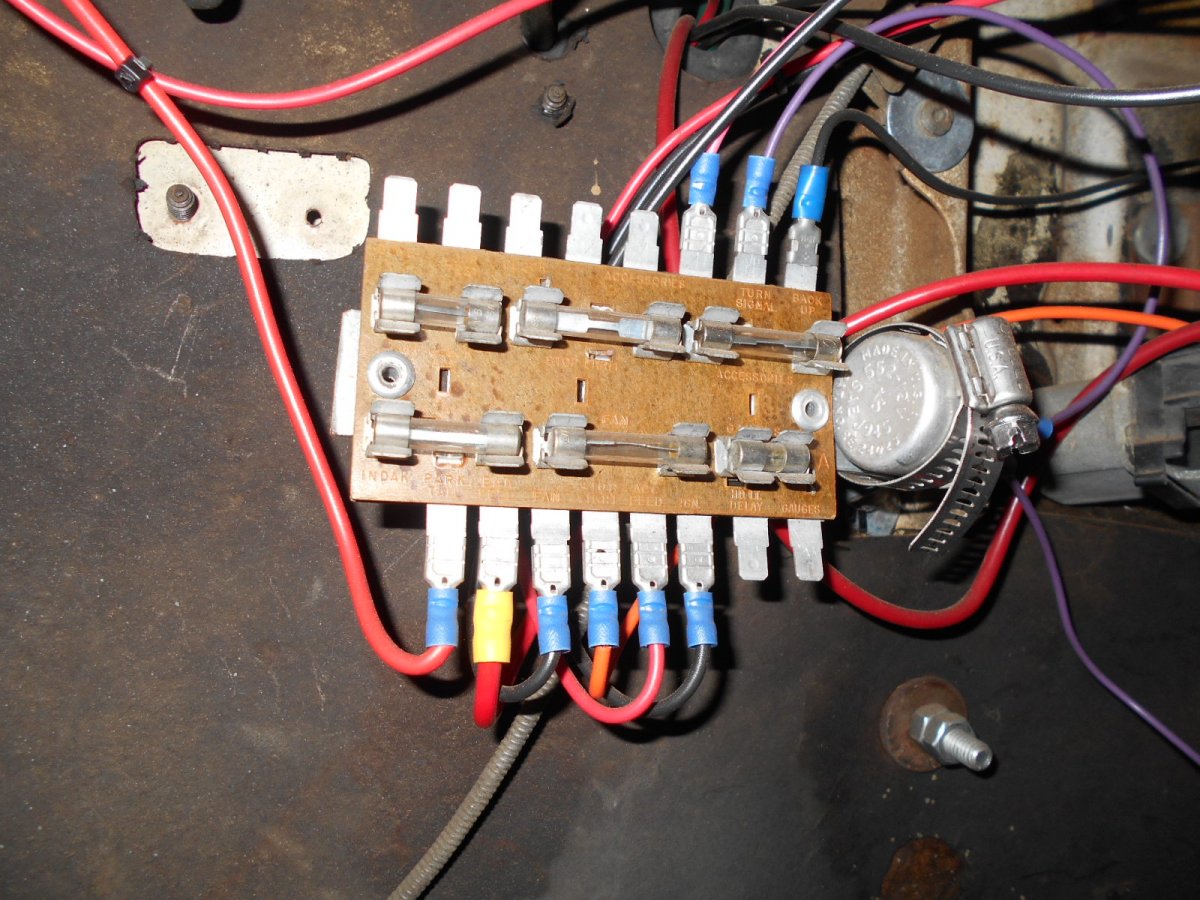

    ...I'm a do-it-yourselfer about everything,..have always used fuse panels from early to mid 60's American Motors cars,...they are clearly marked with input and output terminals and fuse sizes (gl*** fuses),..(not pre-wired, all push on terminals)..they are great for simple hot rod wiring without a lot of electrical accessories....no pics rite now but will get some soon...hardest part mite be finding these panels;..don't know if anyone sells new ones like it.

    ^^^here's a pic...during the wiring process...

    This was the first car I ever wired completely from scratch. I don’t believe the wires being twisted do anything. I just did it because I thought it would look cool.

    Thanks, so the red wires serve no purpose other than looking good? The more I read the less I understand. Bob

    No problem.
    The wires themselves serve a purpose. (Haha) The fact they are twisted......no. 1 wire is Battery power to ignition switch. Other one is ignition power to fuses on that side of fuse panel.

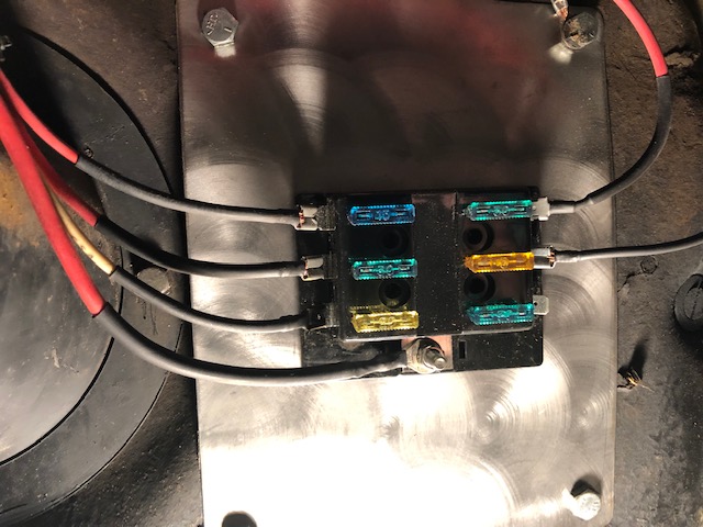

    [​IMG][​IMG]
    This should work! Worst that’ll happen is I burn the car down and loose all hope

    ][​IMG][​IMG]
    This should work! Worst that’ll happen is I burn the car down and loose all hope.
    It can't work, looks like you need another mile of multi colored wires. Bob

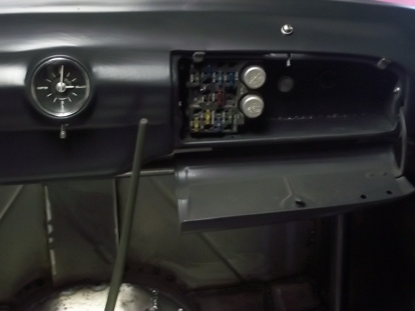

    Like many of us I do all my own wiring, some from scratch and lately a few from kits. My A is getting a Nova fuse block and my own wire loom using labeled wiring that I purchased from Rebel in bulk. Call me **** but I just like it to be a custom loom the way I want it designed for the vehicle I am working on. Along the way I will do***ent all of the wiring into a wiring manual for the next guy to reference. My fuse panel is mounted in the glove box where I can easily get to it without killing my old back.

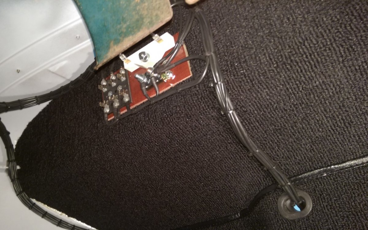

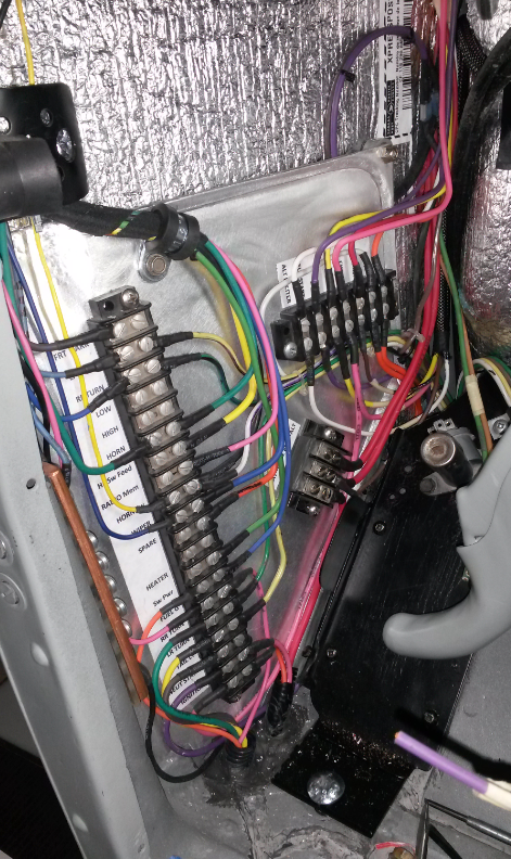

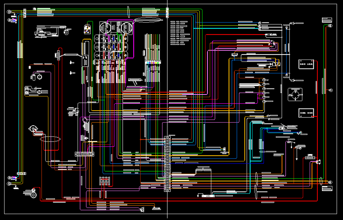

    Drew this up for my Model A coupe. Used a Rebel kit, basically a economical way to buy all the different coloured and different gauge wires.
    Fuse panel mounted above the recessed fire wall insert. Silver box is sender unit for the SW 465 tach.
    Ignition switch and headlight switch and power outlet mounted under center of dash.
    Terminal strips mounted in driver side kick panel on a aluminum plate.

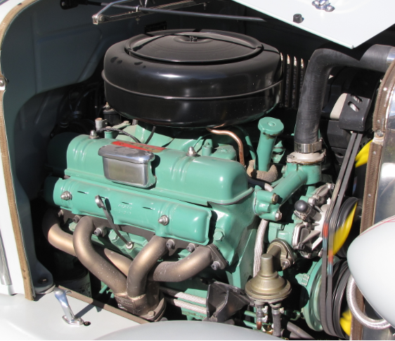

    Engine wired.
    Unfortunately can;t find a shot of installed fuse panel.

    What is the reason the orange wire is running through a copper tube?
