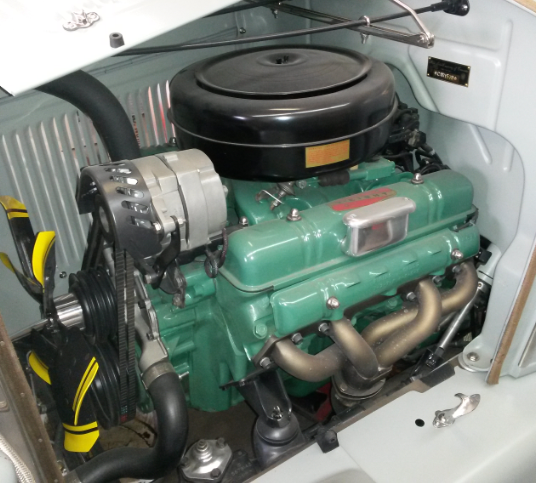

    Not a tube. Actually a copper plate about a inch wide by six inches grounded to the engine. Plate is drilled and tapped for No. 10 screws, can see a few heads showing. Just a convenient source of a good ground connection.

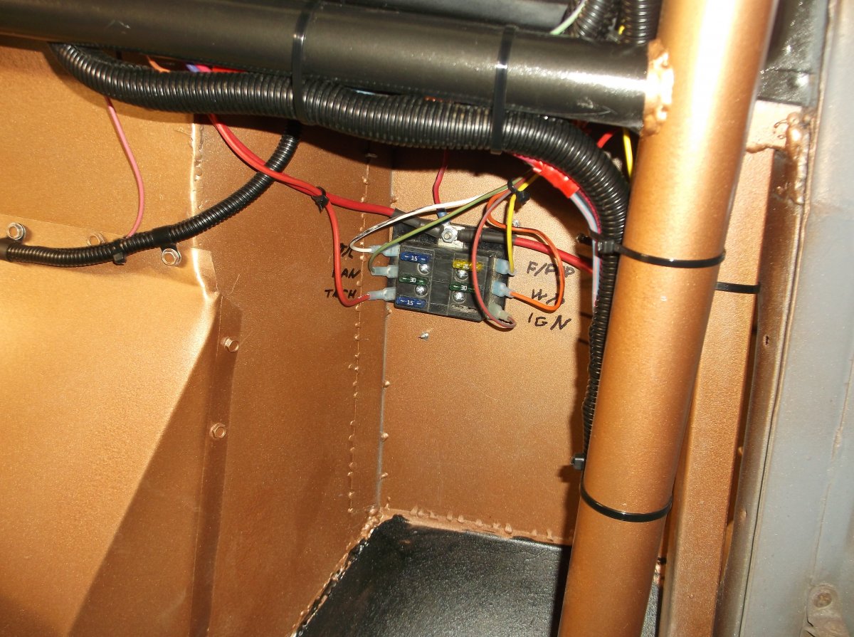

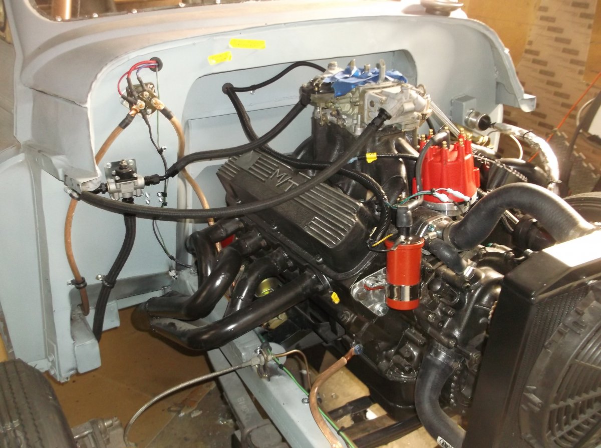

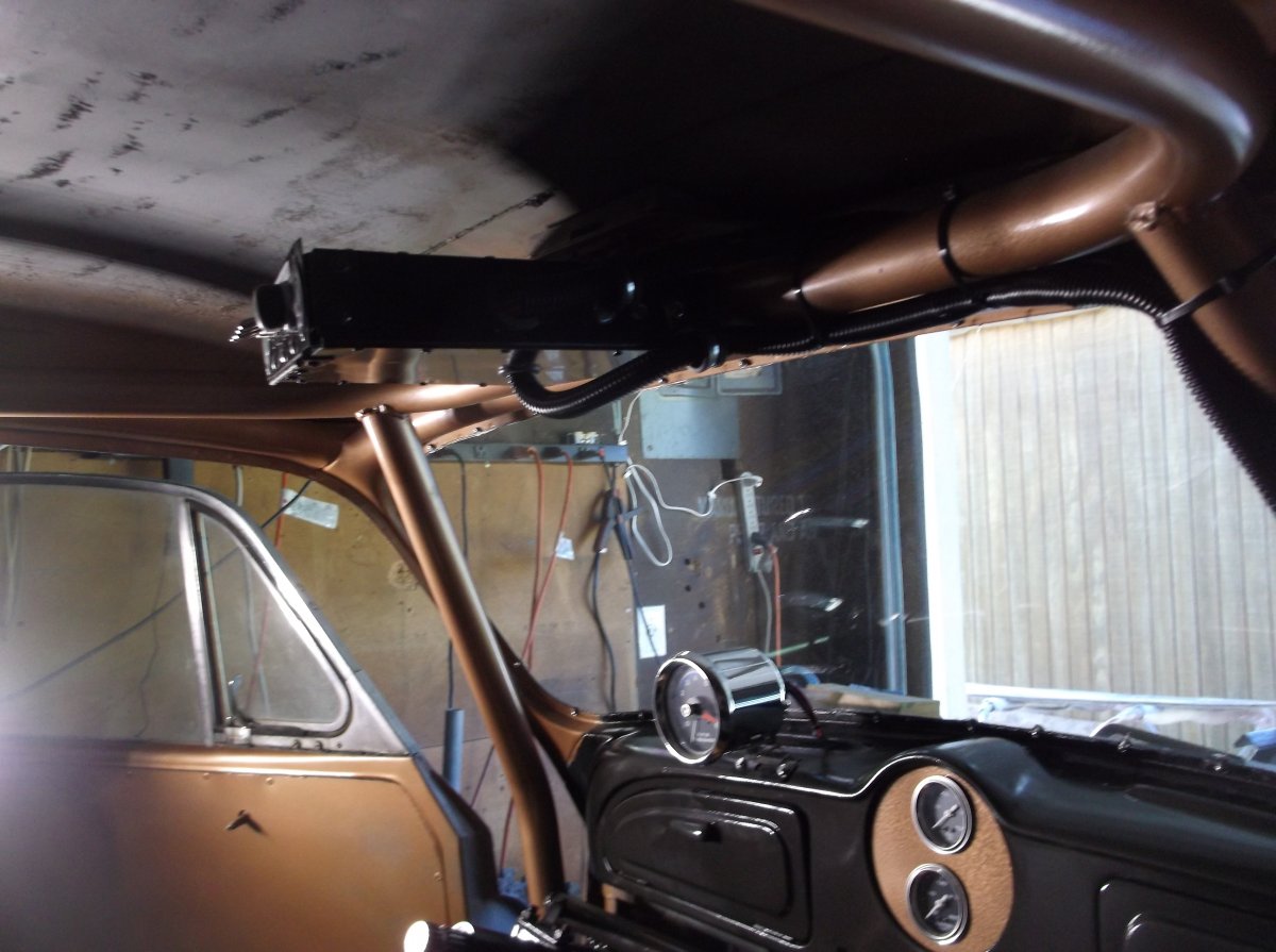

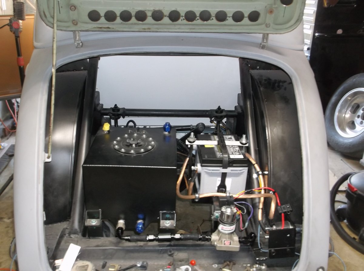

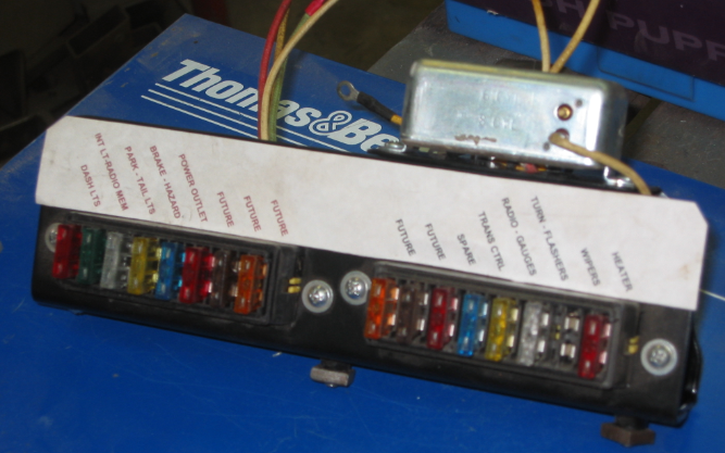

    A simple wiring harness made up from left over wiring kits. I am glad they give you so much extra wire. I used breakers on my fuel pump , electric fan and water pump drive motor. DSCF3492.JPG DSCF3494.JPG DSCF3493.JPG DSCF3520 (1).JPG DSCF3520 (1).JPG

    I might as well sell my car now, had no idea there was that much wire. Bob

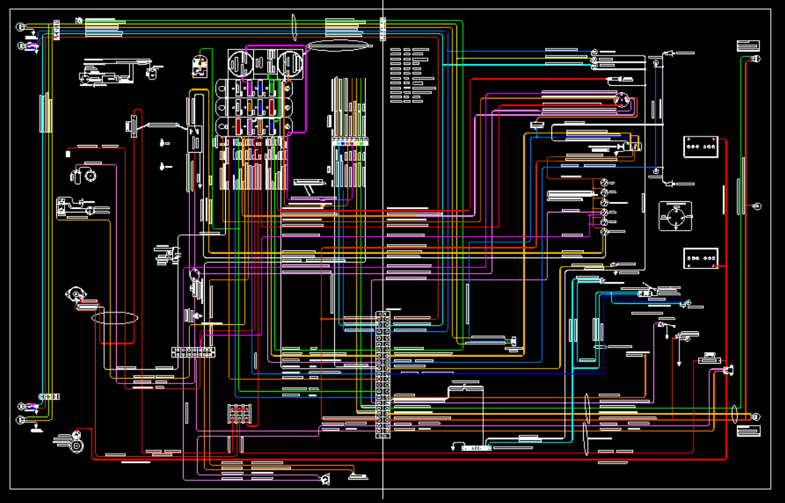

    I give up, that Canuck wiring photo did it. It is in the cl***ifieds. Merry Christmas.

    diaagram isn't really any different from the ones posted by ct1932ford or squirrel, just draw with a different kind of pencil. Had the tools to do it and liked the idea of placing components in their approximate location and the wires routed the way I was planning to run them.

    Thanks. Chrystal clear example that it is light years over my comprehension and fear level. Bob

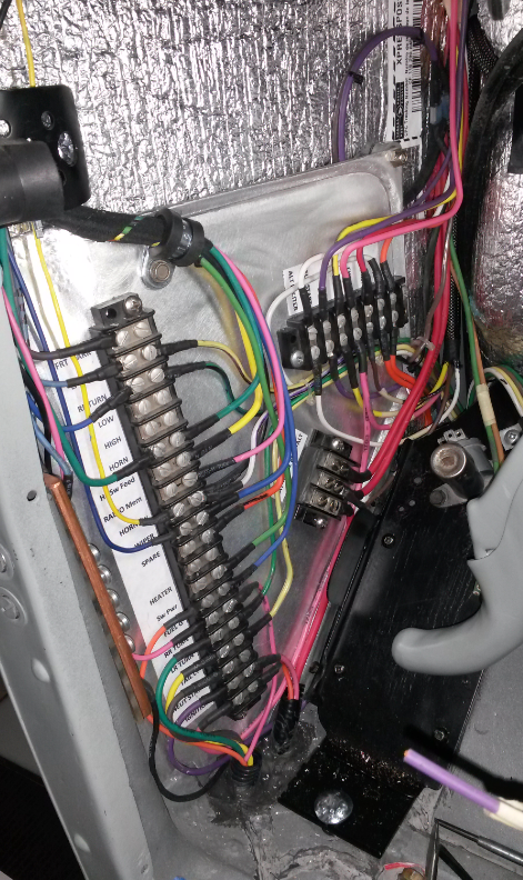

    Canuck, I like your wiring system. I guess because I use those double post strips also. It makes trouble shooting a breeze. I do this on my trailers, also. Depending on the trailer, I some times put two on them, one in front and one in back. I also put them in a weather proof box. I like your crimps and heat shrink . Makes the job look good!

    Terminal strip in the trunk, 3 on the kick panel and a small one on each side of the rad for the keadlights, so the wires could be disconnected to remove lights if necessary. Makes it easier to service and troubleshoot, cost is minimal. Also had a disconnect to byp*** the tach, wiring to the ignition went thru the sender so thought if there was a problem with the sender the car would be dead.

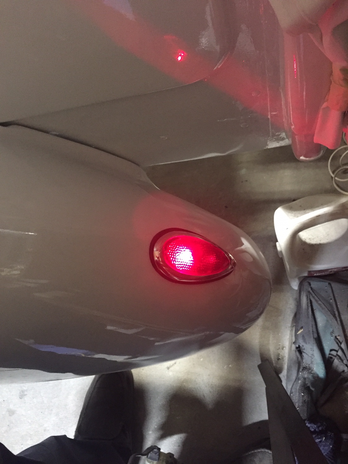

    Woo hoo Christmas lights!
    Tail lights [emoji736]

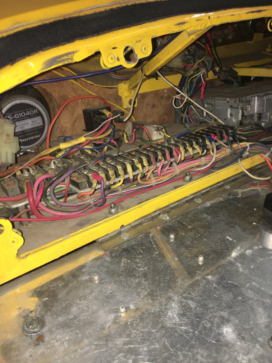

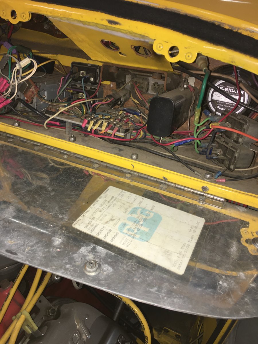

    I wired my Willys wit the harness from a 1956 junkyard Olds I got the rear end from. Was going to use the ****** too but it was the dual coupler but a friend traded it for a '54 Dual Range Hydro so came out ok. This was about 1964 so there wasn't the variety of kits available and I was a very poor high schooler.

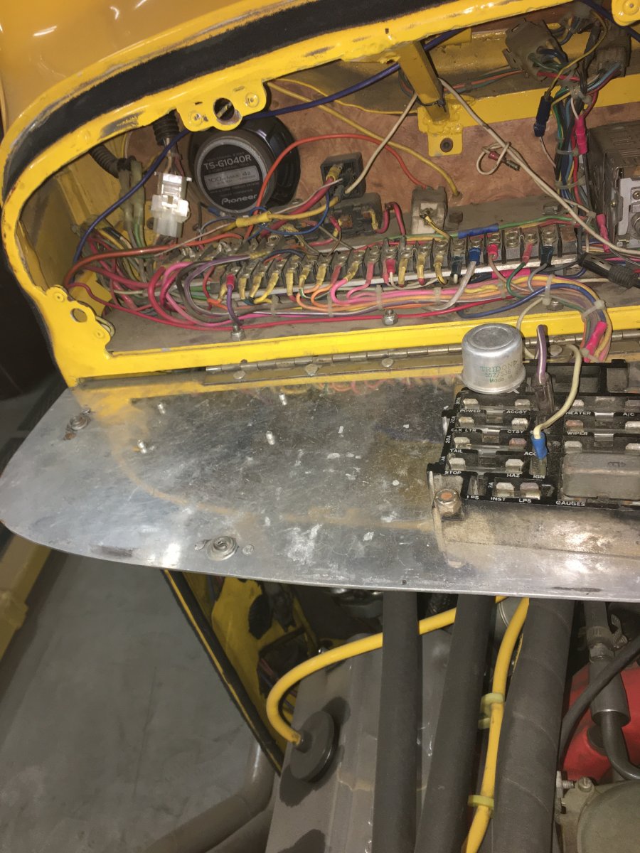

    I used the Olds tubular fuse block and ran all the circuits to a terminal block and circuits to devices from there. Tried to stick with GM color scheme as much as possible. Used a lot of the Olds wire for hook up so my system is 65 yrs old car is +25 yrs old on the current build so is due for a tear-down and rebuild. Will use an Easy harness then.

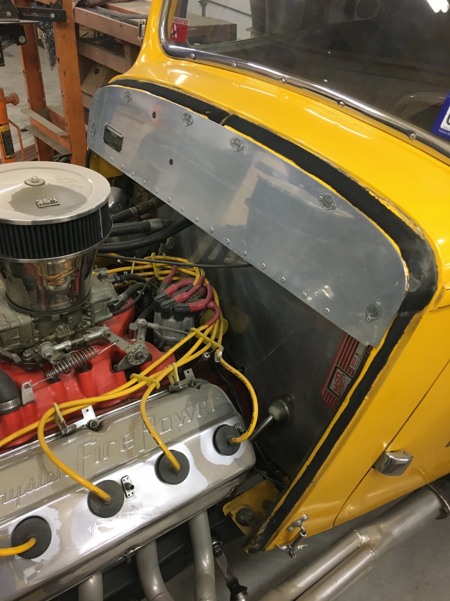

    System is behind this aluminum panel held close by racy Dzus fasteners on a piano hinge.

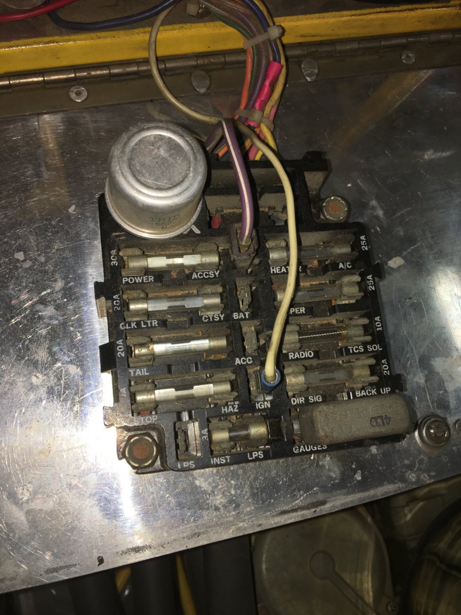

    This is the '56 Olds fuse block. wires all go to the terminal strip in the dash.
    Pretty messy but I have a comprehensive hand drawn diagram that is surprisingly useful. Staying with GM colors was the key. Some of the wires are pretty stiff after 65 yrs.

    The project just doesn't make me happy, that schematic on black from Canada just put the last nail in the coffin. The Model T Bobtail has me excited, treated myself to a few needed parts, Super nice originals. I'm 69 today, looking forward to a project I could have running some day. Steelback is getting stuffed in the corner, maybe the grandkids will do something when I'm gone. Bob

    That is really neat how it’s all behind the panel like that I haven’t really seen that much. SO COOL [emoji41]

    Makes it really easy to troubleshoot too.

    Guys, it’s real simple! Just don’t try to look at all of it at one time! Most things are simple, once you understand, that you only take one step at a time!
    To make a tail light work, you run a wire from the battery to a switch, then to the tail light! That’s it! The diagram just shows all of the circuits at once! No one can see it all at once! Like the 1000 mile journey is just like the 100 ft journey....... one step at a time!
    If you think that’s complicated, you should see a Firetruck wiring diagram!
