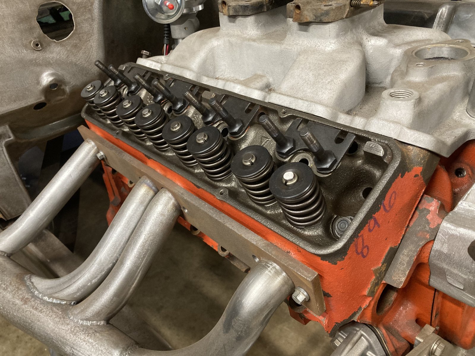

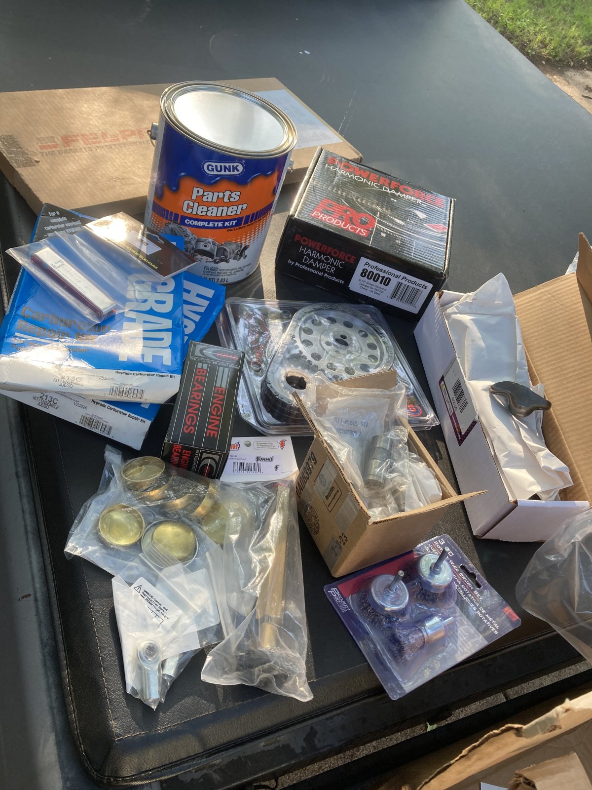

    Lifters…on Cory Taulbert’s recommendation I went with Chevrolet Performance. They have a hardened puck/tip as opposed to the case hardening on most aftermarket lifters. Anything I can do to avoid wiping out a cam, I’m game for.
    Timing set, cam bearings, expansion plugs, new balancer, carb kits and cleaner, gasket set, new set of long-slot rocker arms…didn’t get that crazy of a cam but needed new arms anyway so why not. A few other odds and ends. Going to be a busy weekend but hopefully I’ll have all day Sunday to start exhaust.

    I guess I haven’t mentioned the cam I picked…it’s a Howard’s Rattler. 480 intake with 281 duration and 488 exhaust with 289. Not crazy, but should be a pretty peppy little 283. Stock pistons. I’ve probably mentioned the heads, but since engine ***embly is coming soon…they’re freshly rebuilt power packs with some good springs, screw in studs, pushrod guideplates. Hardened exhaust seats. Positive seals. Bought them as is locally a few years ago.

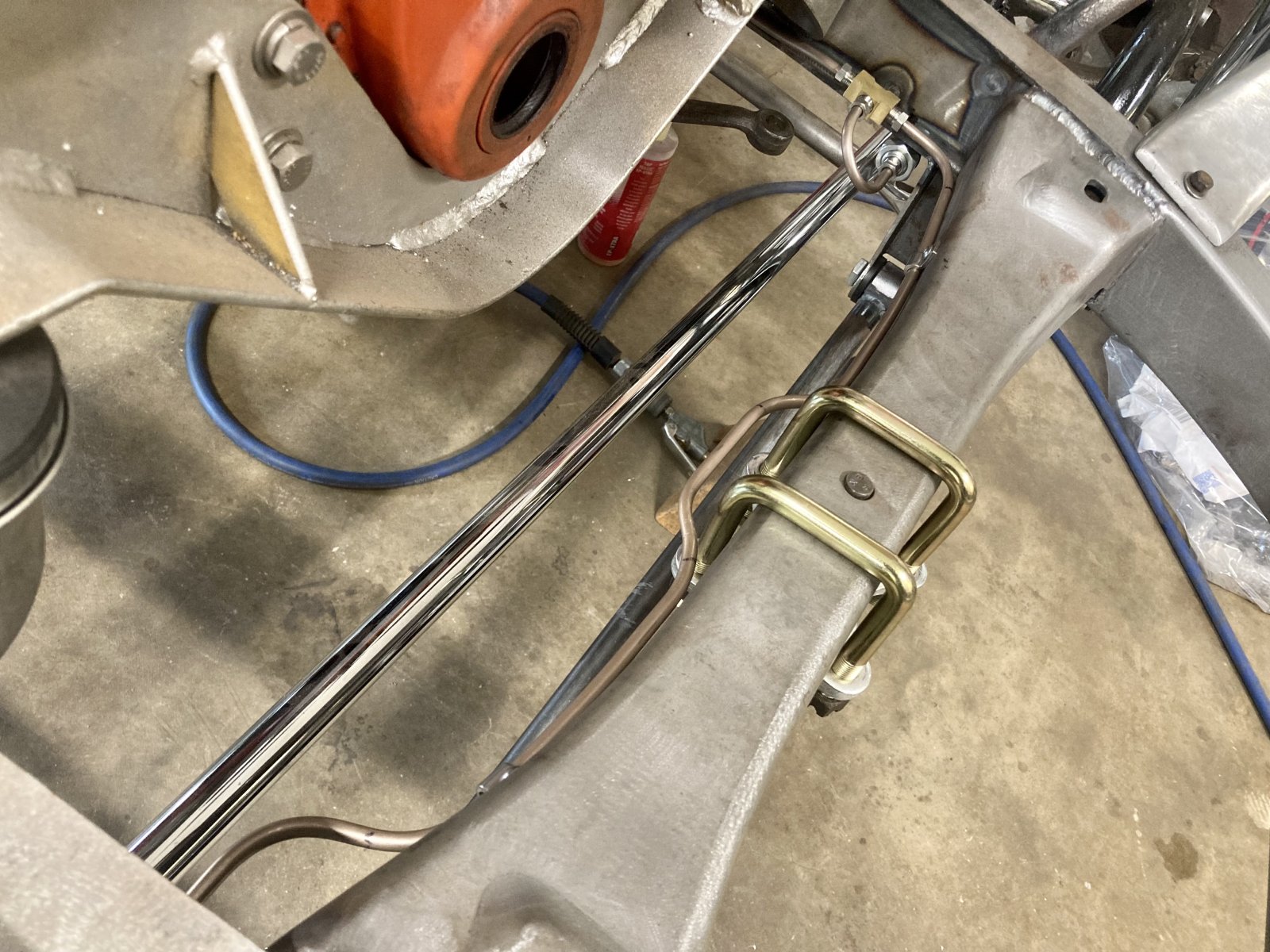

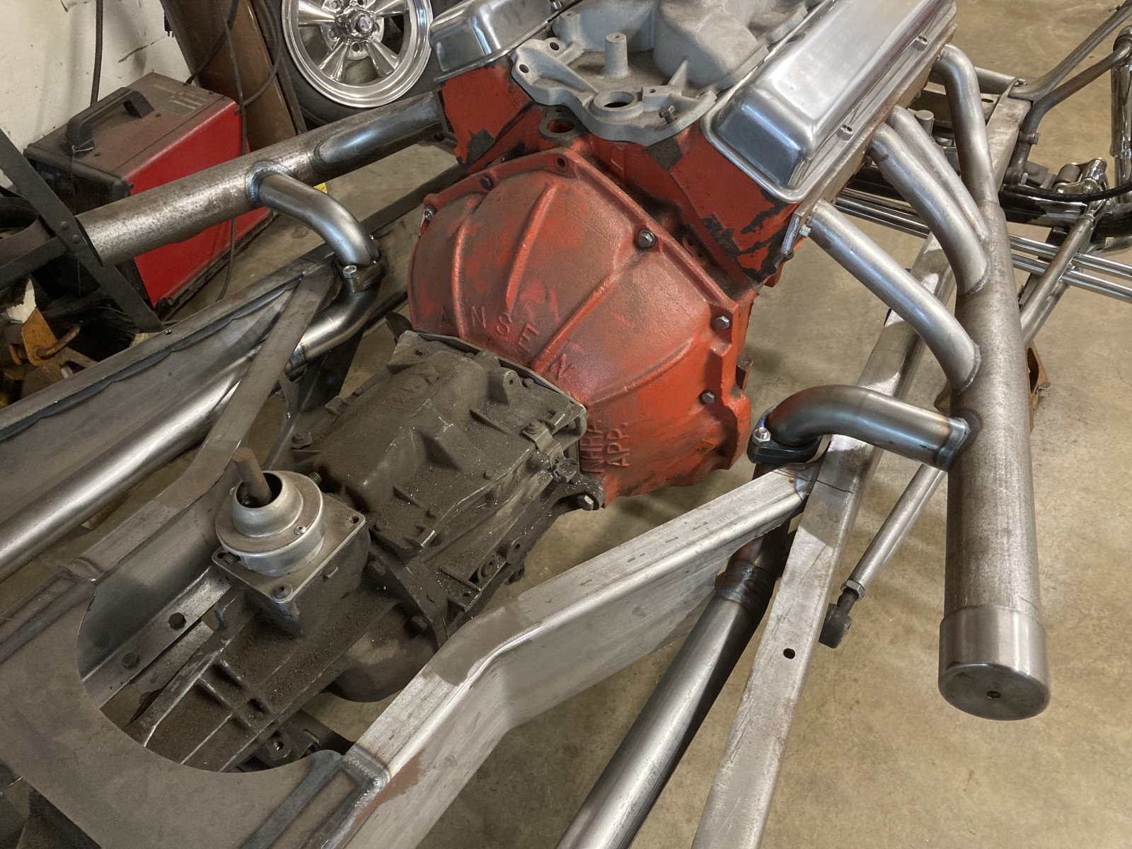

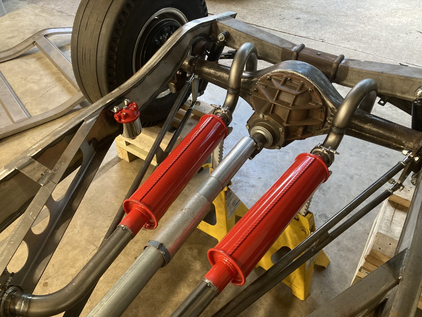

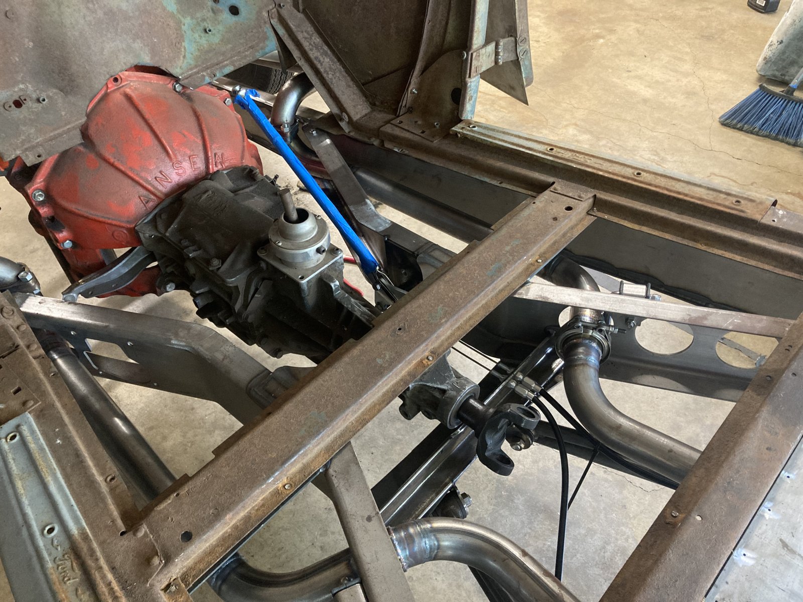

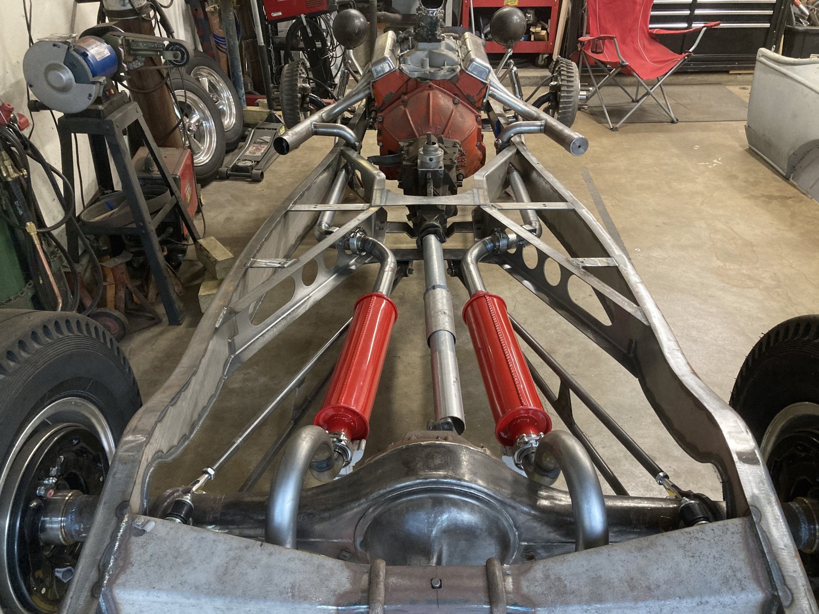

    We have exhaust. All 2” mild steel built from straights and mandrel bends. Went with Cherry Bombs. I know the outlet from the headers isn’t ideal for flow, but that’s what the header caps are for should the need arise. I really did not want to go outside and under the framerails for the exhaust. I notched the cowl sides and ran the pipe that direction, and it’s kind of a dead area in the cowl anyway. It did require the pipe to be closer than I wanted to the rear primary, but so be it. I have some 2-bolt flanges off of the header since they’ll be visible. But for the rest of the joints I went with v-bands. They’re mostly out of sight. I’m almost out of argon and my stainless rod didn’t show up before the weekend to get the v-band flanges fully welded on, and I’m leaving the rear hangars and the last turn for the tailpipes until the body is together on the car. I have them mostly lined up with the inner two tail lights so far and that is the intention. I left plenty of room for a 3.5” driveshaft but 3” will probably be enough even with the blower motor. The front legs of the x-member will need some more t******* and then reinforcing but I’ll deal with that when it’s time to blow everything apart.
    Went ahead and mounted the fuel filter and rear brake hose so I can start on plumbing next. Front brake hoses are mounted too, I made some weld-on tabs from an old shackle plate.

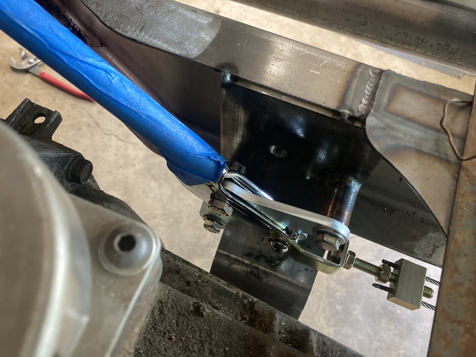

    It’s not very exciting but the ch***is brake and fuel lines are done. Obviously the ones to the body will have to wait until I have a fuel tank and the master cylinders in place. I also mounted a parking brake handle and ran cables. I had intended on just buying the same Lokar stuff I have used in the past but holy cow, the prices on that stuff are off the wall. So I used a late model A/‘32 handle, and the same basic cable setup from Wilwood which was nearly half the price.

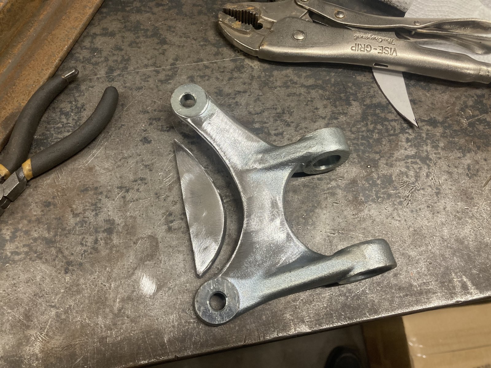

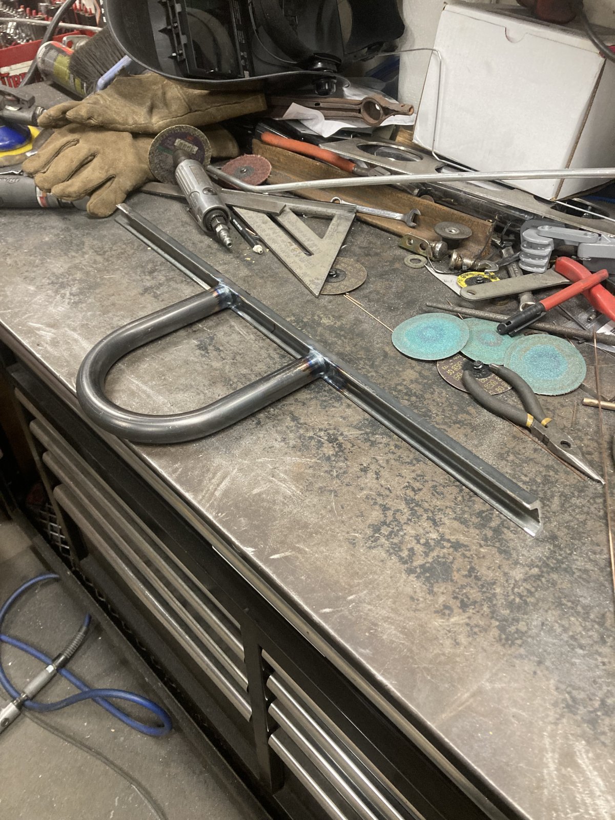

    It’s a little cheesy…but I needed to stiffen up the ladder bar mounting plate. It’s just a big piece of 3/16” spanning the width of the x-member legs with no reinforcement. I had a lot of thoughts on what to do but in the end…I just welded some angle iron in. It gave me a place to route the brake cables to. And I will make some pieces that bolt to the angle that will go up and tie into the plate that is above the transmission. I could certainly do a lot better than that, but I just need to get this thing going and it doesn’t need to be fancy underneath.

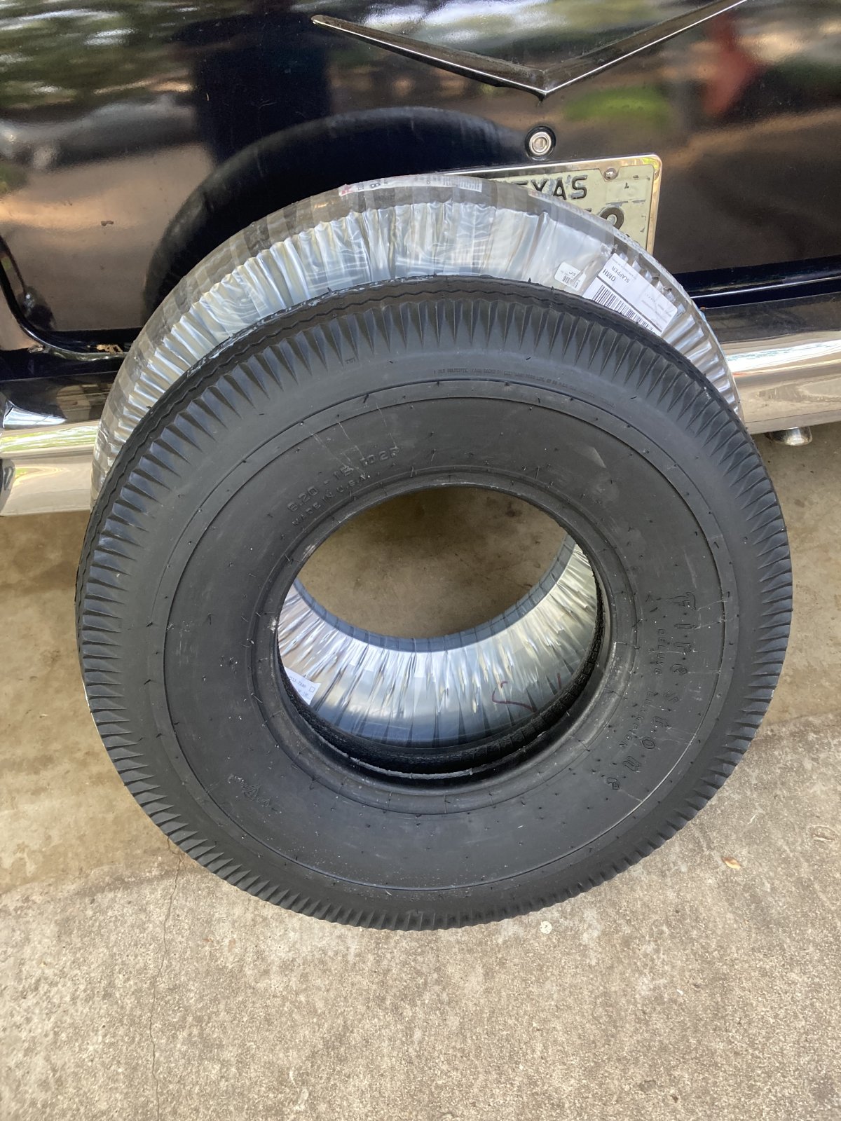

    And another development…the slicks I wanted are back in production! I have checked pretty regularly, and earlier this week Jegs said they had a pair in stock so I ordered them with crossed fingers. They actually showed up today! Pretty excited about that. The pie crusts aren’t the look I wanted, and are a little too short. But maybe they’ll look good on the ‘57 (which is getting a big makeover after this one is done and the El Camino is running). I’ve got to get tubes, but might get everything swapped around next weekend.

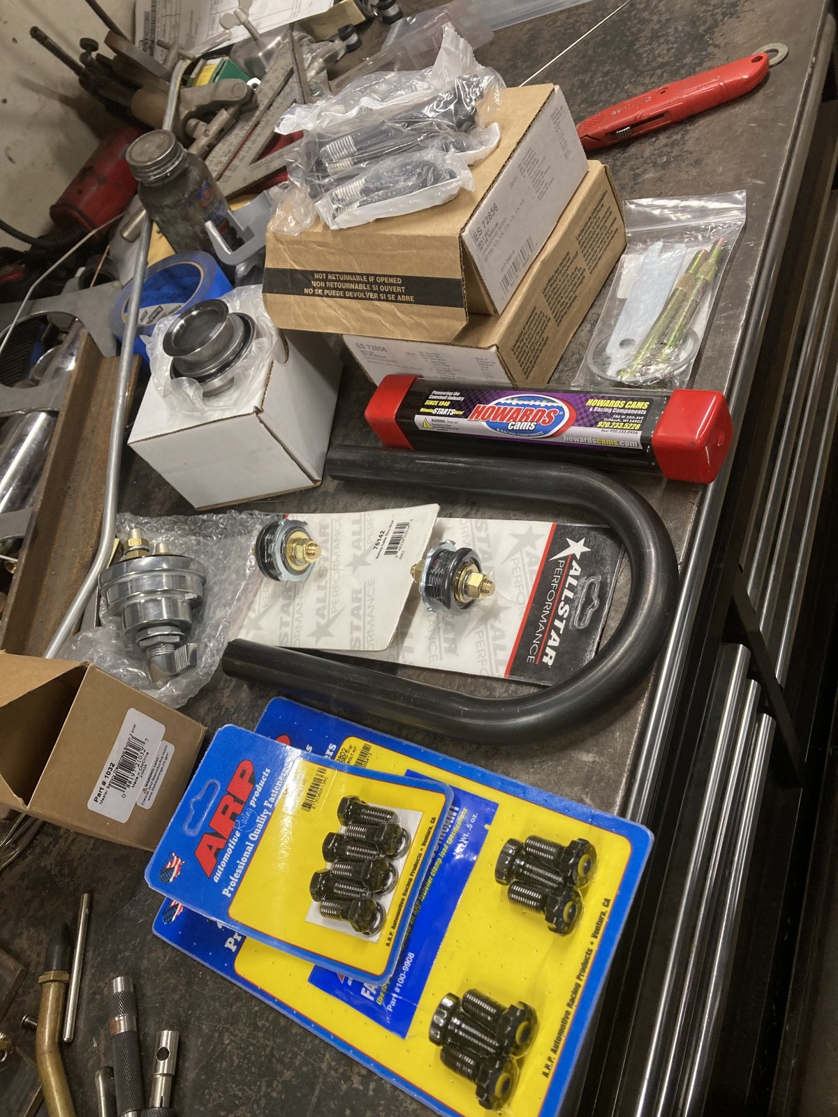

    I am struggle bussin’ lately but I have

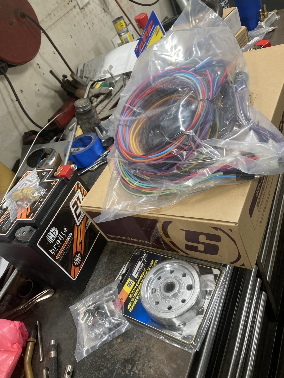

    ordered so many parts. This weekend is a bust with personal time and Father’s Day stuff. But it’s gotta be all or nuthin pretty soon. Engine parts, battery and wiring stuff, and some road trip tires. And some color choices to be made soon.

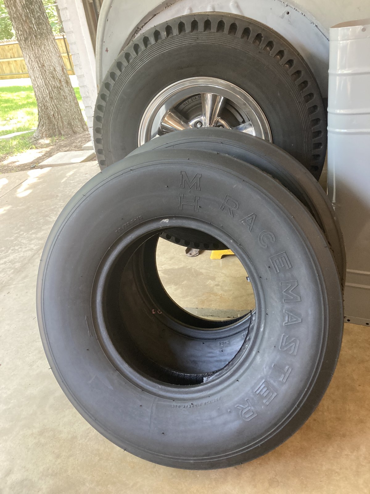

    I ran those M&H’s on my race car and did not use tubes, just coated the inside of the tire with Dawn dish soap. Been doing that on slicks for years with no problems.

    I’ve never been in the racing world and don’t know why these tires use tubes? But I got them anyway. What does the soap do that takes the place of a tube?
    Speaking of which, my front tires will not hold air. I finally checked why, hoping it was a valve stem issue. Nope, leaks all around the wheel lip. I put these on the wheels myself but didn’t screw anything up. Gotta get them dismounted I guess to see what’s up with the bead. I don’t mind running tubes in the fronts if I have to, but they are supposed to be tubeless tires.

    Side walls on slicks are thinner and the soap helps seal them.

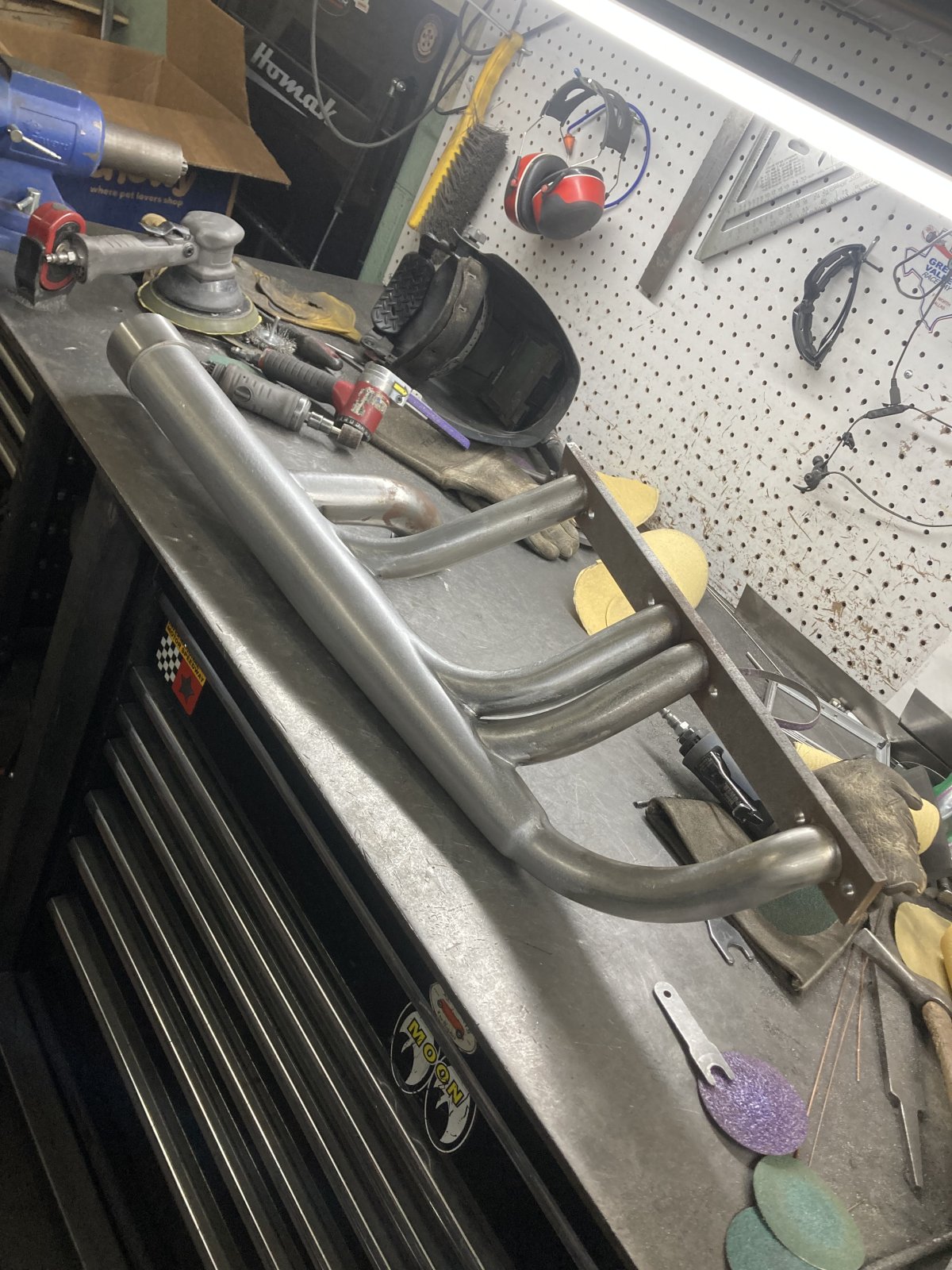

    Part of me wanted to leave the welds on the headers, seen a lot like that from “back in the day”. But then I got kinda carried away. I was a bit lazy and didn’t finish them out in areas where you’ll never see the welds. I’ll let the chrome guys polish those and it’ll be good. Got the headers and caps, front shock mounts, pitman arm and nut, steering stops, and one windshield post finished last night.

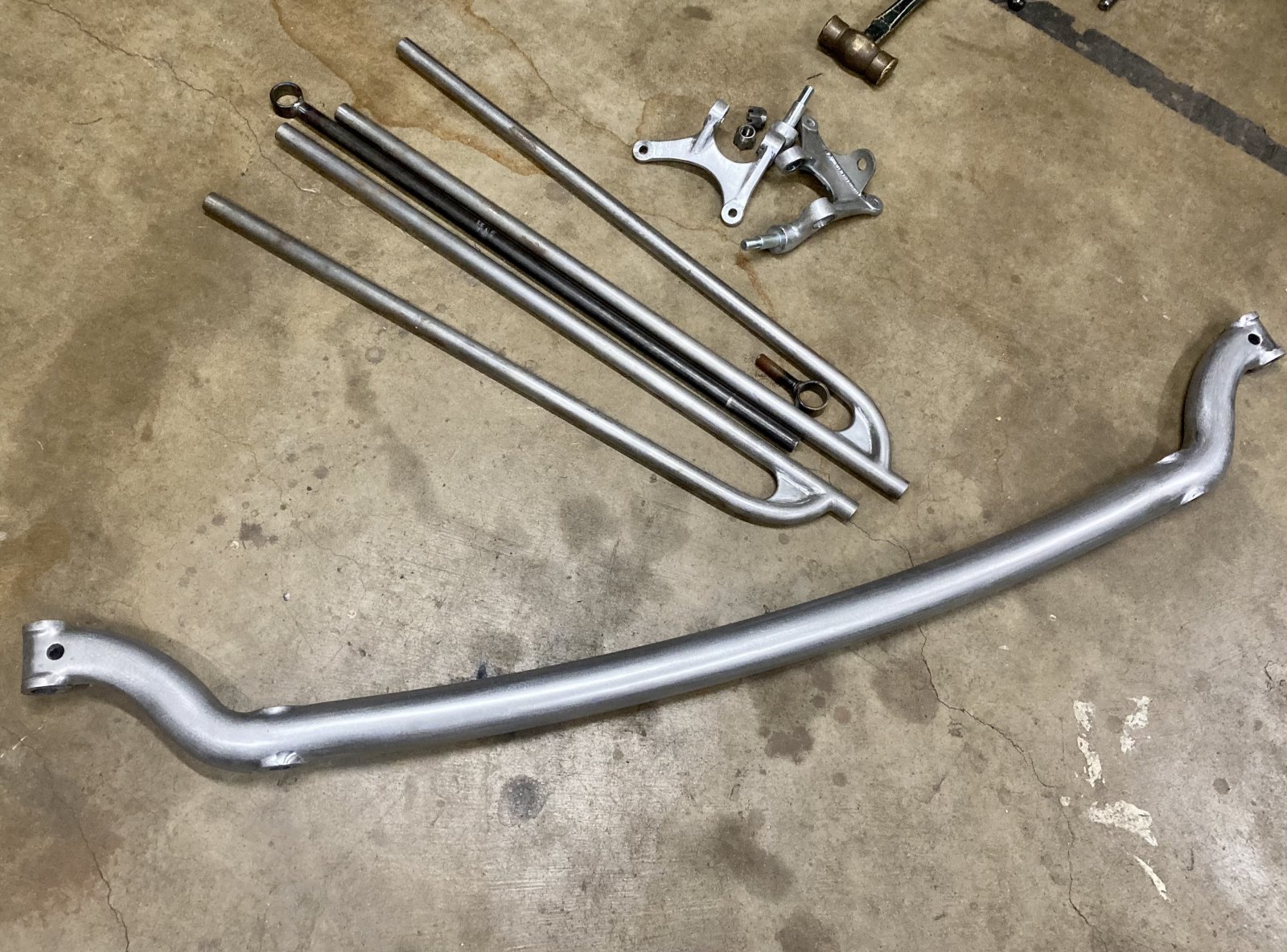

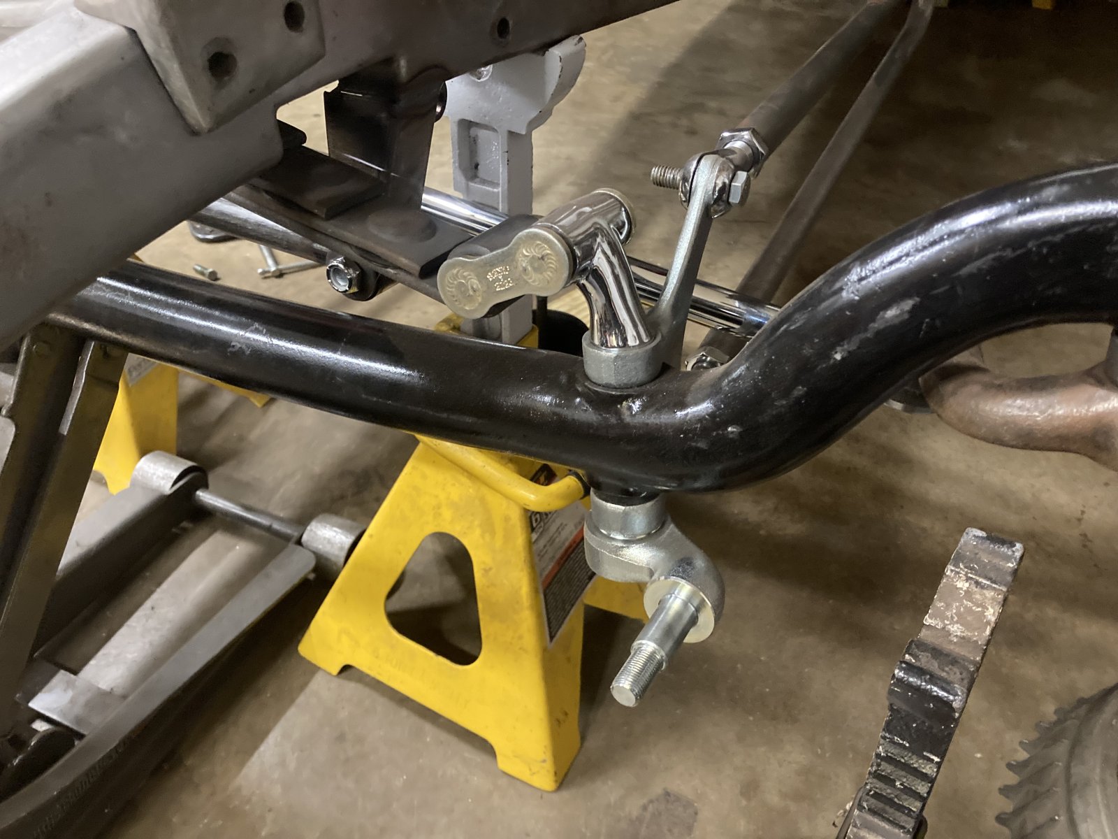

    Live updates…it’s too hot and I needed a cool down. For the live end of the panhard bar mount, this is what I’ve got. Machined a bung and welded (just tacked so far) to the axle. Made a filler piece for the batwing, welded it in and smoothed it out. Cut out a double shear bracket and welded that to the batwing. Then cut that filler piece back a little for both style points and tie rod clearance. I think it’ll work alright. Working on lower shock mounts now, more on that later.

  27. I have NEVER seen it done that way and that is super SLICK!
    Anderson likes this.

    I was ready to leave the bolt on shock mounts on there, they don’t bother me as much as many other folks. But then I welded the spacers (that makes these 2-1/4” batwings fit the 2” perch boss axle) to the batwings…and it was looking pretty thicc. So what the hell, cut the bolt-ons apart and welded them onto the lower boss on the batwing. Last picture is a “before”. Looks a lot cleaner now. I can use a tapered Ford castle nut on the spring perch now too, which will look pretty good with the original looking shackles I got from Roadster Supply. I finished welding the panhard boss onto the axle tonight. Tomorrow I will prep the axle for chrome and get the rest of the front suspension ready to send out. Maybe a couple other tasks. Did I say it was hot already?
