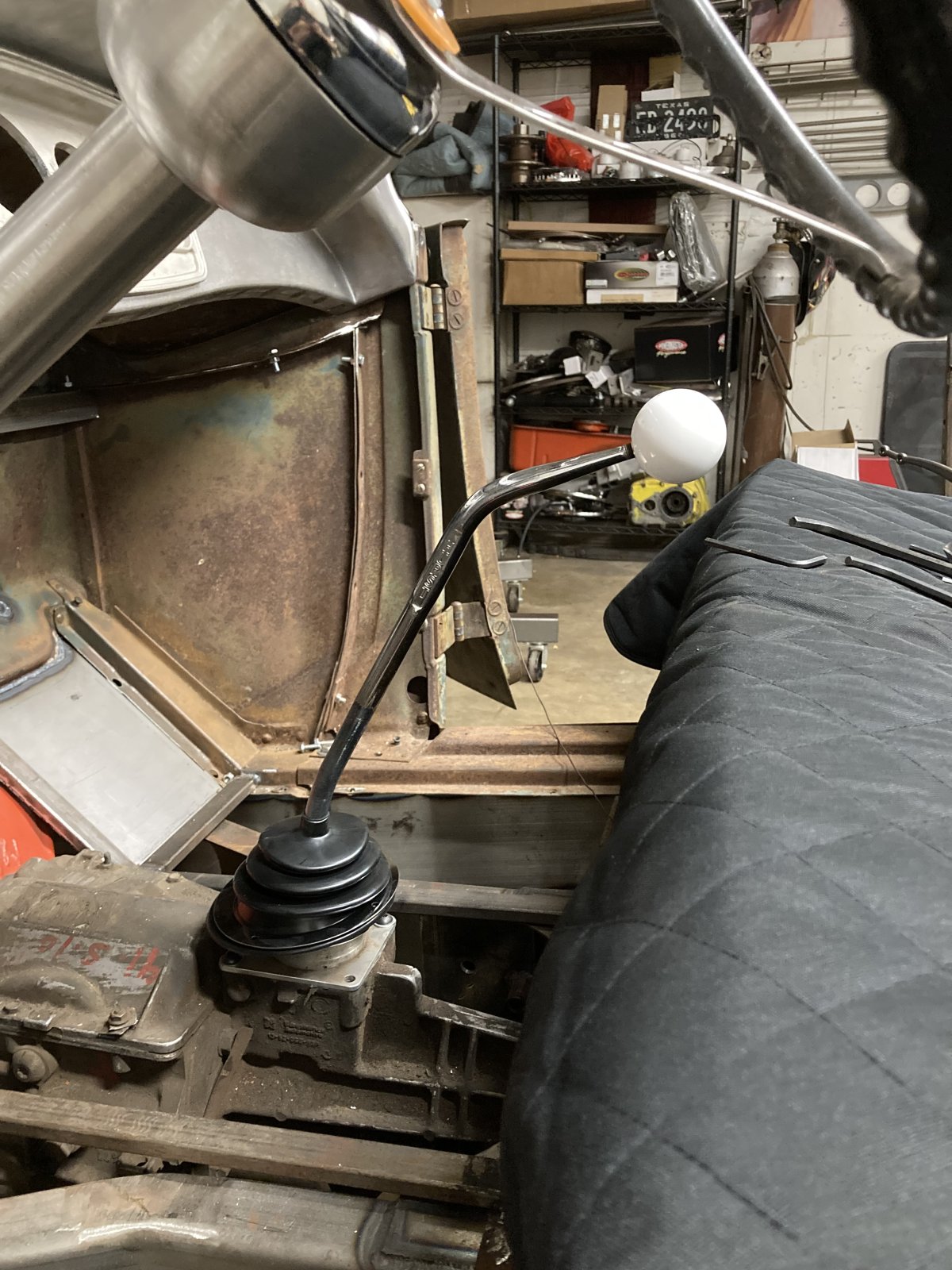

    I stuck the junk block back in the frame with my transmission. Test fit the distributor and it’s good. While it was in there I made my shifter handle. Extended the stub of an old round Hurst handle I picked up and welded it to the stub out of my shifter. Alex digs it.

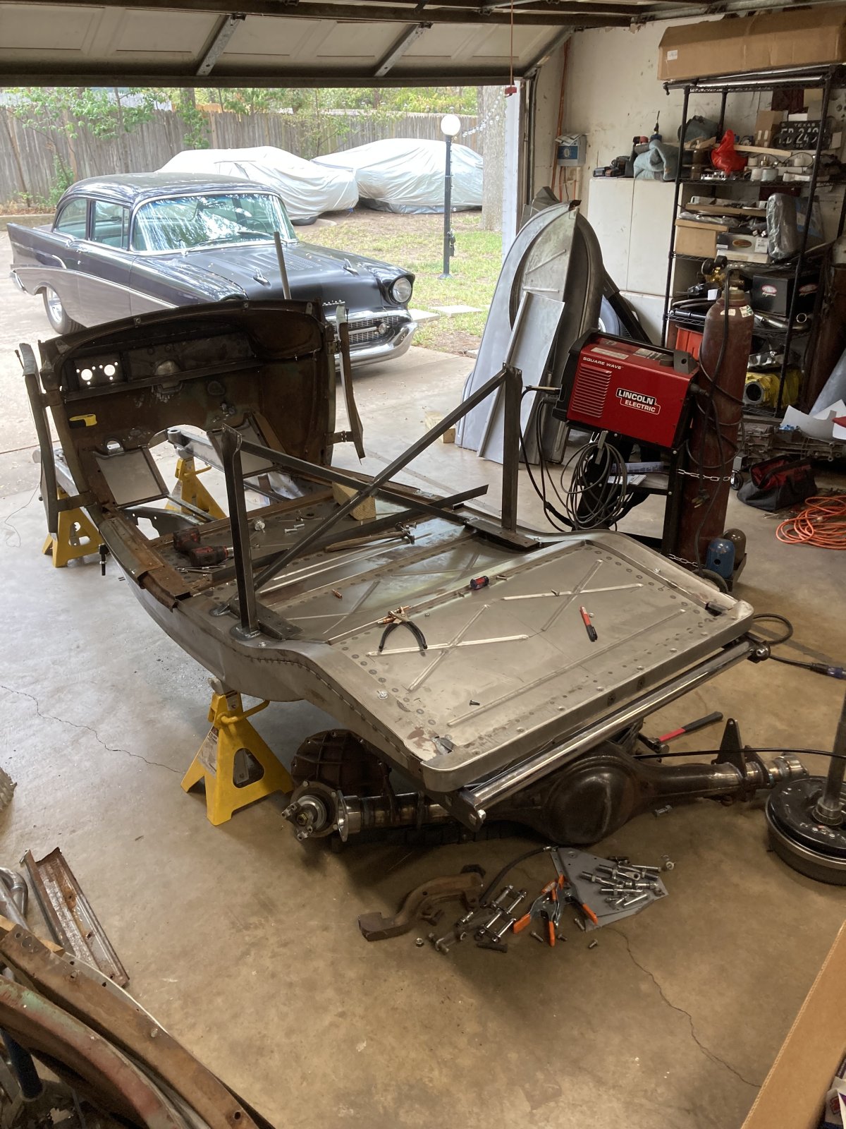

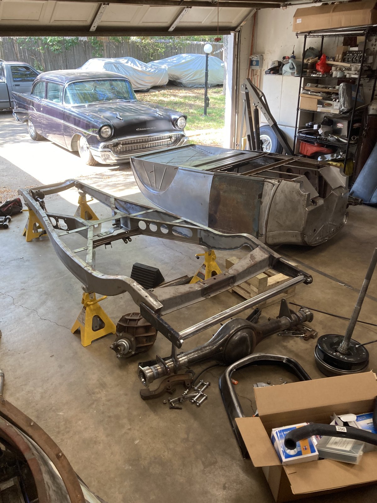

    Finished welding in the floors, got the front cowl feet reinforced and capped on the bottom. Added a tab to the inside behind the exhaust notch to give me another frame mounting point. Pulled the body apart for the last time. Finished the transition from the original subrails to the new back half. Finished any welding left on the bracing. Finally pulled it back off the frame and wire wheeled the old subrails and cowl structure and got some Por15 on it. Then started on the remaining frame welding…when the weather moved in and cut power and ended my weekend. But I’ll finish the frame tonight. Then one morning this week since it has cooled off a little, I’ll get the a coat of paint on the subrails and floors , then I can re***emble everything for the last time and make the quarters permanent.

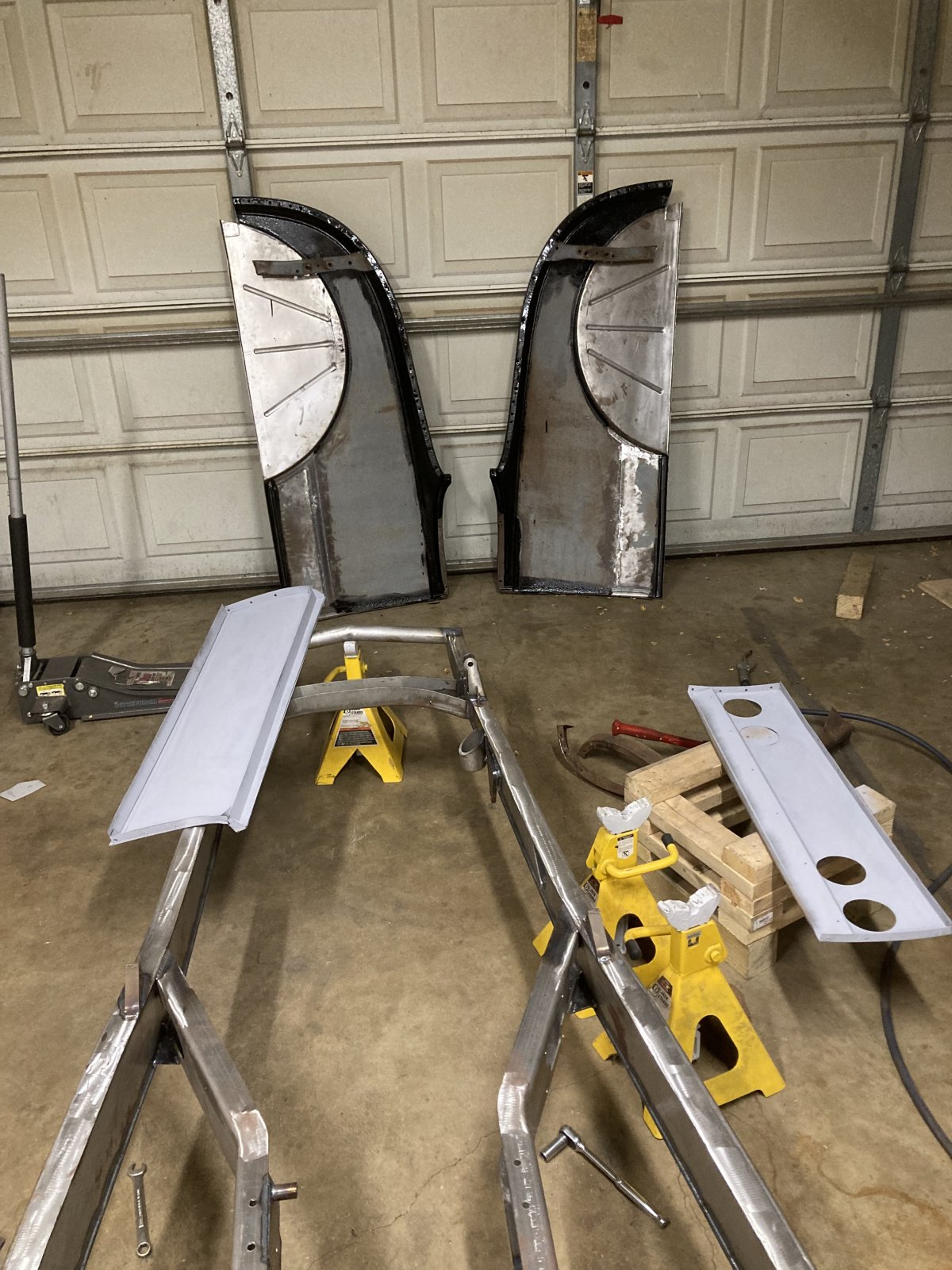

    Frame almost done. Floors prepped. Got some enamel on all the areas that will be stuck together with the quarters on. I will paint the whole underside after it’s ***embled. Was up early today getting the quarters ready. I mixed my primer and the dye and found I need a lot more dye, should be here tomorrow. I think we might see a primered frame Thursday…

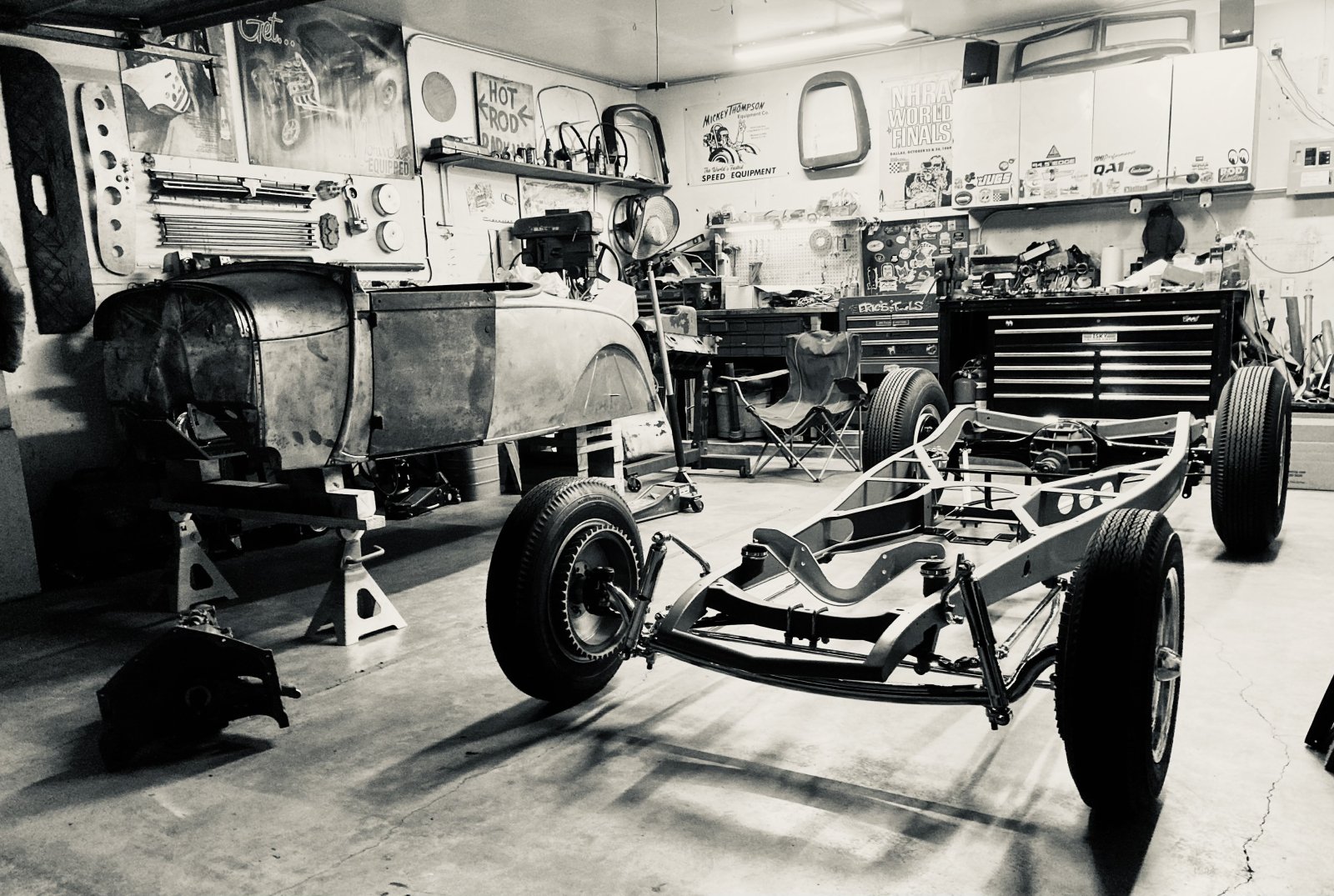

    The frame is done. Short story about the rear framerails. They are original ‘32 and were scabbed onto the back of the original frame that was under my ‘32 roadster, but they were too short so I had to replace them. Really glad I held onto them and got to use them now. I blended them in with some s**** tubing…they look good with the body on even though the transition to the rails isn’t ideal. The way Rjays caps the back of these frames is pretty weird and I wasn’t about to start redoing everything. There are a couple bolts in the body…will wrap it up tomorrow night.
    I should note the body isn’t bolted down or centered anywhere so don’t pay attention to that wheel well/frame c-notch mismatch.
