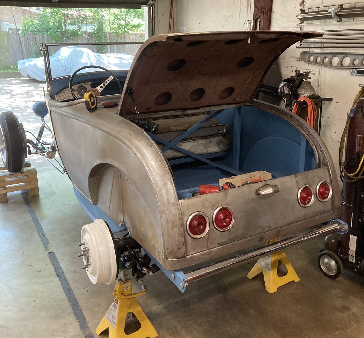

    Are you putting the wood body reinforcement pieces back in?
  5. Anderson
    Joined: Jan 27, 2003
    Posts: 7,560
    Anderson
    I had intended (maybe still intend?) to add a diagonal brace from the top front corner of the quarter panel down towards the subrails at an angle to stiffen that up, but won’t be putting any wood back in the body. I will be putting the wood pieces on for the top to attach.

    That is why I was asking. If you don't intend to add the wood back in I would do some more reinforcements before I got much farther with paint if it was me. The door jams on the latch side especially. Iron Trap did a really good video on reinforcing the door jams on a Roadster recently.
    My Roadster has reinforced door jams, reinforced lip around the top of the tub above the seat, and added bracing behind the seat back. I have no wood at all on my Roadster, but also have no plans to run a top.

    There are a lot of things I want to do but am either putting to the side, or waiting until the last minute to finish up. I have a month to go and it’s going to be close. I need to have a running and driving car in the next two weeks if I’m going to make the Roc. Both doors need major repair and I’m going to be installing bear claw latches. The decklid also needs a bunch of work. But it doesn’t need doors to drive right?? As for paint, it’s has got a long way to go for that and I have plenty of time to make changes. The primer I’m putting down is mostly for presentation. I’m not really into surface rust and bare metal!

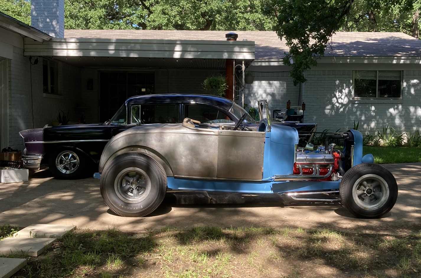

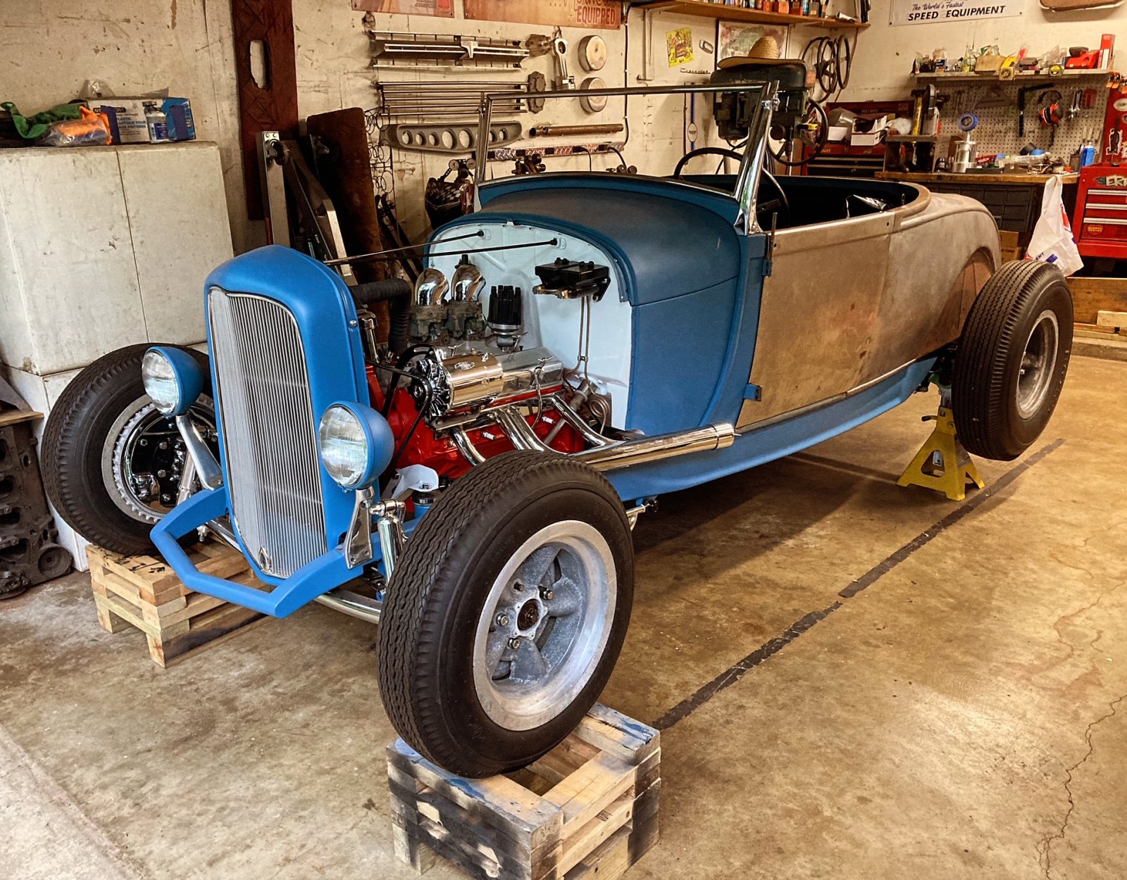

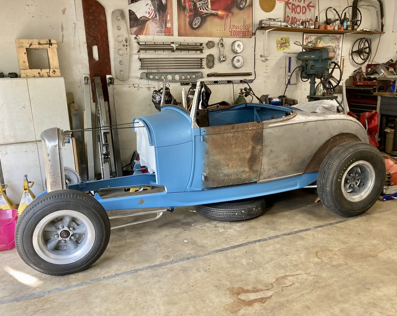

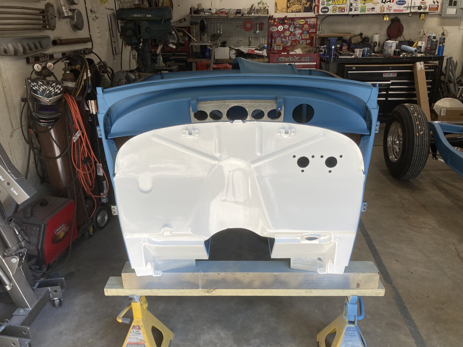

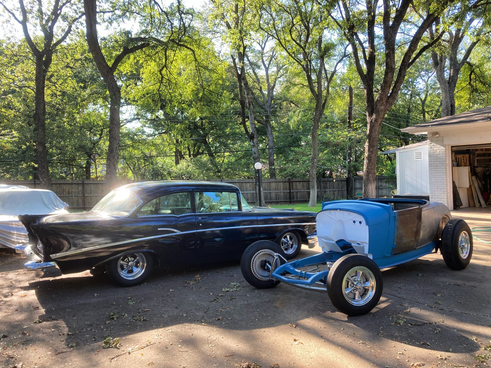

    Towel officially thrown in. I couldn’t leave engine #3 as-was, and it’s a good thing. I already knew the water jackets were full of crud and I found two abandoned freeze plugs inside the block. After I chipped away as much of the corrosion as possible I stared cleaning up the rest of the block. Well, in cylinder #3 I found some crazy pitts. Like sleeve the cylinder pits. I said to hell with it and continued cleaning. But then I discovered that I don’t have the right non-rope rear main seal (or even a rope seal), but wanted to see if my fresh crank from engine #1 would be fit…so I put it in. It’s too tight. Blah blah blah long story short, I have no engine. I don’t have the time or energy to figure it out or find another engine and I don’t have time for EVERYTHING else…Sheetmetal work, priming the rest of the body, wiring, finishing plumbing, battery mounting, engine break in, putting a top on it, test drives, etc. It’s not happening, no Gathering at the Roc for the roadster.
    I’ve gotten more done in the last 6 weeks than I would have in 6 months the way I was headed. I’m happy with everything I’ve done so far and will continue as is at a little easier pace. I’ve got a back up plan for the ‘57 to make it to Oklahoma though so not completely dead. Here’s some fun stuff to look at.

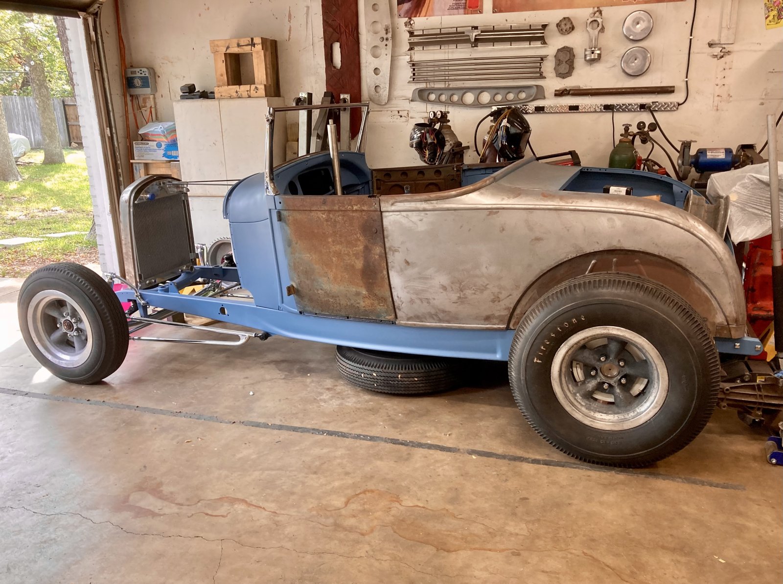

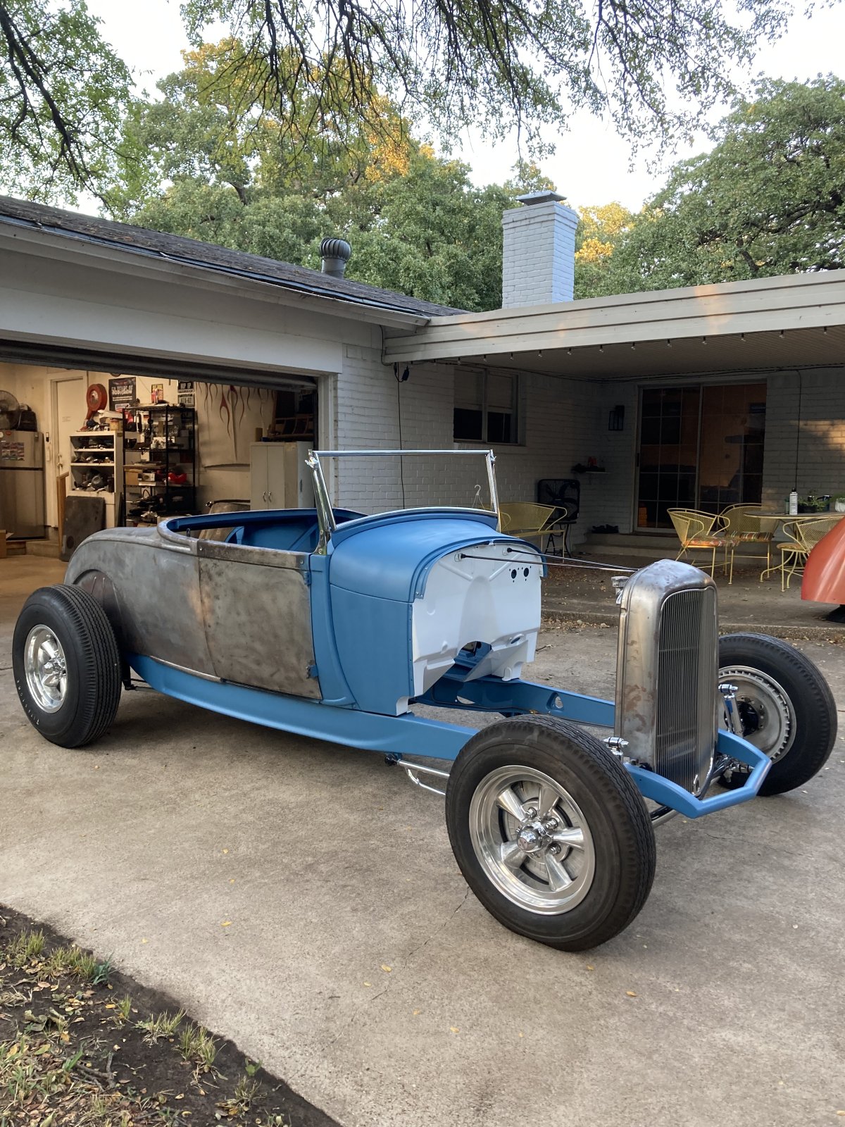

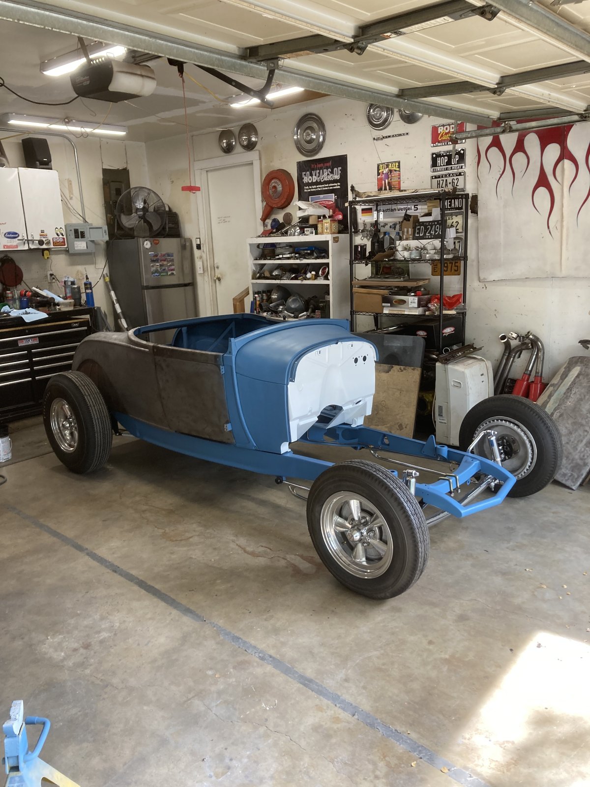

    I found a pair of magnesium 15x6 Americans locally, then found some 15x6 Crestlines that are a pretty close match, though in aluminum. Had someone who wanted the polished Americans so I dismounted the tires. The “new”’wheels still need a lot of cleanup but good enough for a mock-up. I actually think I’ll keep the mags for my slicks and try to find another pair of Crestlines for the back. The mags out back have a little too much offset and are too far away from the body without narrowing the rear end again.

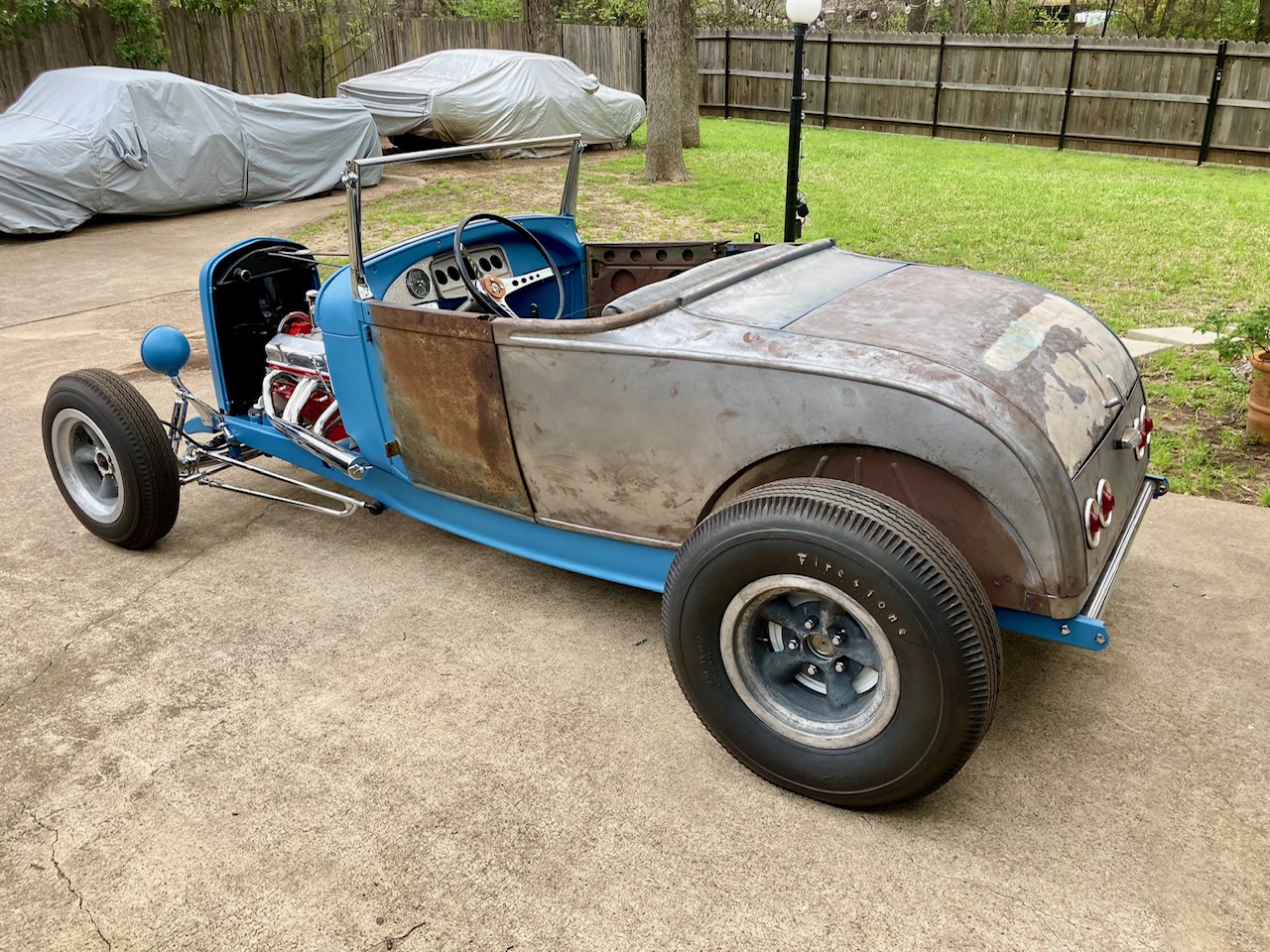

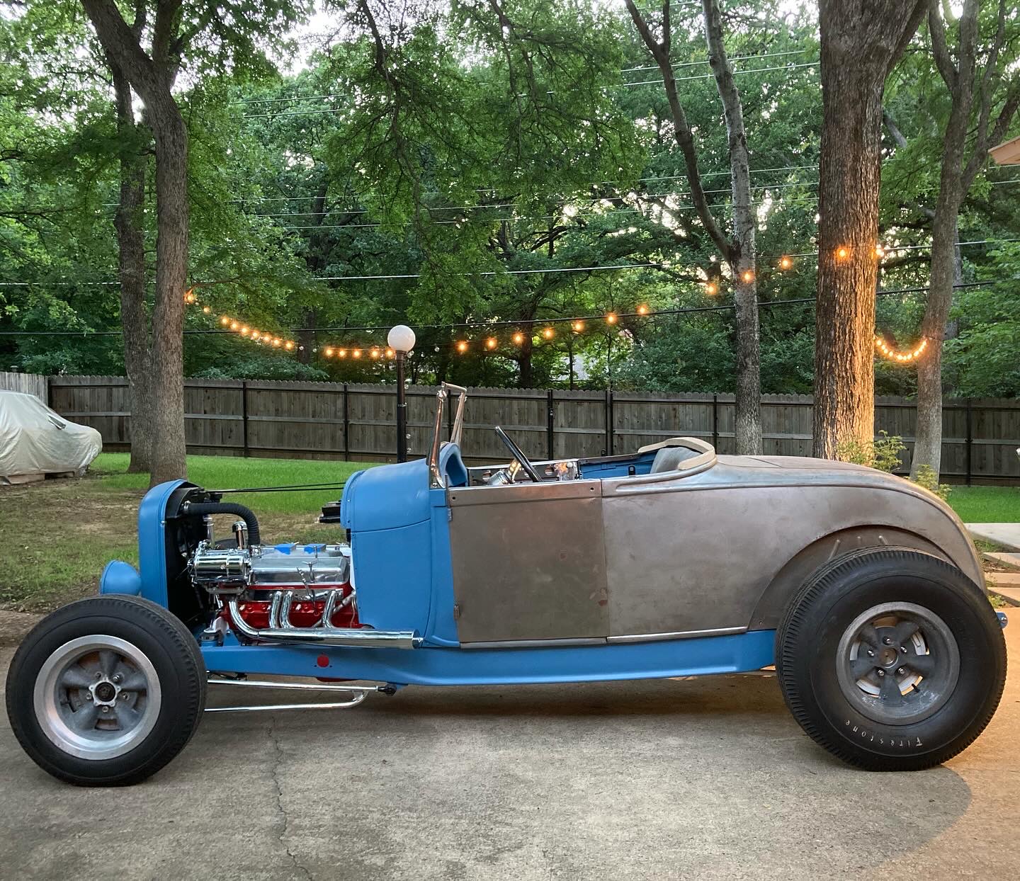

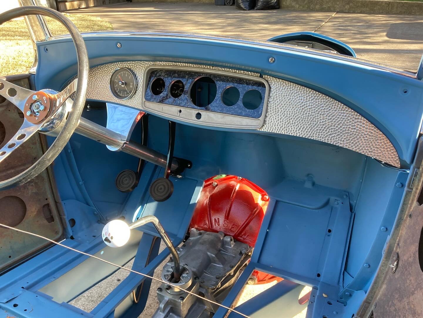

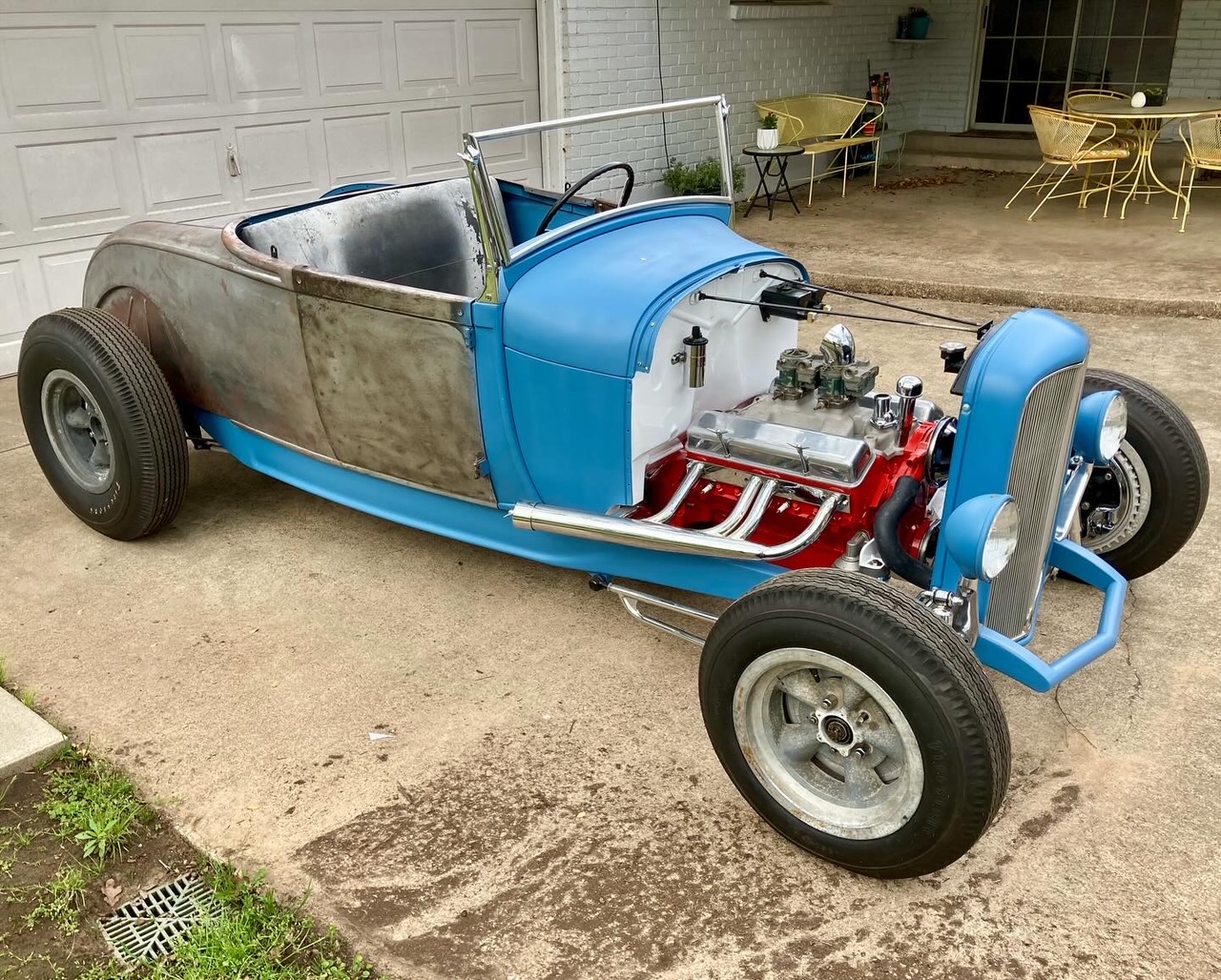

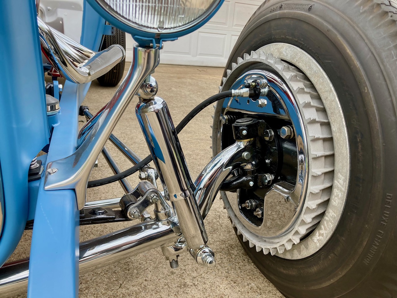

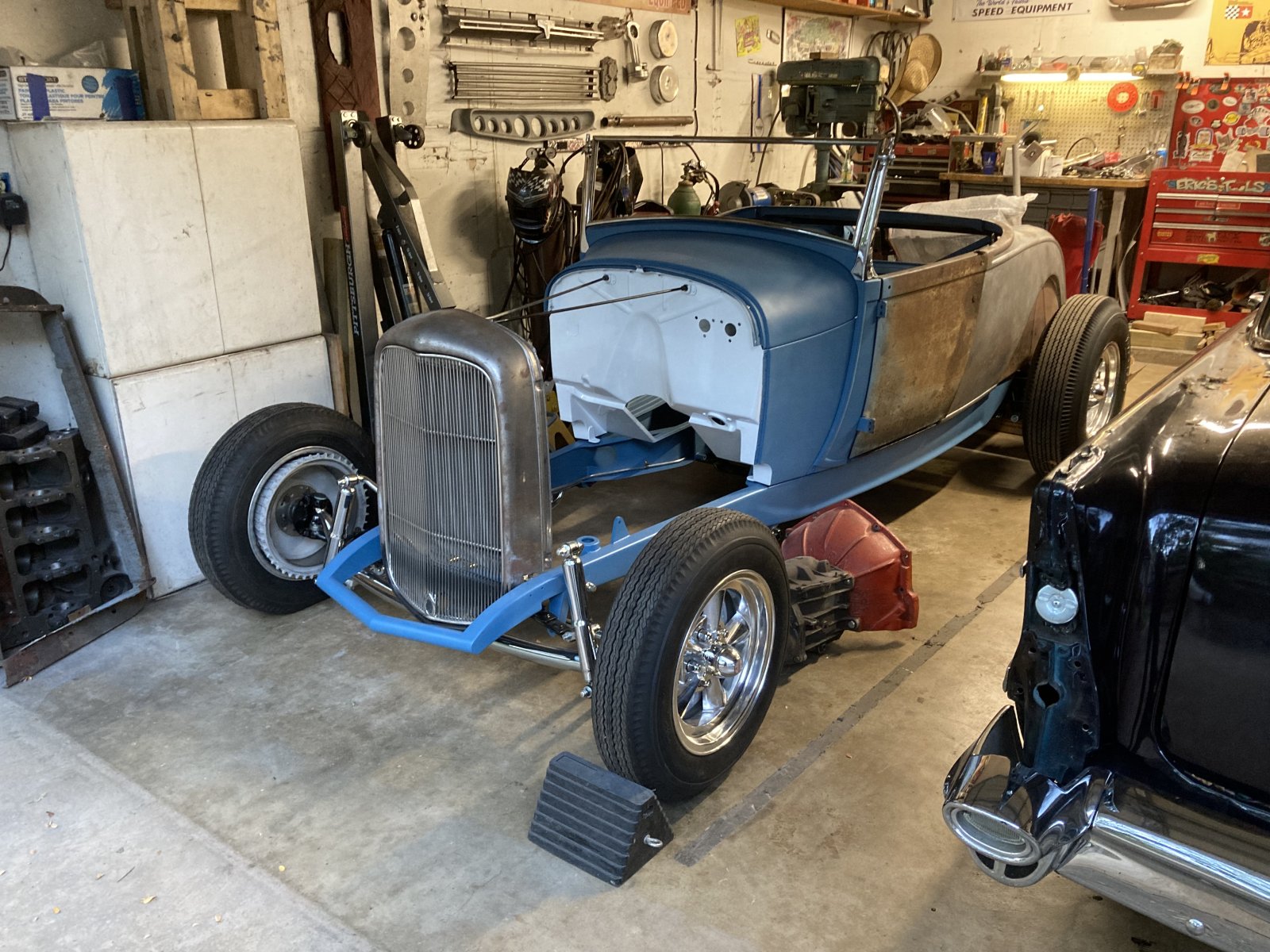

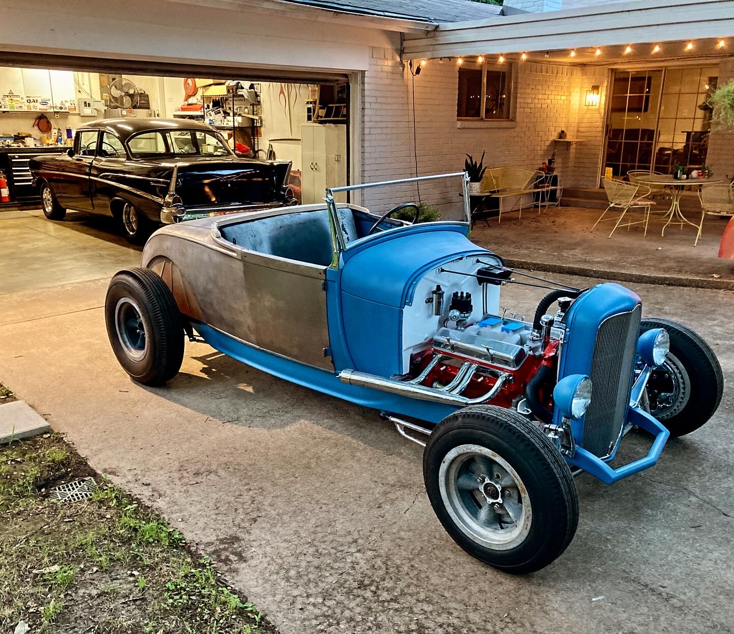

    Sorry it's been a while. After the big push for the show last year I was pretty burnt out. But have gotten some stuff done here and there. I went ahead the put and engine together and got it in the car. The ch***is is done...need to adjust pinion angle and caster but never had all of the weight on it until recently. Just finished up master cylinders, slave cylinder bracket and brake lines. Had an ordeal with the starter, but figured that out. Another issue with the distributor driveshaft but figured that out too. Mounted the powergen. Oh, and I put new door skins on the old inners with some smaller bear claw latches. The doors still ****, but at least they open and close now.
    As she sits. I plan on bleeding the hydraulics this week. I need to add the rest of the leaves to the rear spring now that it has settled, notch the quarter panels for the rear axle, then shoot the rest of the thing blue. Probably be on the road sometime next year at this pace...

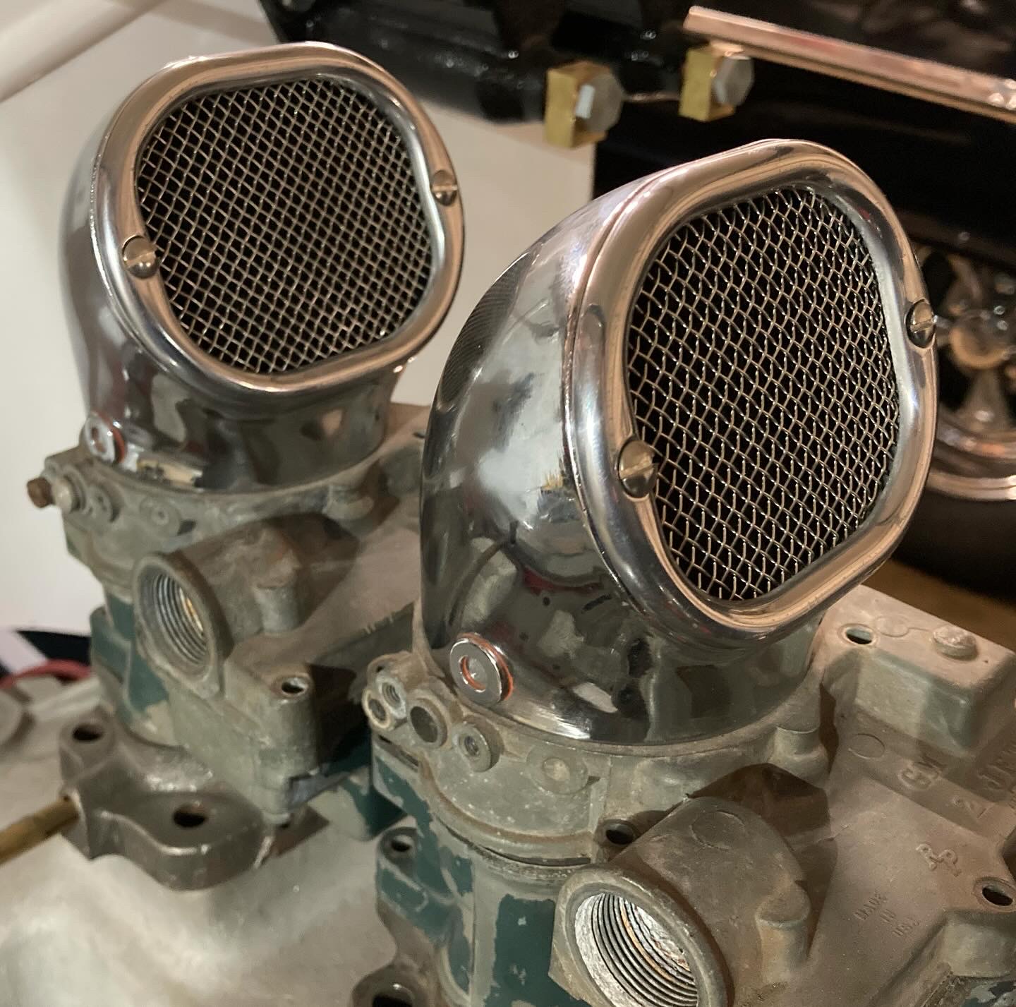

    Oh yeah! since you mentioned it and I forgot...
    I designed and had these carb scoop screens 3d printed. I might also put one of those fuse panels in it, or make a cover for the first fuse panel I did for this car.

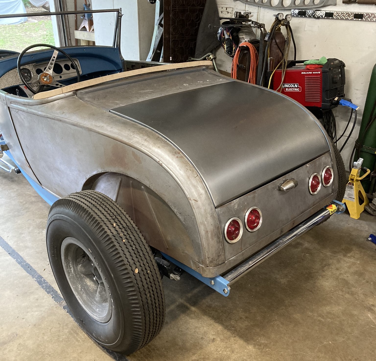

    Yesterday I notched the quarter panels, put the last two leaves back in the rear spring, and worked on the trunk rain gutters and decklid hinges. This decklid is pretty rough but I think I can save it.

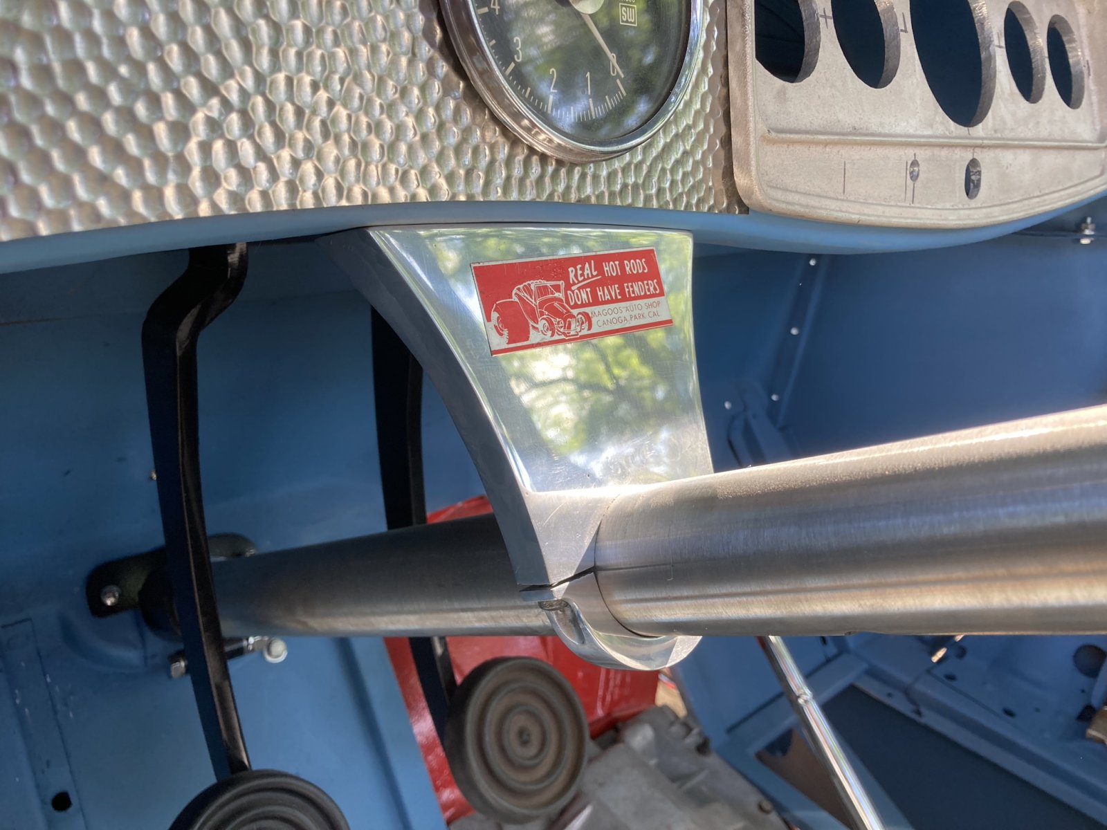

    I don't think I posted the finished column drop. Had to add a little embellishment too. IMG_3342.JPEG

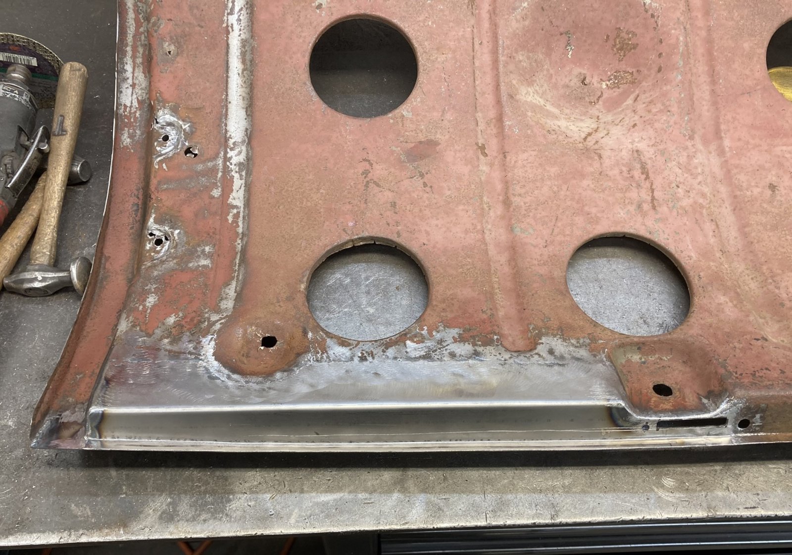

    Decided to go ahead and get a new decklid skin. The old one needed patched and a lot of straightening...decided to put my efforts into fixing the inner structure panel and abandoning the original skin. So I got it apart and patched the inner last weekend. Also cut off the old rumble seat hinges that had been welded on. Its still got some holes that could stand to be patched but I'm just going to get it together with the new panel and get it in primer. An interior panel would cover all the other stuff and they don't cause structural issues.
    The new skin isn't too far off. This is it just setting in place. I'll weld the two pieces together soon and get the hinges and latch sorted out.
