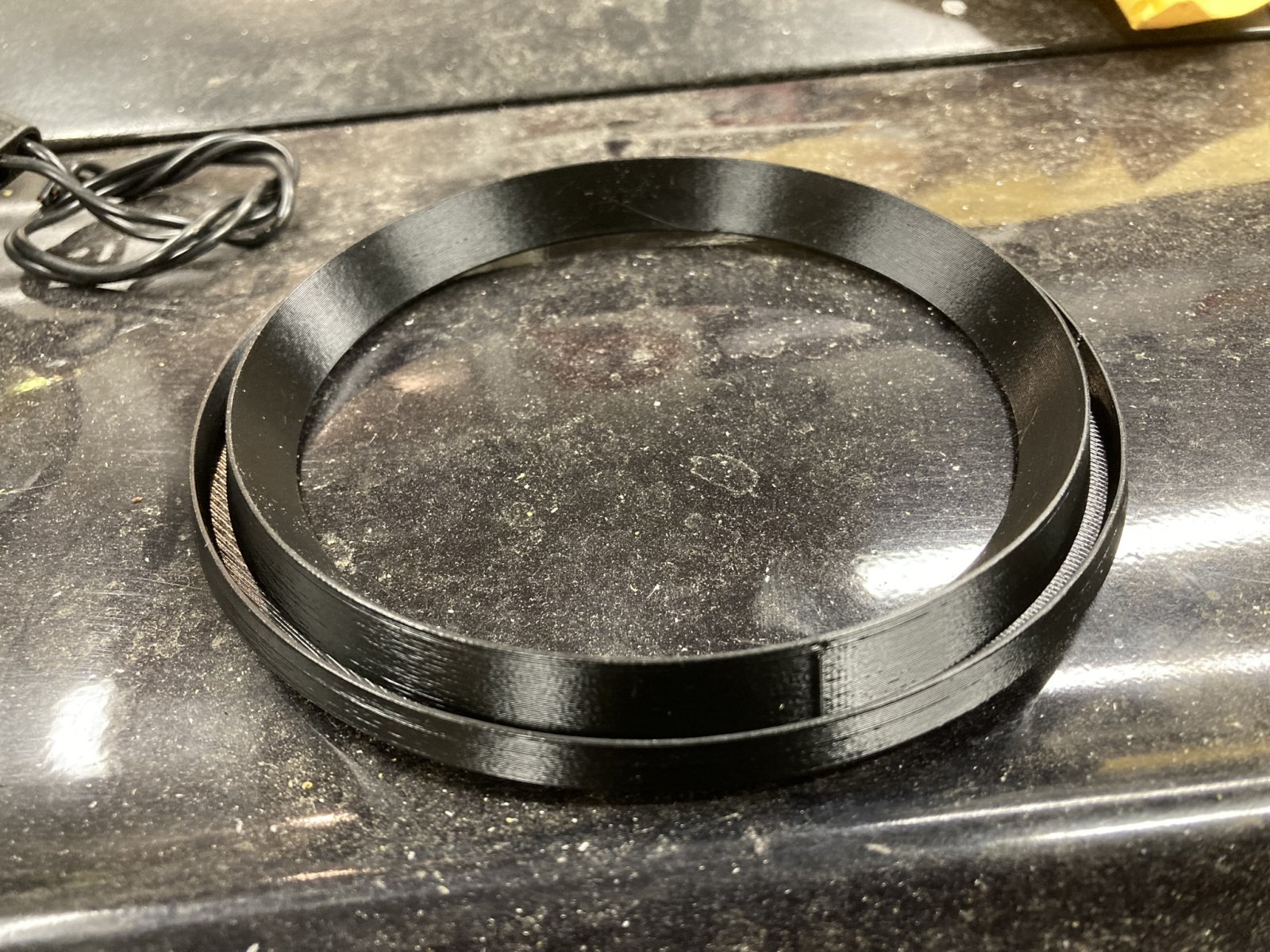

    Haven't had much time to spend on the roadster the last couple weeks. But I did have an aluminum version of my fuse panel cover printed. I sanded and polished it and it turned out ok but there is a weird striped pattern in the material from the printing process. Would probably look ok if it were chromed though.

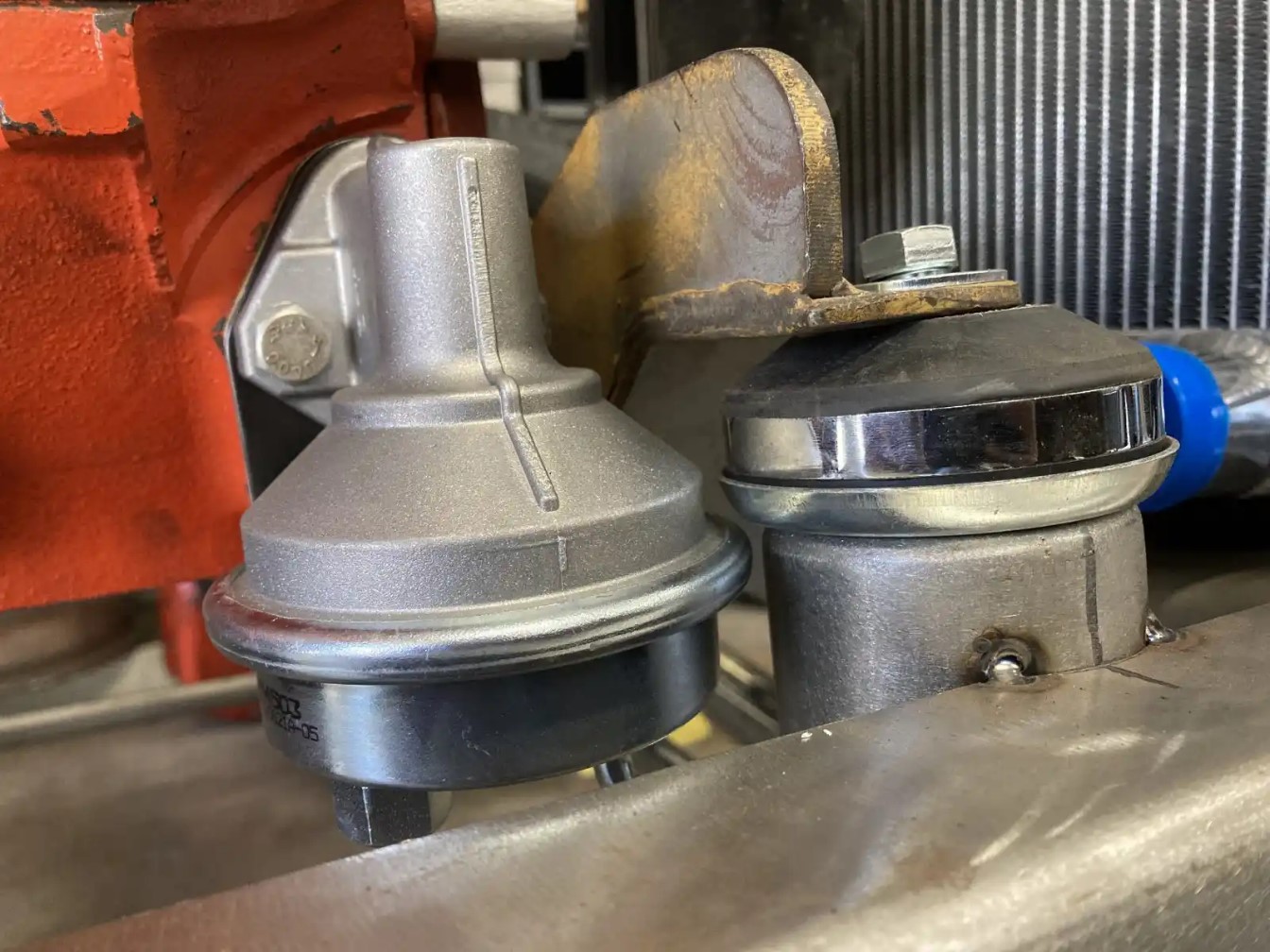

    One question: How much space is between the mechanical fuel pump and the Hurst front motor mount?
    I was under the impression that they interfered with each other and therefore, were mutually exclusive.
    Do the motor mount bolts prevent you from using a bolt to hold the pump rod in place during pump installation?:confused:
    *EDIT*: Never mind. I just saw this photo back on page 3. As you were....

    I was worried about the pump fitting. My Hurst mount didn’t have spacers with it, but I read up and found that there are supposed to be 3/8” spacers between the block and the mount. So I made some. And everything is very tight, but fits. I read a lot of stuff on which fuel pump to use as some are supposed to be smaller than others but never found a definitive answer or part number. I did have to tweak the fuel inlet on the pump a little to clear my frame bracket.
