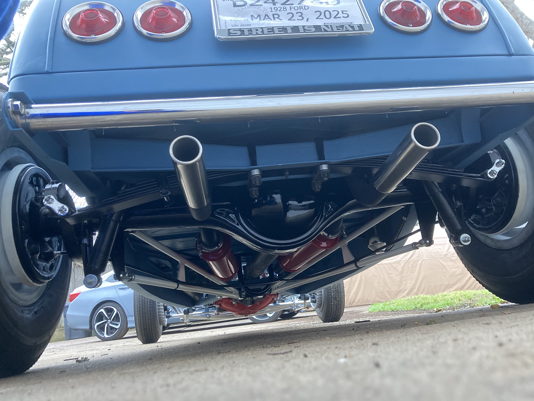

    At the other end of the car…spring clamps were too tall. I drew up and ordered these from Send Cut Send before I left for the roadster show, and they arrived yesterday. Tacked the spacers to the main bar and bolted them on. The car settled a good bit out back. Looks good but I think I might need to raise it, probably stack a couple short leaves at the very top…so I might not need the spacers, hence tacks only so far.

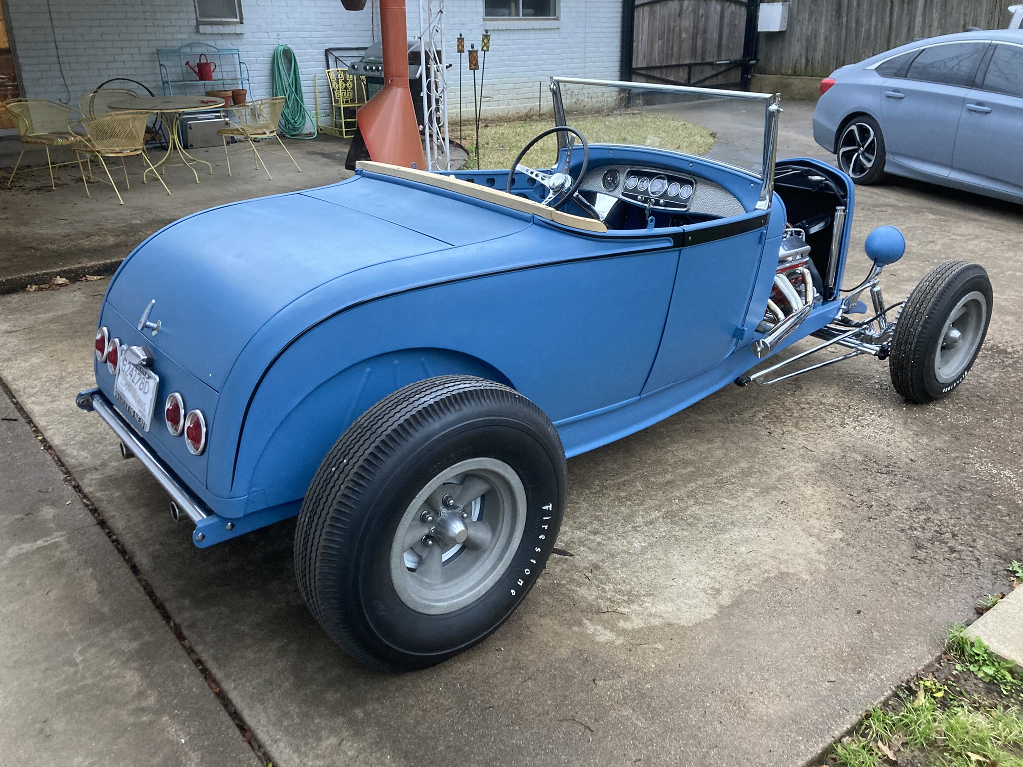

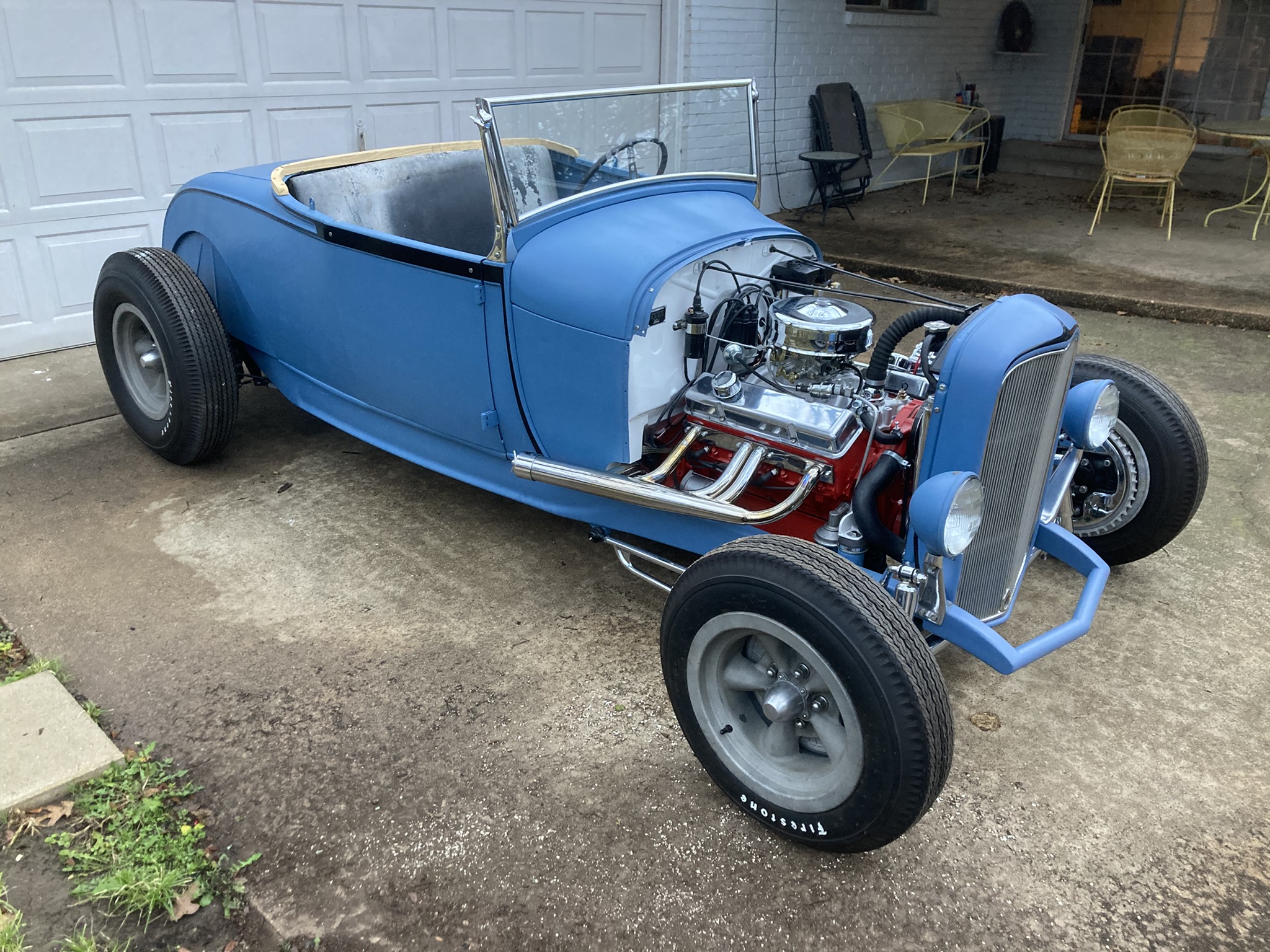

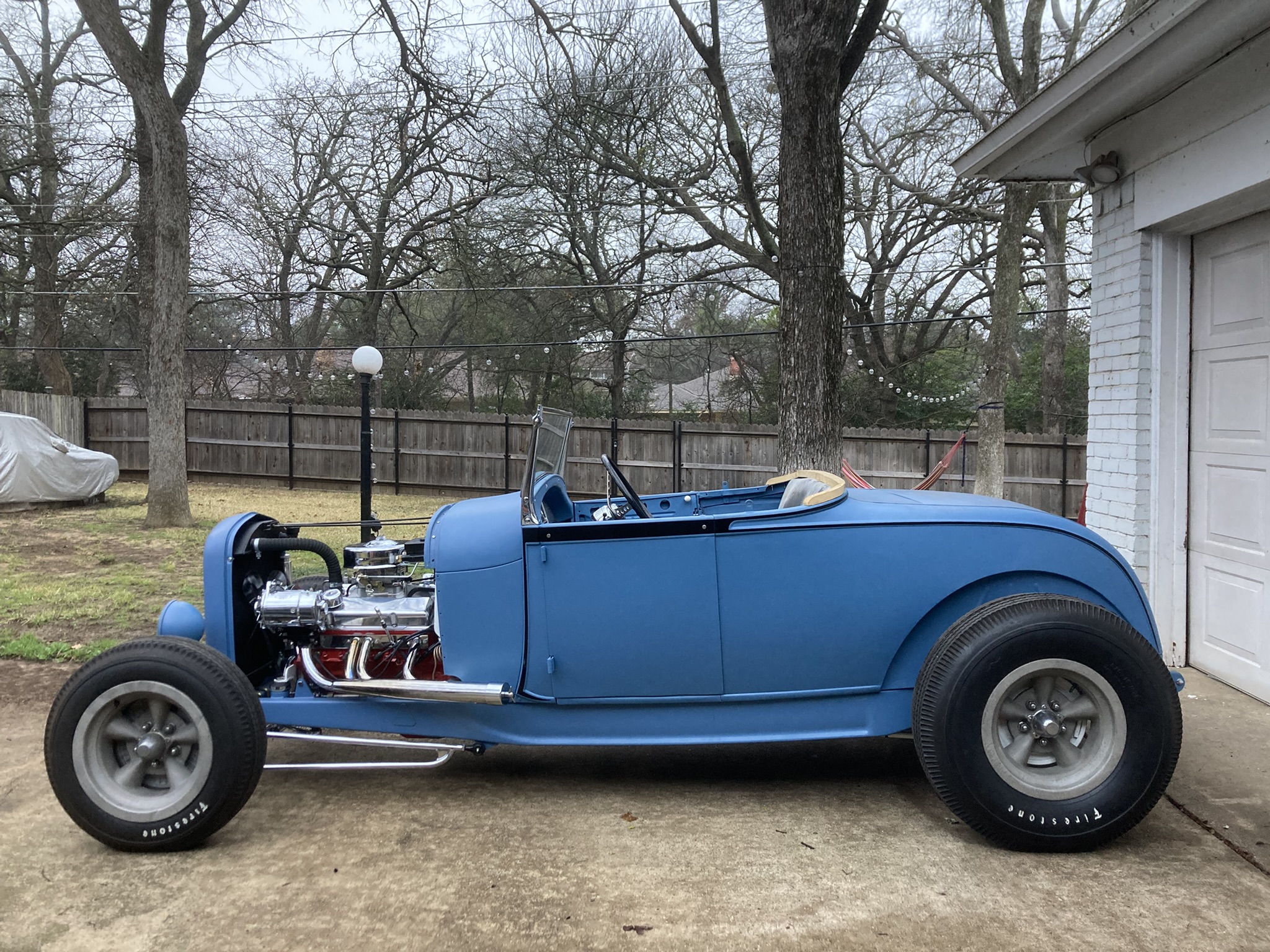

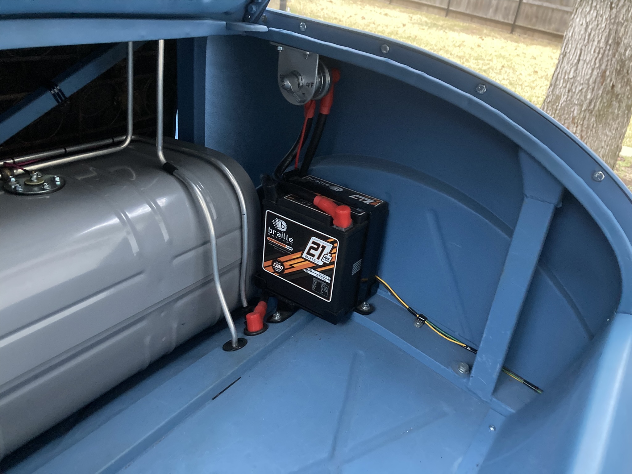

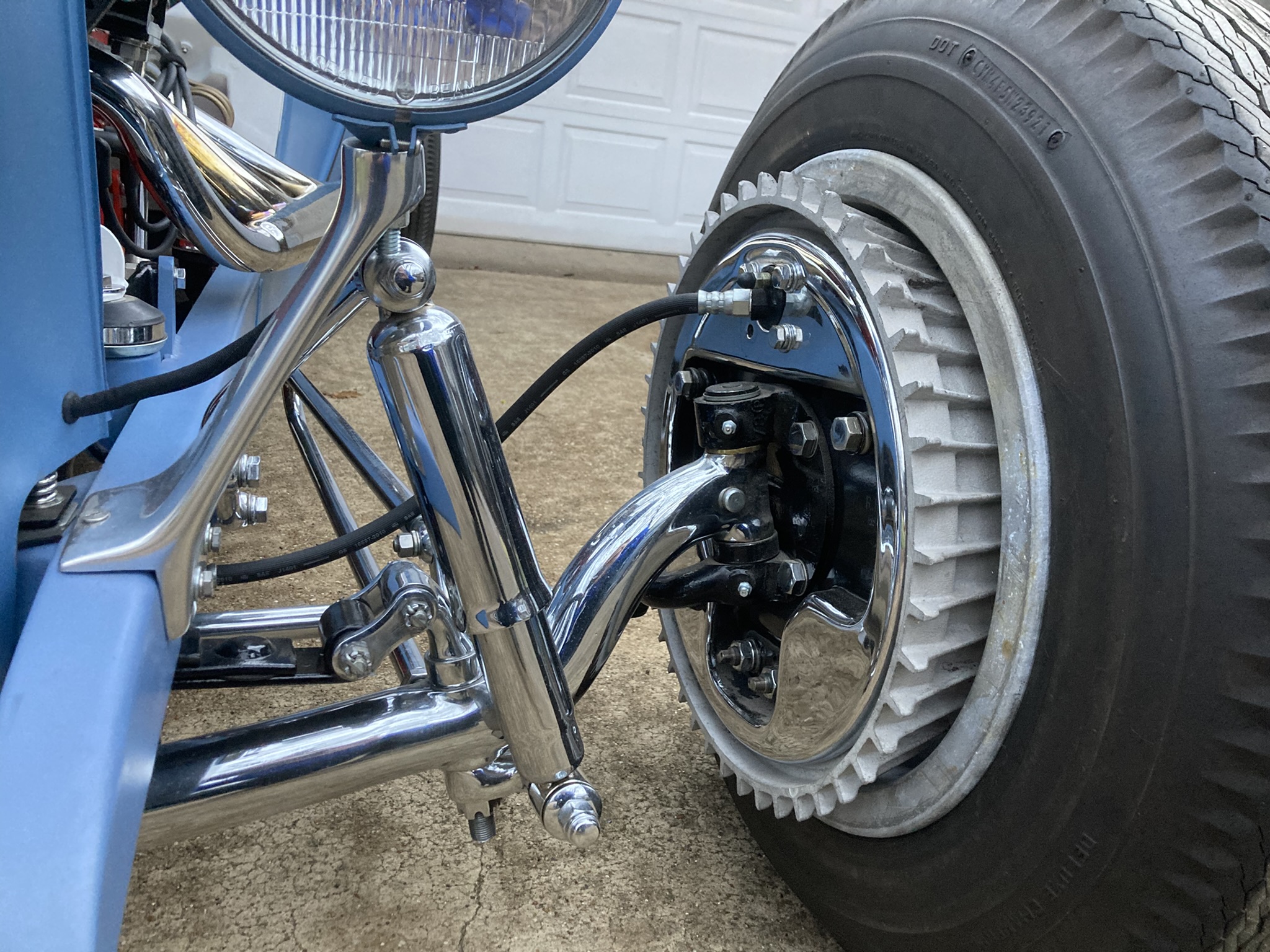

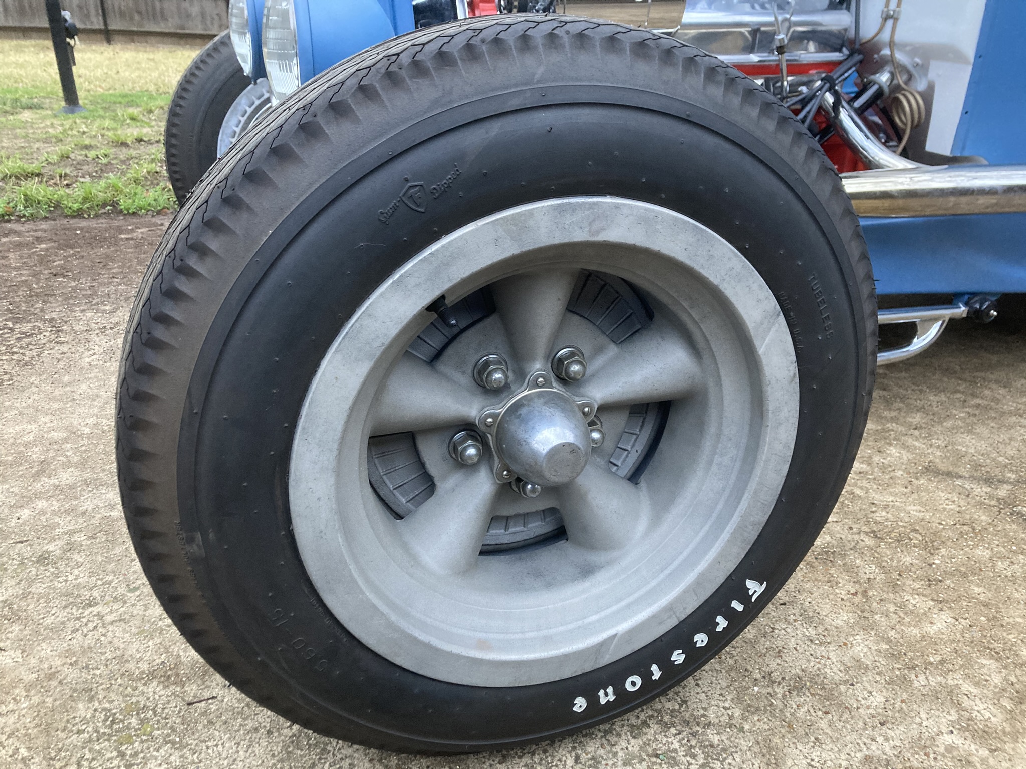

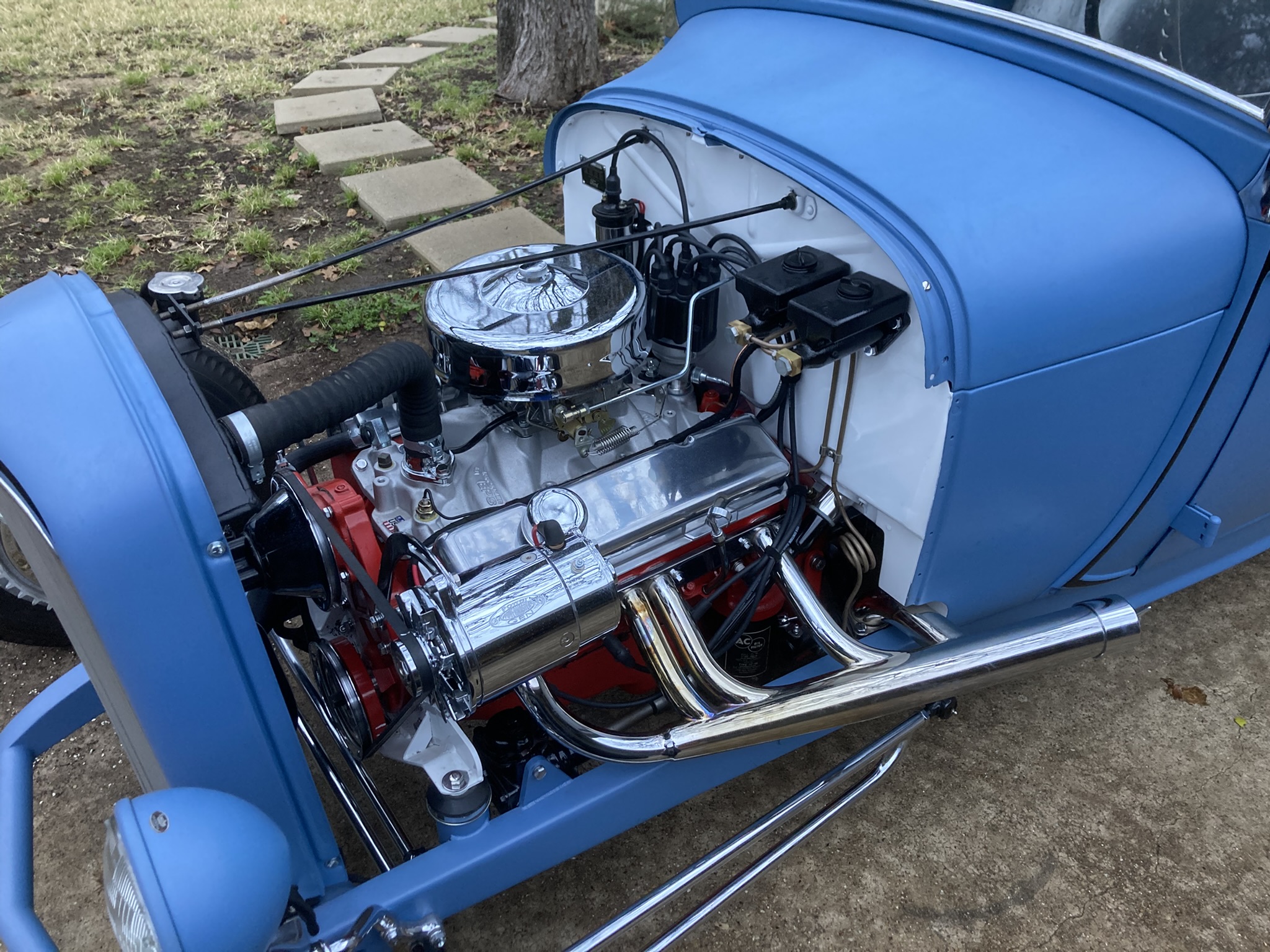

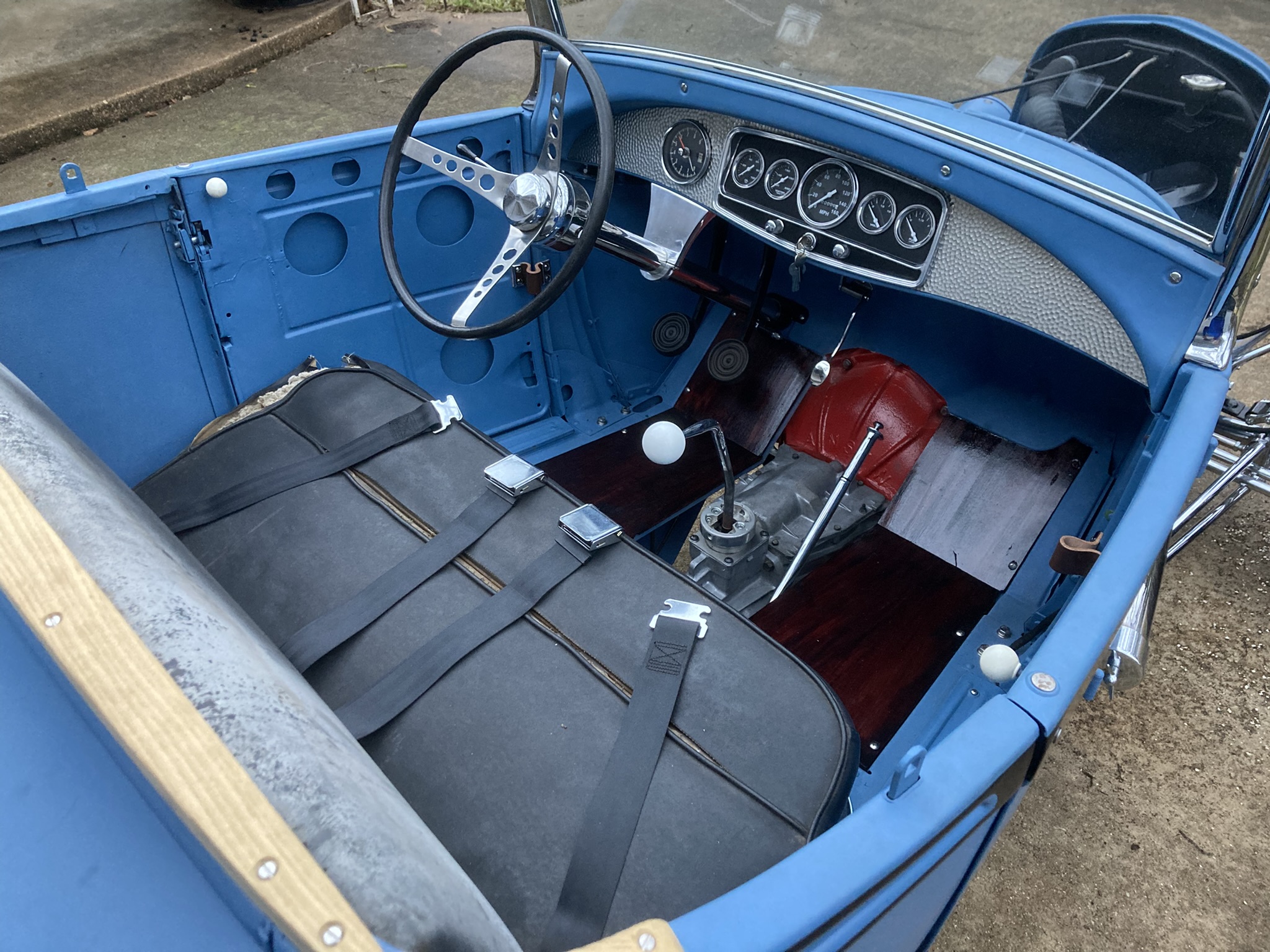

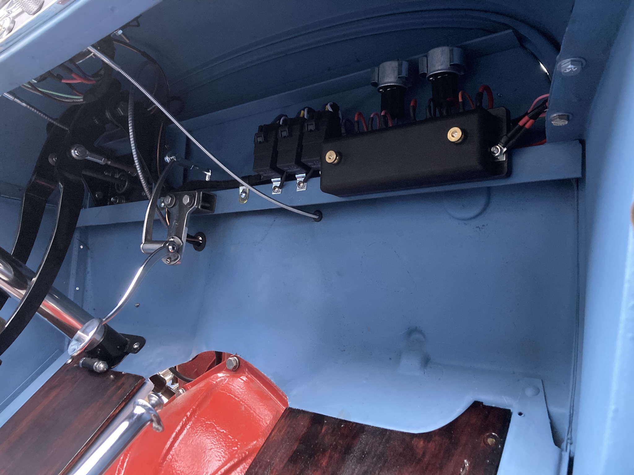

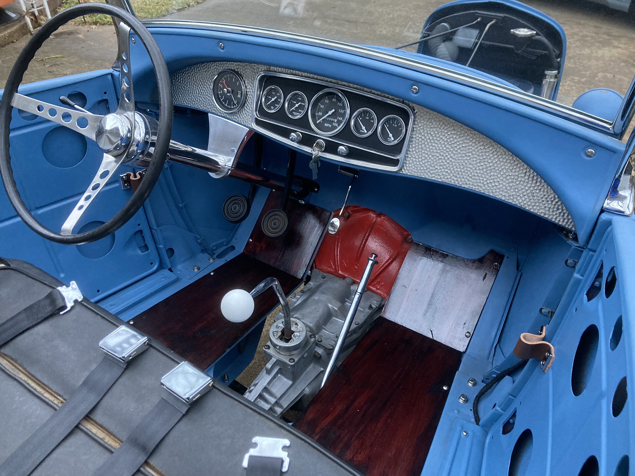

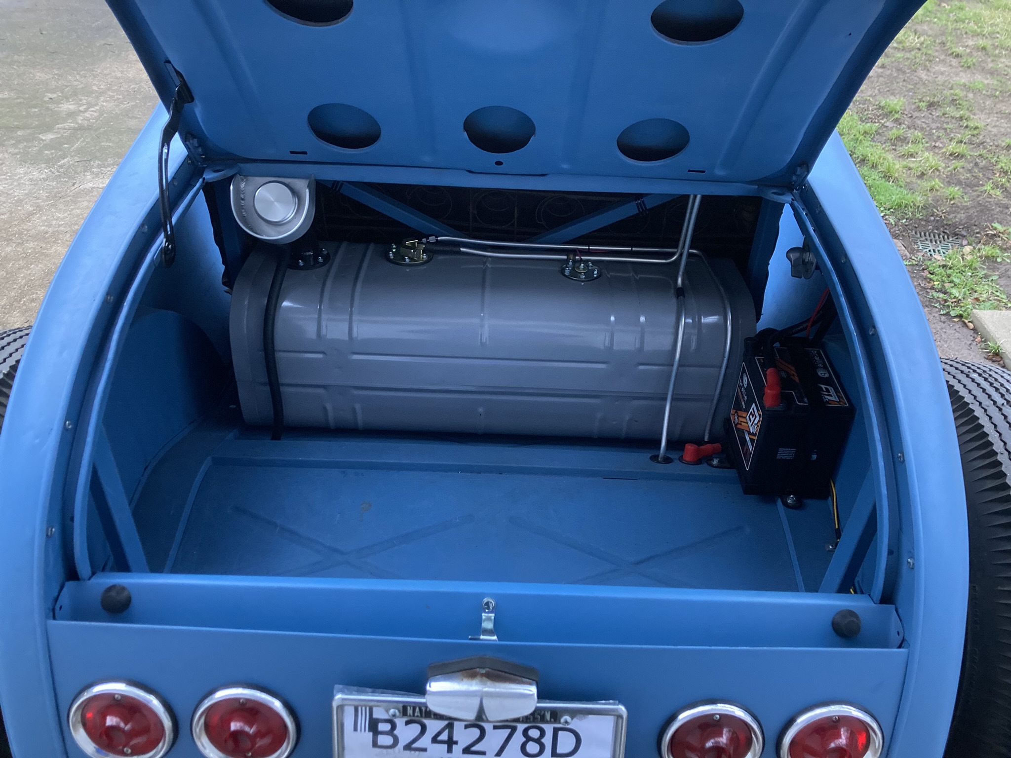

    I have no intentions of turning another wrench or spending another discontinued penny on this car. Consider this the end of the build.

    Sorry to hear that. Have followed and enjoyed your build since Day 1. I ***ume we will now see it listed in the HAMB Cl***ifieds as a running, driving and stopping "project". Was looking forward to a "Roadtrip to the ROC" story at a later date.

    Turned out killer, very tidy.
