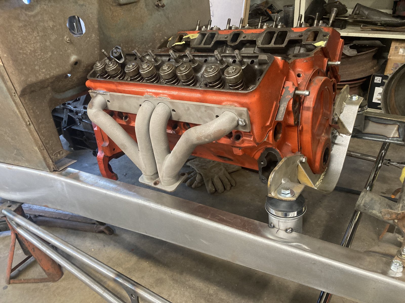

    Nice job man on what you have done so far, Just a suggestion, I would reshape that speedway (Hurst) Motor mount at least on the right side so you can run a chevy manual fuel pump. All you need to do is pie cut the mount bend it forward and move your mount forward. You could do the other side as well so they match. Not trying to tell you what to do with you project, Just a suggestion.
    Stogy and Anderson like this.
  8. Anderson
    Joined: Jan 27, 2003
    Posts: 7,560
    Anderson
    I picked up a fuel pump this week to see how it fit, it clears the Hurst mount - it is a Hurst - just fine (I made some spacers when I set everything up) but I need to tweak my frame mount just a little. It’s on the list for this weekend!

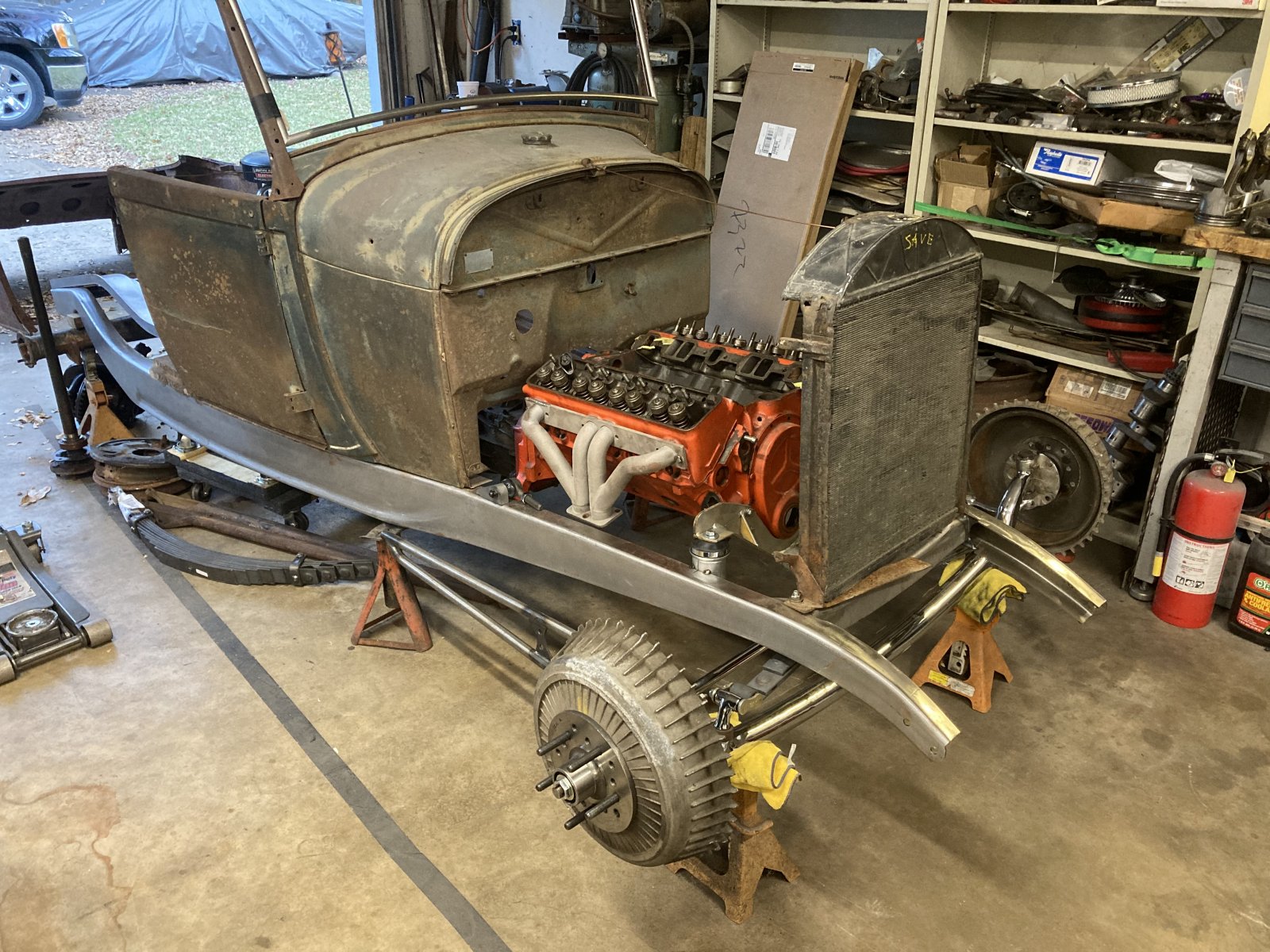

    With a bunch of parts just ordered and others still on the way, I spent today on the cowl. At one point I suspect the cowl took a pretty hard hit that ripped the p***enger windshield post and bracket off, and bent back the filler piece under the windshield. I had acquired the pieces to fix this a while back so decided to knock that out. It was easier to cut and splice the piece under the windshield that to repair it so that’s what I did. I also pulled the tank out and cut the bottom away, revealing that this whole thing had spent some time upside down in the California pines. The tank top is pretty thin in a few spots but it’ll have to do for now.
    After the fixes were completed I decided to go ahead and chop it. I cut 2-1/8” out of the windshield frame and 3” out of the posts to get rid of the gap under the frame. I’m not going to lean the windshield back any.

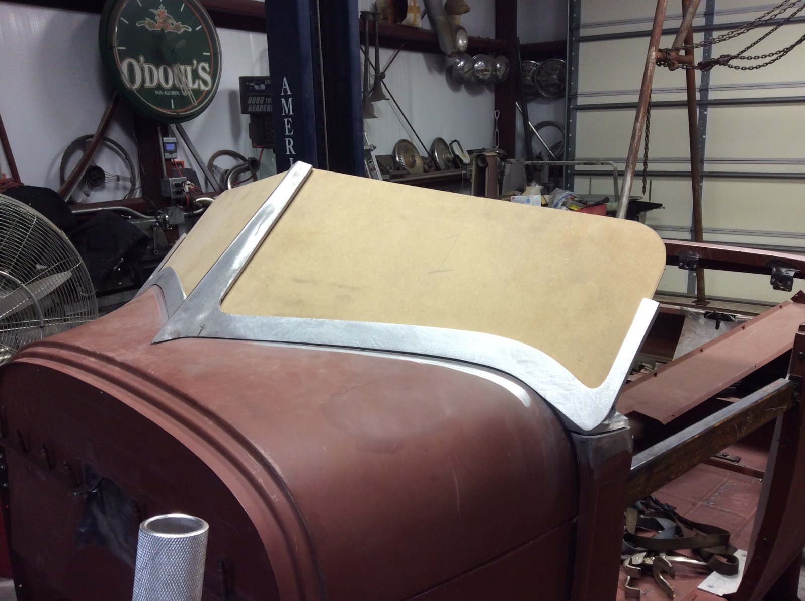

    Not a problem for a stepper, you can notch the bottom sides of the shell to lower it without reworking the insert. The insert takes effort to match the stainless filler so you don’t have a line. If I remember right I used 308L . 309L is a lot harder to work with. 309L will work on cast iron repairs but it’s hard to drill and extremely hard to tap.

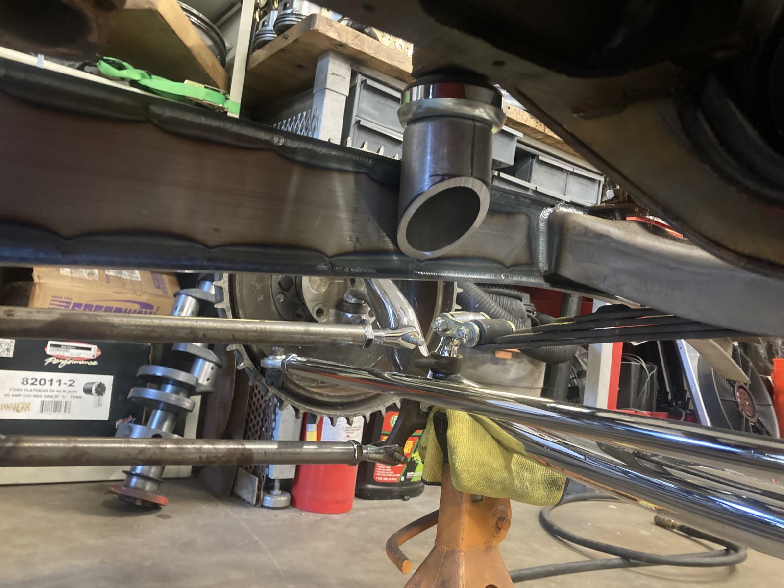

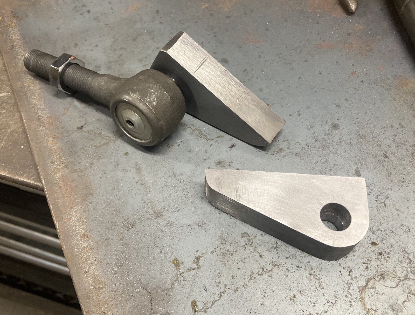

    The ladder bars showed up this week. I saved another hundred bucks buying them without axle brackets. Since I needed to make the spring hanger brackets and had a bunch of 3/8” plate anyway, making those was no big deal. Had to remove the really old factory style shackle pieces out of the spring hangers, then shave down the back edge so it would fit a 2” shackle. The spring I'm using is a 3" drop Posies front spring for a '41-'48. Got as far as getting the hanger brackets tacked onto the housing today. I don’t like the angle that the ladder bars are at as provided on this frame, way too narrow at the rear axle. Going to cut the tabs off of the crossmember and relocate them so the ladder bars mount a little farther outboard. That’ll have to wait until Sunday I guess. Once all the bracketry and ladder bars are sorted out and I get closer to being more sure of ride height, I will cut that tubular rear crossmember out and replace it with a ‘36-‘48-ish one I have.

    Today I got the rear suspension sorted out. Cut half the front ladder bar brackets off and cut enough of the welds off of the other half to be able to re-angle the bars while keeping a solid pivot point. Moved the bars out about 3” per side, tacked the brackets to the rear axle, then removed the front hardware and cut the rest of the front brackets off. Got the rear spring bolted up and the axle center line sorted, then (because angling the ladder bars more effectively made them shorter) welded the front mounts back on about an inch rearward. Installed studs in the rear axles and bolted my wheels on. My rear tires and front wheels are on back order, but my front tires will be here Monday haha. Also bolted up my headlight mounts and King Bees.
