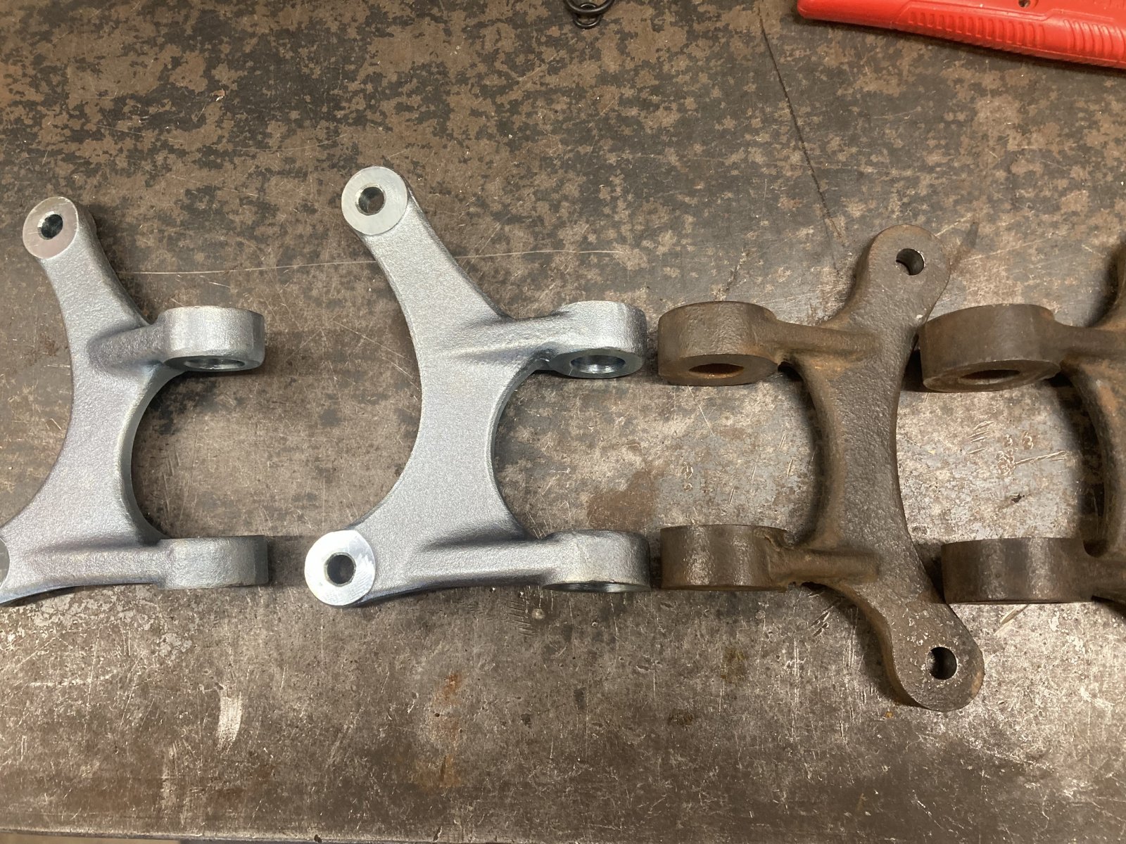

    But now, again, it’s roadster time. As cool as the old batwings were, I didn’t like the fact that they were cast and I also didn’t like that they centered the hairpin on the axle. The hairpin looked like it was heading too downhill towards the front. So I got these from Speedway which are forged and raise the front. They are for a 2-1/4” axle so I dug around in my magic spacer bin and found a couple that were just right. I also didn’t like the kinda rat-rod plate that was welded in the middle of these hairpin, and they were too long overall. So out came the cut-off wheel. I had the right tap for the tubing ends but it is just too dull, so that is where I stopped today.

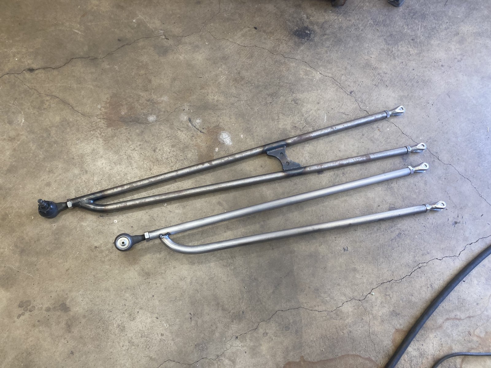

    I should have just bought my own tubing and made the hairpins from scratch as that’s really what happened in the end, but oh well. Some shortening of the top bar and a new bend on the lower one makes them much more like what I had in mind. I also got the new radiator fit and notched the sides of the grill shell 1”. I think it’s just about right. The M&H Racemasters keep being back ordered longer and longer, so that’s been cancelled and a pair of Towel City pie crusts have been ordered.

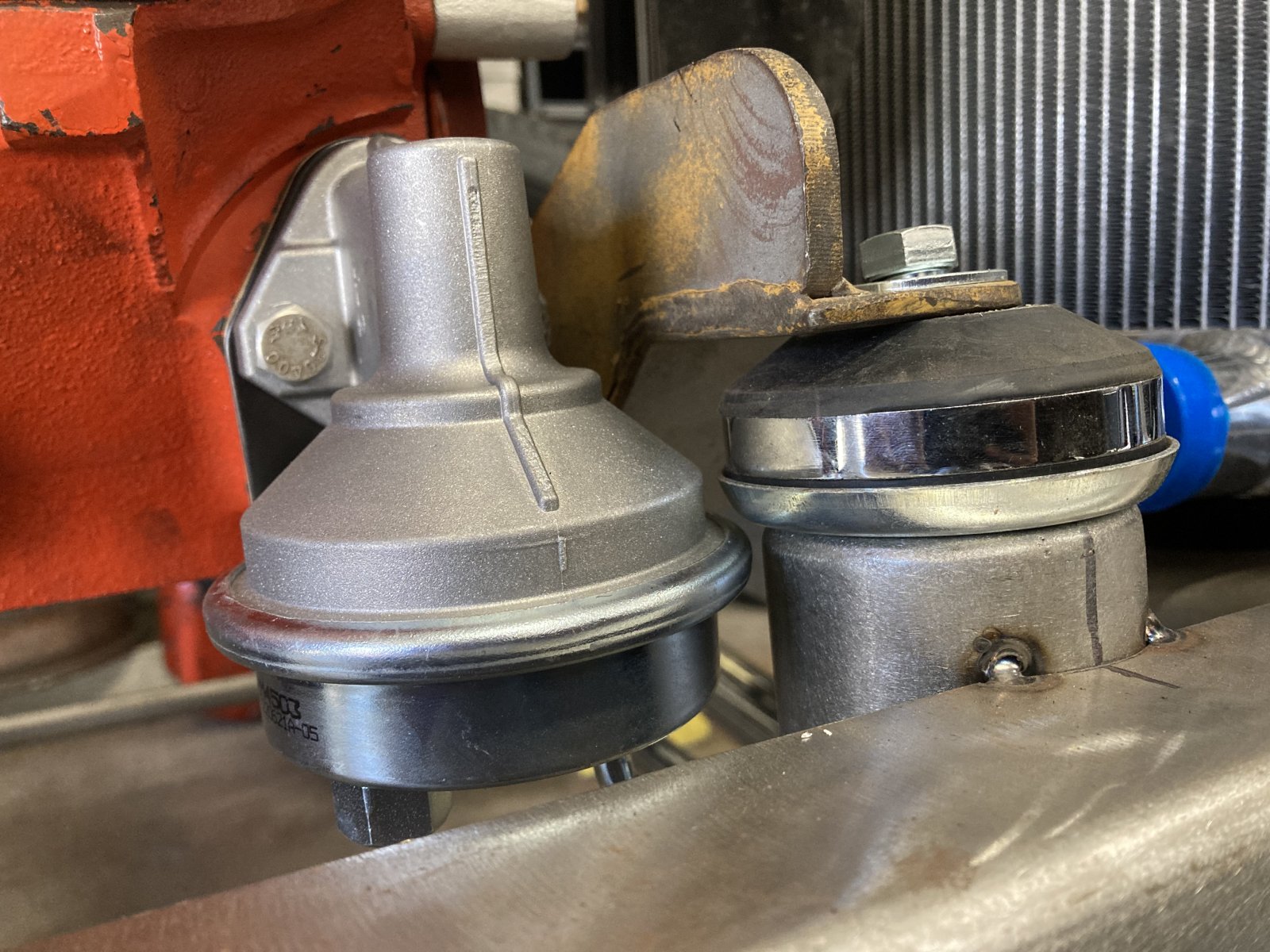

    Anyway, messed around some today. Fit the radiator support rods so I could get rid of the welding wire holding it up. Moved the engine around a little and the fuel pump fits…just have to notch the frame mount a bit to get a hose on it. It’s a Carter M4503. I’ll probably make some thicker spacers for between the Hurst mount the the block to better center it on the frame mounts too. Messed with some shock mount stuff and have an idea of where they’ll go. Going to bend some F1 mounts around to work. Set all the junk back on the engine cause I like looking at it.

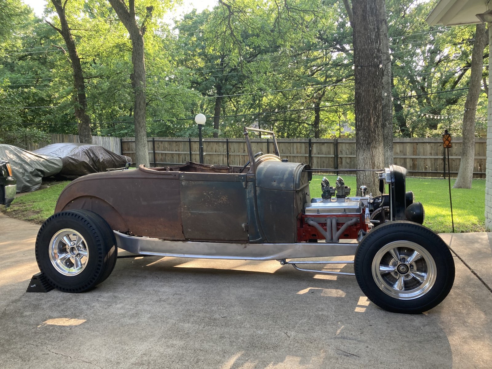

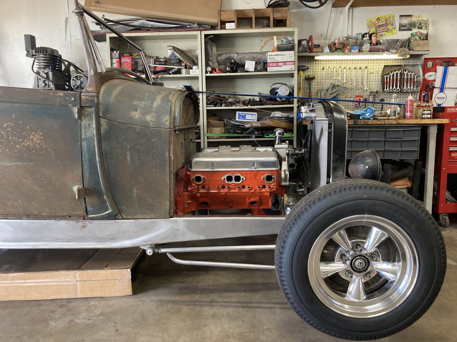

    We have rear tires! And finally a roller. Keep in mind that the back half of the car is just mocked up junk, but it’s so good to get to stand back and check out what’s happening here. Sorry about the late models.

    Don’t mind the crooked…everything.
