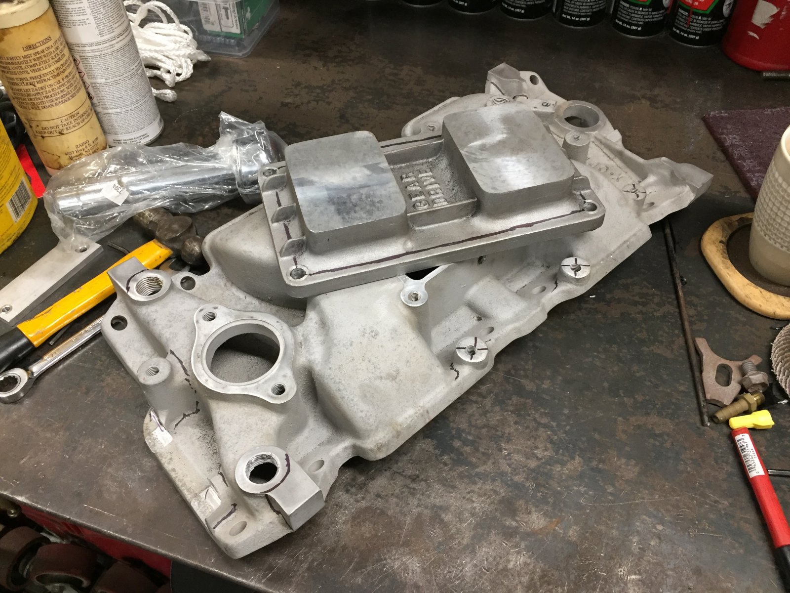

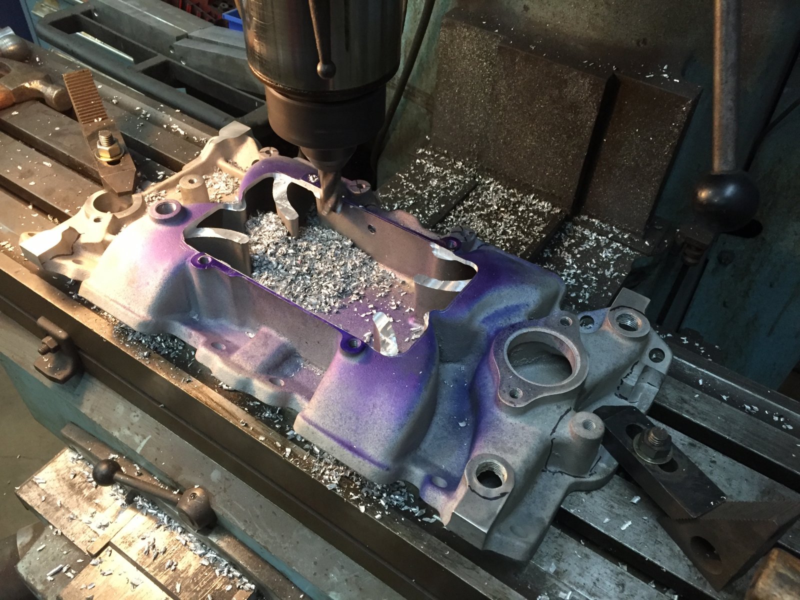

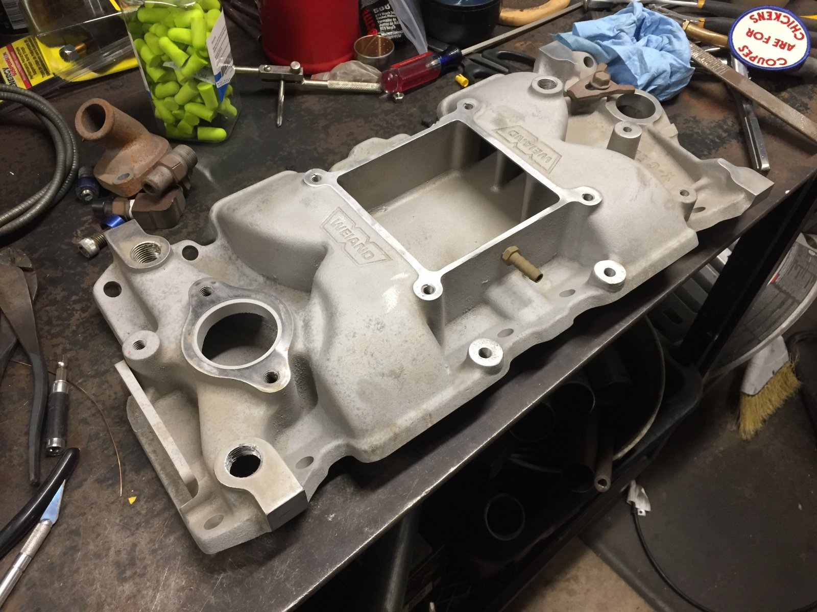

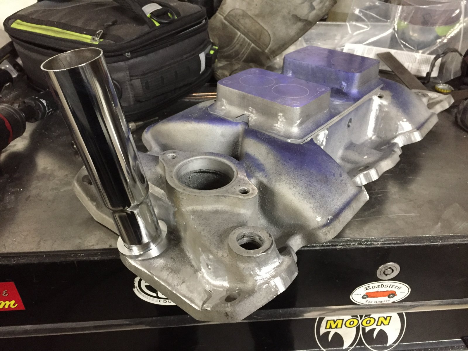

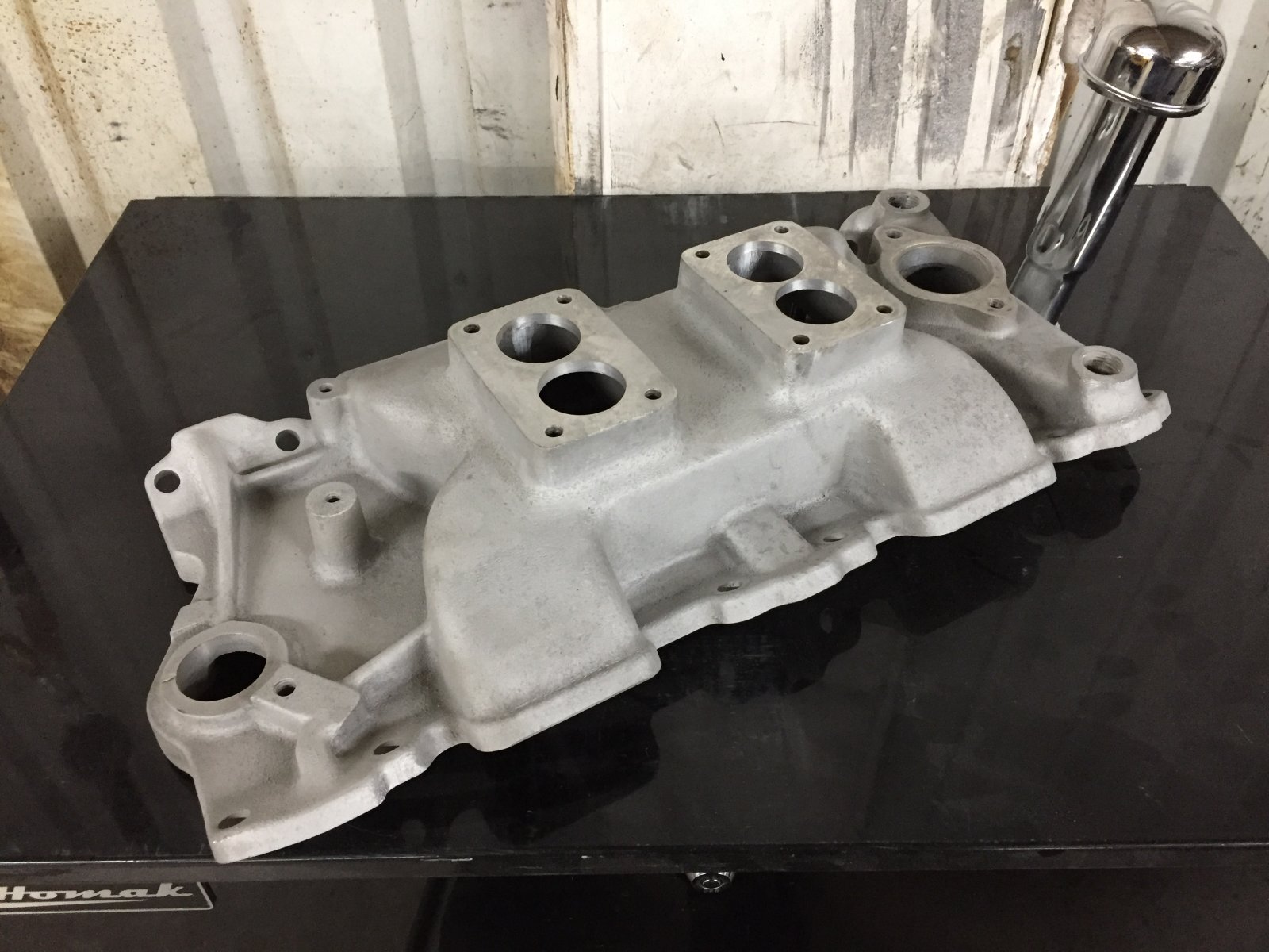

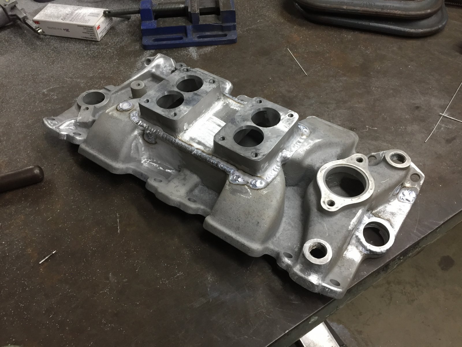

    Great build so far brother and love how much you're doing your own fab work. Whatever we can build we build with new parts being overpriced and most times junk! Cudos on the intake fab. something about a milling machine just gets my juices flowin!! Keep pounding away. Like the 57 sittin in the shop as well. Halfway through a full build on my 56.

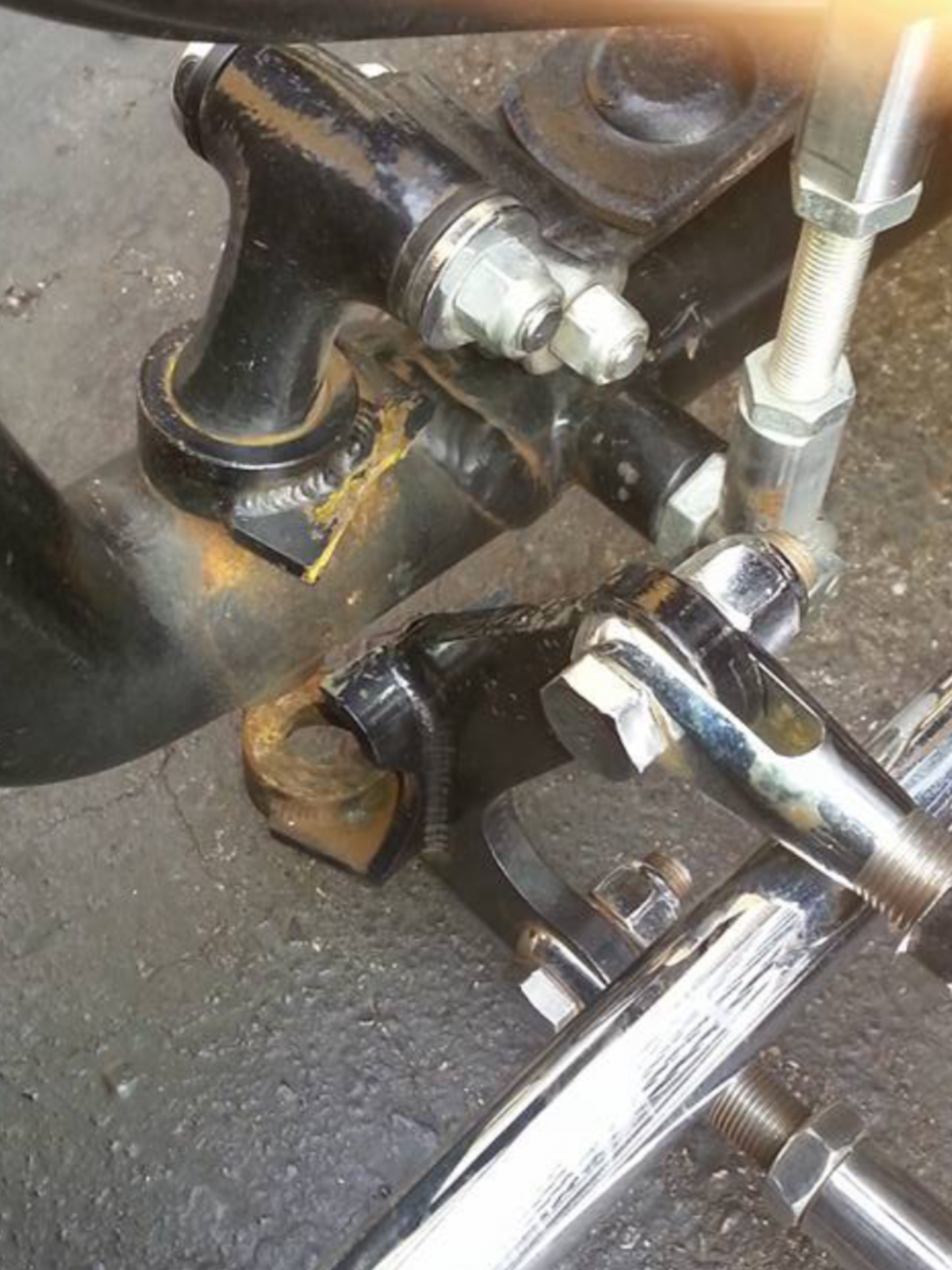

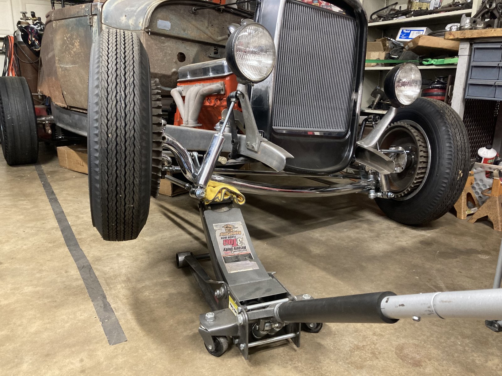

    Hairpins and a tube axle…a little scary to me!

    don’t be skurt

    Just for kicks, here’s the p***enger tire a good 10” off the ground with no signs of suspension bind. Between the flexibility of the hairpins with tie rod ends out back and the thin but forged bat wings on the axle, I think this is about the best case scenario for what you’re not “supposed” to do.

    That intake is really well done.

    Fab work is awesome, great rod.

  9. Love your build. But, if I look at your test, it appears the frame twist is acting as your suspension. The actual suspension seems rigid (the axle to frame distance on each side appears to remain parallel, as you would expect if it was on flat ground...might be camera angle trickery). Your right side shock doesn't appear to have compressed at all. But I'm only offering up my observation.

    the shock mounts are not attached to the frame at all, just hanging off the ends of the shock.
    The front rails need to be C-notched for the spring still, so the spring is bottoming out on the p***enger side…but the fact remains that the drivers side tire remains on the ground. I’m probably an idiot but don’t think that makes a huge difference. I will replicate the test after the C-notching later on and see how it goes.
    And I also wouldn’t call it frame twist, but maybe ch***is articulation. I think a lot of folks worried about the tube axle being so rigid don’t take into account that the whole frame and body are also pivoting on the rear axle. The “math” is based on the entire frame staying perfectly level when the car has to go over a big bump. But the entire rear pivots around the top of the spring just like a factory Ford would have done. It’s a ‘28 roadster without sway bars, on narrow bias ply tires, body roll is very much expected. If you have something on coil overs out back then it’s a different story, but for this ch***is it all works just fine.

    Guess you have to jack it up and down 3” about 25,000 times!

    @A ***** i would ***ume the forged bat wings would put up with a lot more than a welded set up?
    I’m also trying to imagine where you could get a an old ford to compress the front suspension 3” on a regular b***es.

    Wow! I’m sorry if this is arrogant but that bent portion of steel to go from bottom and top of the axle looks to be more than half as thick as I would expect using my Hillbilligy CAD program(my noggin). @A *****.

    I’m only going to do it 24,999 times
