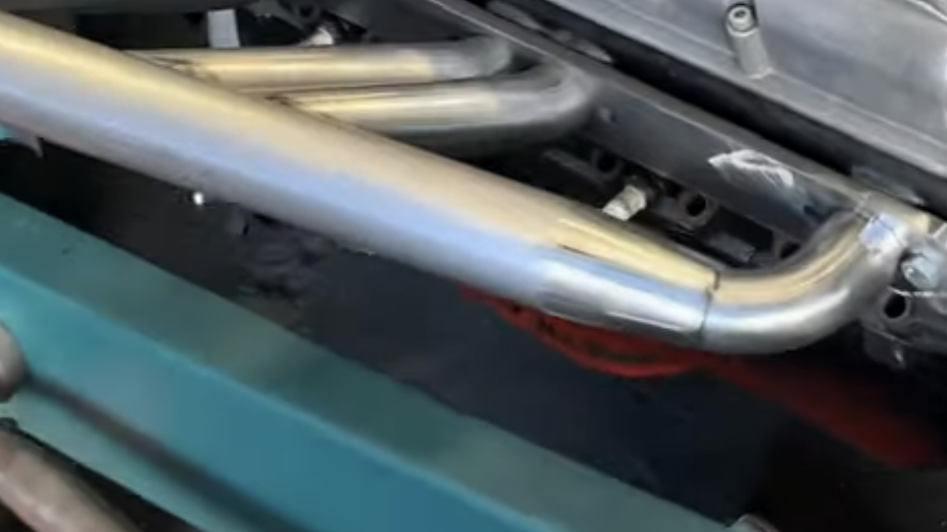

    That I do not know. But I'm guessing not because if you look at the car's headers, while the collector is bigger than the primary, they don't have much of a cone shape that a 35-36 driveshaft has. The collector looks to be a consistent diameter throughout.

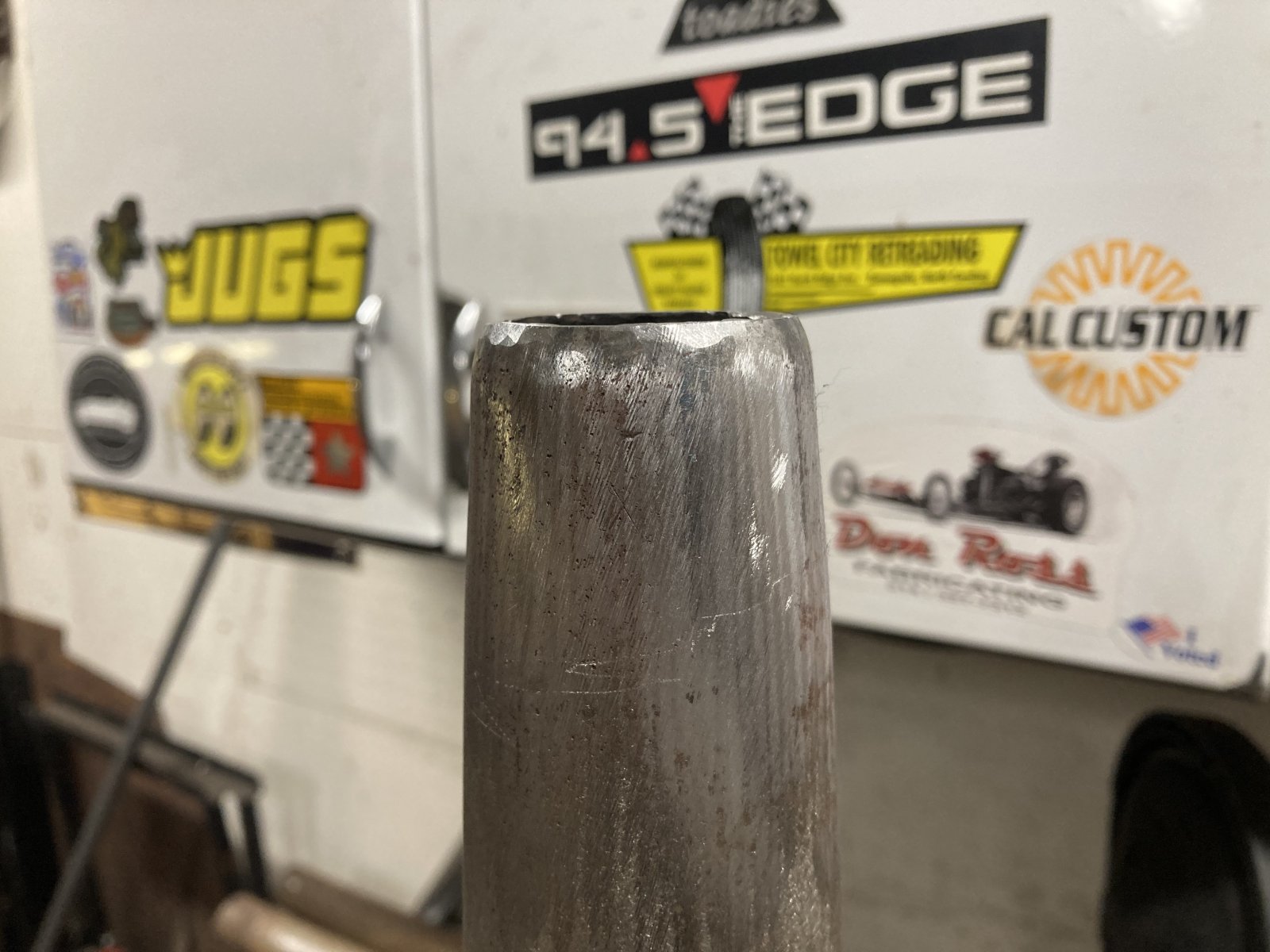

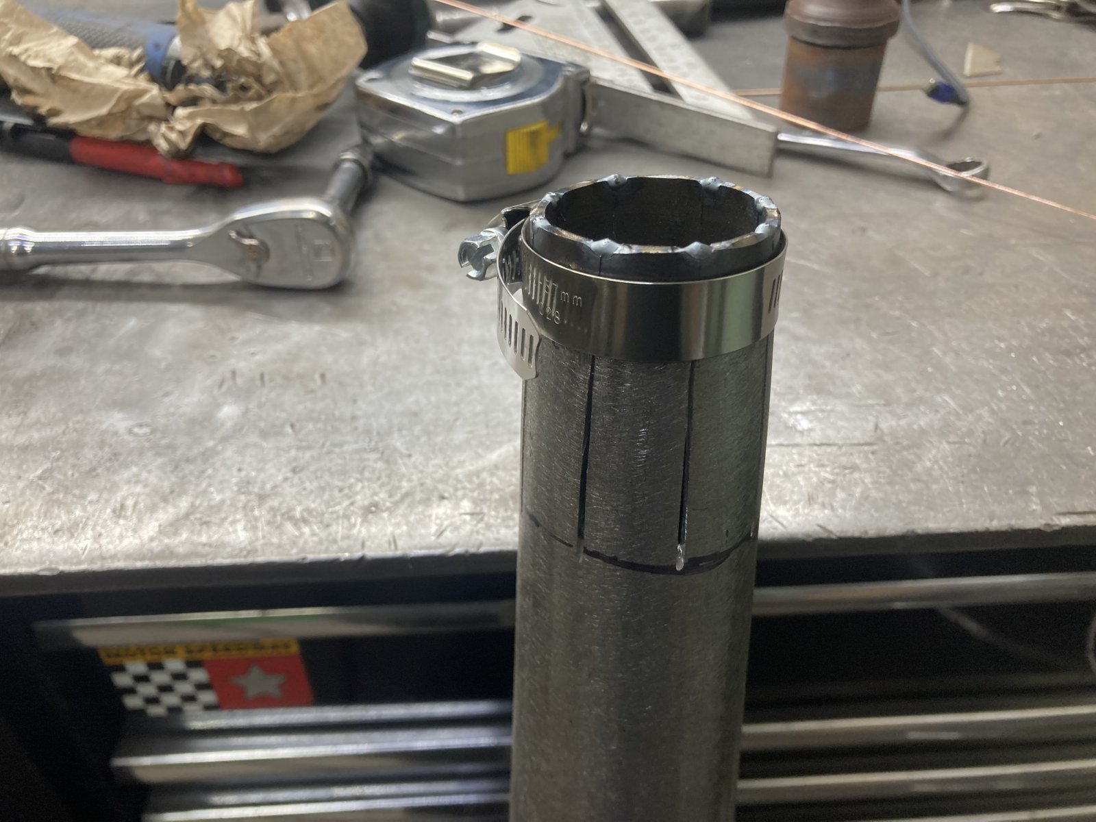

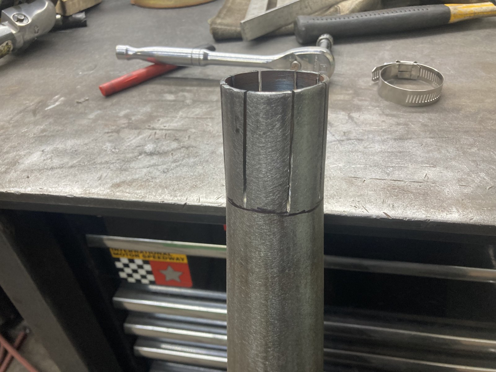

    It’s funny how I often end up working on the same thing at work as I am working on at home…making some exhaust out of full driveshafts for a ‘32 5-window. Much like the above picture shows, I pie cut the part where it straightens back out, clamped it and welded it all together. The male end of the driveshaft that I cut off previously made a good dolly for straightening it out. This worked well for getting it down to 1-3/4”. I’ve got to go to 1-1/2” for my own car though, so we’ll see how that goes.

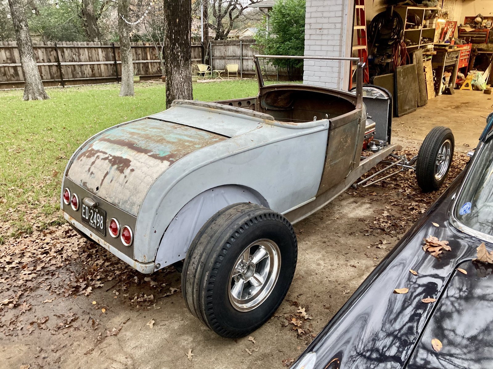

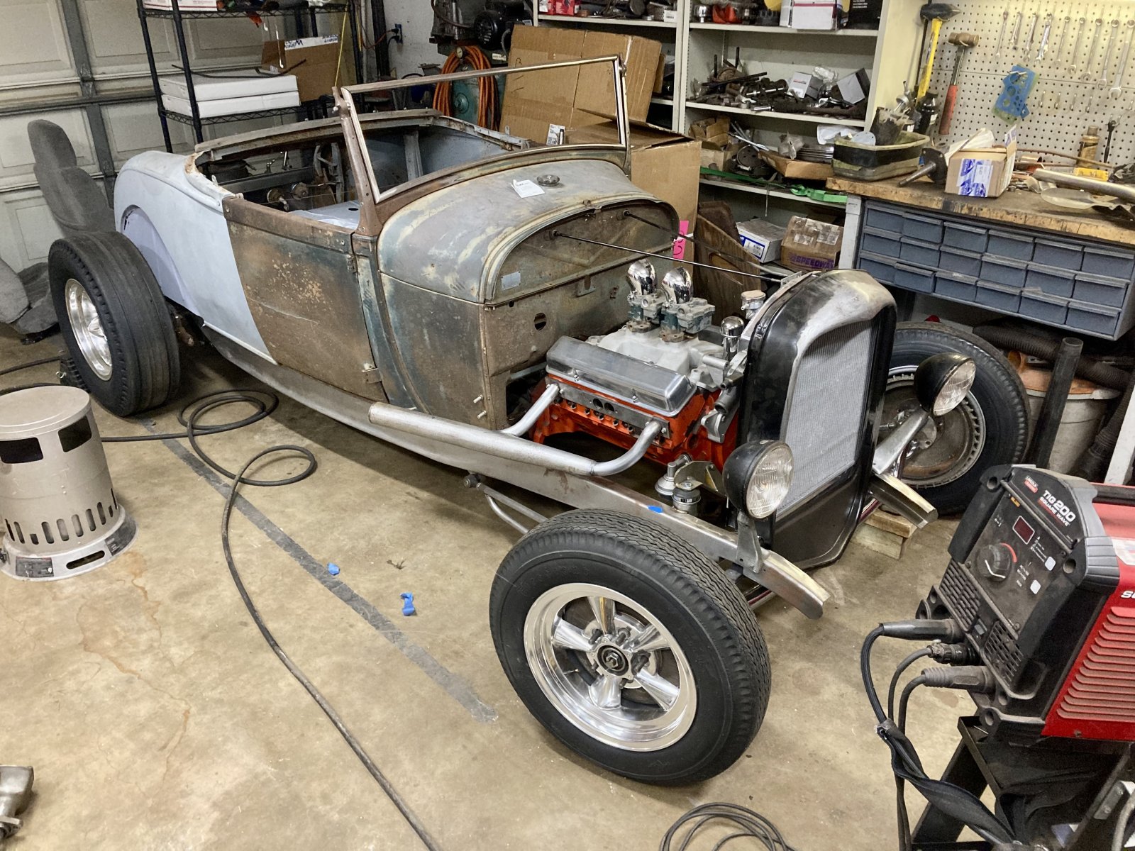

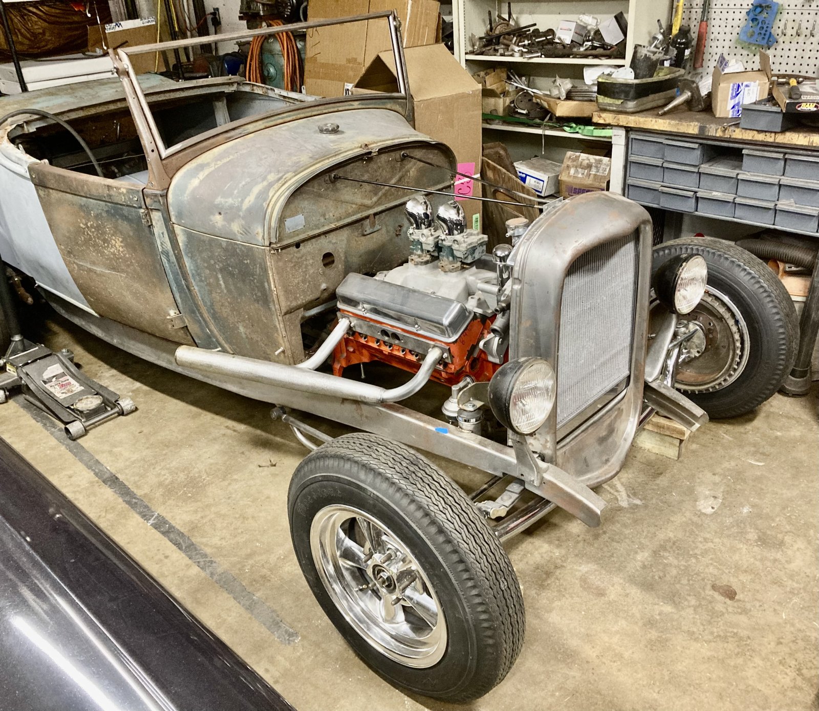

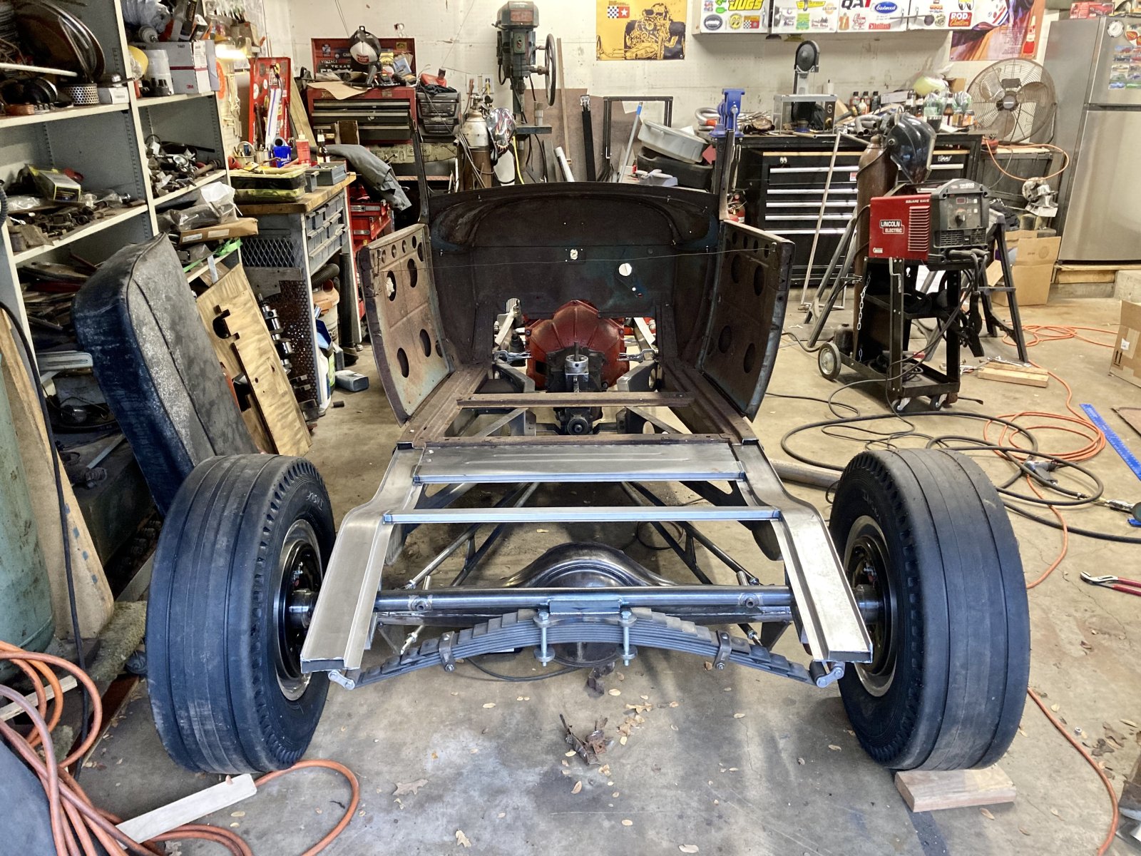

    I finally figured out how ahead of myself I was getting with headers and other stuff. Got back to some more important tasks like getting the body fit and located on the frame, then getting the rear subrails fit and welded together. Then I was able to better mock up the back half of the body and see where braces were going to land and need to be cut or modified. I still have some fitting to do but it’s pretty close. The aforementioned rear end narrowing will help too.

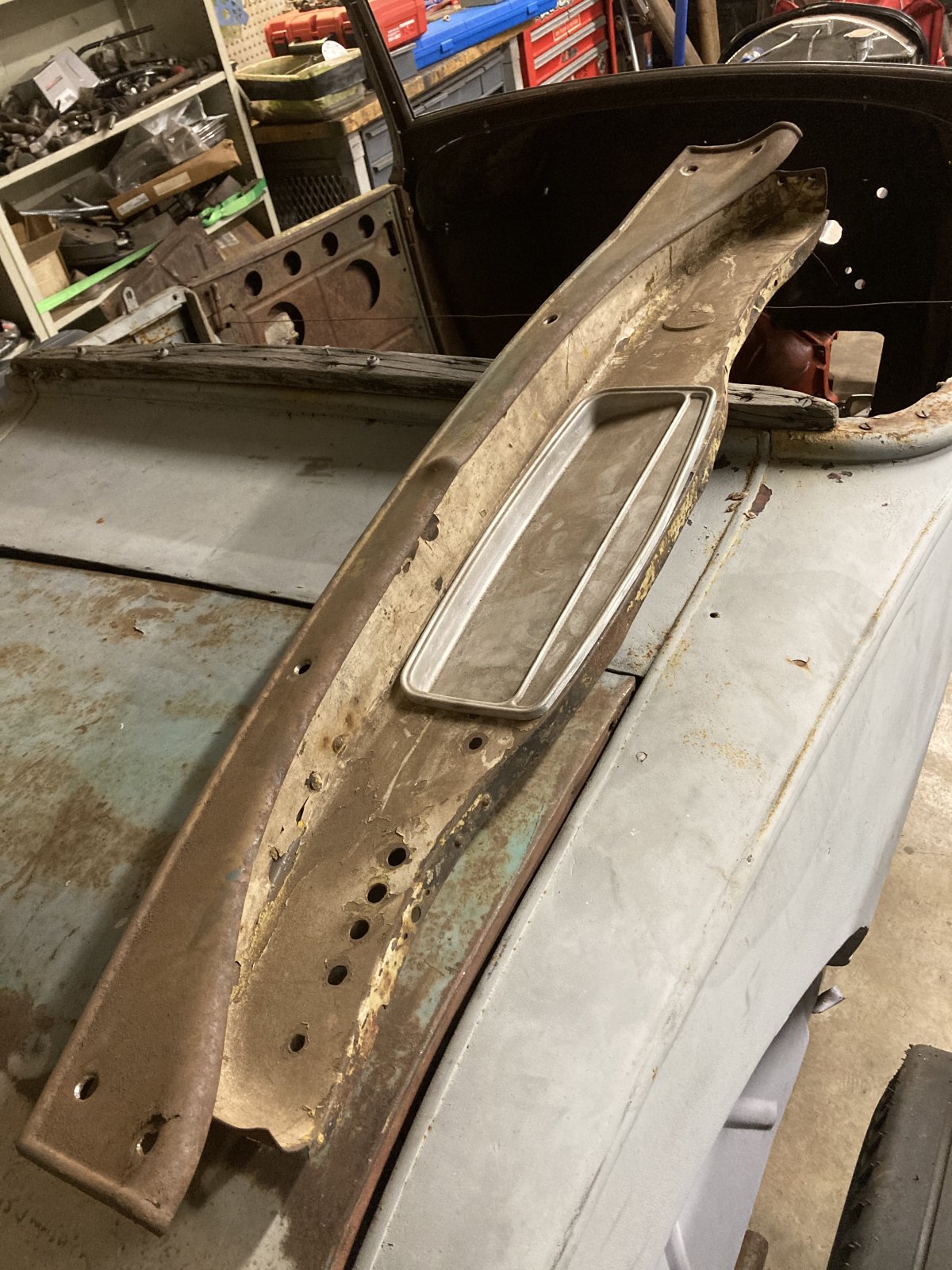

    This dash was slated for the late T roadster I was building a few years ago but will find it’s way into the A.

    That dash is neat! What is it?
    I think we can forgive the Vega as long as there’s not an ***ault on our eyeballs with a t****ze of joints and rod hanging out in the breeze. I’m sure you’ll nail it

    Correct, the insert is from Karl Knecht. He hasn’t been selling them for a while.
    The dash itself is Desoto, but I don’t know what year.

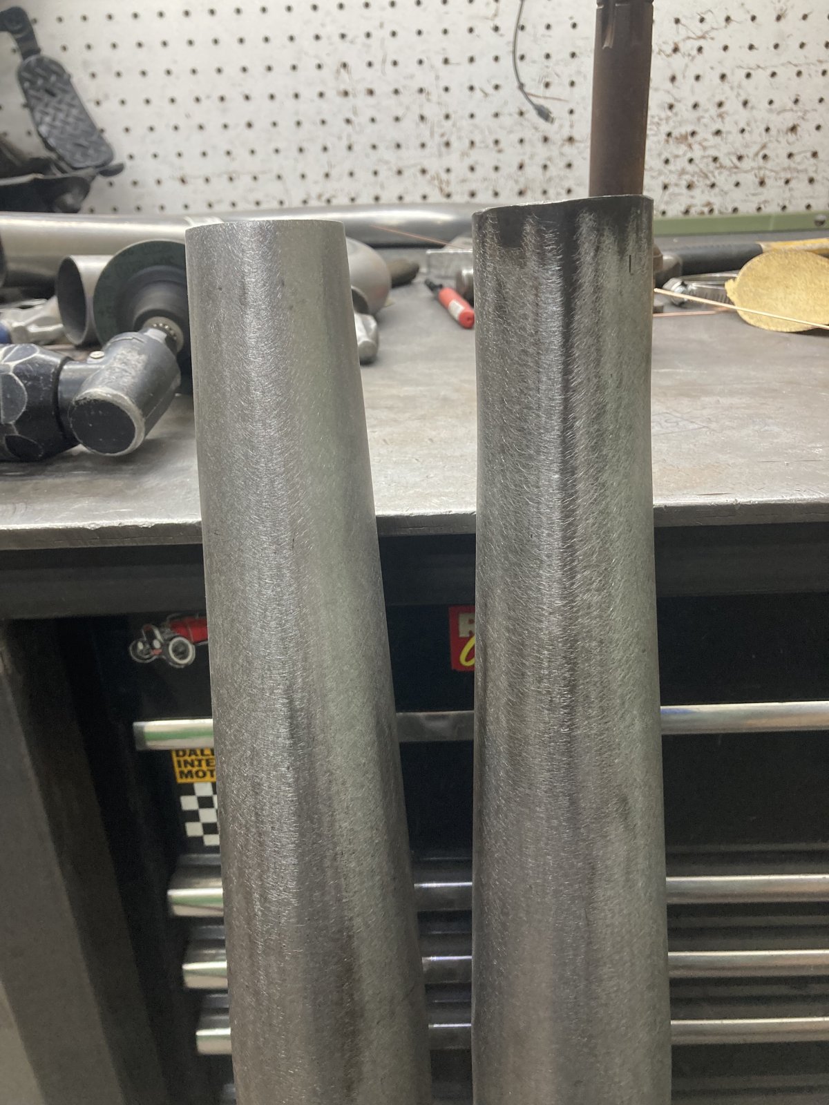

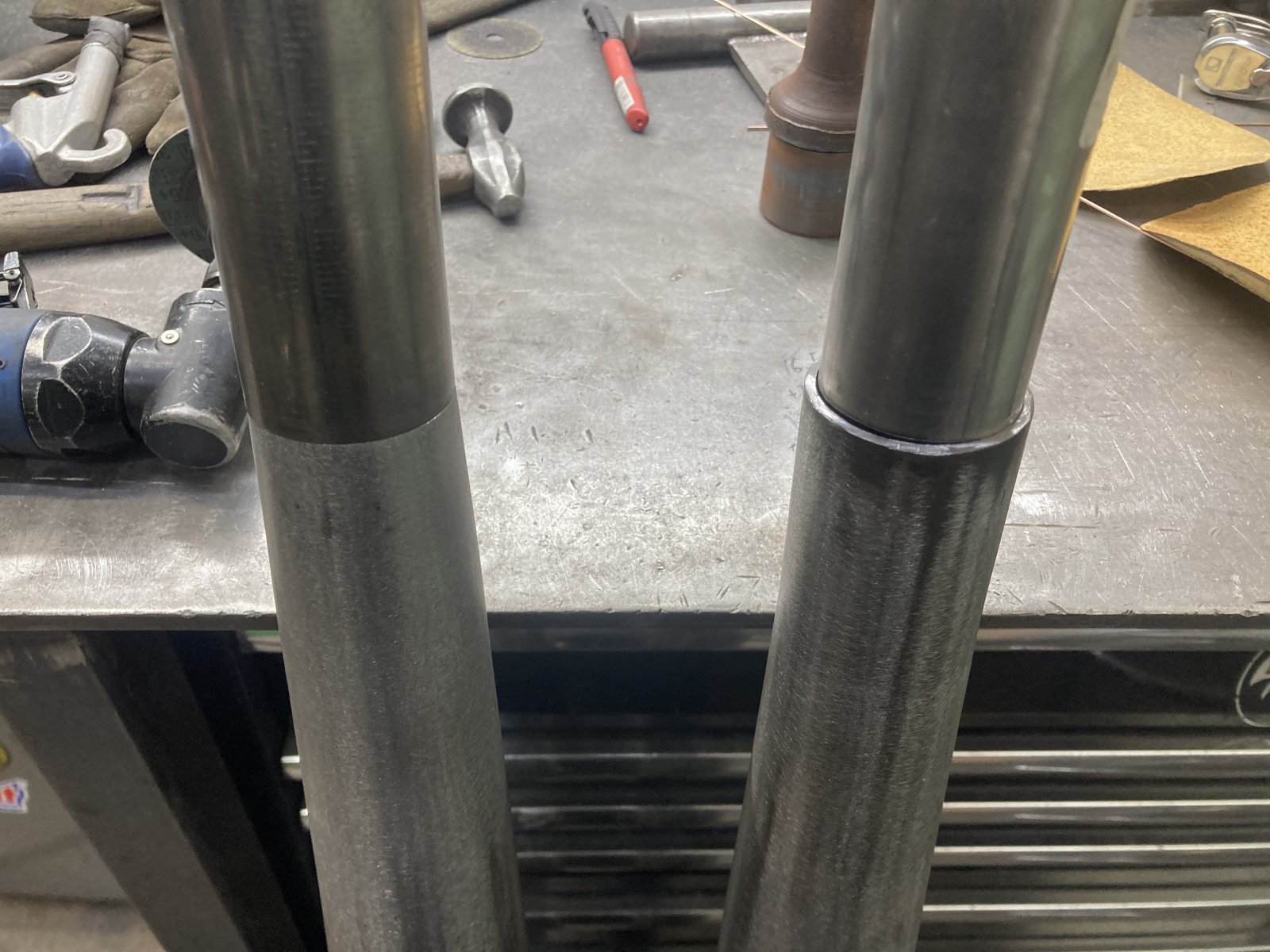

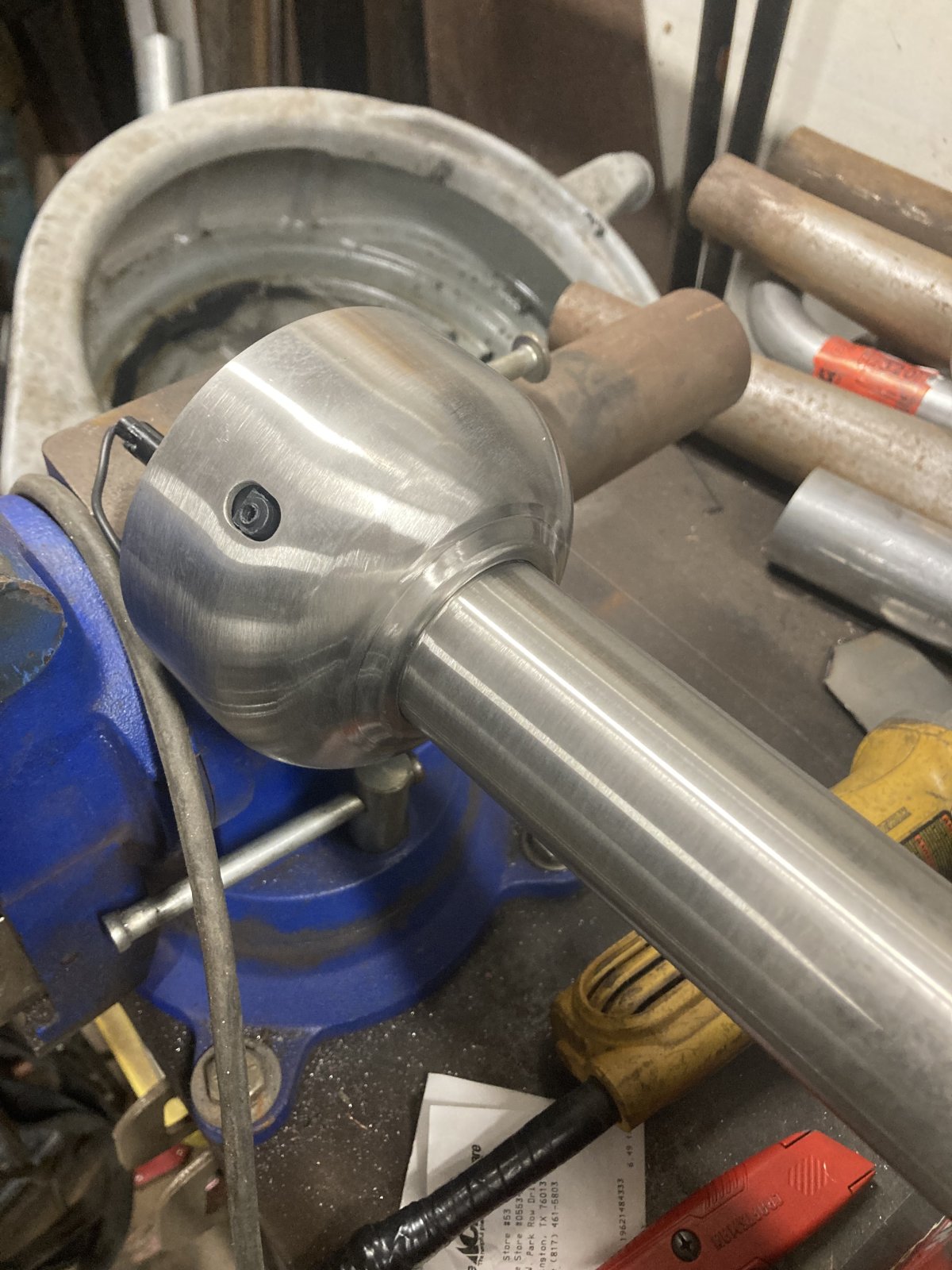

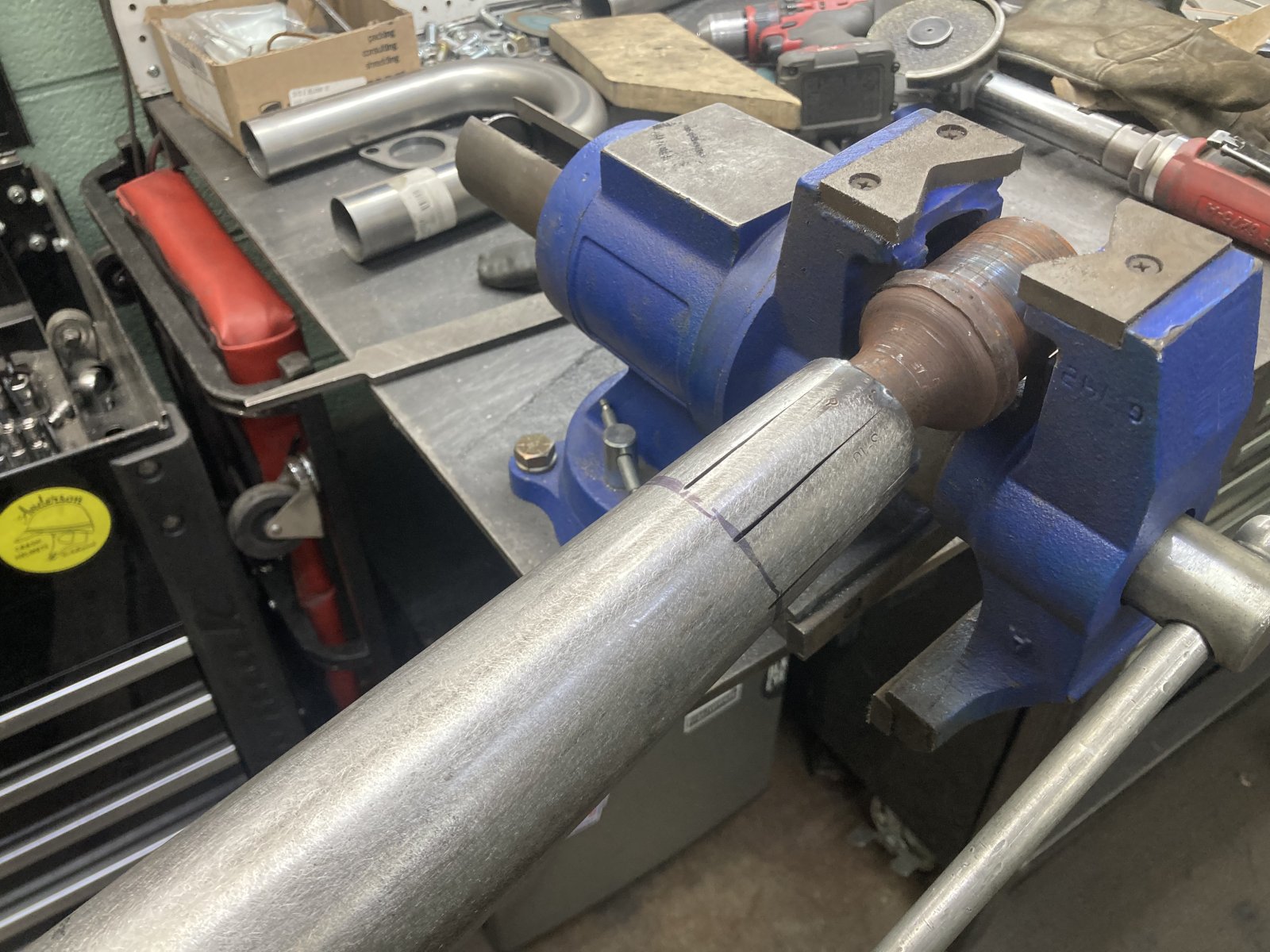

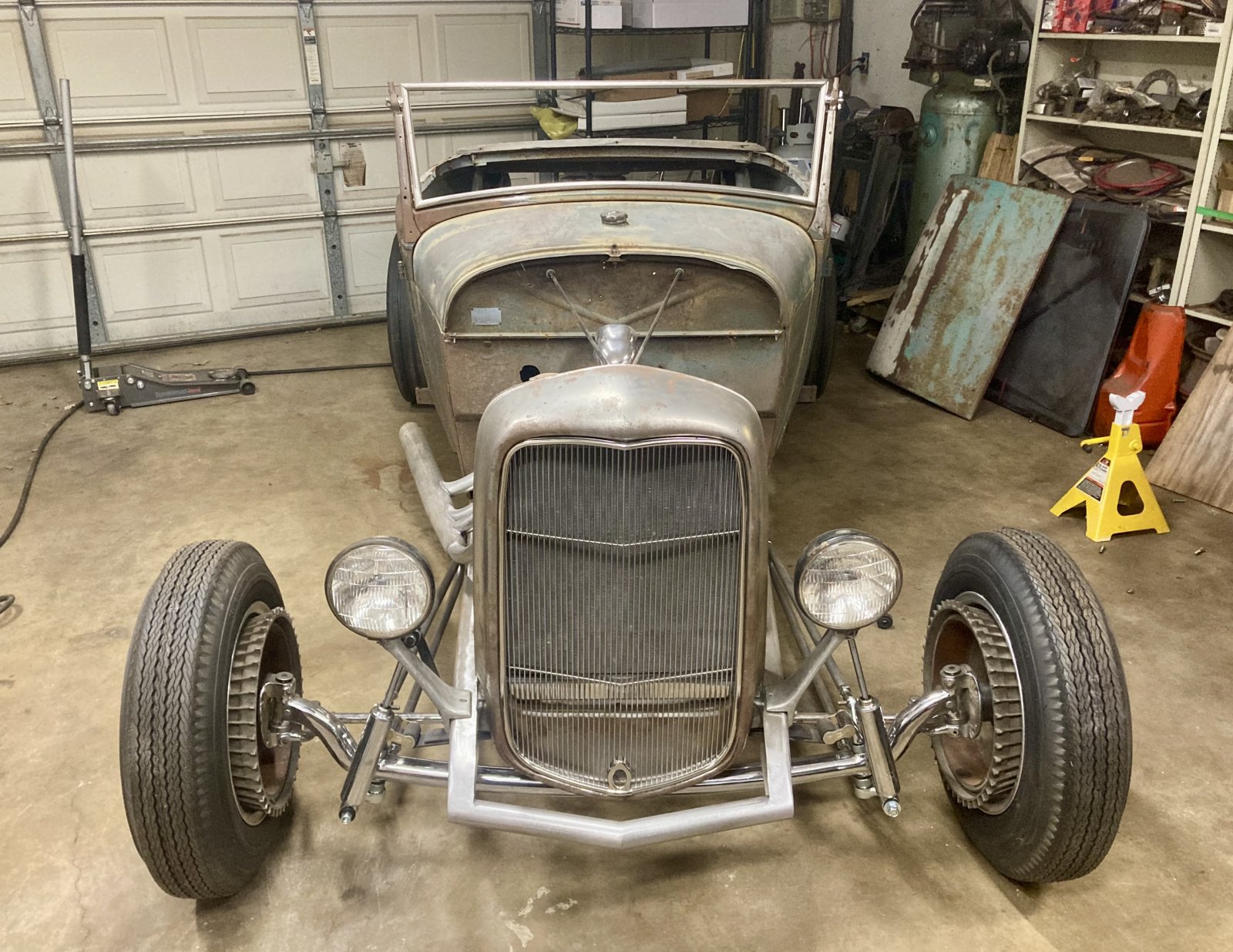

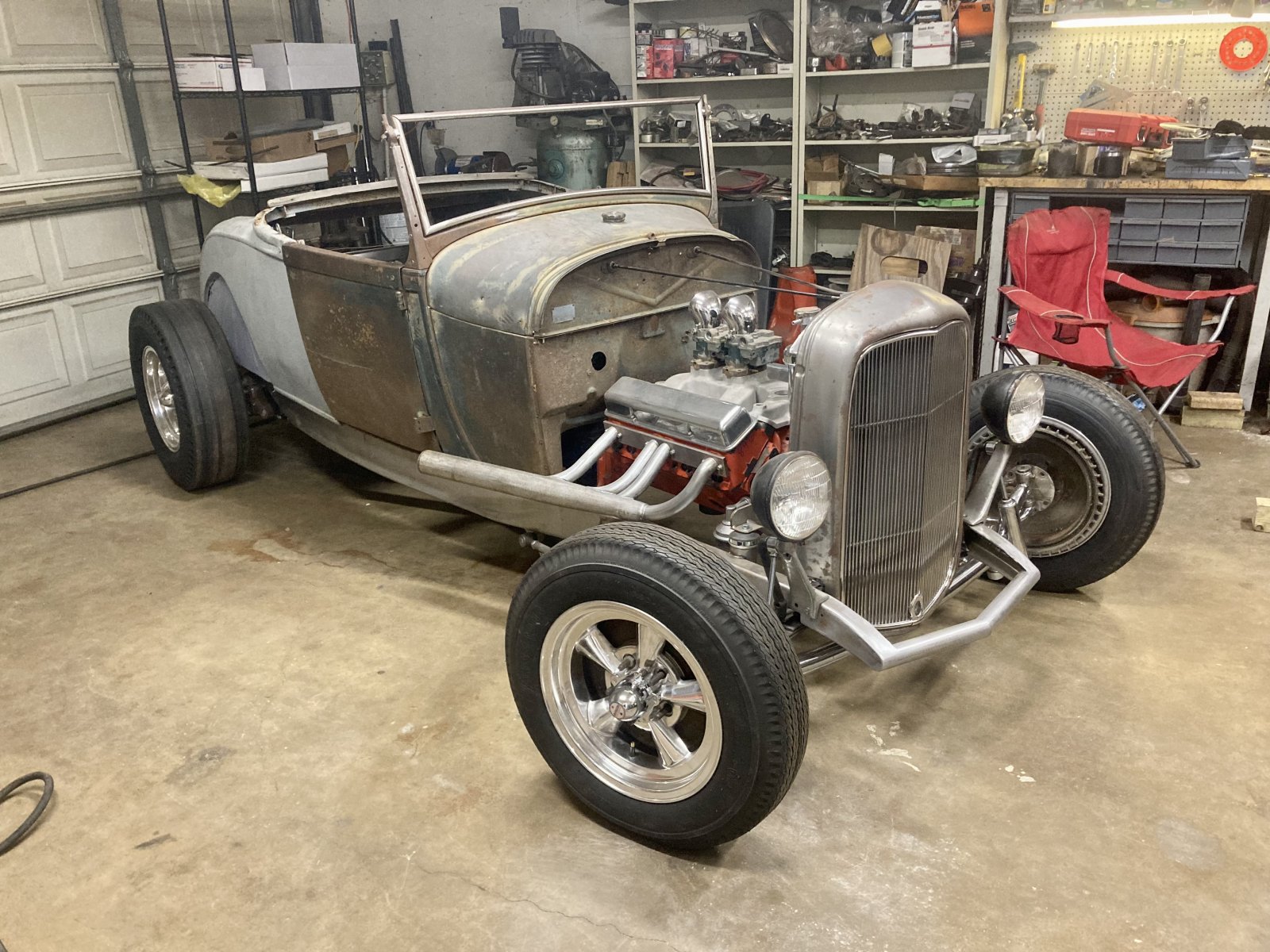

    Looks like is going to be a ‘40 (ish) box. Should work out pretty well. But with half the day off, I really got started on the headers this afternoon. I tapered the front pieces of the driveshaft halves the same as above. Then to get it down to fit the 1.5” primary,
    I hammered the end over an old hairpin yoke ball.
    My biggest concern was getting a hood side on with the cut-out for the header down low. I wanted the main tube down at framerail height and pretty level or even up in the back a little.
    Many times we spend a lot of time trying to replicate what other guys did, or doing stuff just like the other cars…but today kinda showed me that they were just doing whatever worked. If you look close enough at the headers on many of these cars, there’s a lot of weird stuff going on. So, I’m doing what works with what I’ve got.
    Side note…I might have to chop this thing just a bit more.
    2B7278D6-3F5C-45C9-BEA8-45317658FF13.jpeg 3414E800-4BC8-4DC2-828C-8EC507216C8E.jpeg 75CAA0C8-62B8-41A6-B6B6-C120BCD4C6AC.jpeg

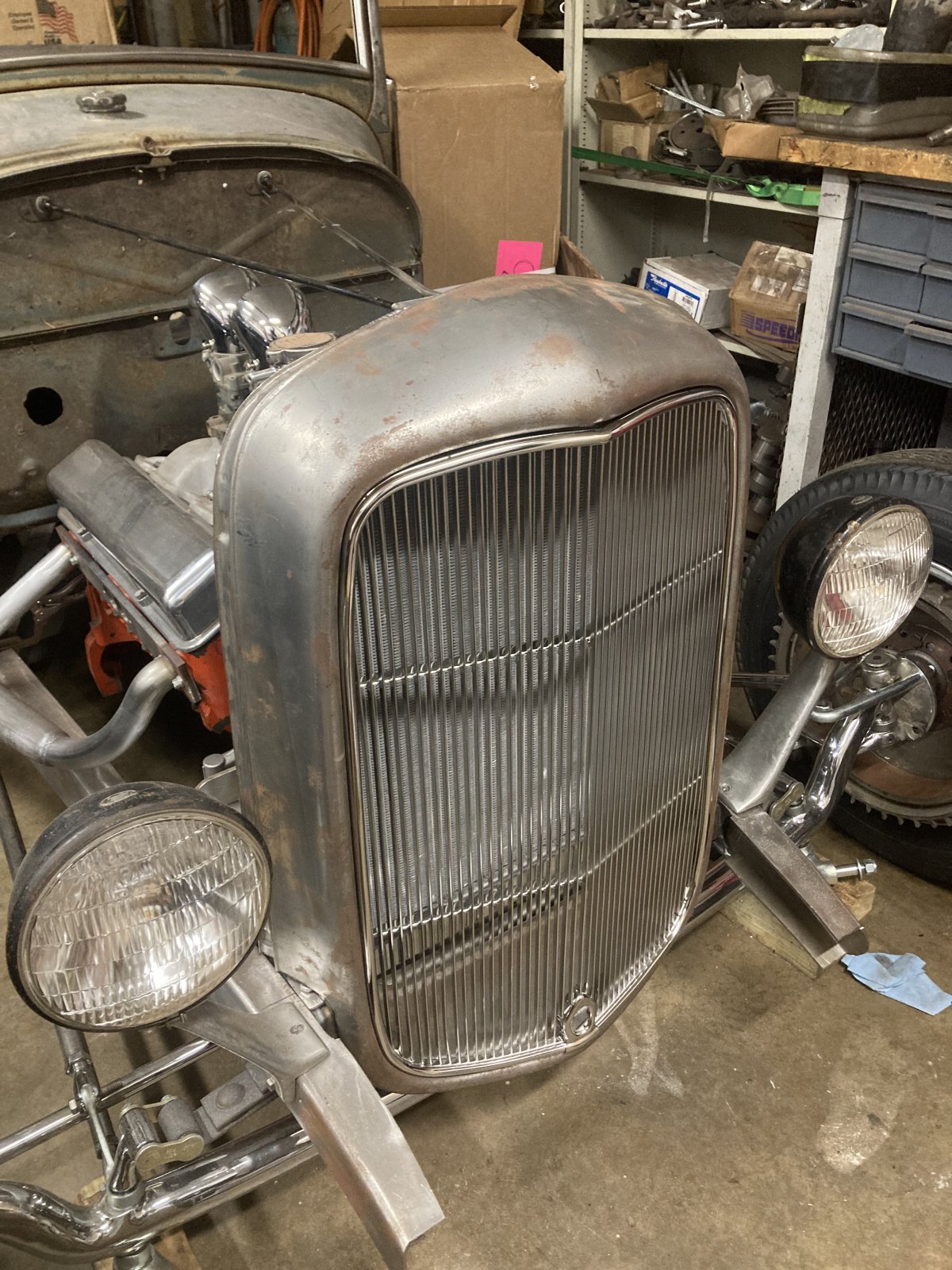

    I have headers to work on and a bunch of parts on the way. But until then I picked up this Brookville “second” shell. It’s so much better than what I had. I might not chop it this time, we’ll see. I ordered a United pacific insert for it. Also moved the headlights back some, but also think they need to be more outboard. The front axle is WIDE and I need to make it appear less so. Shocks will help there too eventually.

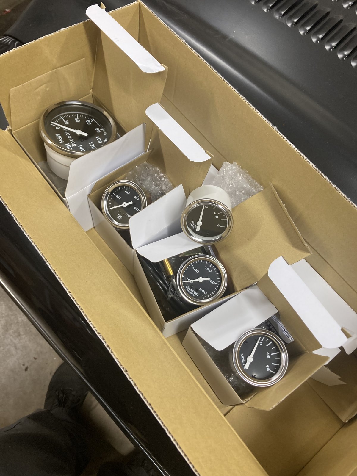

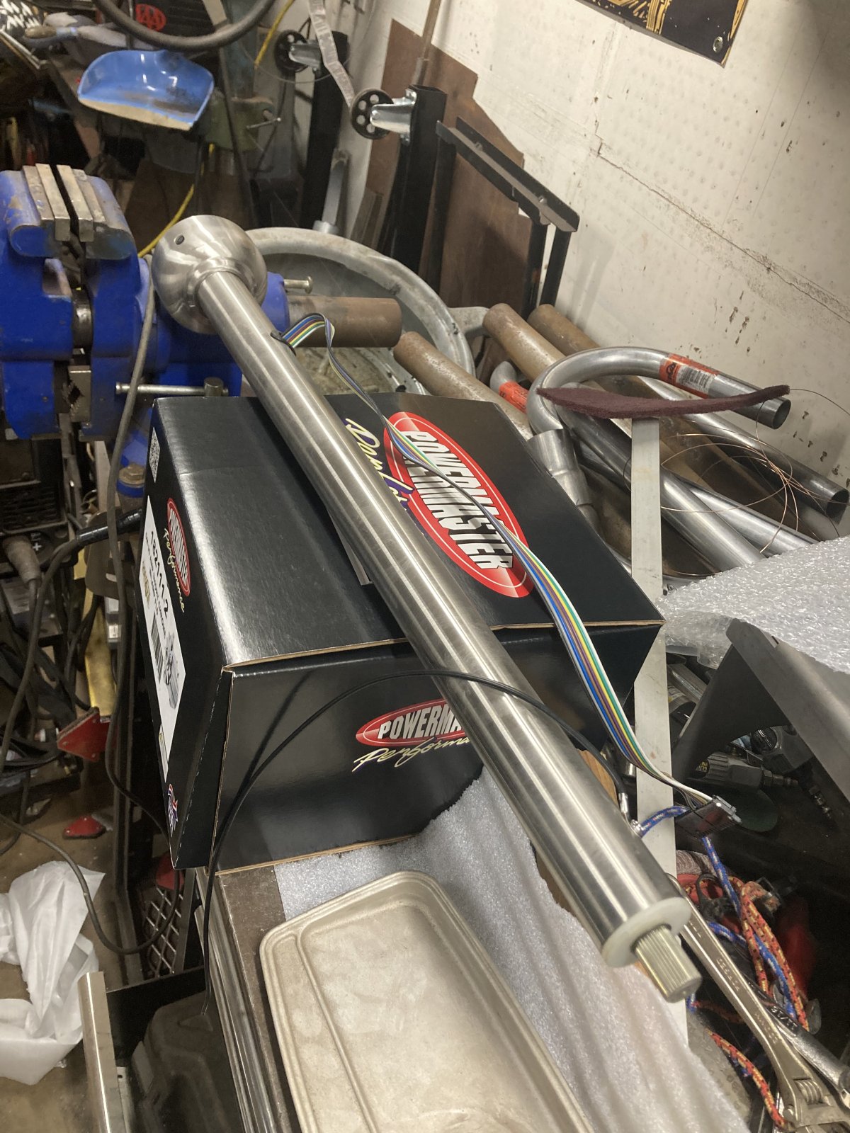

    I’ve got a lot of new parts to keep me busy…the United Pacific insert doesn’t fit the Brookville shell worth a flip, but that was expected and nothing I can’t handle. Still better than the cheap junk I was using. Got a chrome Powergen ready to mount. From Speedway, their “nostalgia” steering column. I wanted turn signals and a horn without a clamp on switch and ****on on the dash or something. The bell at the top has a nice look. Also got a set of their gauges. Knock offs of Stewart Warner, and all the small ones look ok. The speedo has a weird bezel on it that I might try to change. Also bugs me that the small ones have white between the bezel and gauge face while the speedometer is black. But the set of 5 was $200 so they’ll do.

    I’d be interested is seeing how you make the insert fit. I’d be dead in the water and looking for a different insert if that was me.

    Unfortunately I think this is about all you can get anymore.
    I can’t fathom how a really nice ‘32 shell and insert isn’t available these days. The Vintique stuff you used to be able to get wasn’t nearly as bad as what the eBay specials are now. It’s hard to tell what people are actually selling anymore. And a Vintique shell with a Dale’s insert was pretty damn good. But Dales is long gone I believe. If I were building a ‘32 I’d gladly pony up for a nice original setup, but this stuff is good enough.

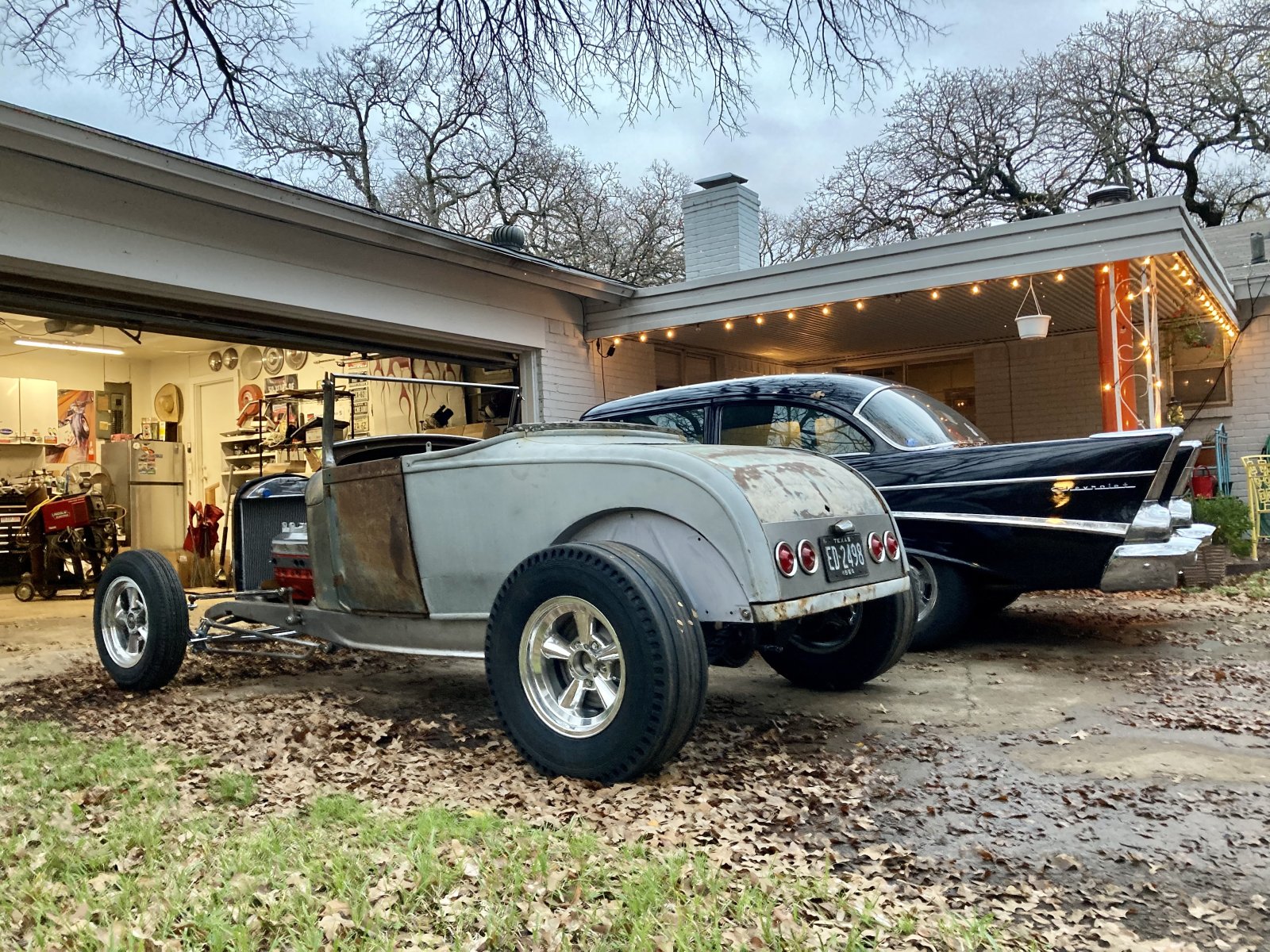

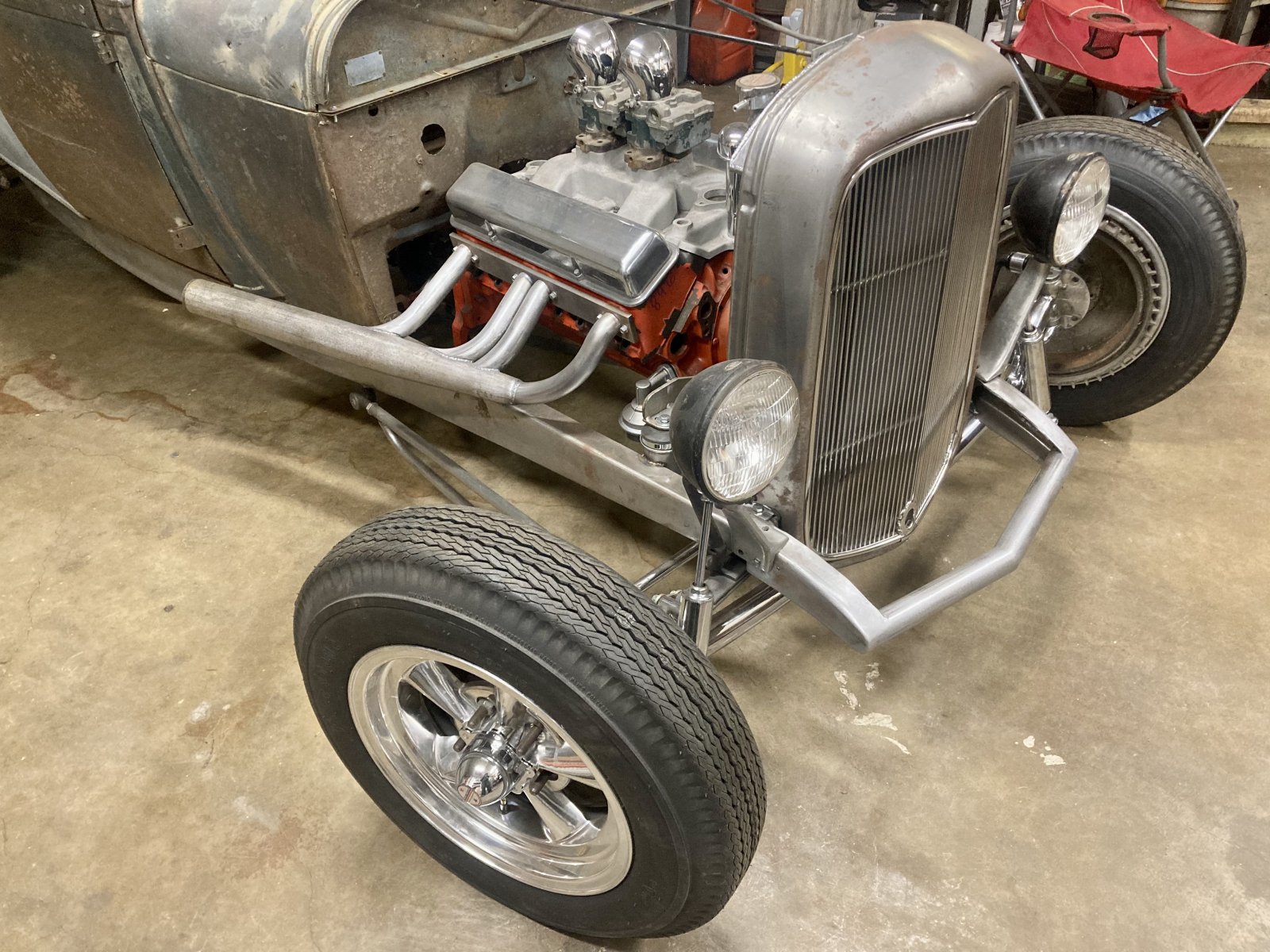

    P***enger header is more or less finished. Then I turned my attention to the front spreader bar, reshaped the frame horns more like a Model A then welded in the V-d bar I made a while back and smoothed it all out. Might do the drivers side header tomorrow.

    Re your 32 grille/insert problem, someone posted on here that the Brookville grille and insert was a 'reasonable' solution. As Vintique parts are more readily available here I've used 2 Vintique inserts in original shells with the only problem being trying to fit the insert without removing the nice new paint on the shell.

    It's nice to know that I am not the only one having a problem in getting a grill insert fit in a 32 shell, the brookvirl insert doesn't fit their shell very good either. I am going to try a Fors insert and see if it fits any better. If not I will make the shell fit it.
