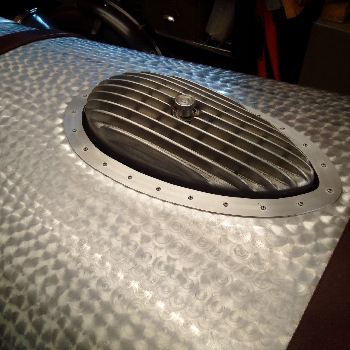

    I can really relate to this since I'm presently making a hood for my car too. After overthinking the whole thing, I decided to just fasten the hood top with lunchbox latches. Would love to have one of those kits that allow you to hinge the hood on either side or remove entirely but entrenched poverty won't allow it. Anyhow, here is what I found in Rodder's Digest #35. Scan-181218-0001.jpg
    jaw22w likes this.

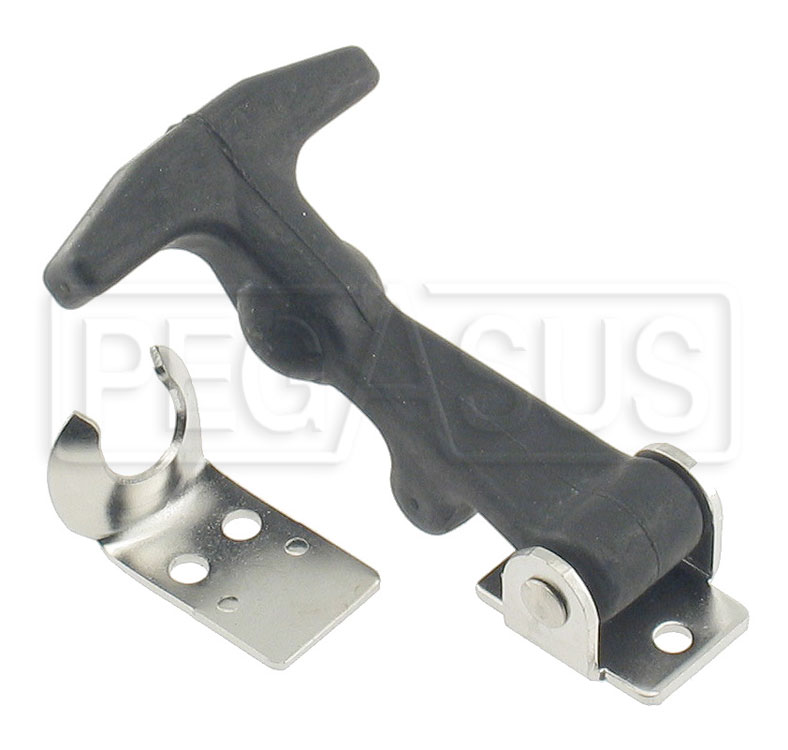

    I got a couple of these for the front of my hood (Triumph TR sumpthin latches in back) but haven't got around to it, hood stays down at all speeds for some reason. They are motorcycle fairing mountings, smaller than a dime. Another option my old hood had, was the edges of the sides, where they rolled back in, 'snapped' over an edge at the radiator support, such that you had to reach from the front and pull the hood apart before it would open. Might just go back to that.
