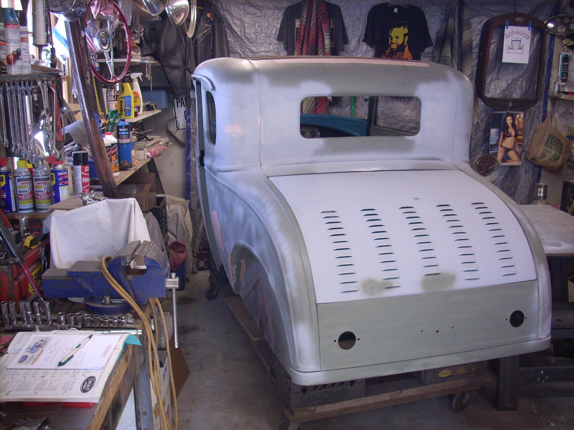

    Just had my Model A hood done- thought about three rows, but space is tight and you get into the side curve.I gave the louver man an idea of what I wanted and let him do his thing.Got part of the decklid done too.....I like it! Good luck--- Mike from M***.

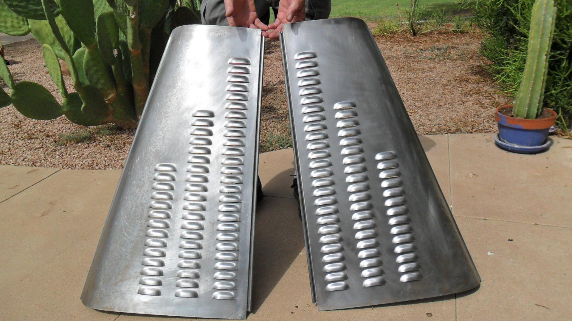

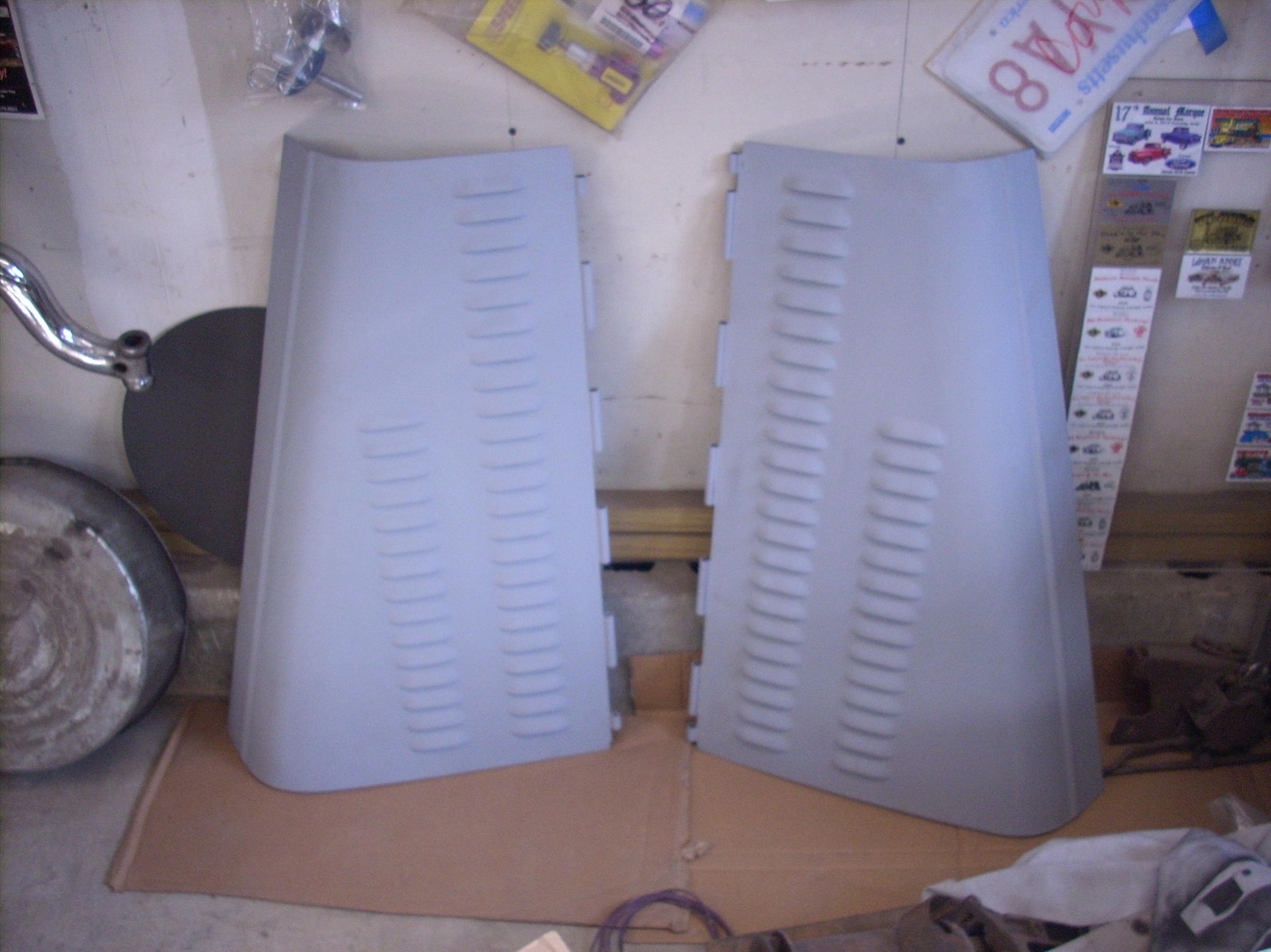

    Okay, a couple of things to talk about with my stuff on this. First is that I pattern in what is called "diminishing horizon", in other words, I don't lay out rows parallel to a centerline on tapered hoods. When I lay stuff out, I "ray" or "splay" the rows just slightly so they compliment the lines of the hood itself. This avoids the optical illusion of putting lines 90 degrees to the center line that make the rows look further apart at the front than the rear. The taper of the hood does that. I also incorporate the lines of the rear edge of the hood into the pattern and orientate the vents of the louvers to that strong line. It looks more complete, like it "belongs there" instead of something added later, and it allows the louver's vents to line up when viewed from the side.
    The second is that it's very hard to give some one a set number that will work well on any given hood. What might work with say 100 louvers on my press, won't even look right on somebody else's press. That all comes down to side spacing clearances, vent to vent spacing, and louver shape and size itself. I hate to sound like the tortured artist, but each hood I do I sit down and lay out my "X" lines, then my "Y" lines, and stop when there is just the right amount on the hood... No more, no less. The only real "rules" to my patterns is that I generally start about 2-3" forward of the hood's rear edge, and end about 5-8" back from the hood's front edge. That helps accentuate forward motion...
    P.S., I dropped a couple of deuce hoods in here because they illustrated my point about diminishing horizon layout. Same deal, I'd just punch them in 2 1/2" louvers instead of 3 1/2" on a '28-'29...
