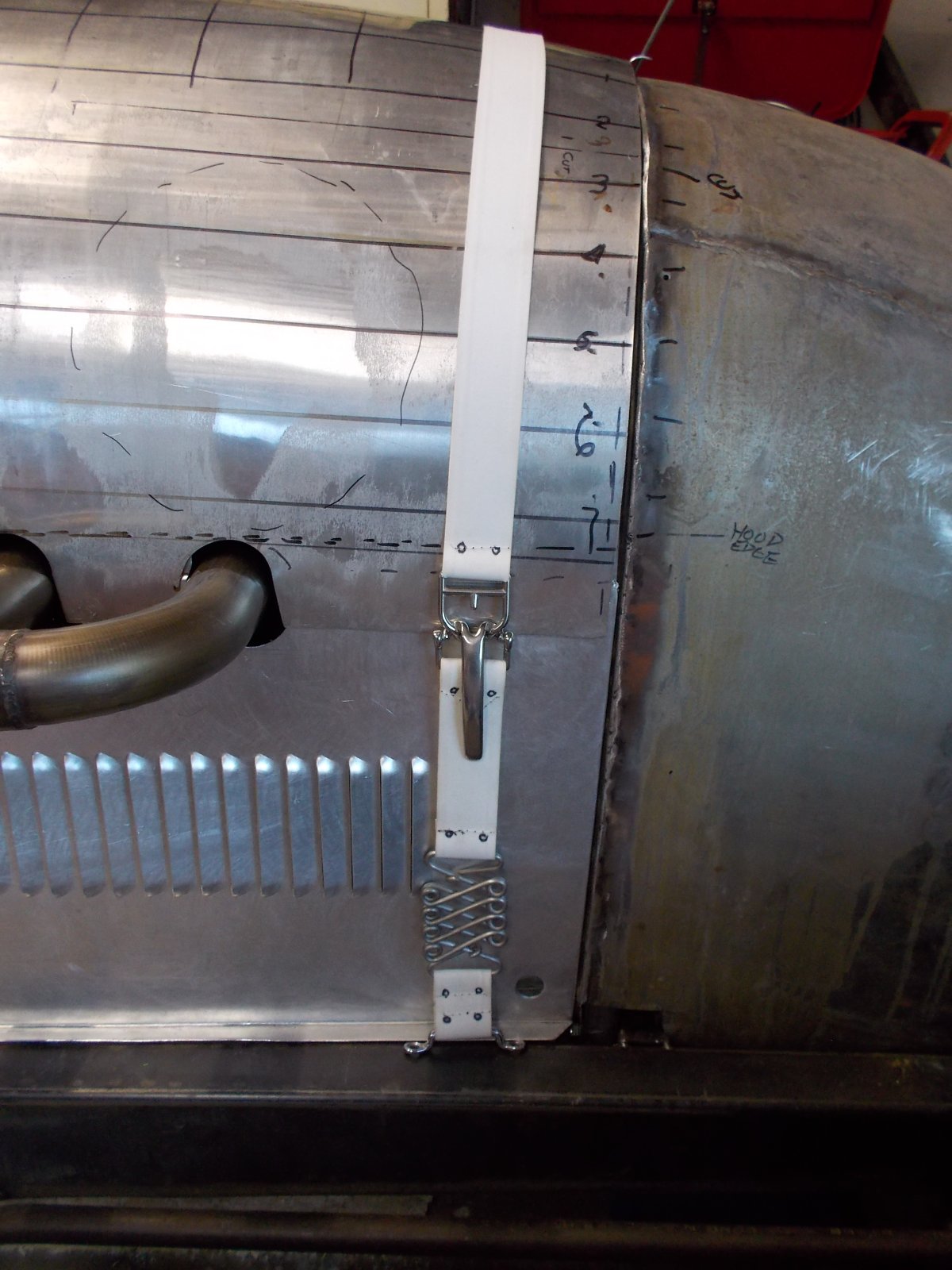

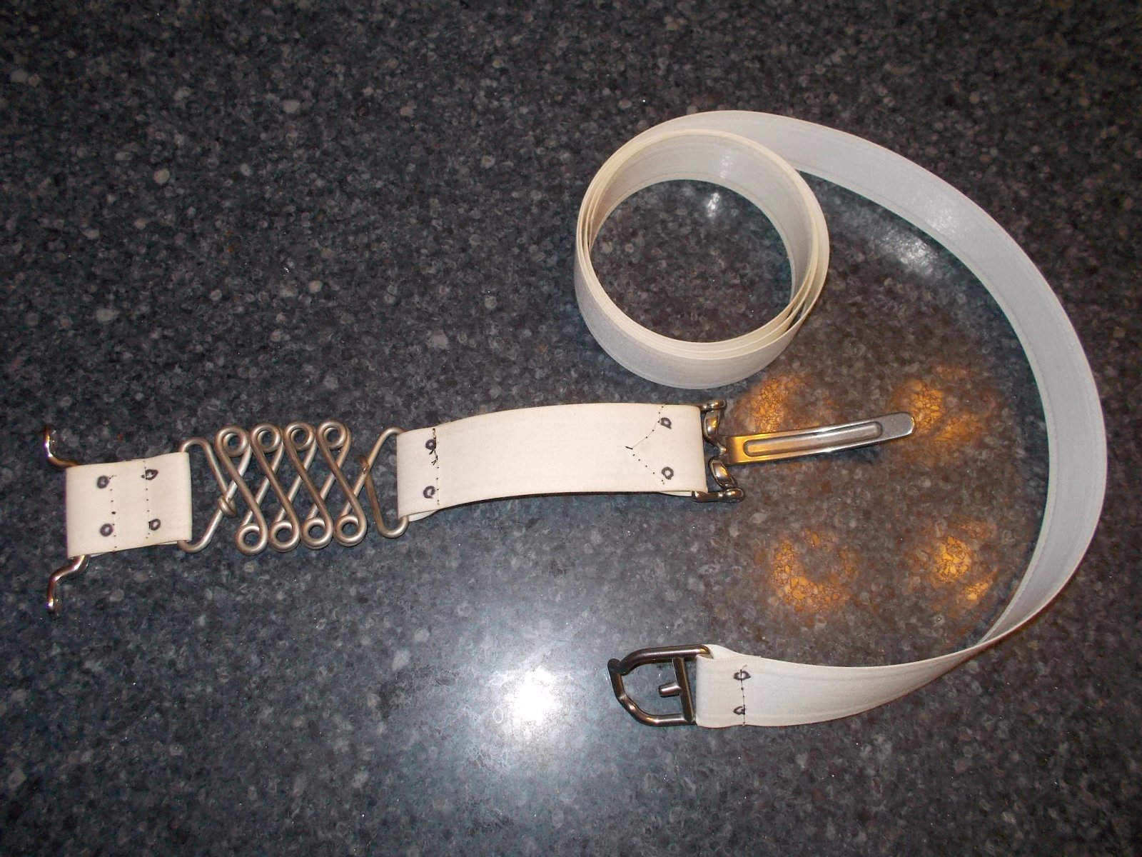

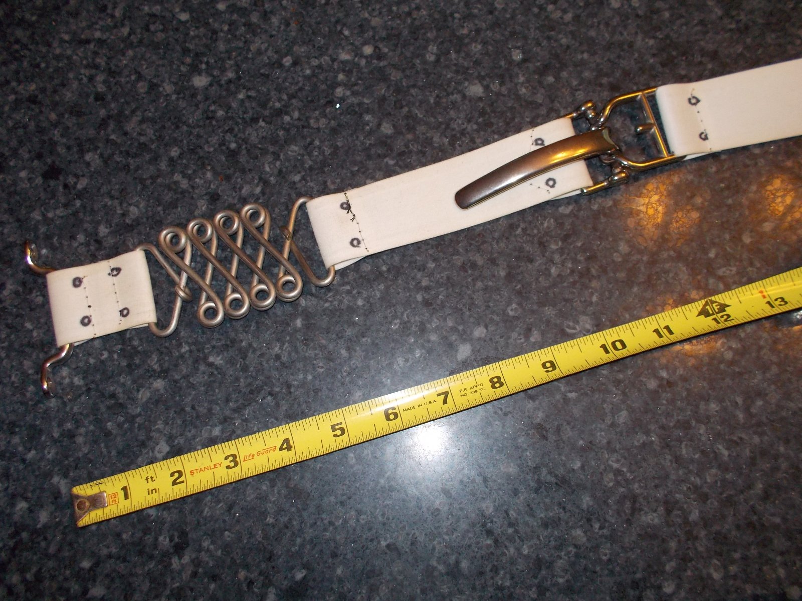

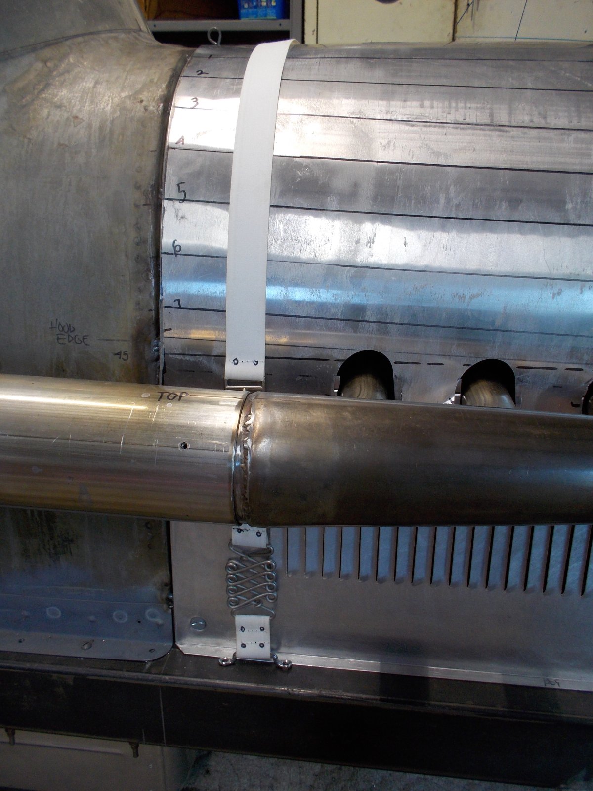

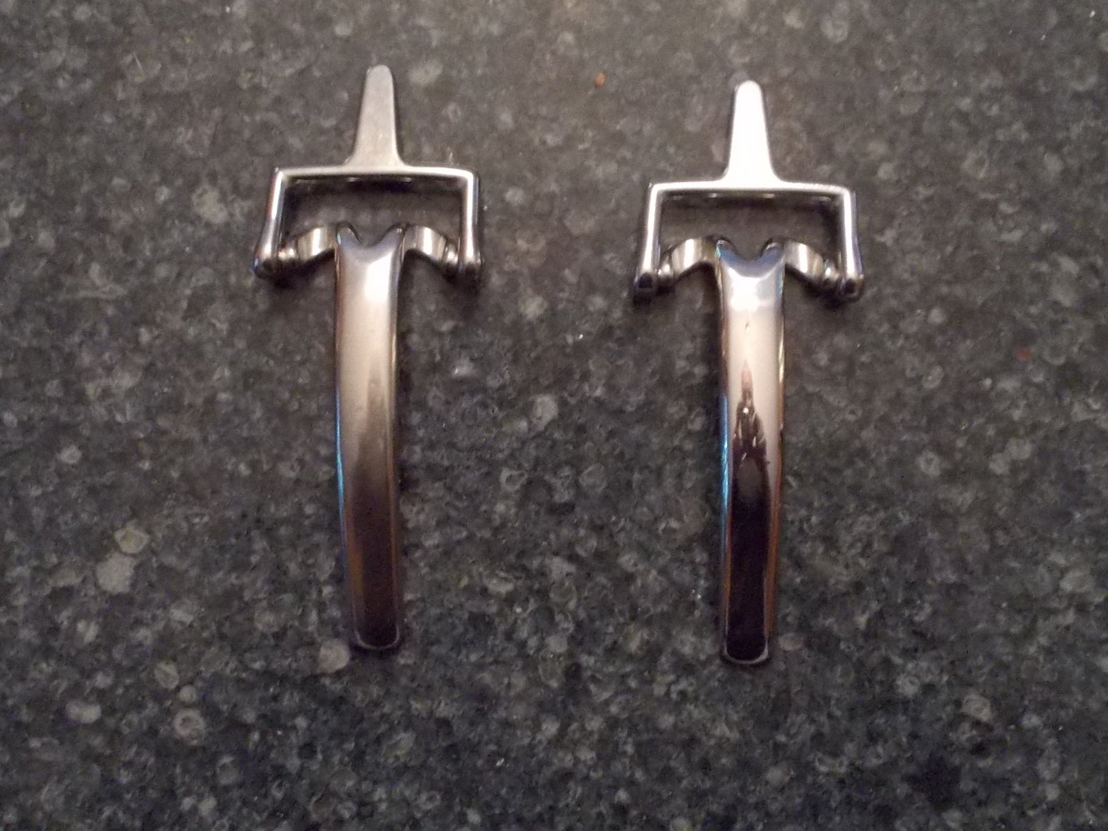

    I'm putting a set on my HAMB era champ car that I bought from Lime Works. I have a couple of suggestions:
    The anchors came polished. The latches were not. I plan to polish all my latches to match the finish of the anchors.
    It was a bit daunting to cut the leather to the precise length so I used inexpensive waist band reinforcing material in my sewing things that was the same width as the leather straps for a mock up (white) - found at any sewing shop.
