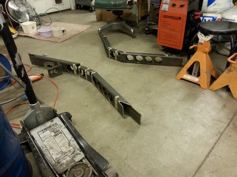

    gonna share my pics of what im workin on. been collecting parts for this for 5yrs. time to start buliding this aside from other projects. hopfully get input from others good and bad.
    1931 model A tudor sedan
    302 with AOD transmission
    ford 8''
    dropped model A axle with 40 ford brakes
    boxing model A frame rails with custom crossmembers
    body-chop, channel , flush mount doors?

    the xmember holed and sleeeved

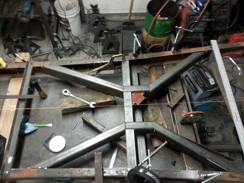

    time for a rear crossmeber. using 40 ford front spring for rear and building ladder bar setup
