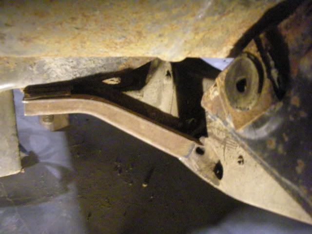

    Got after the rear mounts this evening.You can see the frame mount does not line up with the body mount.That circle up in the right corner of the cab is the factory mount.The body was hung on shackles.
    Time to move the stock frame mount.

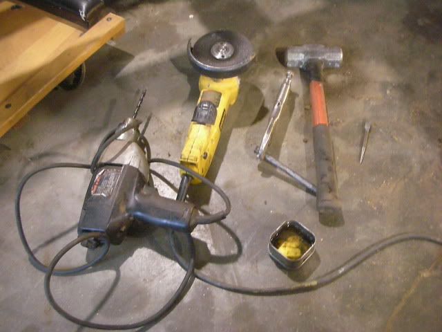

    Tools for removing rivots.Cut the head off.Drill a ways in, use a lot of oil.
    Knock out with a big hammer and punch.

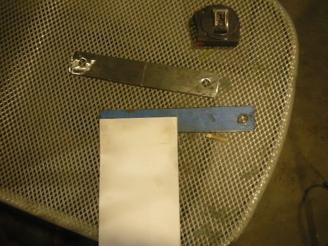

    Cut straps.Drill holes.
    Technical measurment to find half.
    Half.
    Weld the strap to the original frame mount and the mount to the frame.
    Mounted on the new ch***is.
    That wasn't to bad for a 55 cab to 69 frame swap.

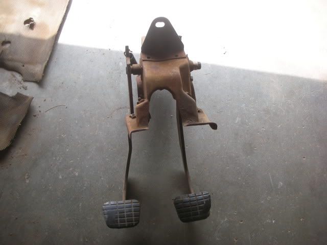

    Got after the brake pedal and master cylinder mounts.This is a 69 unit.
    Cut it down so it would fit between the fire wall and dash.
    Stole a piece of the stock column drop.It matches the bolt pattern for the dash.
    Welded it to the mount where the face was cut off.
    Template for new holes in the fire wall.
    Good pedal position.
