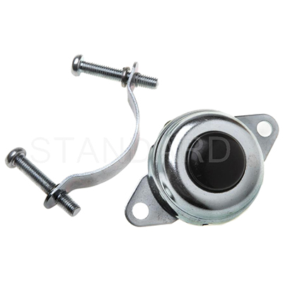

    Actually on the Pusher (and several other vehicles over the years) I used a hot button. A starter button wired into the horn like a switch.no relay at all. it is back yard but you shouldn't be using the horn very often and a 35 amp (@12V) momentary button is cheap.

    I used a 1940 Ford starter button, In its STOCK location.:D
