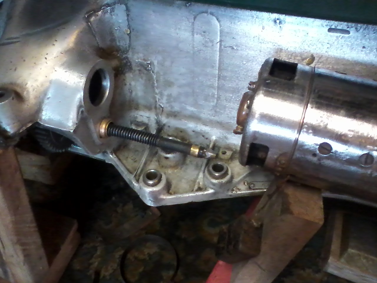

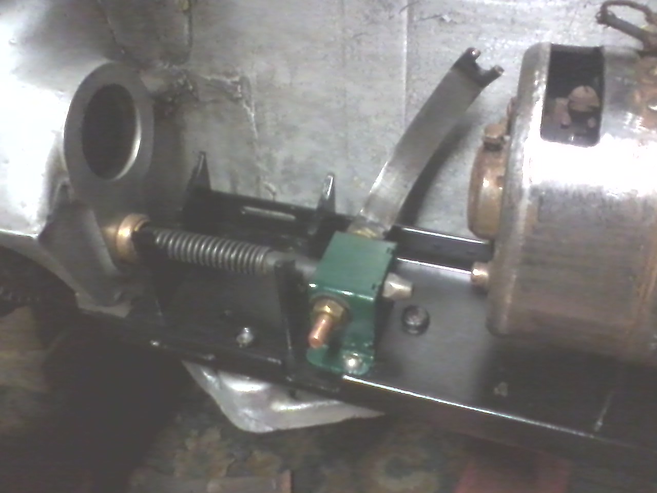

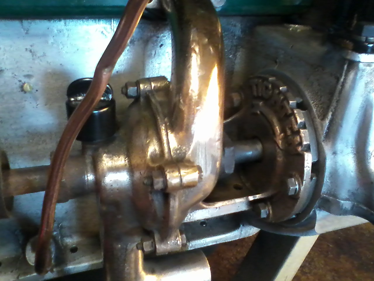

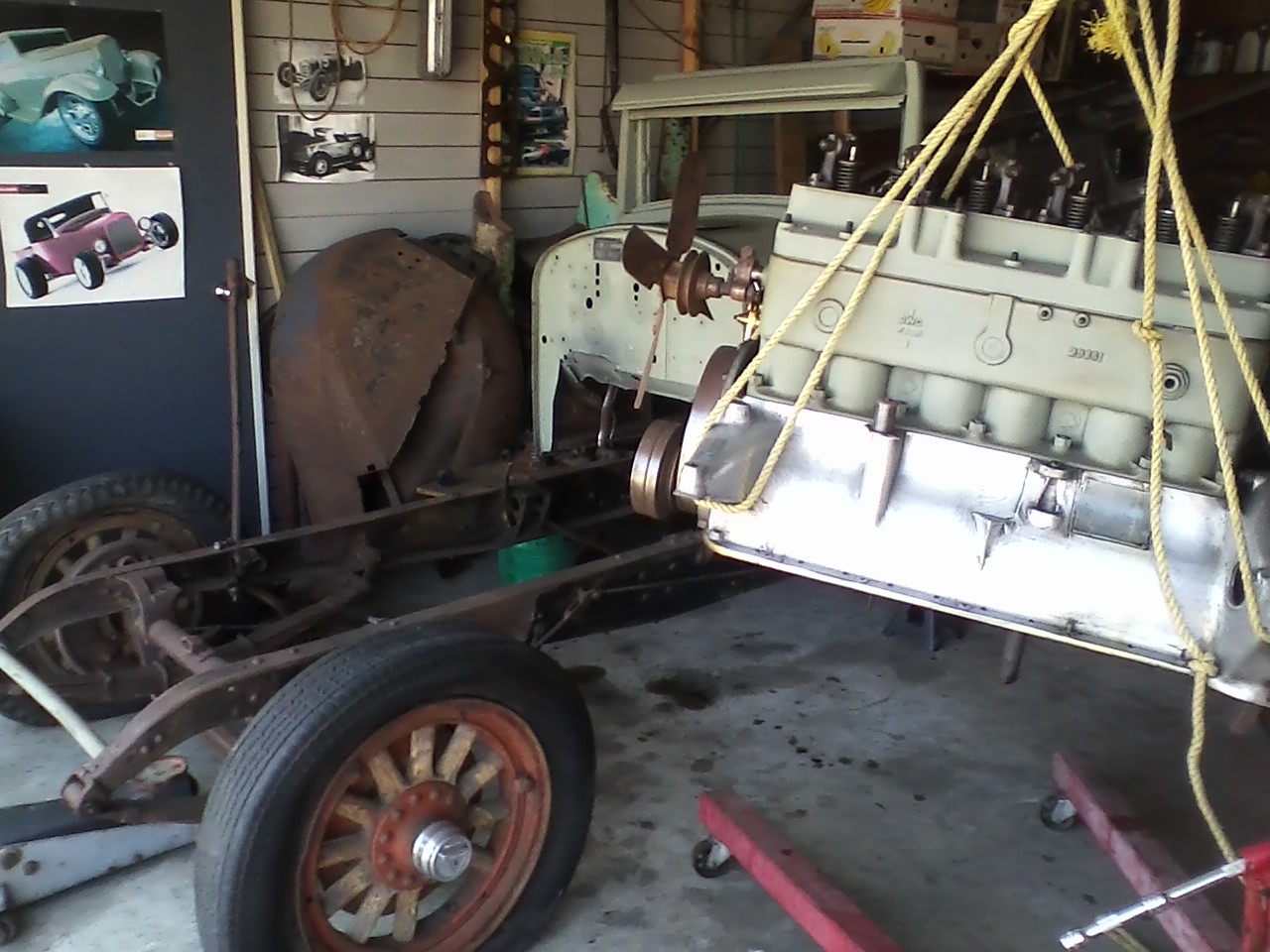

  6. Spring time here, and its raining. No surprises there. Haha. Heres a couple of pics. The engine has penitrating fluid in the bores, but i think maybe the water pump drive may be the problem. Other pic is the rear springs in place.

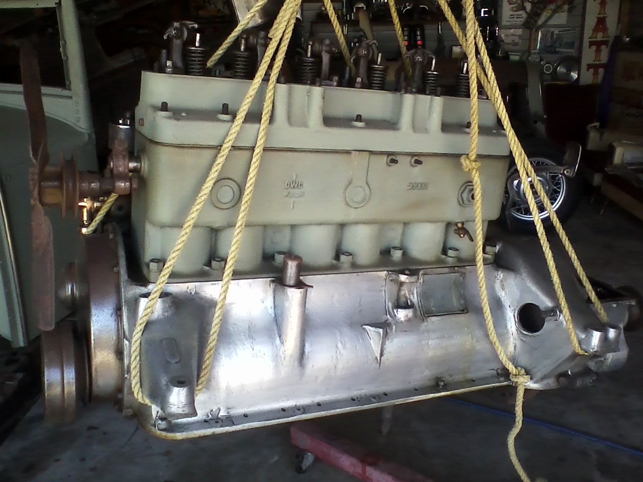

  7. Ive not been able to find any good wheels for the 28, so i havnt touched it for some time. Today i stripped it down, so i can striaghten the ch***is, get it blasted, then paint it. The engine was pretty easy to get out, considering its size. My 34 Chev project now resides where the 28 has spent the last 12 months :)

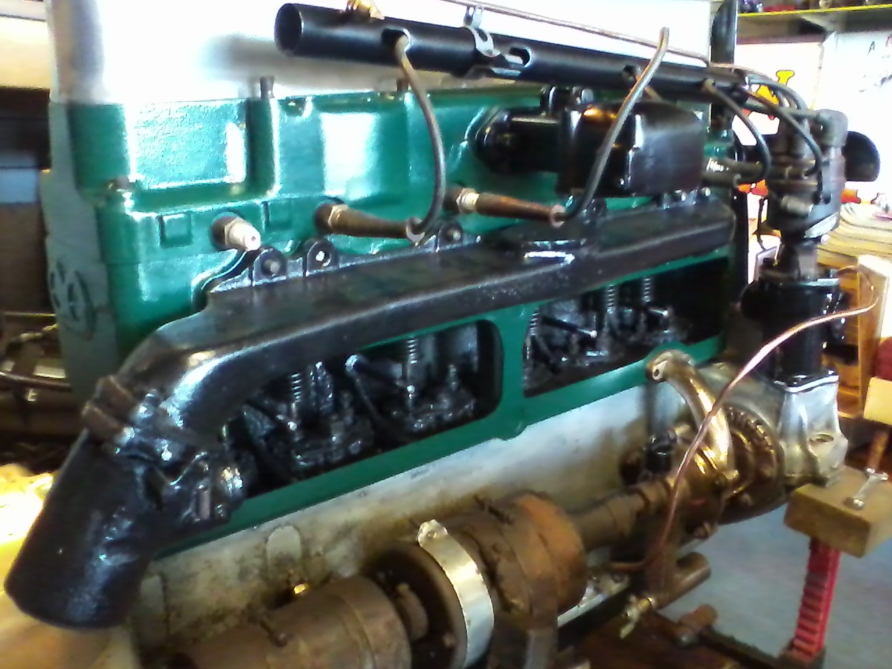

  15. Thanks Captainjunk#2. Im ichin to get it finished, and start on the ch***is. If/when i ever get this thing done, im with you on running it without a hood. I dont have one for it anyway, so id be savin a few dollars :) All i got done today, was paint inlet manifold, and install it up, (or down really) the correct way.

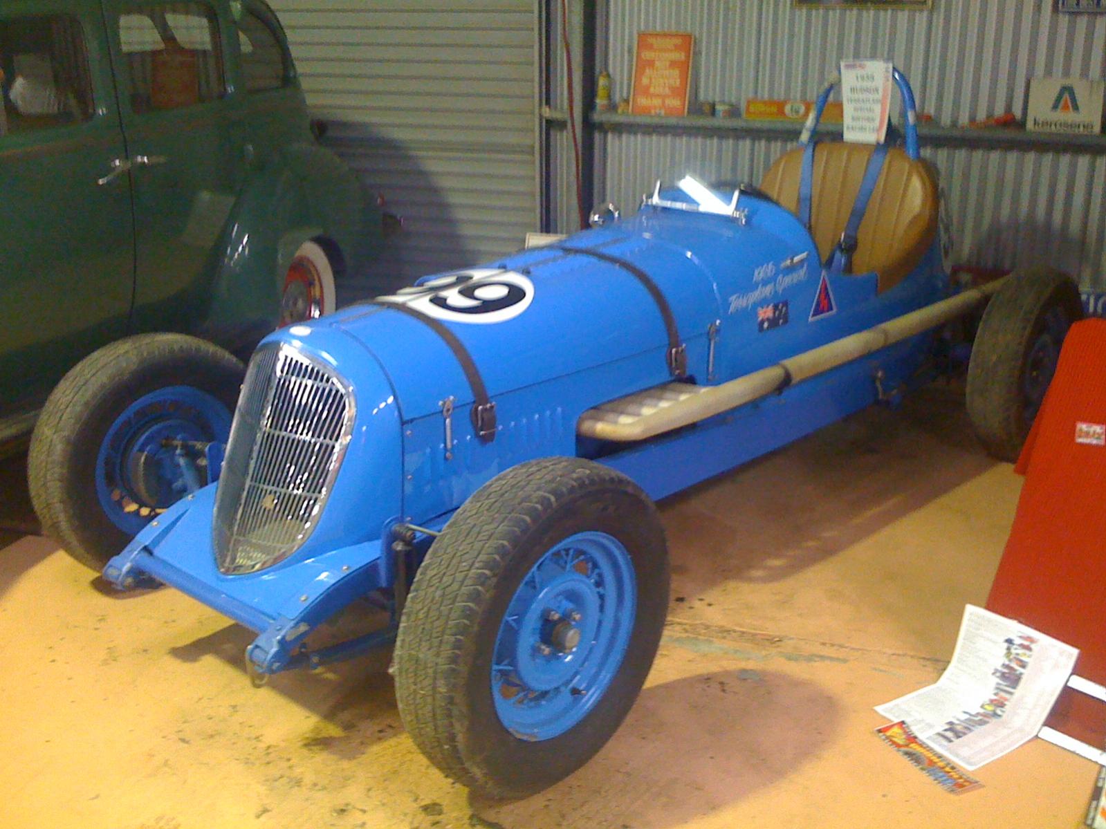

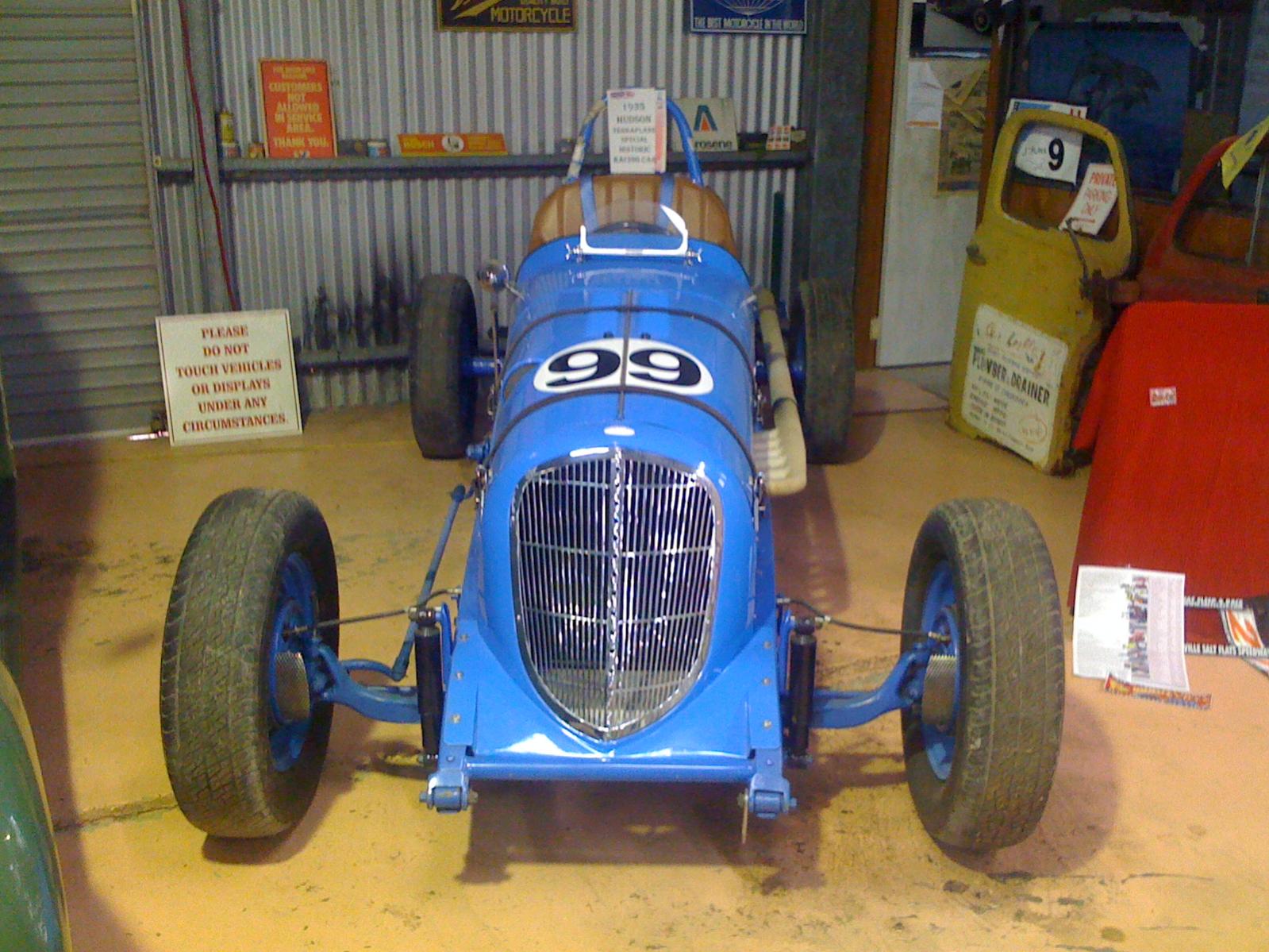

    This is a 1935 Hudson 'special' on display at the Buderim Ginger Factory on the Sunshine Coast in Queensland. If you're over for a visit maybe you could check it out for ideas!
    I couldn't get any closer for pics, it's behind a picket display fence, but if you told them you were 'restoring' one maybe they'd let you have a closer look.
    Cheers, Glen.

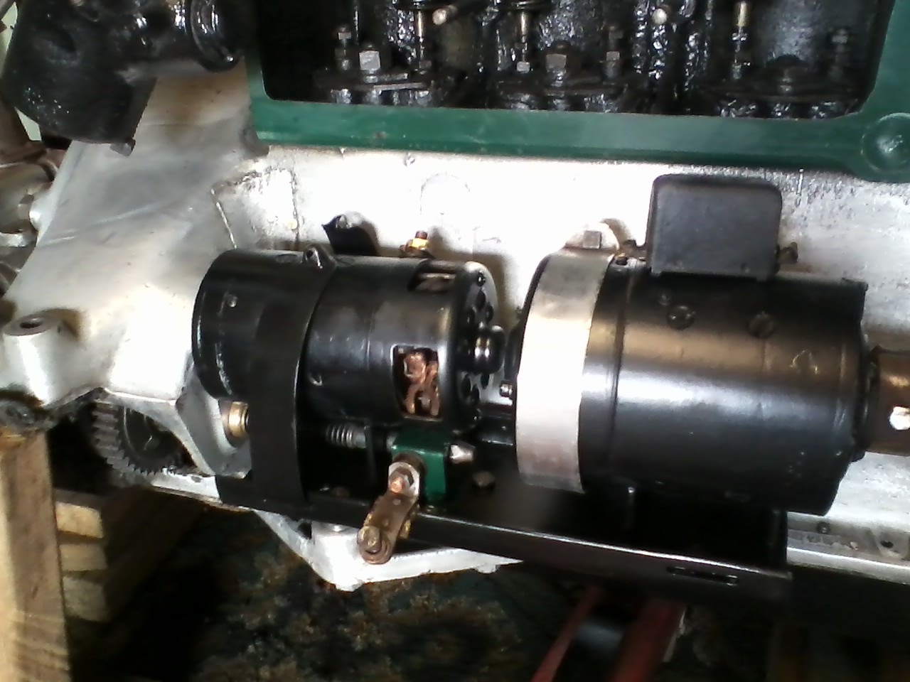

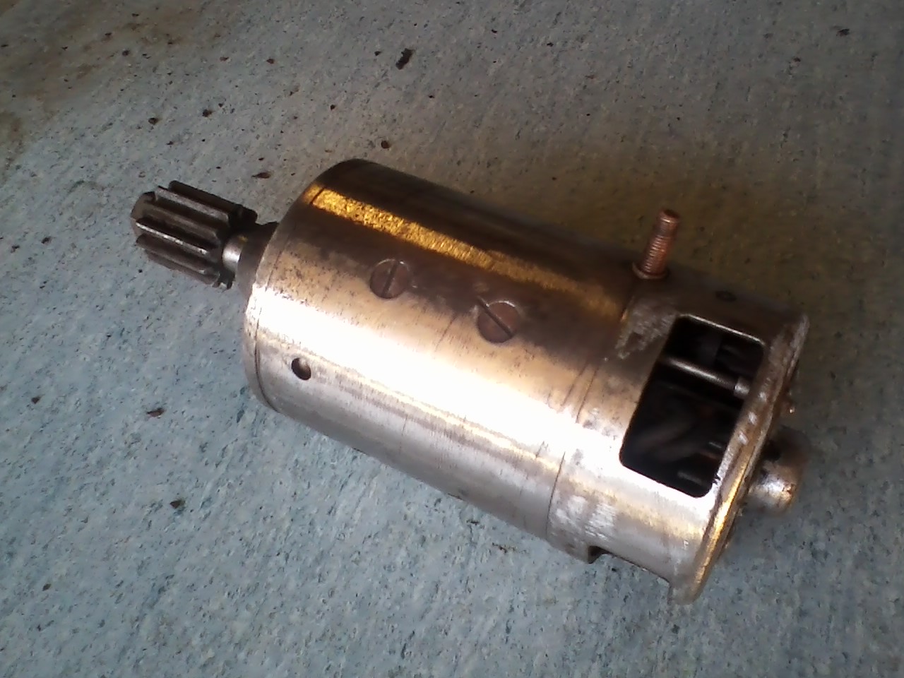

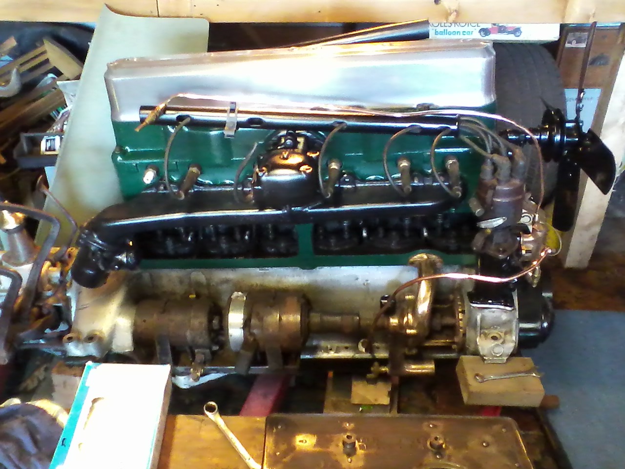

  27. Thanks doctorZ. I spent the weekend getting the starter and generator cleaned up, and painted.
  28. Almost all back together :)

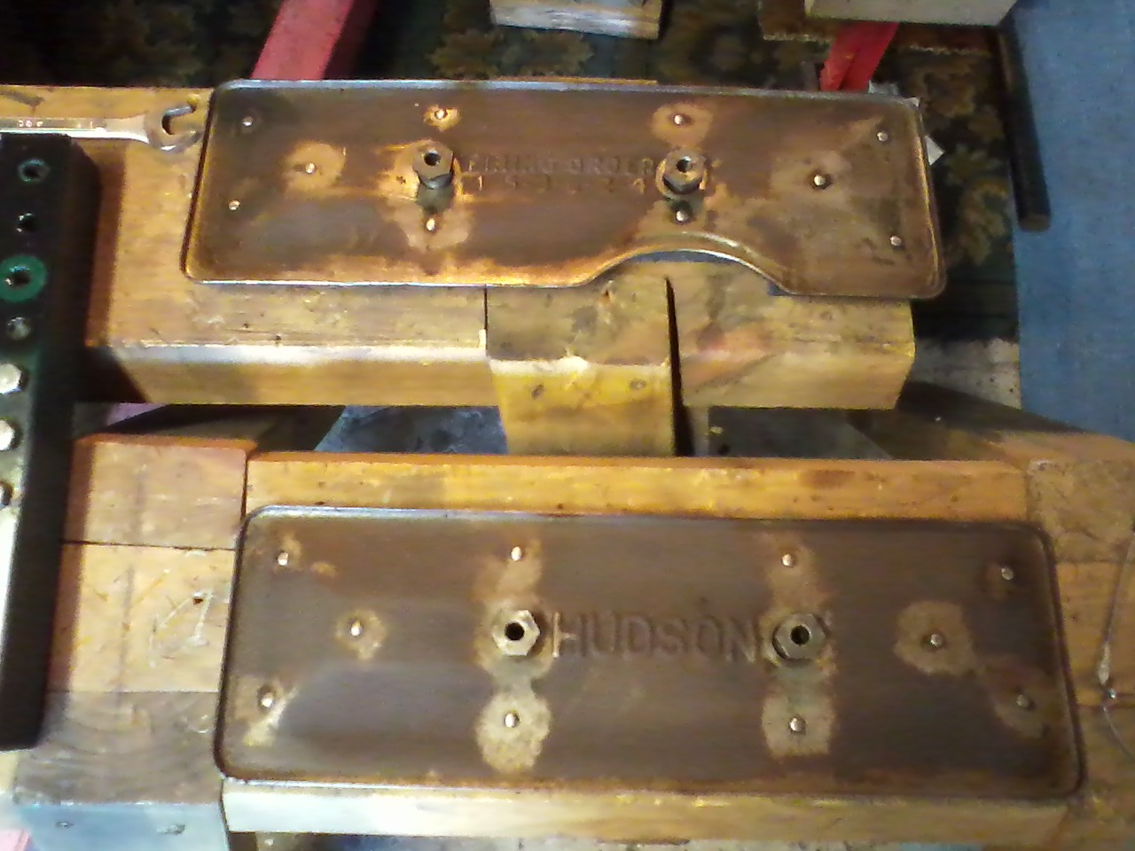

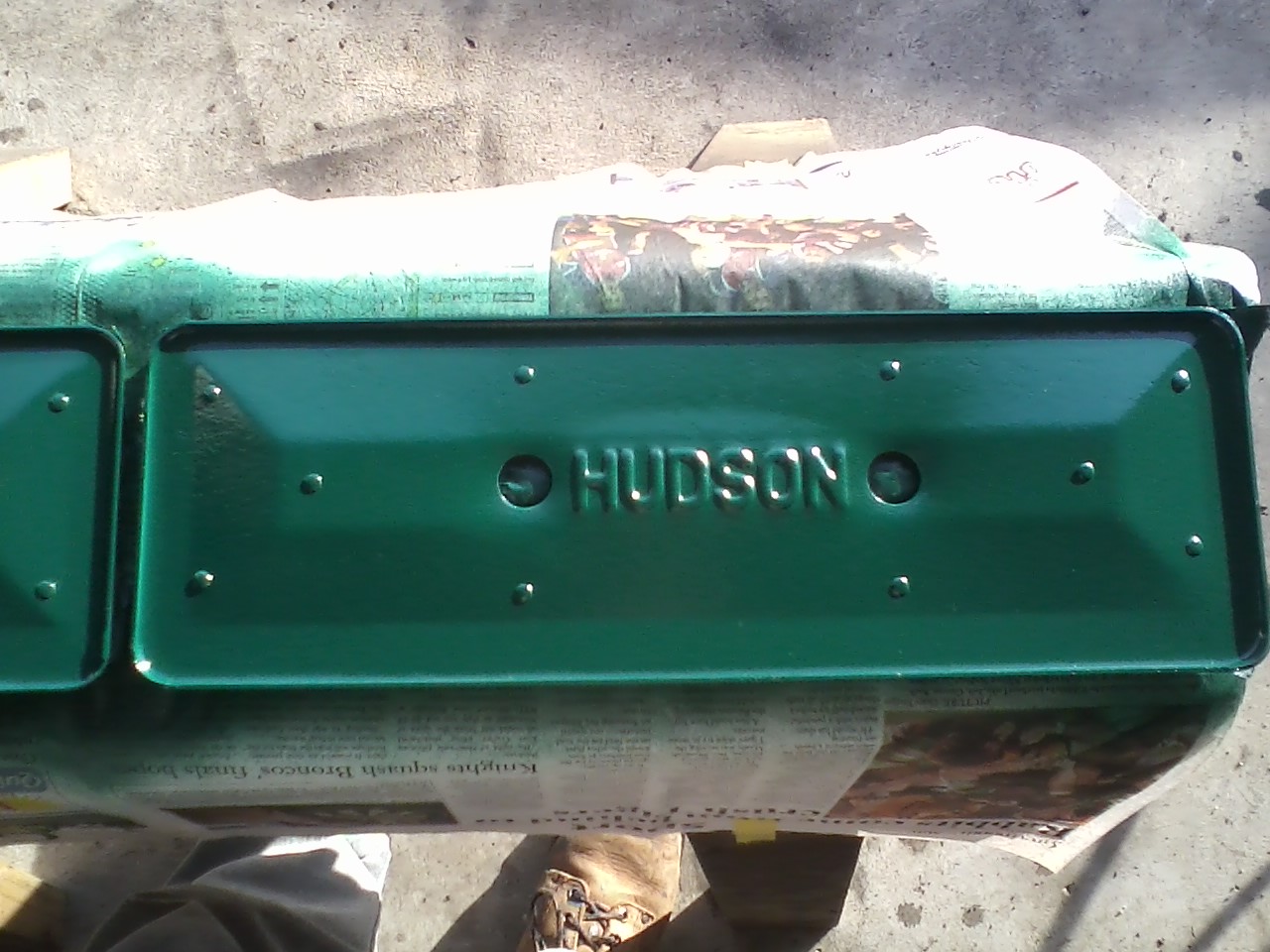

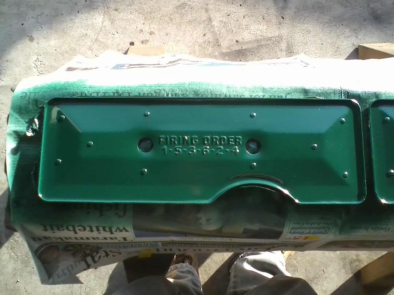

  29. I garnet blasted the side plates, and after a little primer and paint, threw em on the engine.
  30. The paint used on the engine is VHT Racing Green engine paint, in case anyones keen to use it themselves :)
