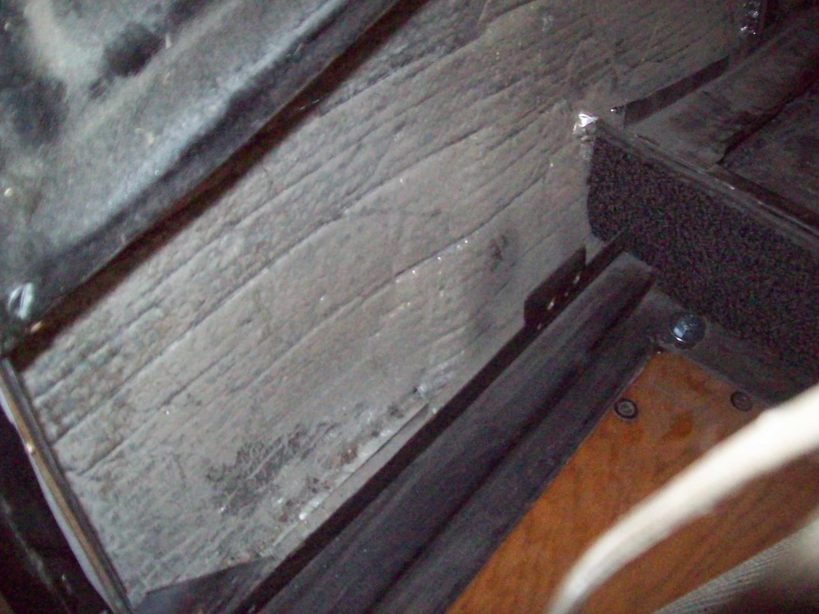

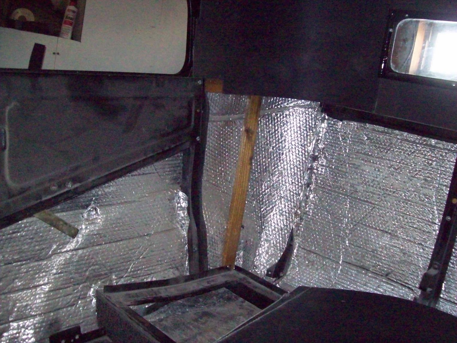

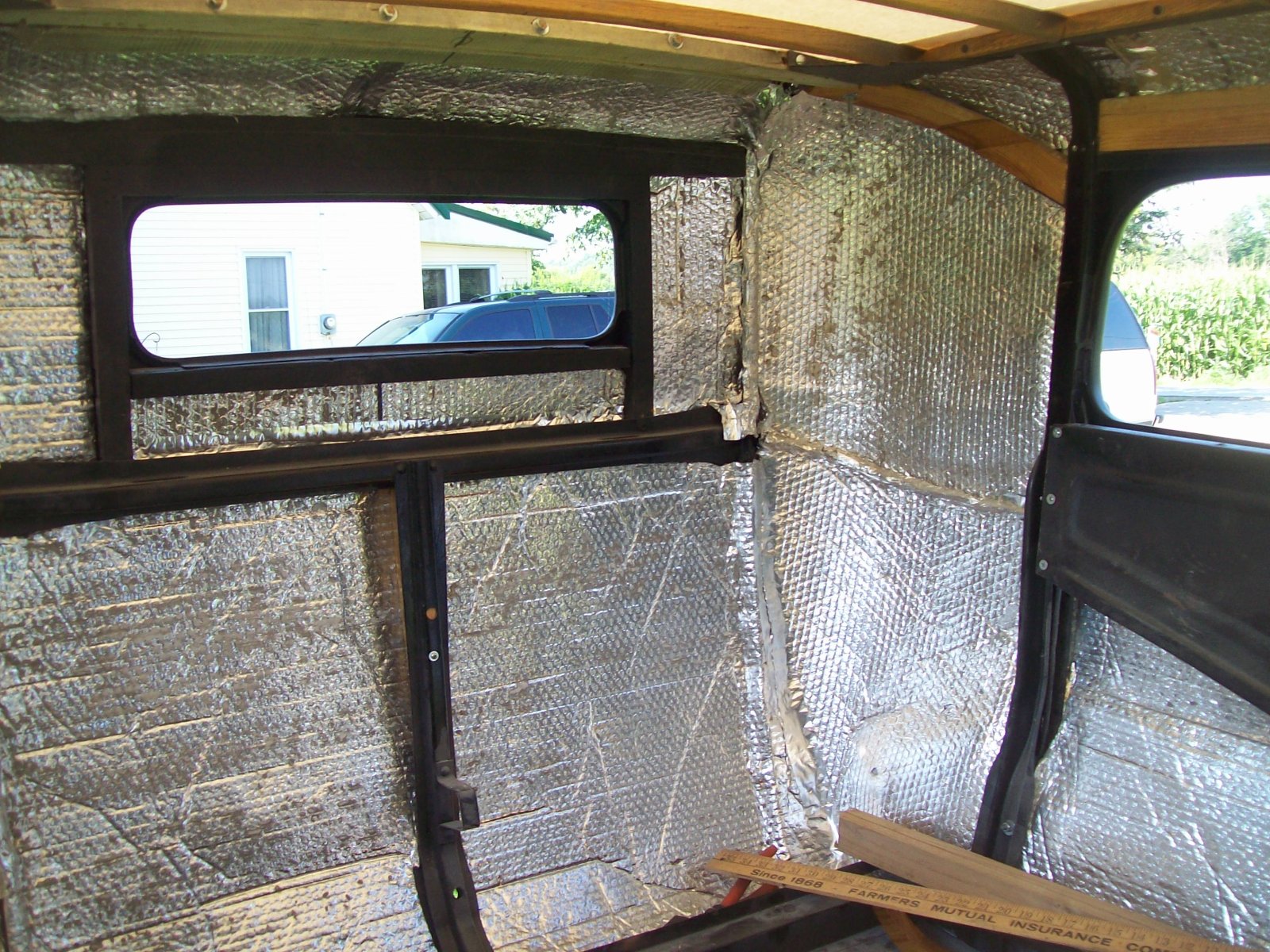

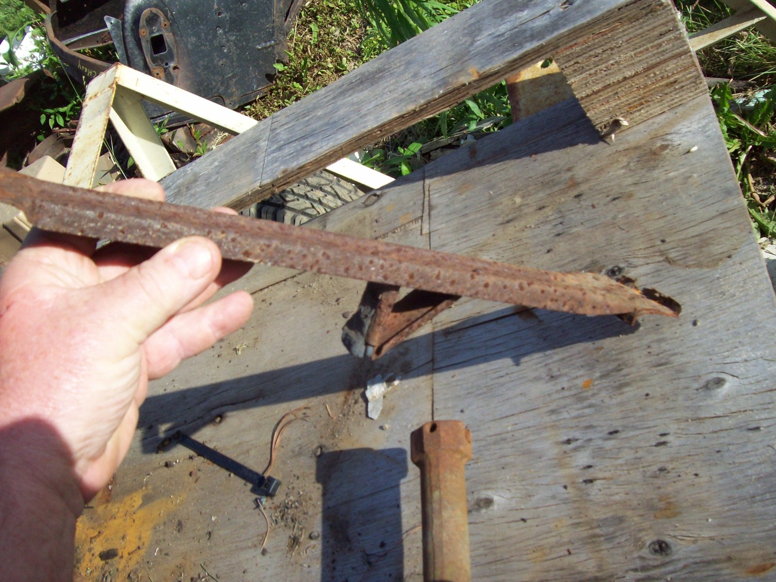

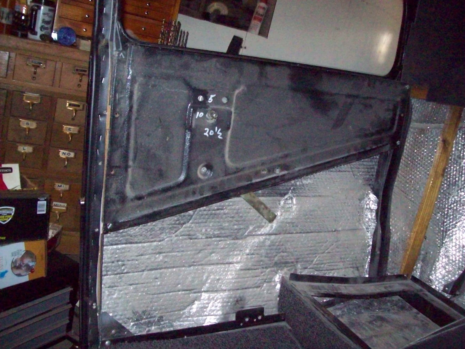

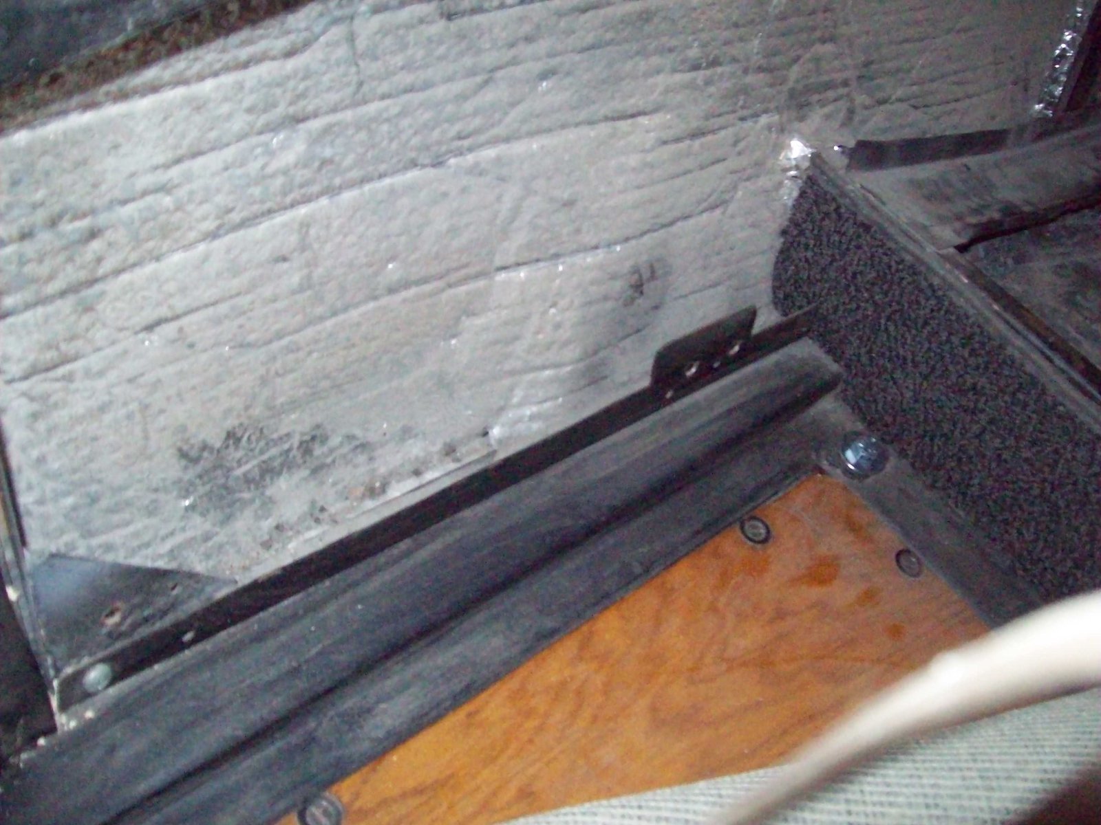

    That is not a rain gutter , it is just a channel the rear side panel clip into, you can just use a pieces of flat bar, here's some pics, most of the bolts are 1/4-20 , the carriage bolts need the heads flatten on some of them
    I'll make a list when I get time I have a 2 door here that is all taken apart and ready to go back together
    later kb
