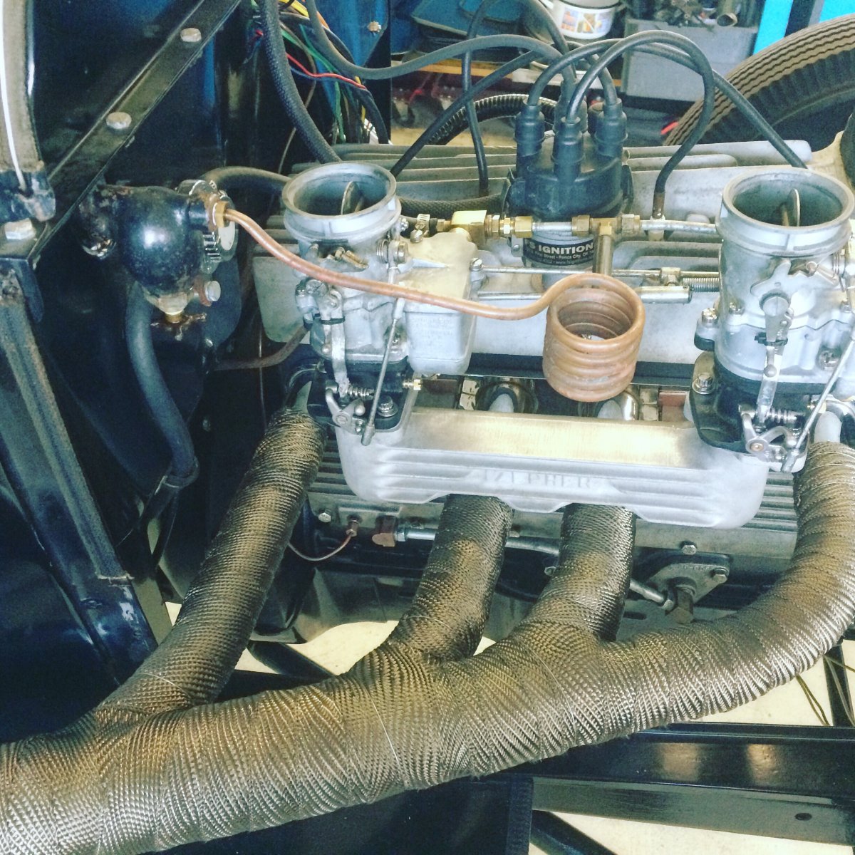

  14. bulli_cyrano
    Joined: Dec 24, 2016
    Posts: 10
    bulli_cyrano
    image.jpg Here is my 98 horsepower Banger
