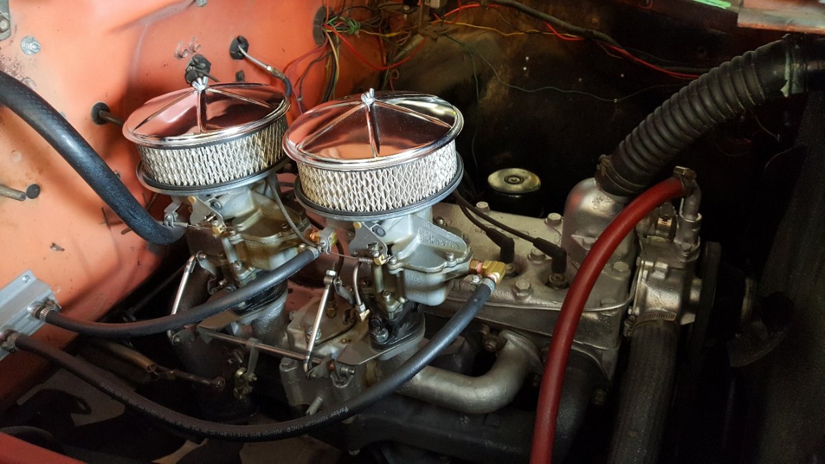

    Dodge 1948, 230cui ,Offenhauser manifold with -41 Oldsmobile carbs, and split exhaust.
    I did not build this,just bougth it:) Skärmavbild 2020-07-11 kl. 08.15.39.png Skärmavbild 2020-07-11 kl. 08.16.35.png

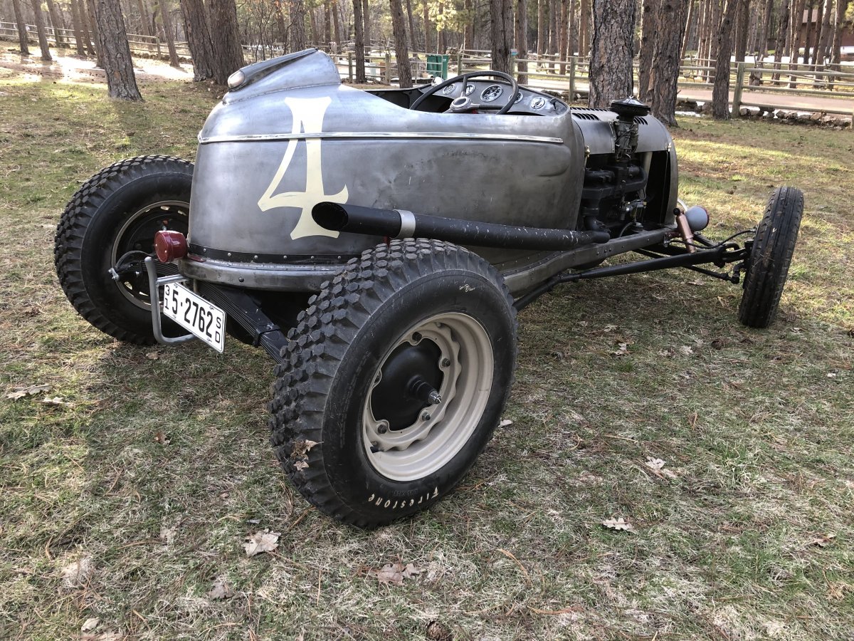

    C9A5B62B-E7DE-48A7-A398-A481A485B366.jpeg I have a 1959 dodge 230 in my single seater. It 100% stock though. It moves my little 1500 pound car down the road just fine. I don’t have plans to hop it up just get the oil leaks fixed.

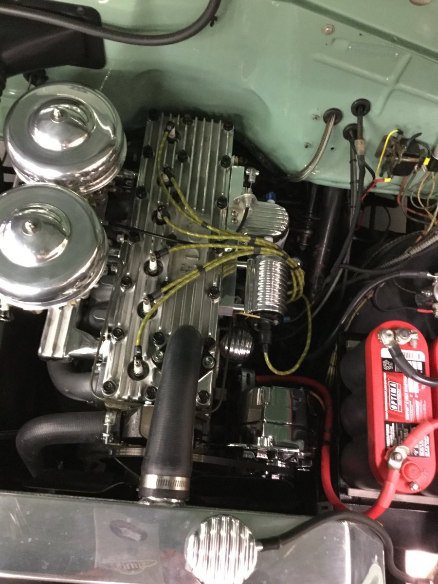

    I am interested in seeing detailed photos of hopped up flathead six installations; the new EDGY phase 2 heads do not accept the MoPar throttle bellcrank post.
    I am trying to determine how to connect the throttle linkage on the firewall, near the steering column, to the dual-carb AOK intake's Carter B&Bs.
    The Carbs are connected by a linkage included by George Asche, but how to connect that to the car is a puzzle.
    Also, if I want to install a hotter cam in my engine, which is stock and has been run about 3300 miles, how essential is it to install new lifters? Thanks for any advice or posted photos!

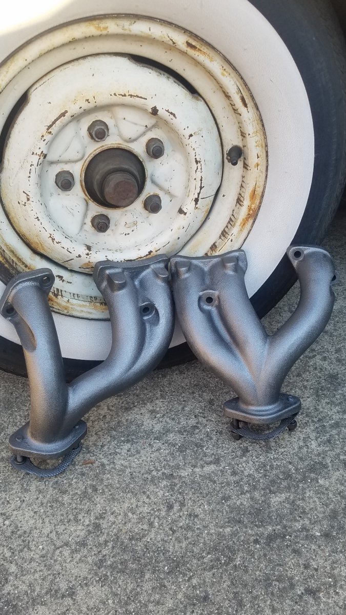

    Here's pics of my dual carb flathead 6. And my 265 engine.

    19BCFF8B-2EC1-4BD5-A16B-6E23BB1E737E.jpeg I’ve read a lot of concerns that the edgy head doesn’t have a provision for the belcrank throttle linkage. I used the stock pedal linkage and adapted a lokar gas pedal cable (shorten ) and made a few brackets

    Did you drill and tap the missing holes for the ignition lead tubes and the oil filter attach?
    I received my head Sunday and am unsure how to proceed. I will be calling Tony.

    No I didn’t use the factory plug wire holder but I did drill and tap the head to attach a brace to attach the throttle cable and
    Remote spin on oil filter. Hope this helps
