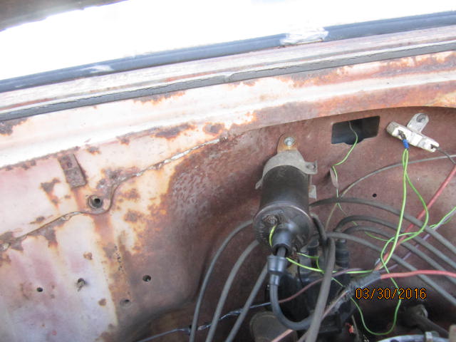

  1. horizontal coil 001.JPG horizontal coil 004.JPG horizontal coil 005.JPG Ok over on another forum Ive got in a discussion about coil mounting. the other guy claims a horizontally mounted oil filled coil will overheat. My contention is lots of engines like FE fords came from the factory with horizontally mounted oil filled coils. And they never failed because of how they where mounted. I think the coil don't know or care how its mounted?

    On a Horizontal mounting of the coil, If you mount it so the terminals are horizontal they are fine. If you mount it so the terminals are vertical they will then overheat as the upper terminal, inside, won't be fully immersed in oil.

    If you rotate yours so the terminals are horizontal instead of Vertical it will run cooler and last longer. As someone who works for a coil manufacturer, I can tell you it's just a good practice. The way it is now, depending on how full they got it with oil, the upper bobbin could be partially out of the oil, creating heat. A no cost change that is like cheap insurance. :)
    I have been mounting the Delco GM 12 volt coils that where originally mounted vertical in a horizontal position on my tractors for at least 5 decades. The first picture I posted is a 12 volt Delco Coil that has been on that 1944 M farmall for at least 50 years. I have a wire I attach to byp*** the resistor when starting it. I have numerious times forgot to unhook it and then remembered and the coil was hot to the touch.. But it still works ok . I havealso mounted a Delco coil sticking out from the firewall on my 55 chevy. buzz it to six grand and it never gives problems.
