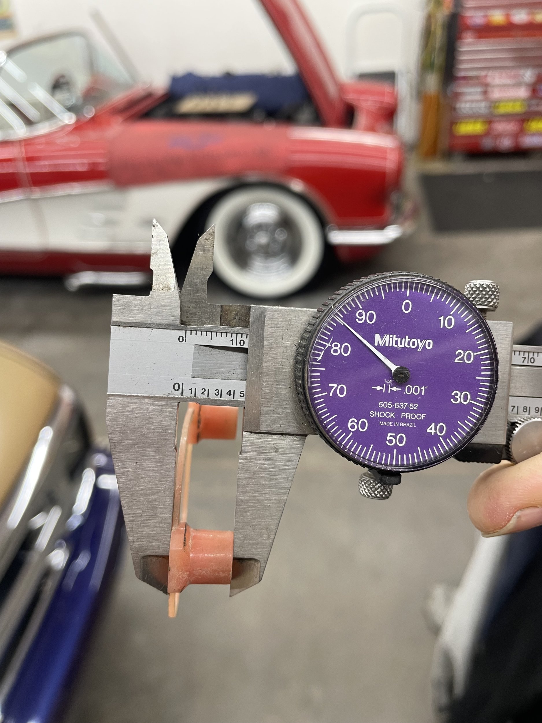

    Is this it?
    Johnny Gee likes this.

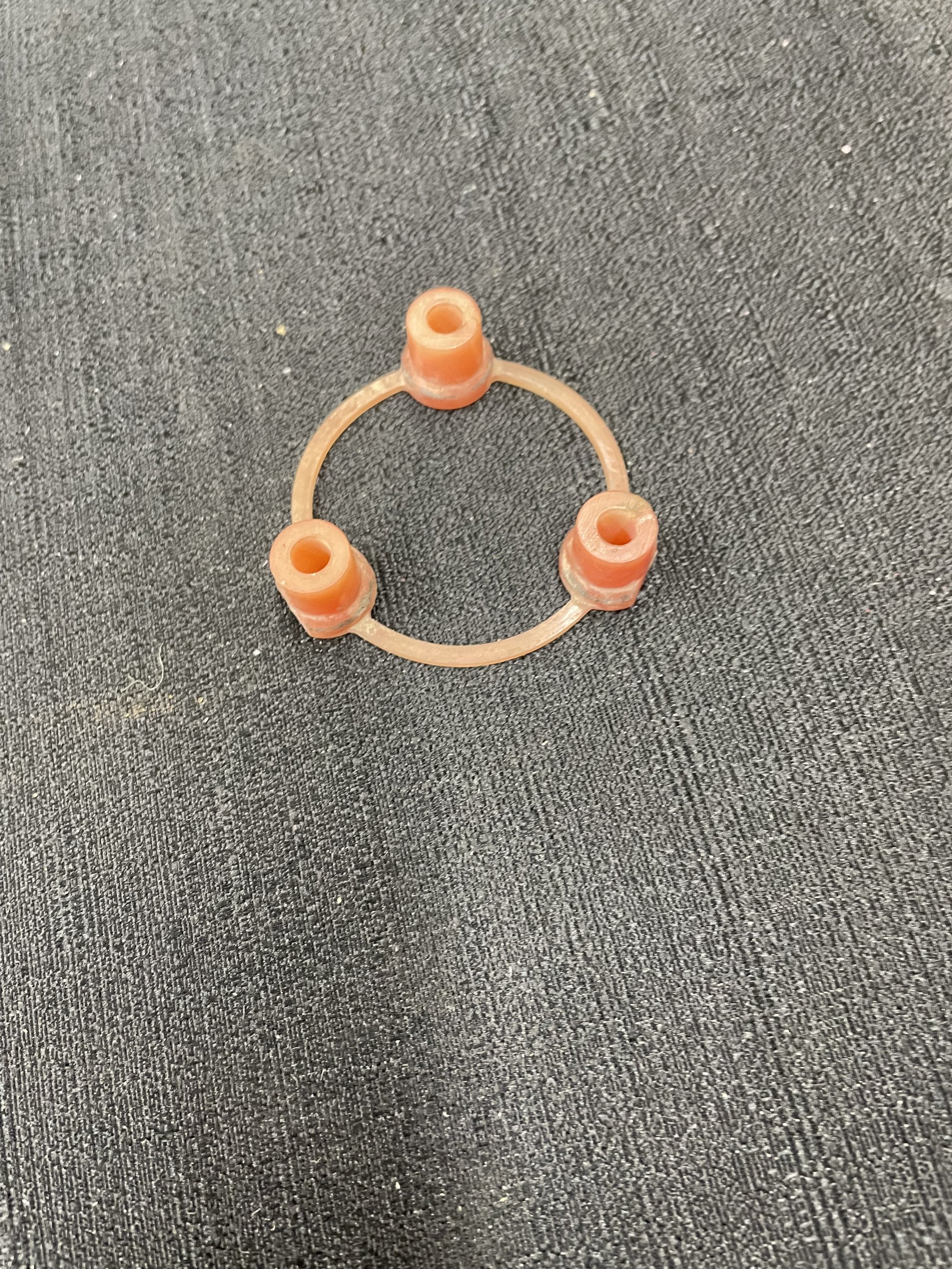

    The orange piece that Moriarty shows. And the red piece from alanp561. Iirc. Used to come in different lengths for different steering wheels/columns. Though I suspect the after market only supply's one generic size/length. As far as the aftermarket from China is concerned. It doesn't actually have to work. As long as it looks similar.

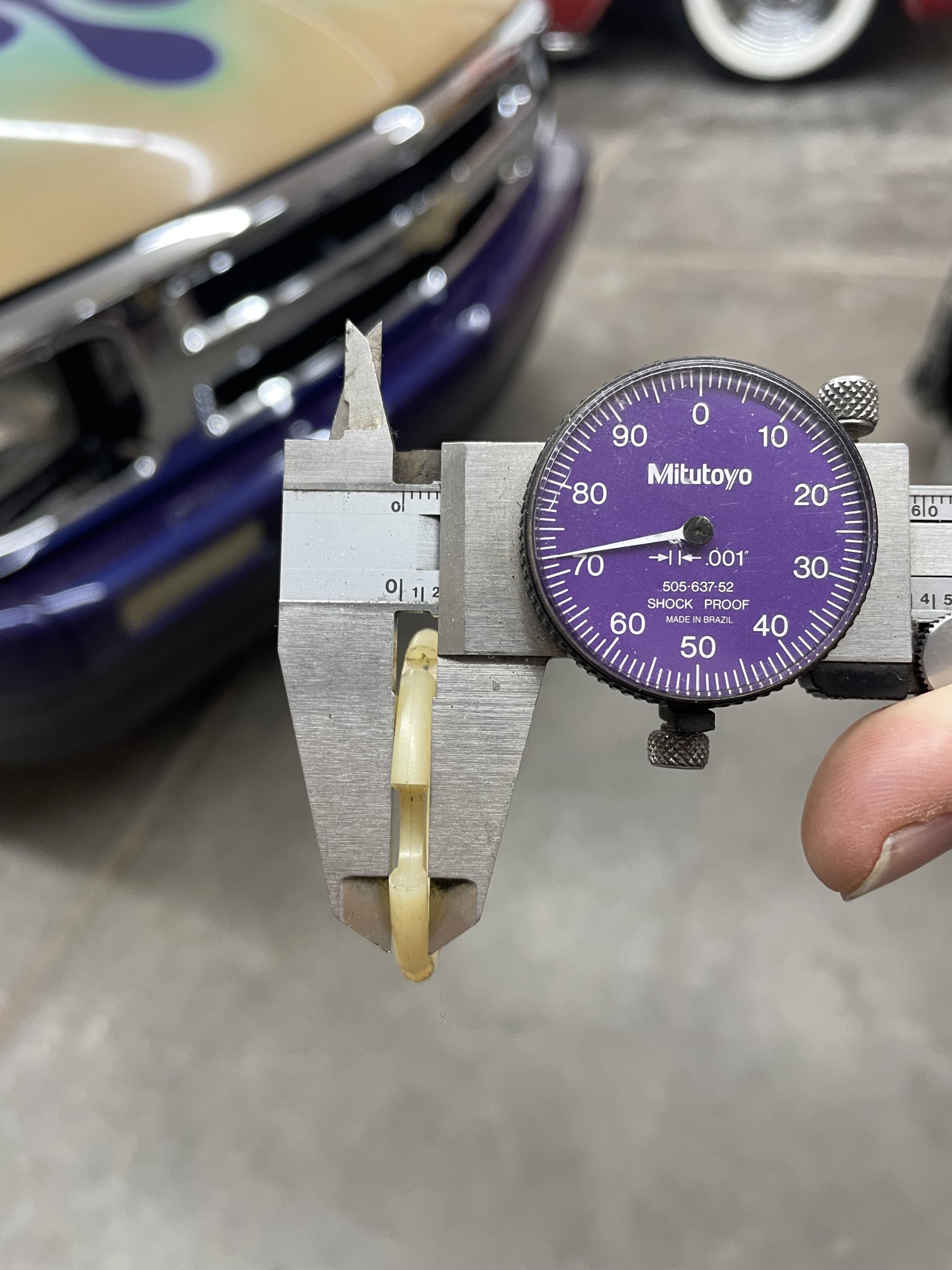

    Yup, found a white one. Look at the difference in thickness

    How does your repop part measure compared to your original broken part and to my pictures above?

  22. Moriarity
    Joined: Apr 11, 2001
    Posts: 37,659
    Moriarity
    SUPER MODERATOR
    How thick is yours ? Send me a pm with your address, if you think this part will fix it I will be happy to send it to you IMG_3119.jpeg
