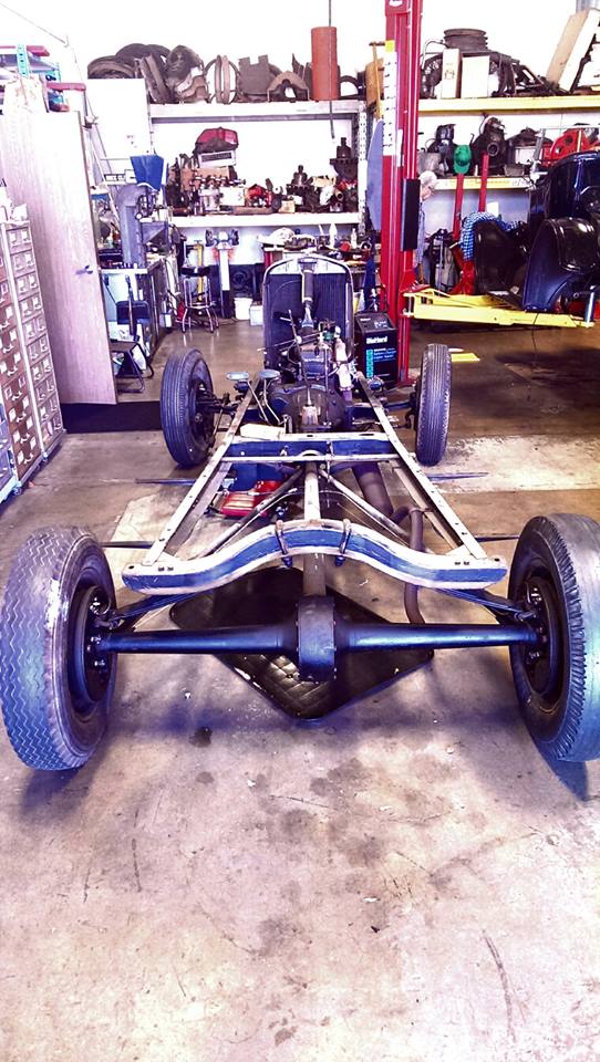

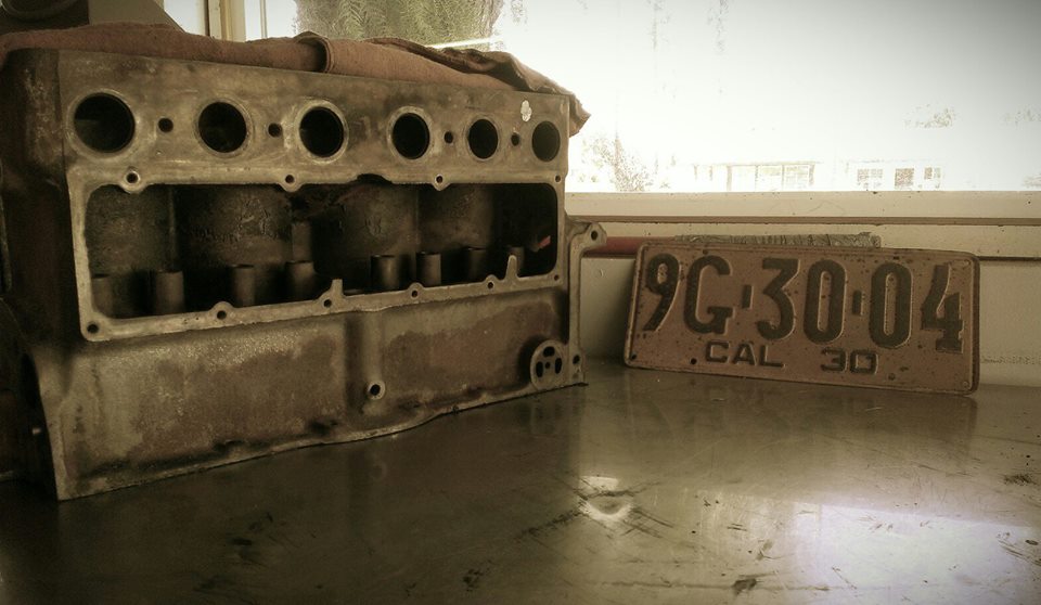

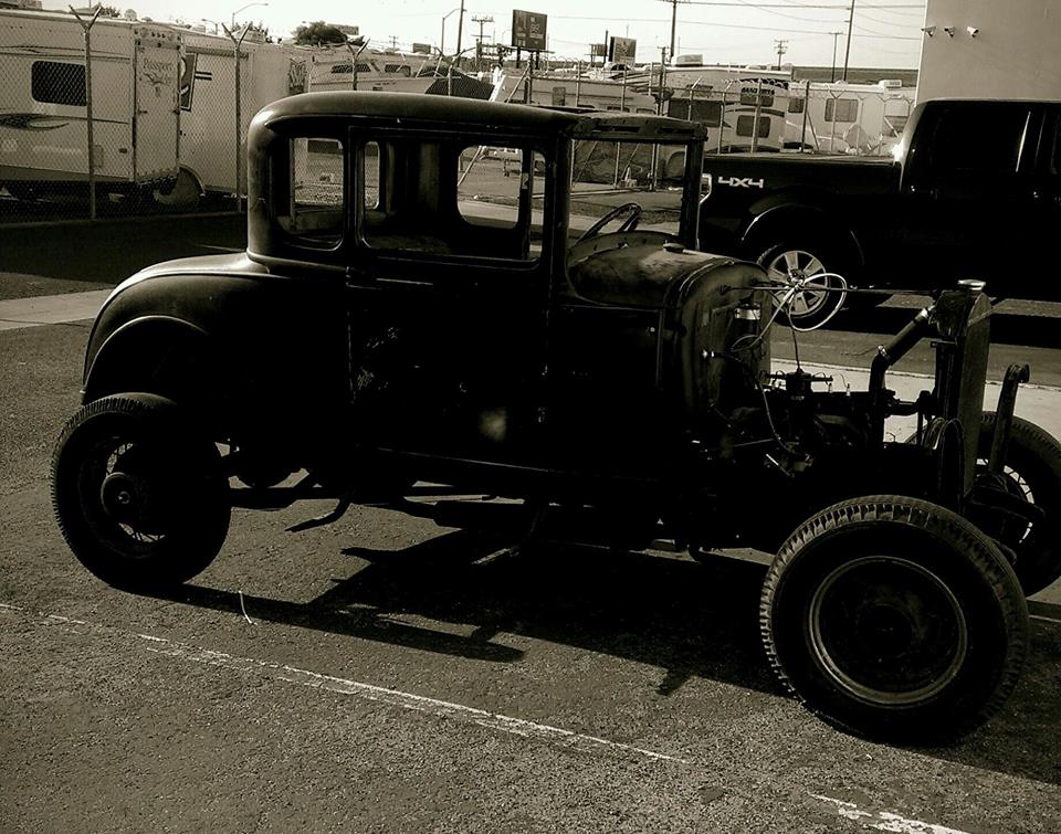

    so im about a month into the build of my first model A...1930 -- 5window. motor getting done as we speak, searching out for a T5 trans..just swapped out the rear springs for T's minus one springs (thanks for the help Elrod). i used a heavy duty paint my pop uses on all his T's to do up the frame. came out good...Body is perfect..like 99% perfect and all there (running it fenderless). I am sure i am going to leave it untouched paint wise for a while..83 year old patina looks cool. besides a little minor stuff, should be cruising down the road soon.
    Have to say the HAMB community is such a great reference...thank you all for the advise...i am positive i will need more. will update as we go.
